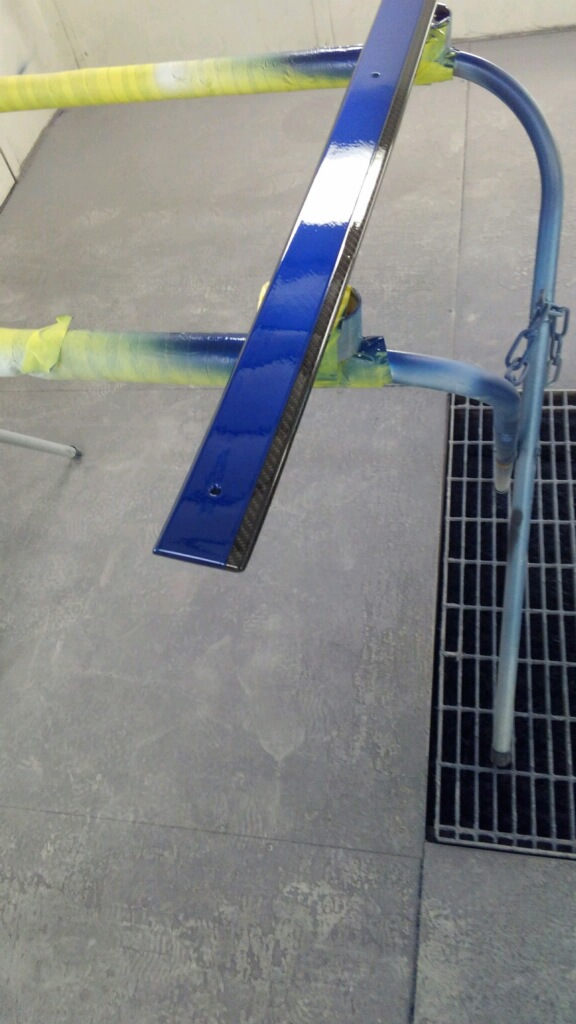

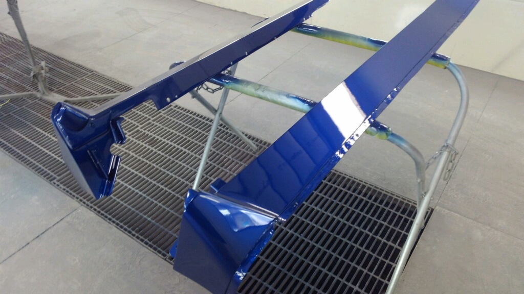

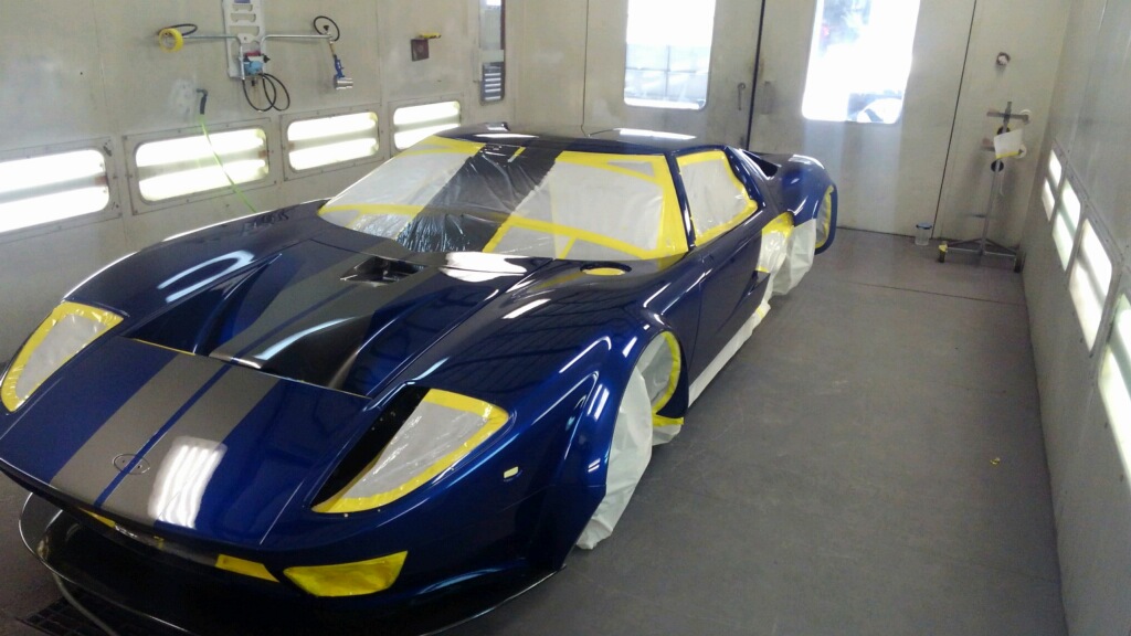

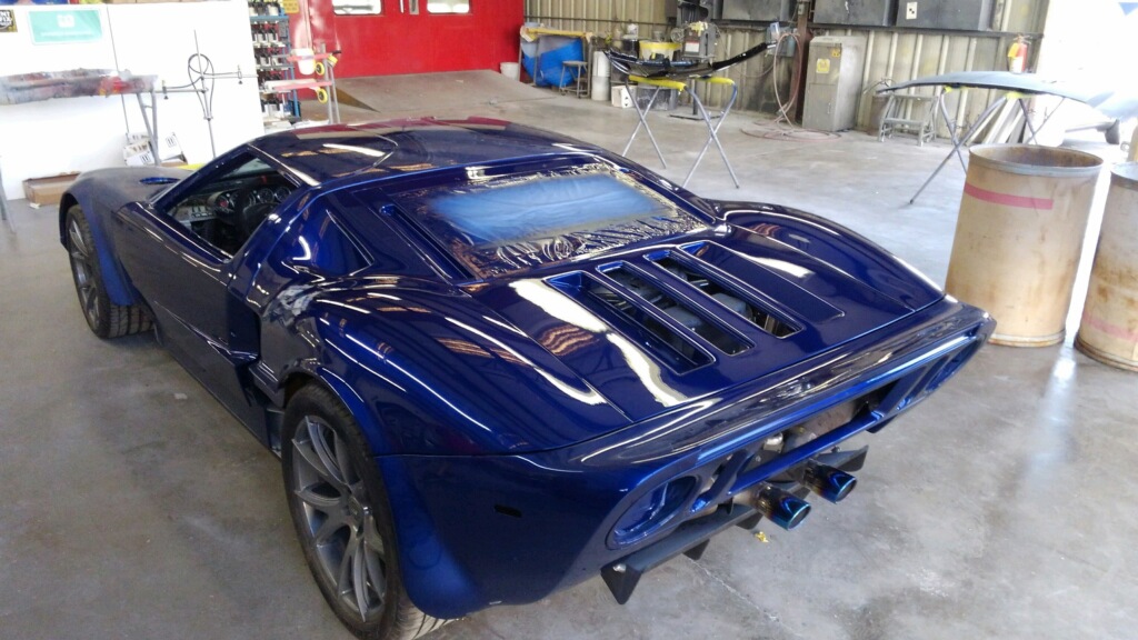

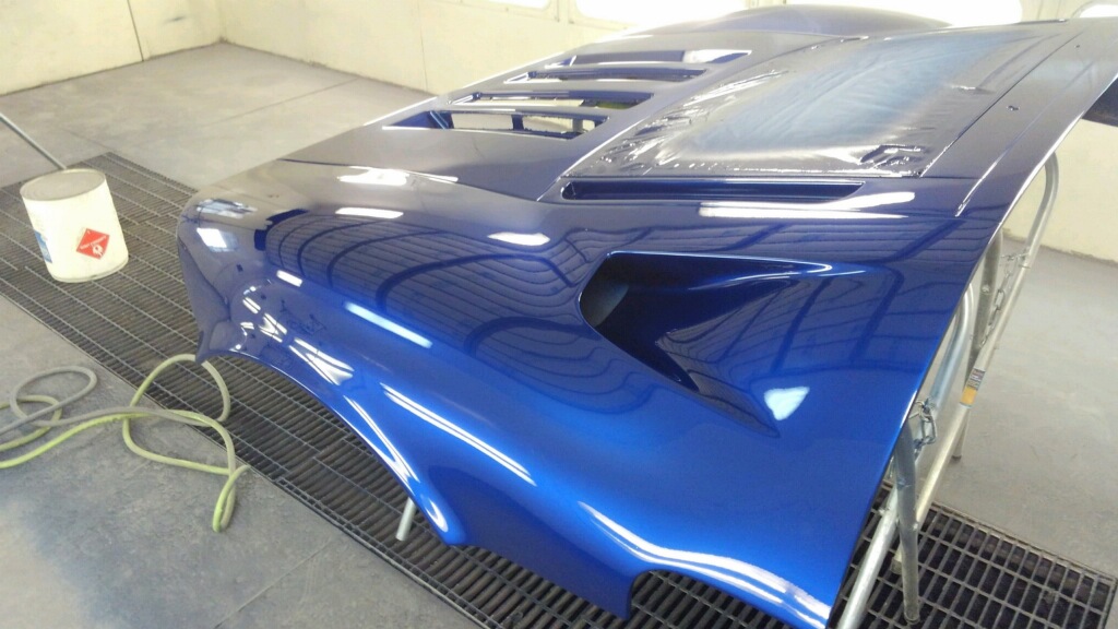

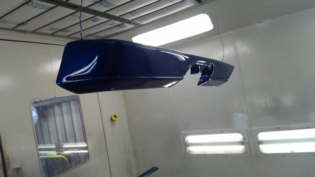

Well everything that needed to be blue is now blue!
Well primer coat, blocked, black base primer, three coats of deep impact blue base and two coats of PPGs finest clear coat. next it will get wet sanded on all the outer surfaces, laid out and painted with the graphite stripes and three more coats of clear, I think it should look beautiful.
