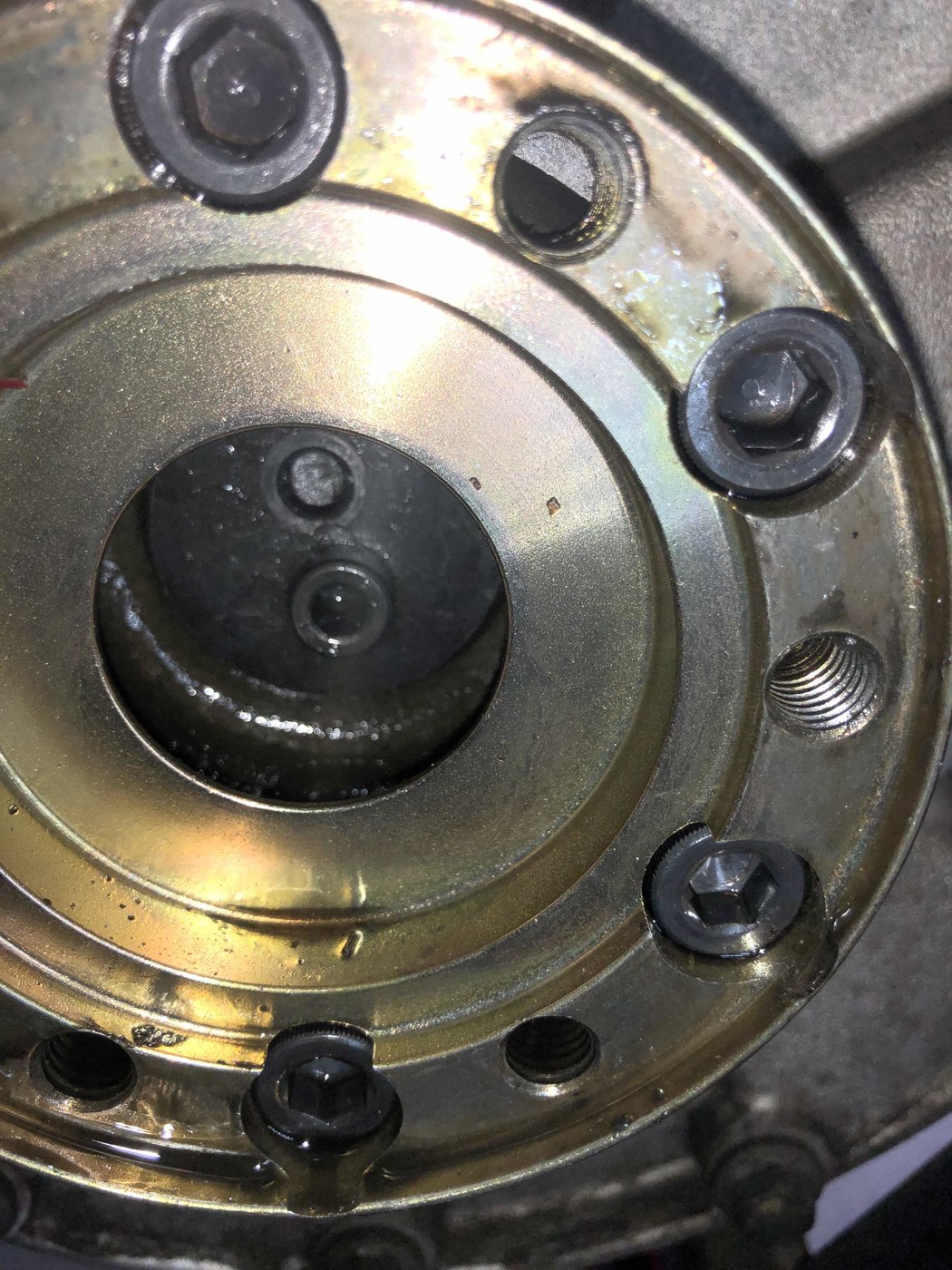

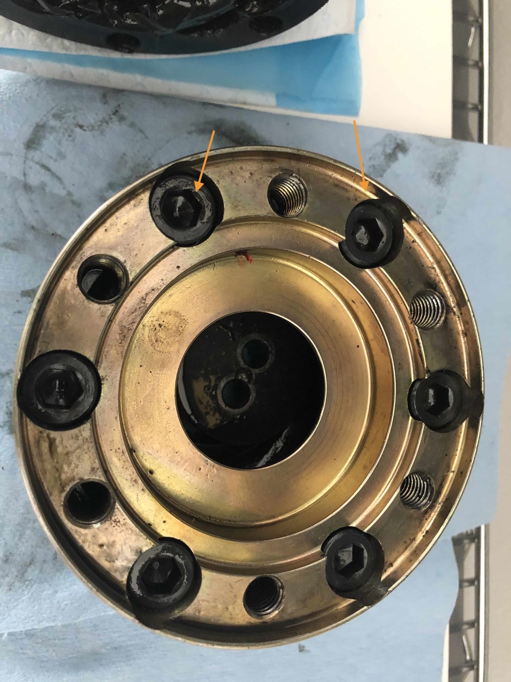

An update.
I have successfully replaced the left (driver's side seal). Not a minute too soon as one of the bolts had sheared.
I had to remove the entire shaft (both sides) to get it out. I did not have enough clearance to separate the shaft from the output shaft flange.
So I had to remove the 6 bolts on the wheel side.
Question - Should I replace these bolts are well? They are the same size as the replacement bolts in the Accufab kit?
Also - I have to remove the cover of the output shaft flange to get to the output shaft washer. Looks like 6 bolts, same diameter but shorter. Should I replace these bolts as well or can I reuse them - If I need to replace anybody have a source?
Starting on right side tomorrow. Thanks again for everyones help.

Agreed - I changed those to Accufab. Question is do I change the others with ARP or buy another set of Accufab since the bolt size is similar?
Also - what about for the spacer flange - these bolts are 10MM but quite a bit shorter than the other bolts. Trying to back one out to measure.
