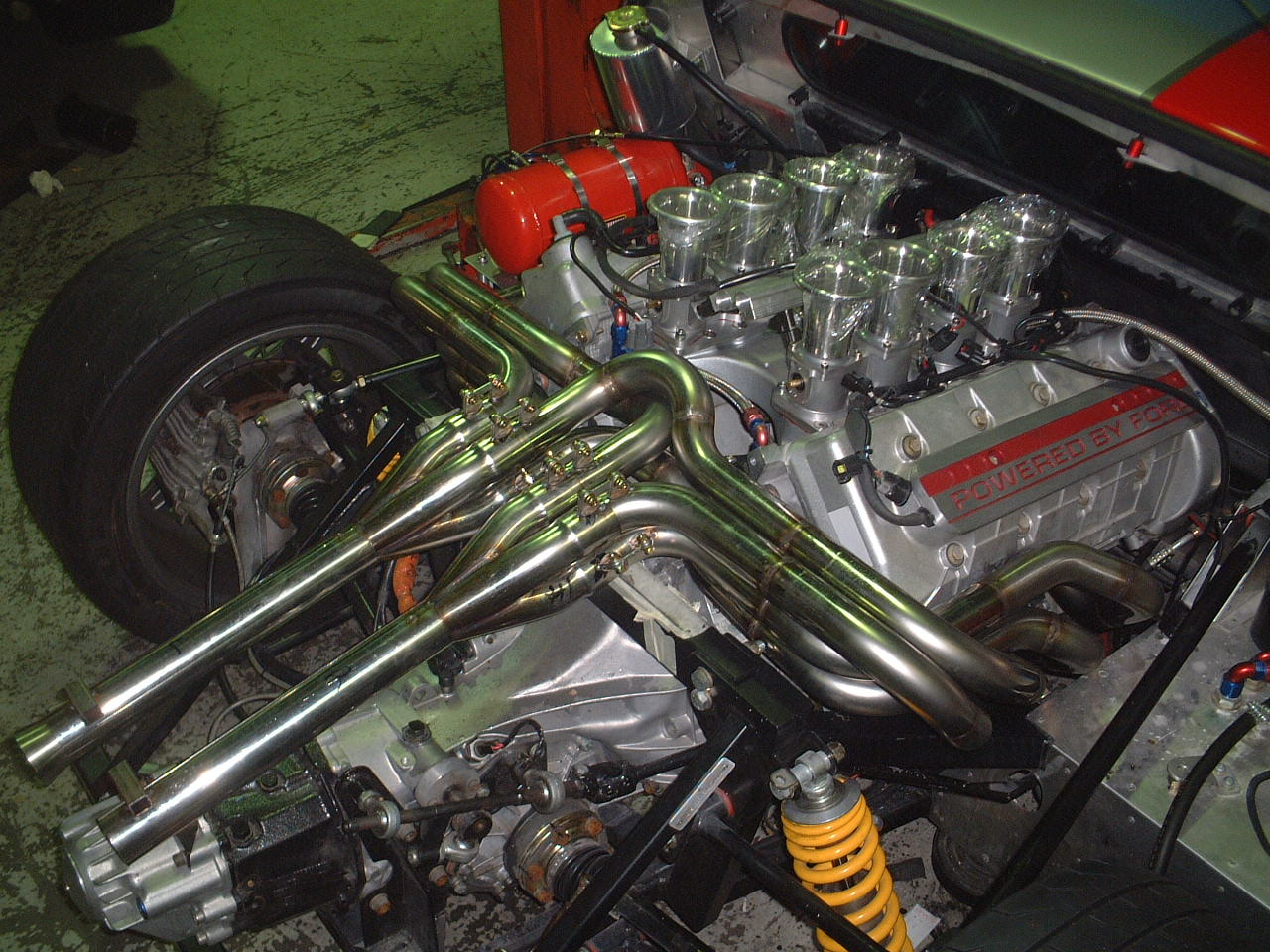

On performance I was advised that if I wanted power at high RPM with my engine (which will rev to 7.5K to 8K) I had to ditch the cross over and have the shortest equal length system possible. This resulted in my setup with a H-pipe. Burns Stainless did analysis and advised this. I built this system below. It is my first attempt at headers with some help from RF.
It just takes hours and I also had a big disc sander that faced all the tubes. I actually cut all the tubes by hand with a hacksaw. As it was very thin tube it was easy, controlled and did not create a load of dusty crap in the workshop.

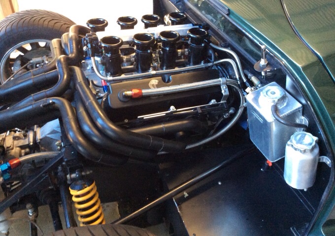

Here are my pipes, self made in mild steel with black exhaust pipe paint..a bit ghetto compared to some above but do the job fine. I still need to linish the mig welds back a bit more to smooth off.

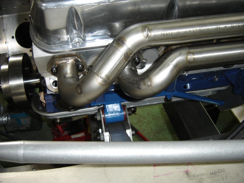

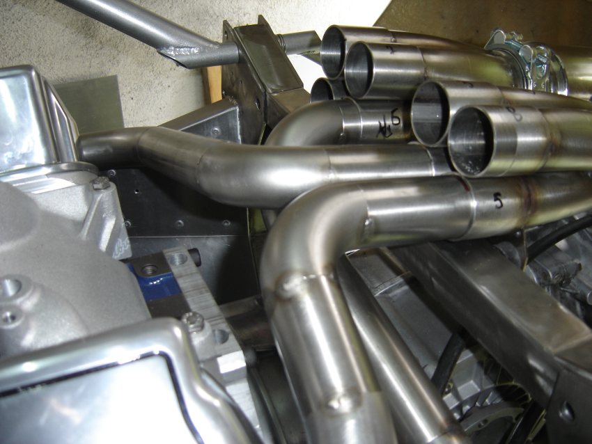

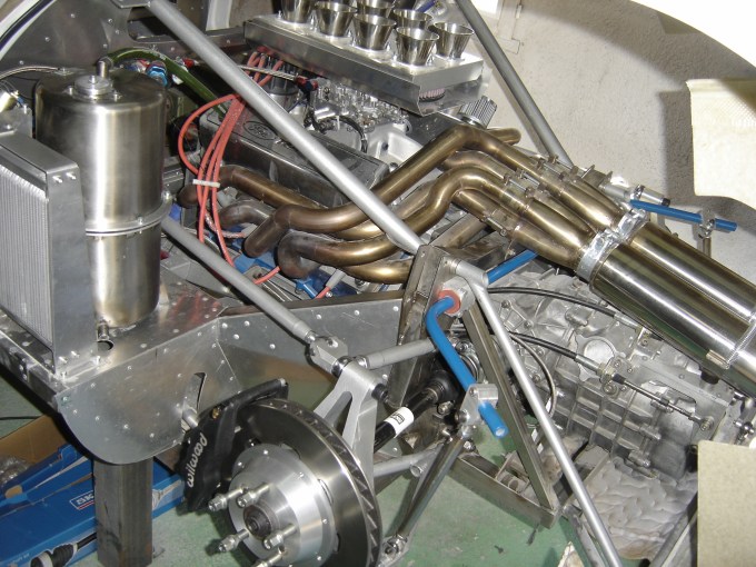

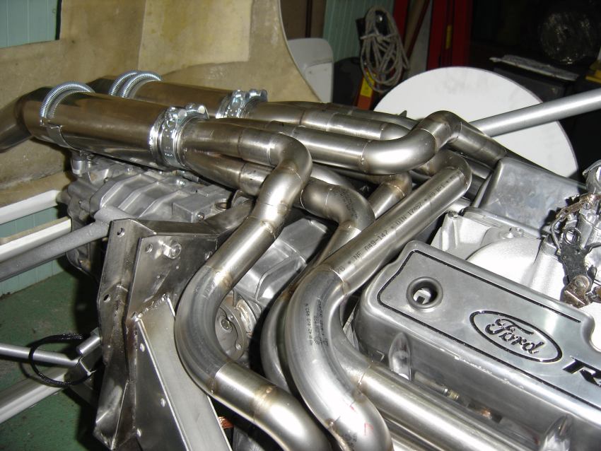

To bring my 2 cents to the subject , these are the headers I made for my 302/331 SBF on a scratchbuilt GT40 ; from this first experience I keep in mind the following main points :
*SS 304 ( 1.6 to 2 mm thick) with pre-fabricated bends is a very valuable solution.
Needs some patience, but you know you will get at the end ...
*One independant flange for each cylinder ( 8 mm thick SS) is a must for a cross-over system ; the main point is to memorize the right de-installation and re-installation sequence!
*4/1 own merges are a satisfaction, but a huge work !
*A seen on the pictures, the pipes color is evoluting to some brown from usage ...
