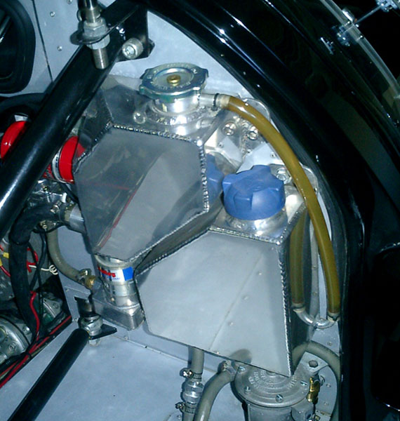

I have dual Holley fuel pumps mounted on the lower firewall and they function perfectly.

My Holley pumps did not prevent fuel from flowing backwards and required an in-line check valve (see it at the bottom center on the picture in the earlier post). I got my check valves off of eBay and if memory serves me, I paid like $15/each. If anyone needs them I will check the source and post it.
