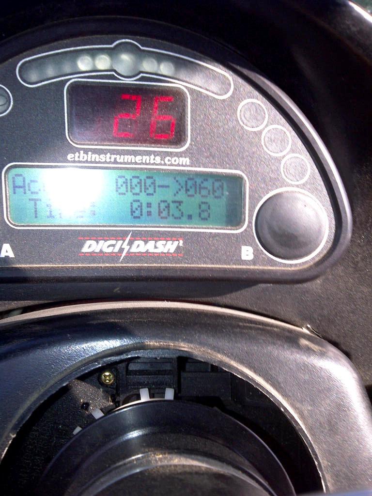

I tried a few 0-60 passes with my SL-C when it was first built. I tried to hit 60 in first but got fuel pump cut out at 58mph. Bummer. Had to slap together a quick shift to second but still managed a good time:
Tires: Nitto nt05a 335-19 in the rear
Drivetrain: LS376 - Ricardo 3.30 final ratio
Timing: Digidash
Conditions : Dry
Temp: mild 60's, quite nice
Elevation: 800ft -Texas flat
Pass: 2nd and final 0-60 run.
Result: 3.8 seconds
If I had been expecting to shift I could have easily shaved the time down to sub 3.5. With not Hoosiers, I think the 3.2 sec estimate is pretty reasonable.
These 2 passes made me realize the Ricardo is not made for 0-60. A 3.30 final drive is great for the track, I normally need only 1 shift between 3rd and 4th.
I'd think a Porsche tranaxle with a higher final drive ratio would be the call. 18" rear rims would also help acceleration at the cost of top end.
The combination of a high torque pushrod LS, solid motor mounts, tubular Al frame and a 3.3 drive ratio is pretty brutal. Plus I can get more g's on cornering.

Jack, you're right, I'm sure I could have crushed 4.5k clutch dumps and got better times, that was a first stab, not a huge amount of effort.
