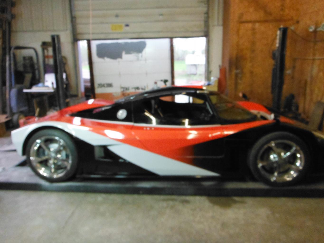

Well, I took mine to the drag strip Wends nite, test and tune nite, not its not turned up, only 8psi of boost, rev limiter is set at 6500 till motor is broke in then Ill go to 8000.
0-100 was 8 sec. flat, first gear was really usless since It went on the rev limiter with in 20 ft and didnt really spin the wheels, track is very sticky, so yes if I wanted to drop the hammer from a standing start im sure I could of been in the 7 second range, but for now, thats fast enough for me, I worked hard on the car to get it to driving state.

Dave, I had the mods done to the rotors, bearings, oiling system, balanced, yes 8000 is where my limit is, soft rev limiter is set at 7500. T8 Greedy turbo. The micro tech im getting used to it, so im geting around 13-13.8 normal driving, under boost im at 11.5 -12 on my A/F gauge.
I really have no desire right now to go any faster, I built the car to be quick like Paul's, to me its more fun out of a turn, leaving a car show and banging gears then 200 mph.
Thanks for every ones input, for right now, I am going to drive it, I want to wear out at least 1 set of tires this year, I am happy with the way the car drives, its not a luxury car, at least mine isn't, but it does get plenty of looks when I park it anyplace. No air, no radio, just a stock dash nothing else, that's this winters project. I did buy the door panels, but need to cut my seats on the side support, I have big Kirkey seats in it.

Your photos are terrible but your car is sick!
Try and get a video up with sound if you can. Amazing job......:)
It almost has the F 1 new engine sound other then the whoosh of the turbo and relieve valve when you let off. SHifting is not quite as fast, but pretty close with the sequential gear box.
