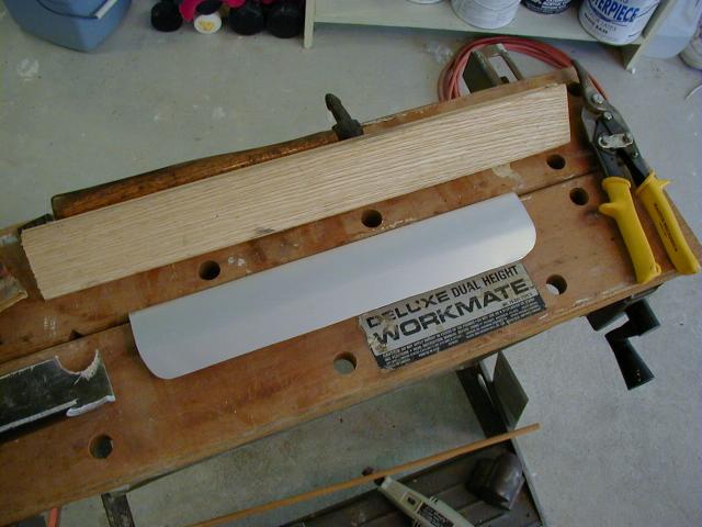

Even though the paint job is not the paint job of the '69 Le Mans race there were features I could look at close up. One was the small splash guards on the wheel wells of the front tires. With that information I made my own guards and will be mounting them soon.
