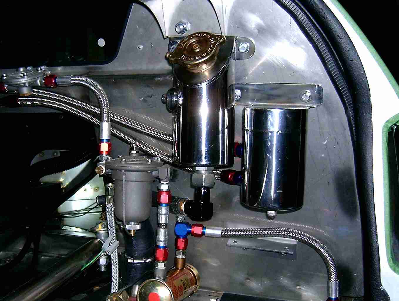

Buzz, The Caped Crusaders report no Fuel Starvation problems. All the plumbing is AN8 plus the surge tank, in fact leaning out the system at high RPM was a challenge. Braking and cornering has no effect on fuel delivery either.
Now if I could just get Superwomans address! PS: The high pressure pump mounts below the surge tank on the bracket shown.

Enjoyed the pics of your Fuel Injection plumbing by the way!
