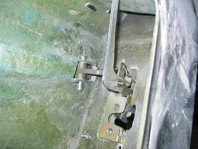

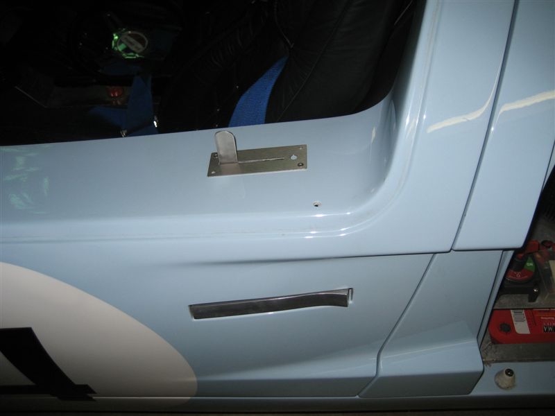

Bill, I used a 3/8 inch Hich pin to hold the handle in the door.If you cut a hole in the recess for the arm you can mark center line of the hole for the handle.I think Ron has a good close up of this from the inside of the door.
I glassed in some metal tubing to the door for the pin to sit in. Here is a picture

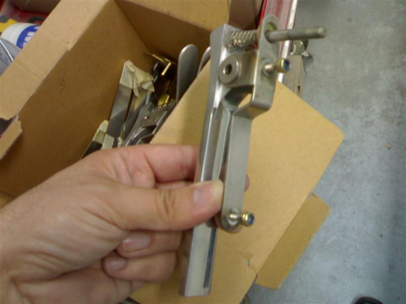

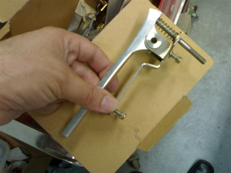

I used the "New" RF type of handle - of which only 2 sets were made before everything turned to PITA.
It was a great idea though as the handle mechanism is self contained - ie. it is assembled outside the car and then you attach it - quite simple really.

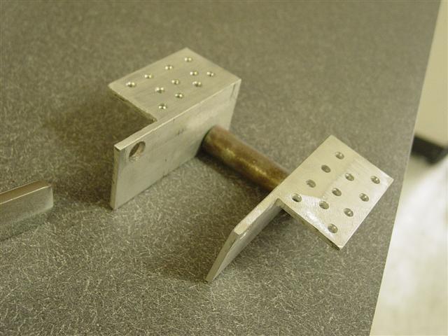

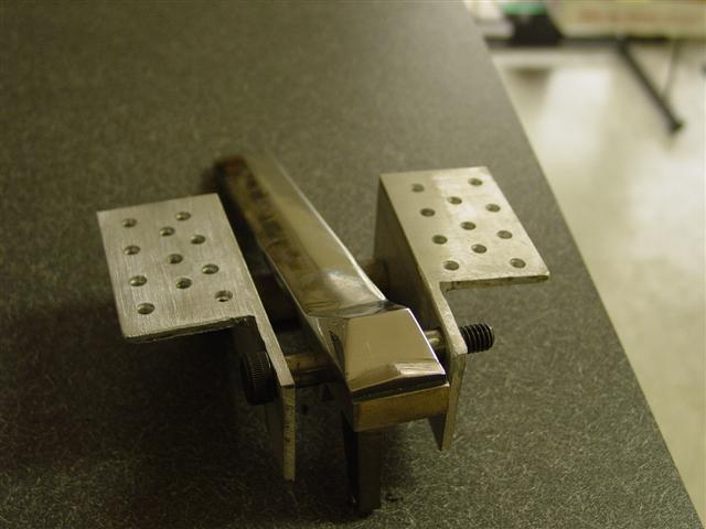

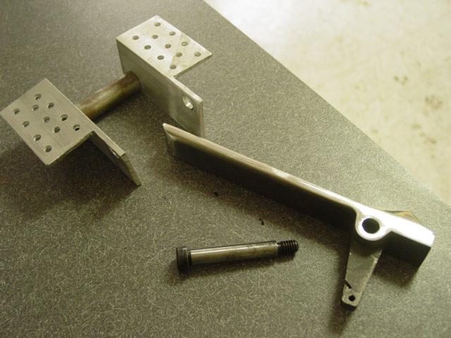

Rons approach is very similar to the one used at the shop, we use two angles of 1/8th aluminum and we bond them to the inner door...we also ream the door handle pivot hole and use a ground surface shoulder bolt as the pin....
I dont have any pics at home but I will post some in the am.
The RF components shown are a very elegant solution.

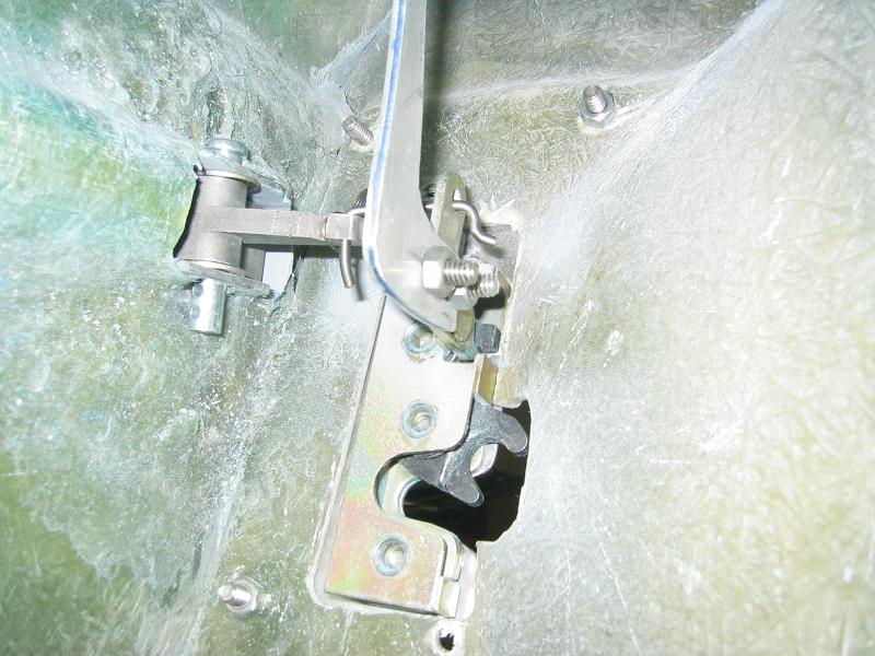

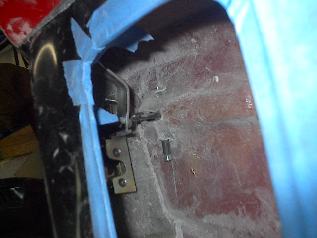

I used a die grinder to make a big hole. I then installed the metal pipe on both sides and glassed it in. Then I filled any gaps between the pipe and the hole.
Pics as promised

It appears the hole has to be large enough so the back of the handle can pivot in to open the door. Is that correct?
