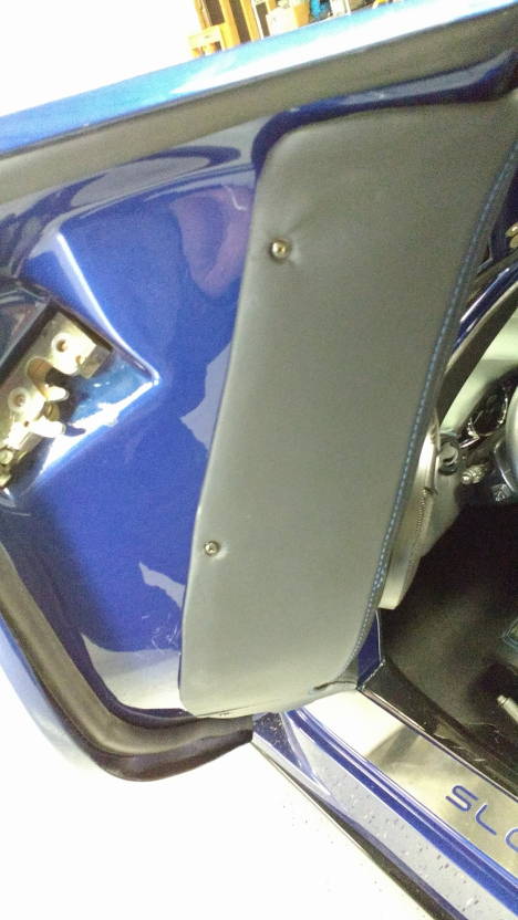

I used black anodized screws along the outside bottom edge of the door panels (i.e. only visible when the door is open). These camouflage pretty well against the black leather.

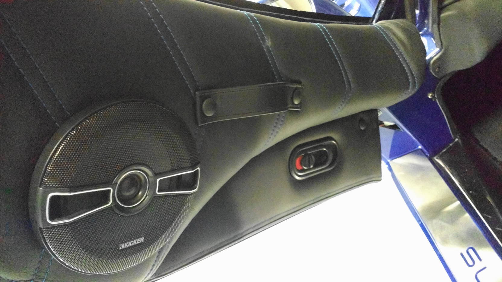

At the middle of the door panel, there is a leather door pull. Each end of the pull is secured with screws into a bracket which is glassed into the door structure. This helps pull the door panel tight to the window frame and provides a solid structure to pull the door down with. The screws are covered with upholstered buttons. Similar buttons are used to cover a screw at the very top, rear edge of the door panel and at the front of the door panel, facing into the cockpit. Both of these are needed to hold the panel snug against the door frame and both have an upholstered button on them.
