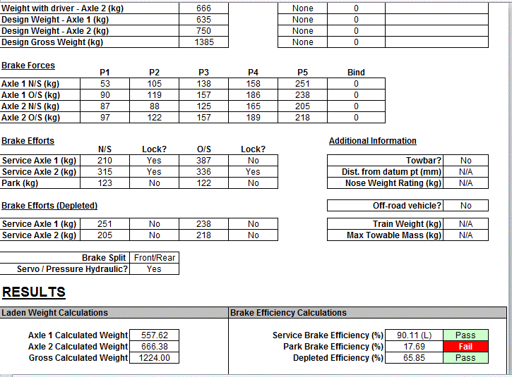

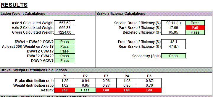

Hi Lloyd,
Unfortunately, the UK brake test is done on a brake roller tester. I think this is the hardest part of the test to pass I have found my brake results which show the results from different forces applied to the foot brake, and hand / emergency brake results. Needless to say aI failed my first IVA test on brakes as the attached results show,

Mark .... I don't have a Bias .... 2 Servos .. I put my Pilgrim Cobra through SVA in 2002 a lot different now ... All the fails are very minor . apart from hand brake ...... Retest next Wed .. fingers crossed ...
