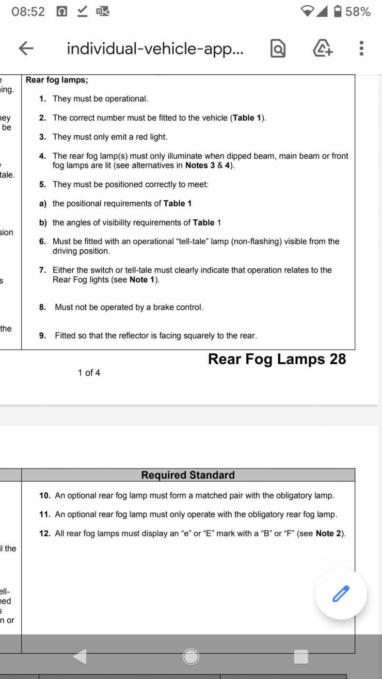

Ed McClements
See section 28 from current IVA manual.
Ed McClements
You need to be able to switch on the rear fog only when the headlamp is on, whether it's on main beam or dipped. The switch must be labelled, and there needs to be a warning light to remind you that the rear fog light is on. The warning light needs to be labelled, or bear the fog lamp icon. And that's it.
There are *optional* alternatives in Notes 3 & 4, but they're more complex to implement. Keep it simple, IMHO.

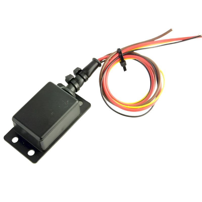

Hi,
From what that I understood is that the fog light may be switched on with dip or beam only, and with warning light on dash, done in such way when you switch of the headlights, the rear fog light is of to and you must again switch on manually the fog light on..
cars builders sell this little item ..
this is to avoid driving behind cars with the fog light switch on by people who forget what the warning light on the dash is for... when the last time when they were driving in fog...

Ed McClements
Hi chaps
I totally understand what you're saying, but the rules in black & white do not mandate what you're proposing.
VOSA have offered the following clarification by e-mail to several clubs / enquiries:-
Good Morning ****
We understand that there is some confusion over Note 4 in section 28 regarding the operation of rear fog lamps, the intention of Note 4 was to allow these options but not mandate them.
The requirement for the rear fog lamps are as follows:
The rear fog lamp(s) must only illuminate when dipped beam, main beam or front fog lamps are lit,
But the other conditions listed in the Note 4 will also be accepted if manufactured / wired up that way,
The manual is currently been amended and will clarify the operation of the rear fog lamps and the accepted alternatives, we have already issued a memo to all IVA Examiners with the correct information so VOSA Station should now be applying the correct standard.
Hopefully this will resolve your concern
For all the requirements regarding IVA can be found in the Inspection Manual which is free to download from Vehicle approval - GOV.UK
many thanks
Approvals Policy Engineer
Approvals Scheme Management
Scheme Management and External Relations
So...I was only offering the facts, so that Shaun can decide on the way forward.
Cheers,
Eddy

Shaun
CBS sell latching and non latching versions dependant on which switch type you have.
I might have a spare non latching one I think? Those switched look the part but the terminals on the back are not great, really small and the cables slip off easily, I will probably once all sorted just pipe a bit of silicon to hold them in place

Shaun
Mystery solved so they do 2 it seems not very clear from the site but one is latch and one not but anyhow looking I was being lazy as per Andy's schematic its dead easy to do with a £4 relay just use the output to hold the coil on
