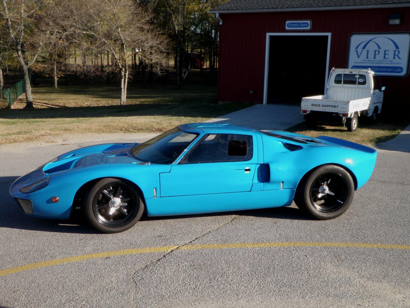

Man does that sound smooth. You did a great job of working out the bugs.Can't wait to see it on the road. Thanks for the post and keep up the good work.
