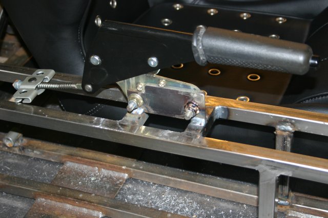

Hi James,
Hope all is well. Could you drop me a close up pic of your handbrake Handle mounting there ?
Also, You have places an extra cross member on your Roll hoopas oppsed to mine. Whats your thinking there ?
Thanks.
Nick.
Here you go Nick....
The handbrake is from an MGF and is pretty compact. It's got a switch on the other side for the brake light.

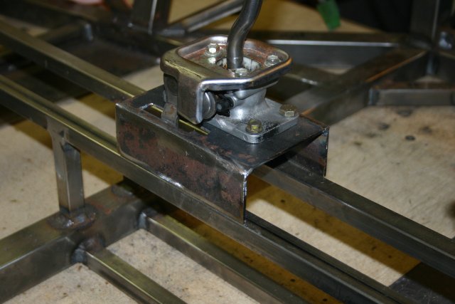

I've also made a start on the gear stick. Need to wait until I've sorted out the steering wheel position before welding it in place to ensure there's no interference.
Extra cross member - do you mean the horizontal box section below the lower round tube? That's just to position the threaded tube for the harness

Hi James,
Thanks for that, I've slung my hand brake so low that when its up, it'll certainly interfere with the main cooling pipes. I must have been half asleep that night.
Looking at your gear shift - I thought you were right hand drive, any reason for the centre shift ?
Ha, yep - doing everything at least twice means you get at least twice the fun :).
I've got an Audi 01E box which has the control on the left hand side, so cable shifters down the center looks like the simplest solution. I'm planning to use the space to the right of the driver (where the gear rods would have been) for some of the services - a/c, wiring loom, maybe brakes
Hey James, I'm trying to develop a centre shift for a tornado with Renault 013 box, what mechanism have you got planned for cabin and box ends of things. the shifter you have at present, what is that, MR2?
Hi James, wow that audi box is a beauty, I'm going to have to buy a sandblaster. many thanks for the pic links, that rear shifter mechanism is very neat. K

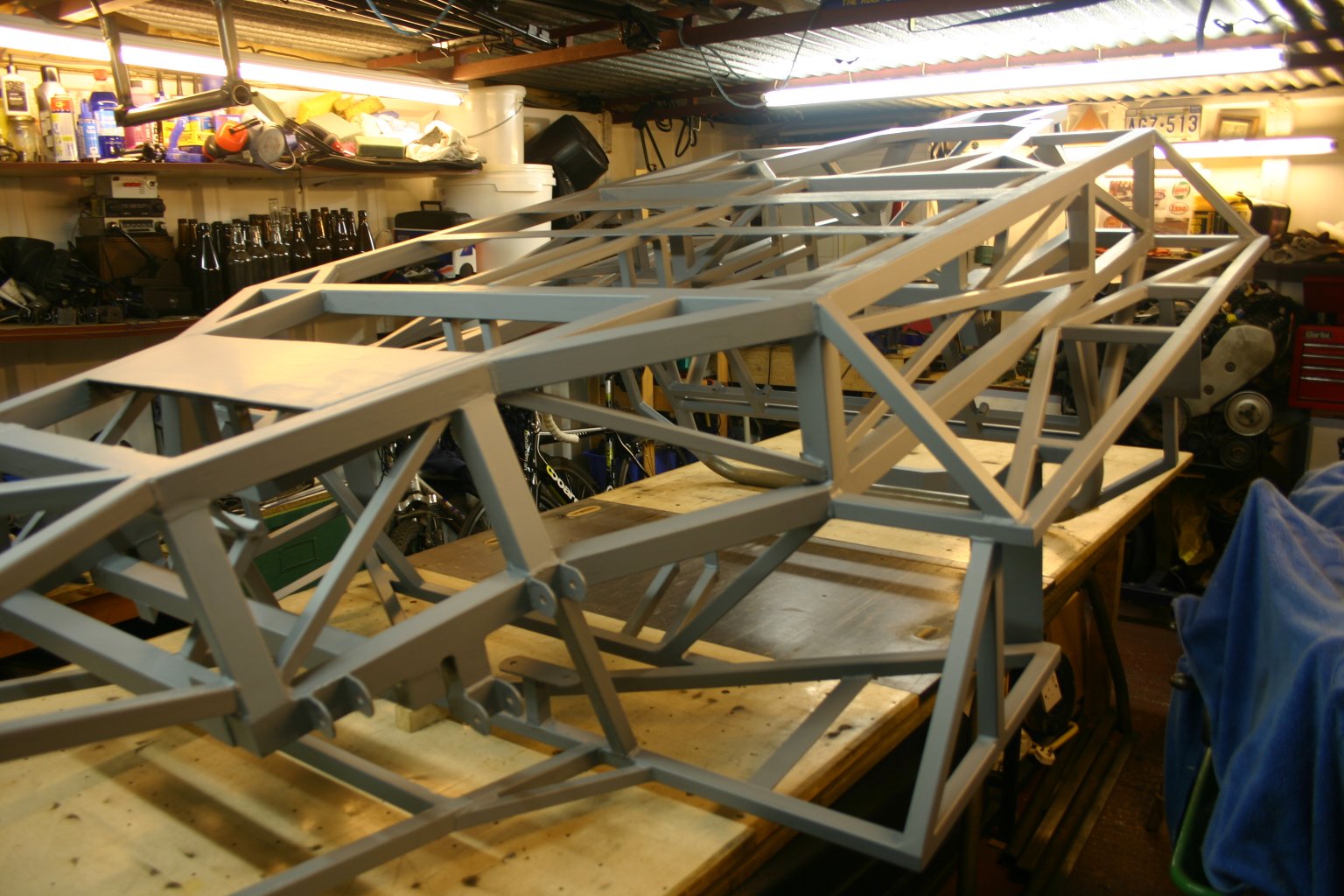

Got most of the first coat of zinc primer on...
Quite surprised how long it takes! File down weld splatter, wire wool clean, roughen up with sand paper, clean with white spirits, then paint. Just got sand, second primer coat, sand, first top coat, sand, second top coat. Turn over and repeat :).
Glad that I've got most of the bare metal covered now though as my garage has a metal roof which tends to attract condensation which then rains down...

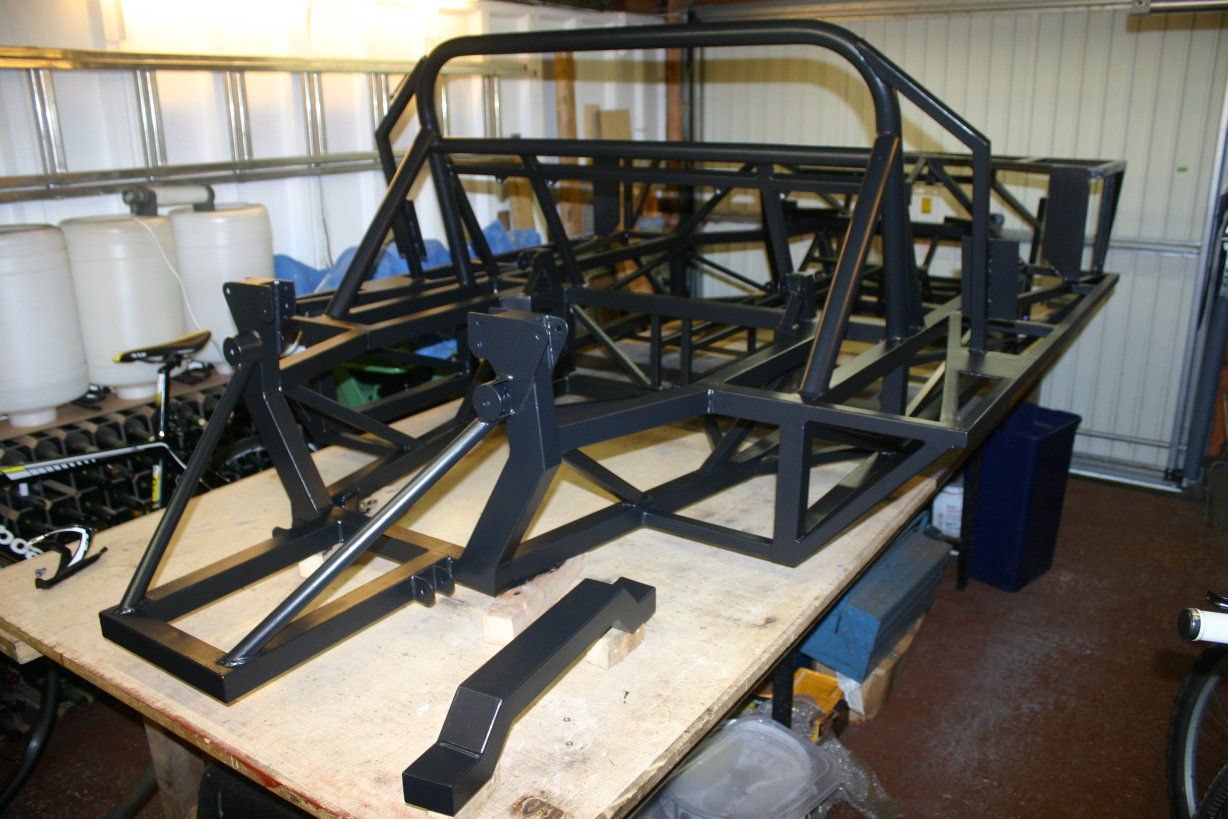

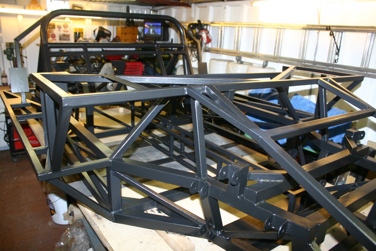

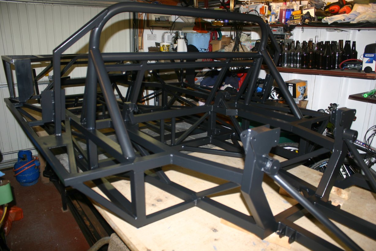

THE CHASSIS IS FINISHED!!!!!
Taken a bit of time, but finally got to this milestone. (The 4 coats of paint were especially tedious!)
But at last I can move on to the next stage :)
NickD
Great stuff James, Now it starts to get more expensive ;-(
