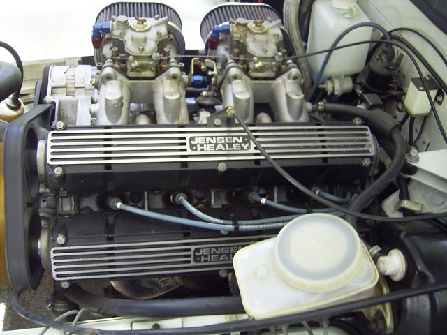

Ron,
Happy to hear all is well with you.....
A driveshaft faliure, the shaft is 'whipped' off center by its rotational speed and the torque being transmissed through it. Each shaft will have a (bitter...) sweet spot where any vibration is magnified to produce more vibration eventually causing the shaft to either snap (i've seen this on a 351 powered mustang, when the new owner decided to 'see what she would do..' the ends of the break in the driveshaft looked like a whipped ice cream). Or the shaft remains intact (sort off) and the vibration seeks a weaker spot than the shaft, in your case the u joint and gearbox. You would have been pushing relativly hard accelerating up the straight.. was it at high revs just before a gear change?
Rebuild her.... and maybe give her a new coloured dress to play in....
You will know its Silver Grey (GIP 26771/M)
...but tell her its really Sebring Silver (GIP 26771/M)
