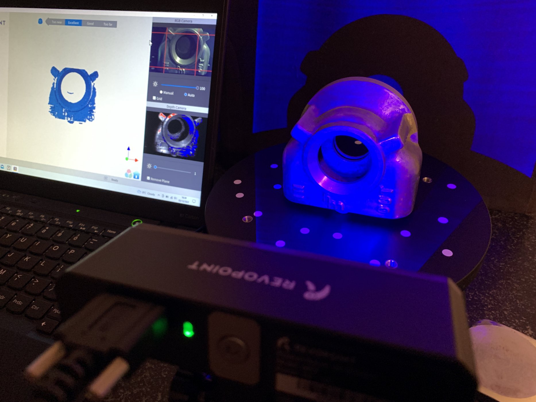

We already have an Einscan HX? blue light type - about the size of 90s mobile phone :) It's great for bigger stuff like a bellhousing or a wheel casting.
Today I got a little Revopoint MINI for smaller close up stuff. It is another much smaller blue light unit but claims to be more accurate, and also handheld. The package is delivered fully accessorised as a kit including an inclined rotary table and a steady hand tripod.

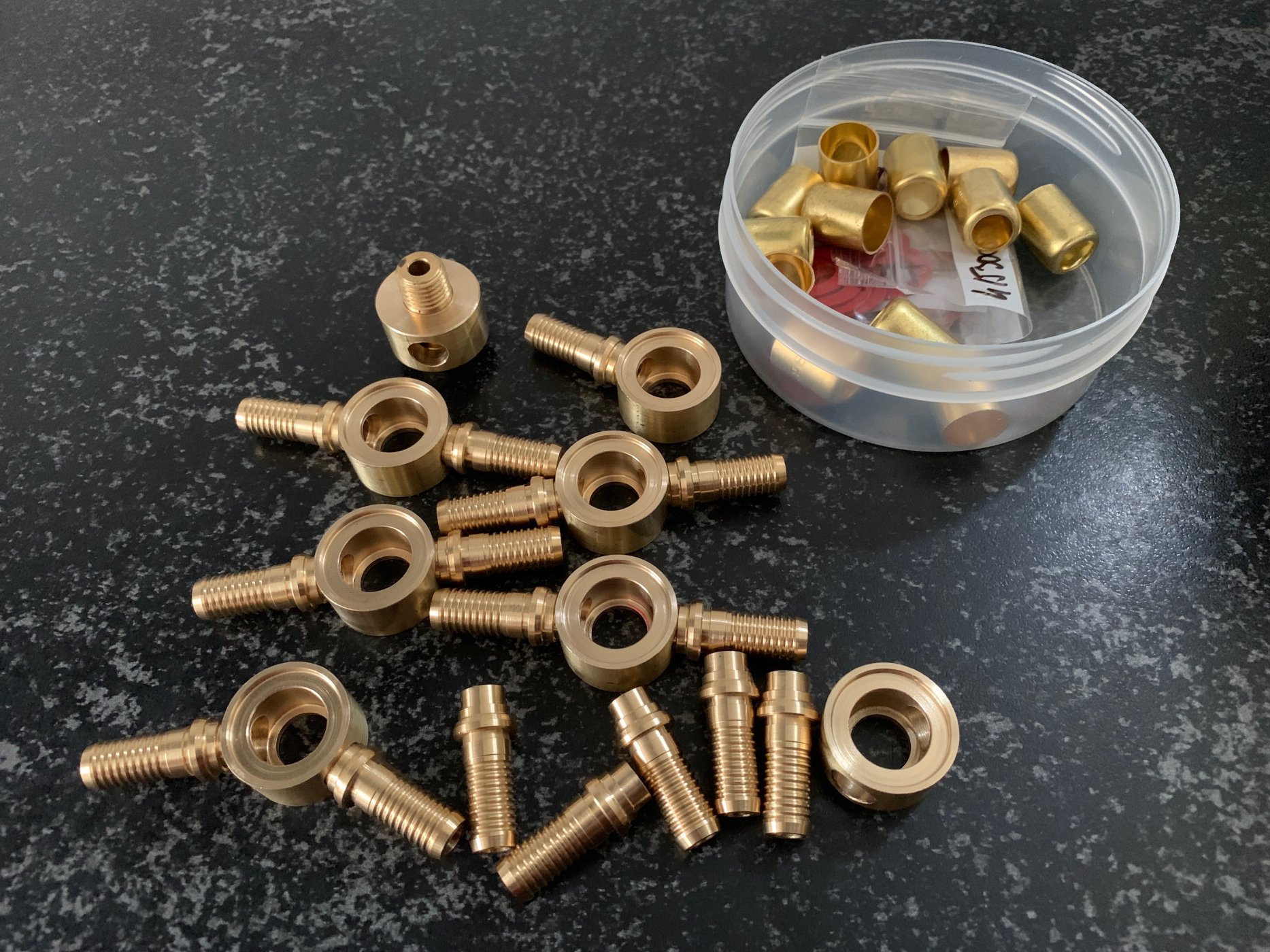

The unit is only about the size of my Leica camera and on my first venture without a micrometer I used one to make axis machining files for the barbs on these plumbing fittings.
The files for those plastic wiper parts have also gone for prototype printing.

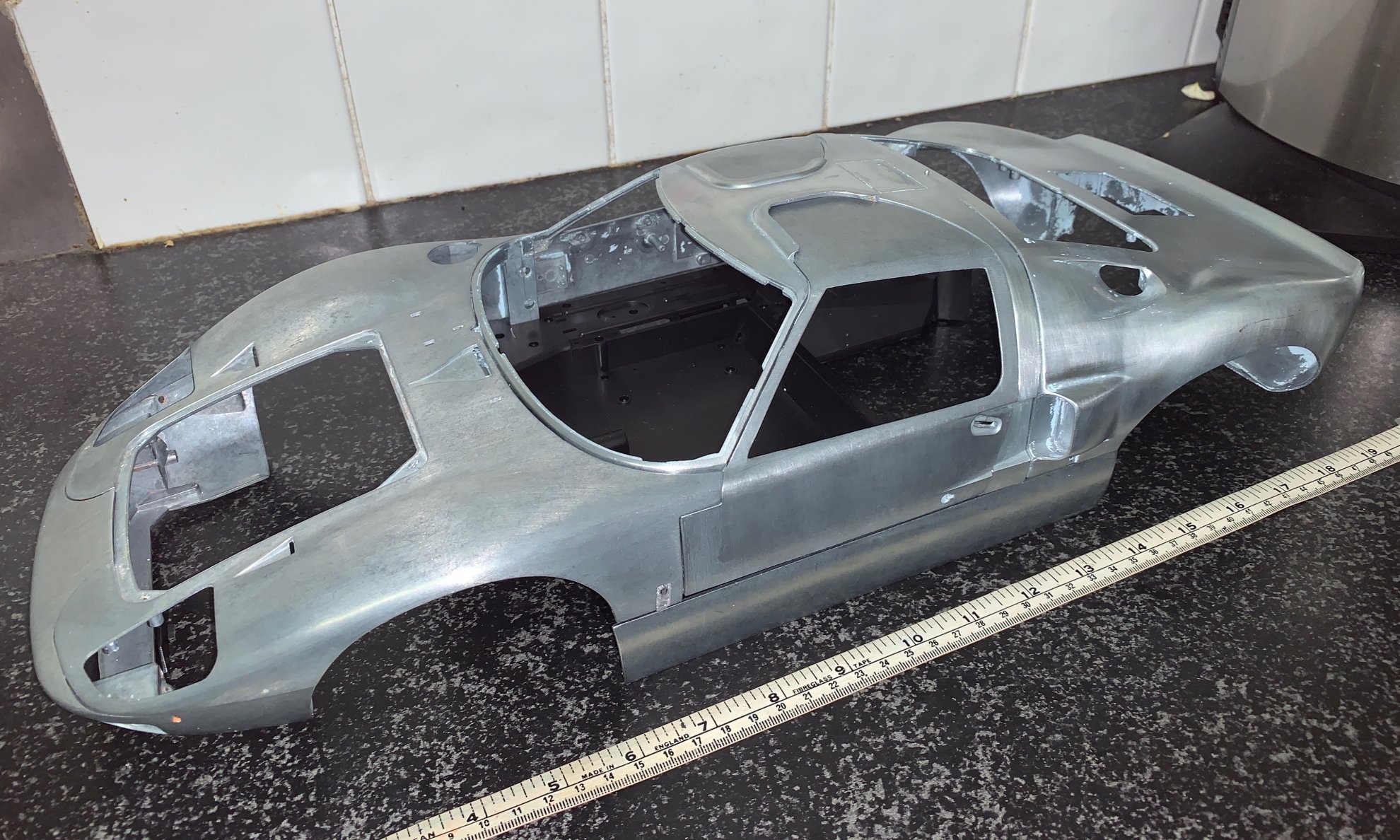

There is a lad up the road from me making a 1:8 model of my car using a metal body shell from the Dagistini GT40 kit as the basis. The rest is 3D work.

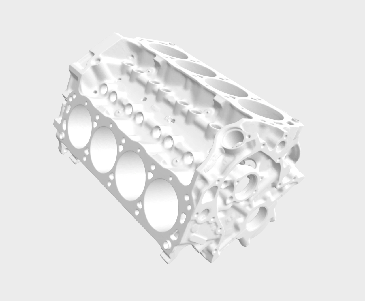

Ryan knows all about this stuff as he let me have a beautiful scan of his 302 short block recently.

Here is an appetiser for you, a screenshot from a digital file made by Ryan. I am having this file 3D printed in aluminium at 1/8th scale for the toy model.

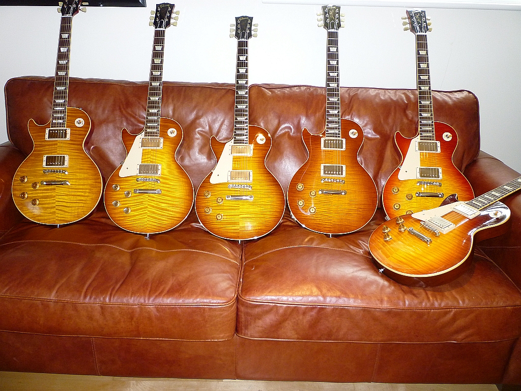

It is something so awesome when you don't remember how many Les Paul's you have. It's funny how so many of us are afflicted..... A distant friend has an old amp habit, I have an old guitar habit. One day we brought them mostly together:
The first, second, and fourth are actually 50's Gibsons. The left-most burst is a '21 and the next newest is from 92. This was a wonderful day!
Marvellous Chris !
How cool is that Gold Top Deluxe "with Firebird pups ??" - cant see the poles in them.
I do like the "63 335 dot Cherry with the smaller ears there on the right. I had to wait years to get a lefty one of those.
Amp wise I am not too fussy and I use a Denis Cornell Plexi most of the time but also have a little Fender Tweed Deluxe and a Mesa Subway Rocket.
Chris Kouba
Extremely well spotted James! That is my treasure- its a '52 GT which has been seriously reworked-pick ups, stop tail, shaved bridge, original neck angle, tuners, etc... Truly player's grade which made it affordable, but the pick ups absolutely sparkle with it and it plays fantastically. I absolutely love it.
The 335 was great too, but that one is Marcus' guitar. It was a fantastic day, there were no sour apples in the bushel!
We played through a number of amps, but the one we kept returning to was a 50's era Gibson, but I forget specifically which one at this point.
