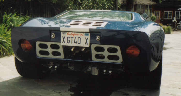

GT40 in BMW blue and white stripe and nose flare.
(Water under the car from the sprinklers - car has no leaks and it is easy to check on my auto lift)

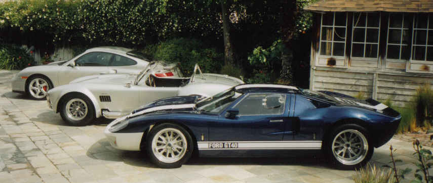

A side view of my CAV GT40 in good company with Cobra and Turbo Porsche.
John

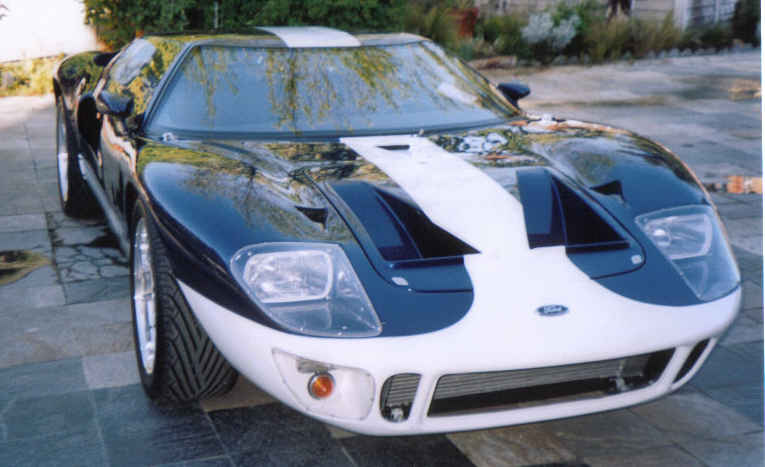

CAV GT40 Blue and white stripe stunner
Was surrounded today in shopping parking lot with guys requesting I wait while they went to fetch cameras.

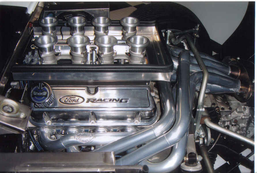

My GT40 is on the road and like a different car, in fact runs like the Ford GT.
All Aluminum Dart 427, AFR heads, SCAT Ultralight crankshaft, aluminum flywheel, SCAT H-beam conn rods, Accel/DFI distributor, producing 550 HP and 547 lbs-ft at 3,000 rpm.
Quietened cockpit sealing all joints and applying Dynamat heat seal, also double plexiglass rear and caulking compound. Stronger stub axles, drive flanges, drive shafts and CV joints and bolts.
Many other improvements along the way.
John
