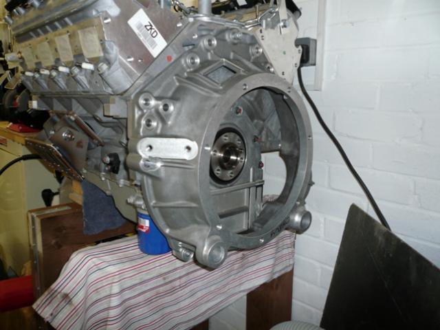

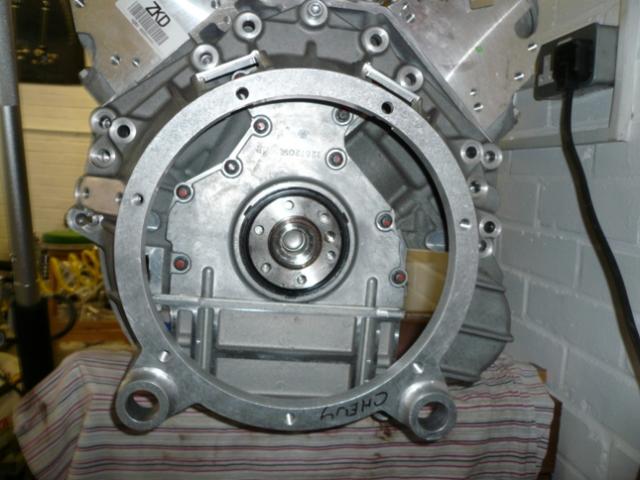

Offered up the Quaife ZF-Q bell housing to the LS7, slight fettling of one of the two holes for the location studs, took just a few minutes with a dremel (Actually it was a force fit as delivered but Mr Melia suggested I eased it just a tad:idea:) but for those of you looking to go down bowtie and Quaife route thought the pics might be of interest.

That block/bellhousing does not appear to have the chevy dowel holes drilled ( in the blank bosses between the two holes on each side ) The ford bolt & dowel pattern is drilled, not sure that the chevy dowel ones are. The seven bolts do NOT locate the housing.
If this is the case you will need to do a runout check on the bell housing register before drilling dowel holes.
Thanks for the interest. Dowel holes are pre drilled by Quaife. The bell housing is designed to fit either SB Ford or Chevy LS. I referred to them as location studs above.

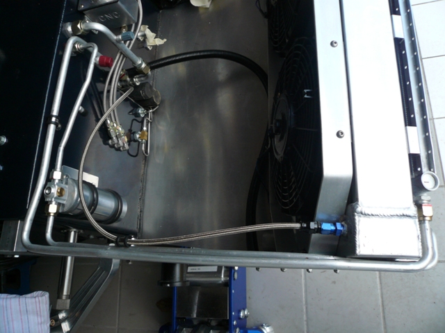

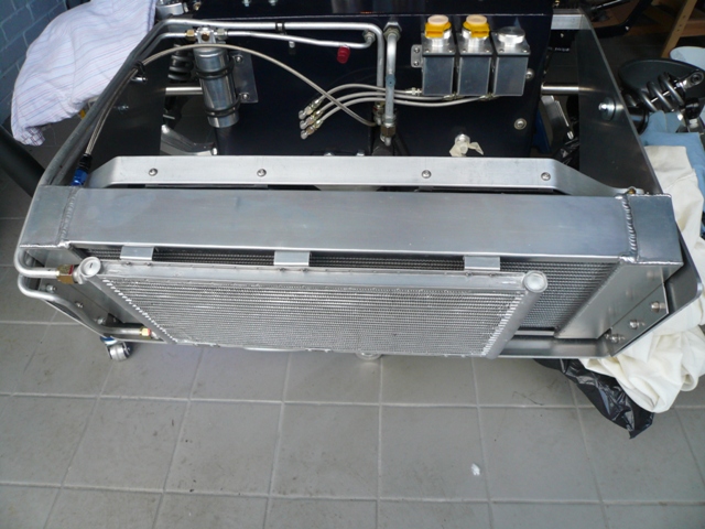

1. Connected up the brake/clutch reservoirs

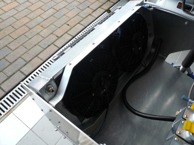

2. Installed radiator, bleed pipe to header, condenser, trinary tubes etc. Was going to shroud the rad etc but after polishing the fabricated fan mount, radiator top and condenser top decided I preferred the naked look.

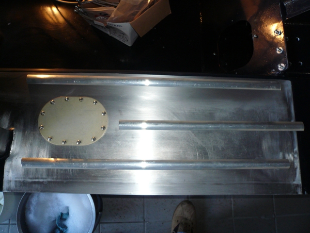

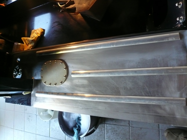

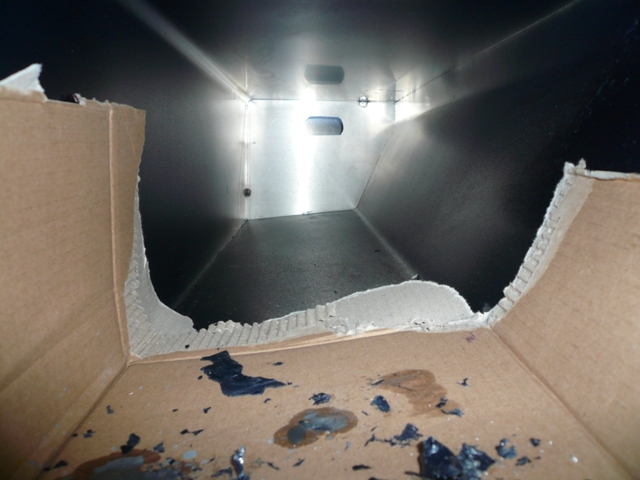

3. Removed powder coat from top of side sponsons (nearly finished) and trial laid out the feux fuel plate and mouldings (still need finishing at either end) prior to epoxy resin fix.
4. Cut out flow and return hole in the middle bulkhead and fuel filler hole and vent pipe hole prior to fitting the bag tanks. The fuel filler hole is slightly larger than it needs to be as I intend to inset the tank part way and then fit the rigid fuel senders through the hole before sliding (ready wired!) into final position. This was done because I didn't want to cut another large hole in the sponson immediately behind the scuttle weld point nor did I like the idea of significantly deforming the bags with a rigid sender in place when inserting them through the front cut out (which will be tight anyway)
Steps 3 and 4 are taking longer than I would have thought, especially cutting holes in the (very inaccessible) bulkhead, but almost there now and feeling rather pleased.

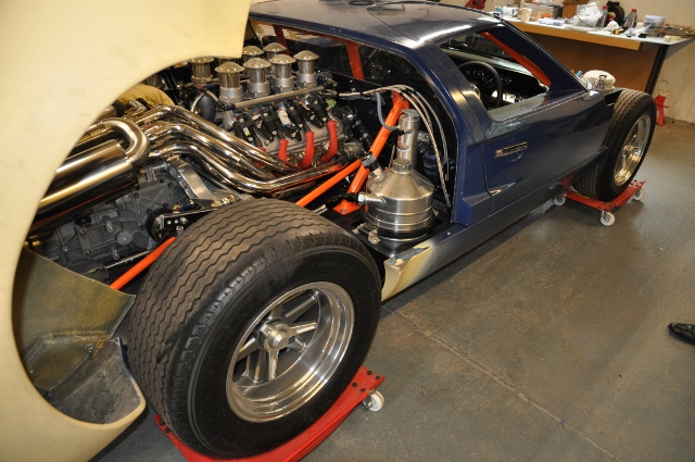

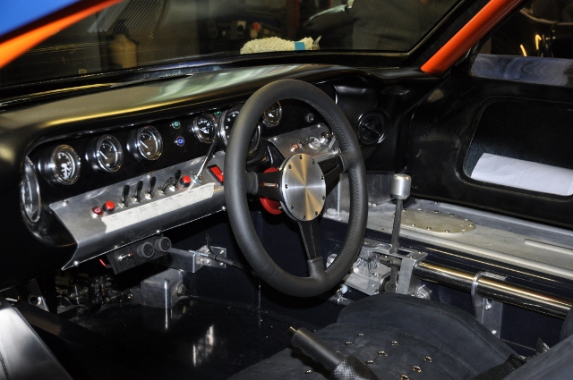

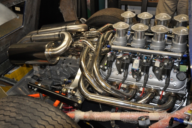

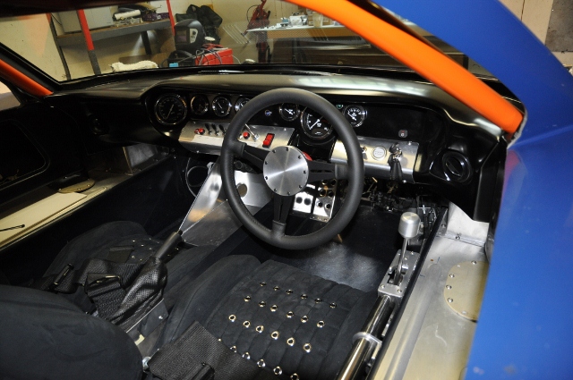

Nearly there, IVA end June, off to the painters (Gulf Colours) next week. Engine start up on the tube.
www.youtube.com/watch?v=Wh7-CmAXK_E&feature=youtu.be
Sounds glorious, unfortunately not really captured by the camera. Lightweight flywheel/clutch makes the Kinsler Stack LS7 very responsive, fired up on the button first time (wheezy noises due to air in pumps). Also some pics. Will post more detail post IVA
