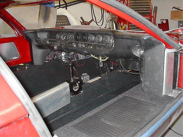

Time to post some updates. I got the carpets in a few weeks ago:

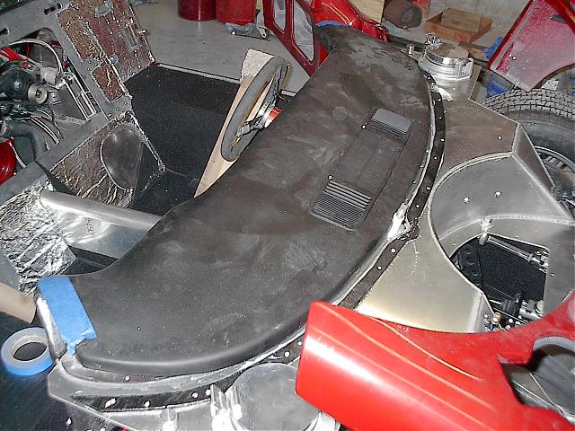

Over the weekend I permanently attatched the roof. I had to make a shim out of 1/4 inch plywood to get the roof to the height I wanted. You can see the shim in black in front of the dash.

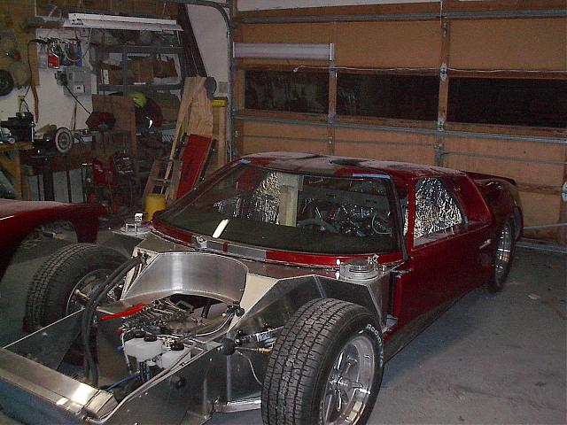

Today the glass guy mounted the windshield. I am happy with the results. It took them over two hours. They had to grind down a few spots to get it to fit right. The extra time paid off in the results:

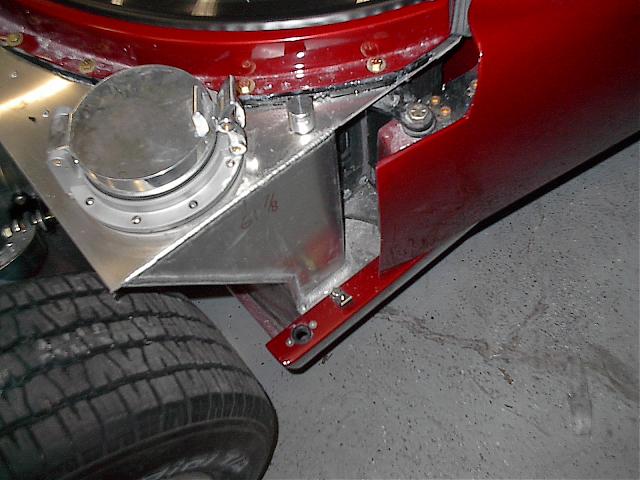

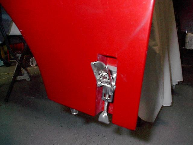

I also got the body latches mounted over the weekend. Who would have thought that it would take an entire day to mount them. I had to weld a 90 degree braket to the J hooks on the body and weld an extension on the latch side hook to make them longer.

Jonathan the car is looking fantastic i love the colour. can you tell me were you got the little breathers on the picture of your fuel caps small round alloy breather? how long do you think it will be befor your all done and dusted?
