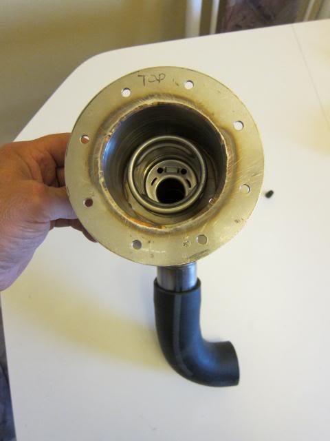

Ken Roberts

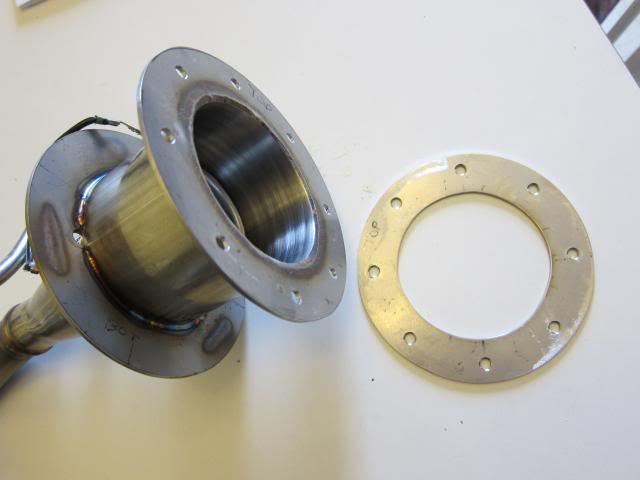

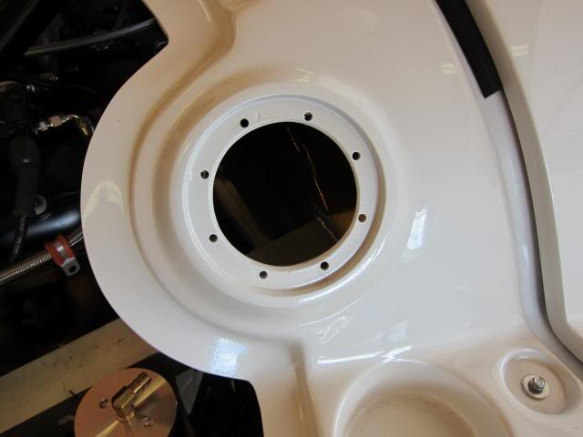

Two of the 4 3/4" discs with 3" holes Need to have the 8 small holes cut in them around their circumference to match the pattern of the Sparco fuel filler. I already drilled the holes in my bodywork for the Sparco so I had to reproduce this pattern on my Corvette style of fuel filler.

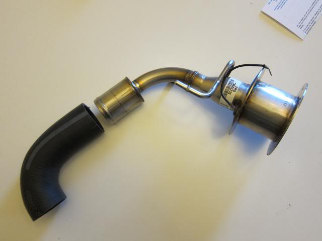

Ken Roberts

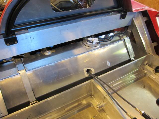

The Gates #24717 fuel fill hose (90 degree) gets cut to fit. It fits between the 2" intercooler pipe and the 2" outlet on the tank.

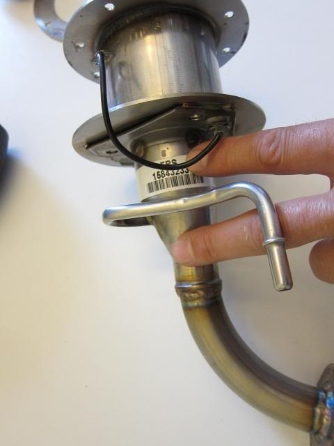

Ken Roberts
The C6 Corvette fuel filler is the actual part I'm touching with my two fingers. The rest of the assembly is what needs to be made.

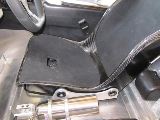

Ken Roberts
Mounted the Safecraft Halon fire extinguisher and billet mount. These are popular with the Ford GT owners.

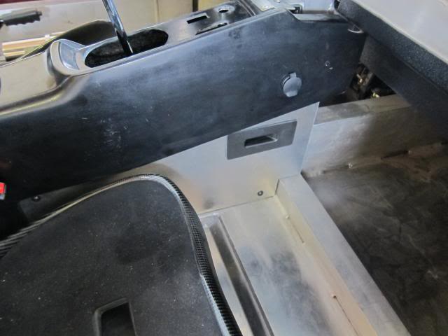

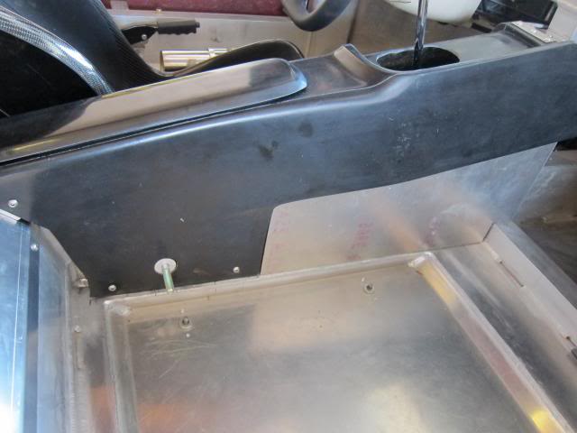

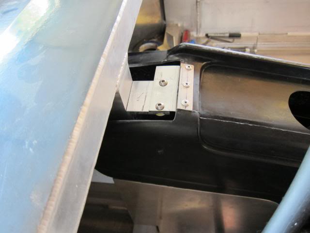

Worked on mounting the seat belts and center console the last couple of days. Here are a few pictures of the center console.
First two pictures show the "close off" panels I made to complete the sides of the console. The middle picture shows the 12v power outlet and the Corvette fob slot in case the batteries are depleted. Don't make close off panels till you determine if the seat sides will clear. The third picture shows how I secured the console at the front top.

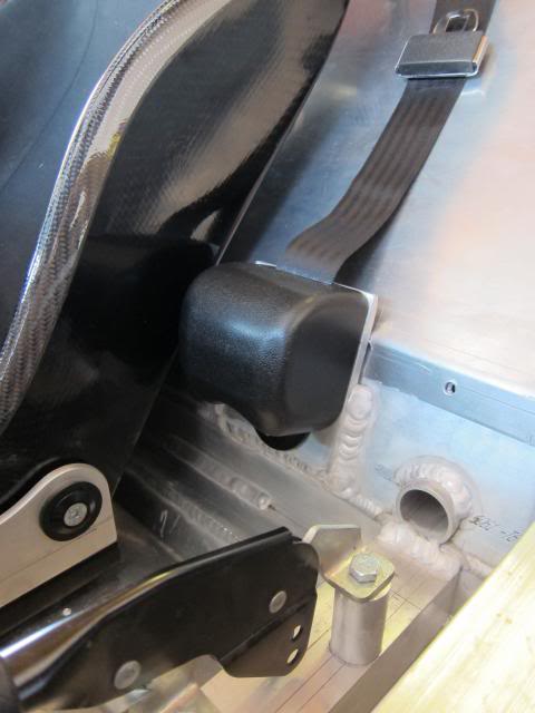

The seat belt receivers turned out great. I welded a 1 1/4" round bar 6" long (with a hole in the middle for a 6" long 7/16" grade 8 bolt) to the center tunnel beam. The seat belts are a three point standard automotive type. They were purchased from Wesco Performance.
The retractor gets bolted to a plate I had welded to the beam behind the seats. A hardened steel insert (Gardsert) was installed for longevity.

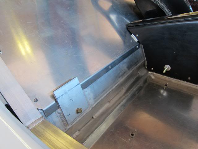

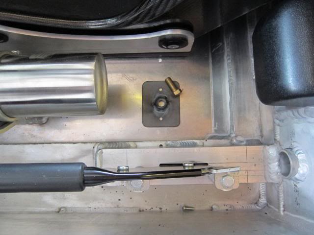

This picture shows the floor mounting anchor for the seat belt at the side of the seat. The plate with a grade 8 nut welded on gets mounted to the bottom of the floor. I still need to sit in the seat and replicate the ideal positioning of the seat belt across my hips before I decide where to drill the hole through the floor for this anchor.

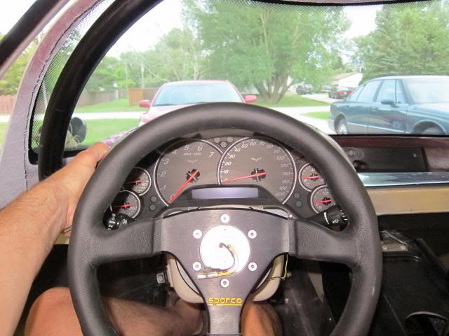

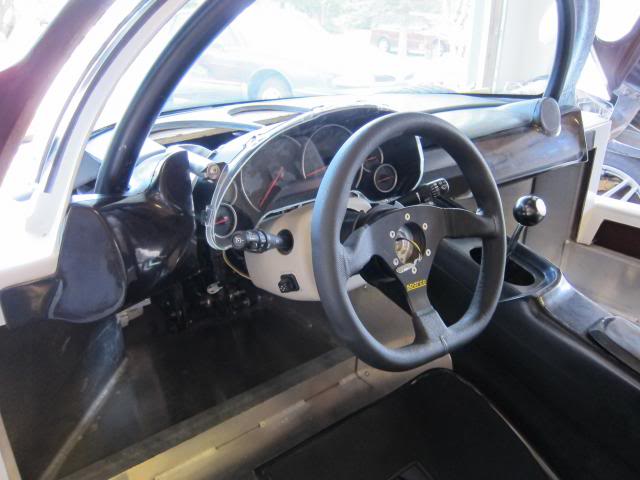

Ken Roberts

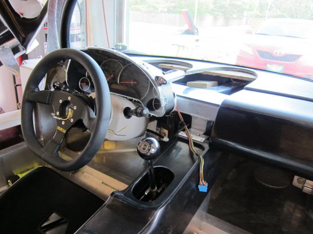

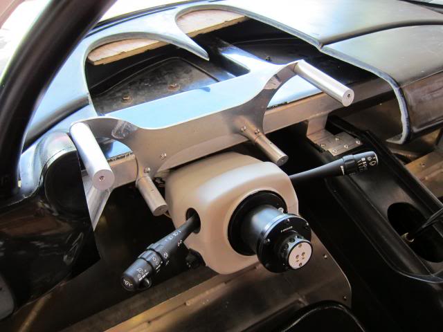

Starting to work on converting the dash to house a C6 Corvette cluster. I'll start cutting up the stock dash tomorrow. I ended up switching to a 350mm wheel to get a slightly better sweep of all the gauges. The picture shows the smaller 330mm wheel. The 350mm wheel will also give you an easier time when turning at slow speeds.
