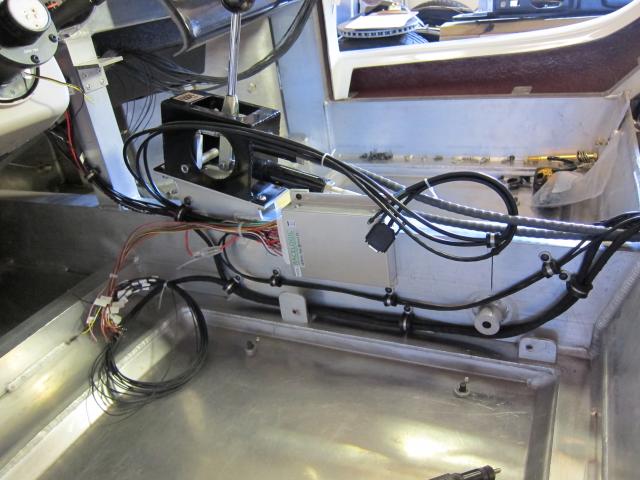

Here is a picture of the Racelogic traction control box mounted to the center spine. All of the cars low current/sensor wiring runs along the center spine. The High current battery feed and ground wires will be the only wiring run along the outside of the frame on the drivers side.

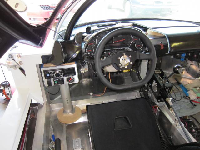

Ken Roberts
I'm getting ready to finish the wiring and need to mock up the media player, fuel pressure gauge and rampro lift switch. Here is where I'd like to mount it. The tubing is just used to hold it up in place temporarily. It will be bolted up in place tomorrow. Please critique my idea before I commit to final assembly.
If you are using the optional door crash bars than this will not work. Also if you are heavier and have thick legs it might not be advisable.

I would be concerned that you will be banging your knee on that at egress. Sorry, I think that location will be a serious pain.
I too think that will be a bad location - my rear view camera is around the same area, but more angled, and I find it a SOB and keep whacking it. If I'd have it positioned like that i'd have destroyed it by now
Howard Jones
That looks like it would take your knee cap right off in a shunt. I would move all that stuff up onto the dash board. You look like you are making extensive changes to it anyway, what's one more.
Thanks for all the comments. I've abandoned that idea now. Probably not the safest area to use.
Ken - good move. I can tell you that you need that area to swing your legs-feet when you get in and out.

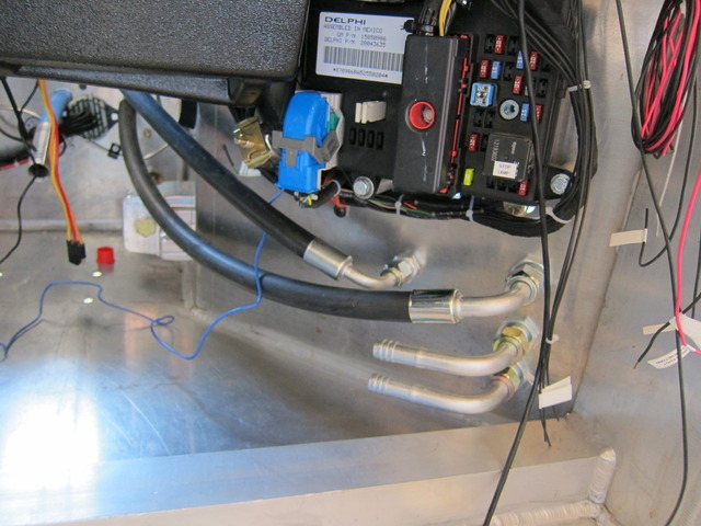

Ken Roberts
I cut out an area in the front of the dash for the Corvette A/C module. The module will control when to disengage the a/c under full throttle or maximum rpm so it doesn't throw the belt or damage the sanden compressor. It will also turn on the cooling fan when appropriate. Unfortunately it will only work in "manual mode" as I was unable to install all of the needed items.

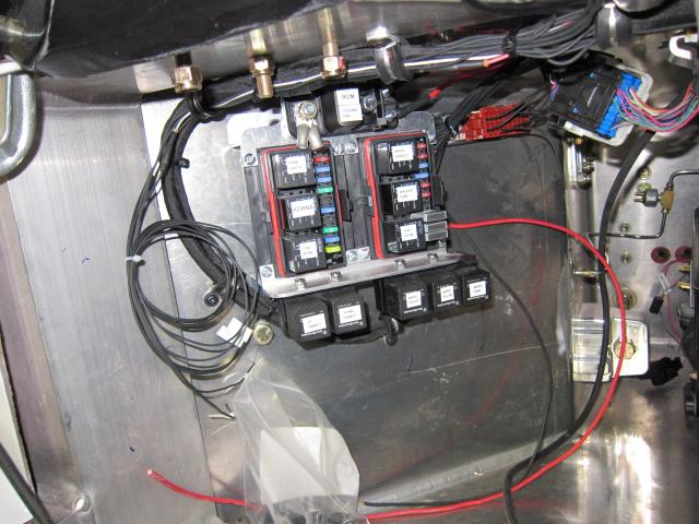

Ken Roberts
I finally finished the wiring of the home made fuse panel and Corvette body control module.

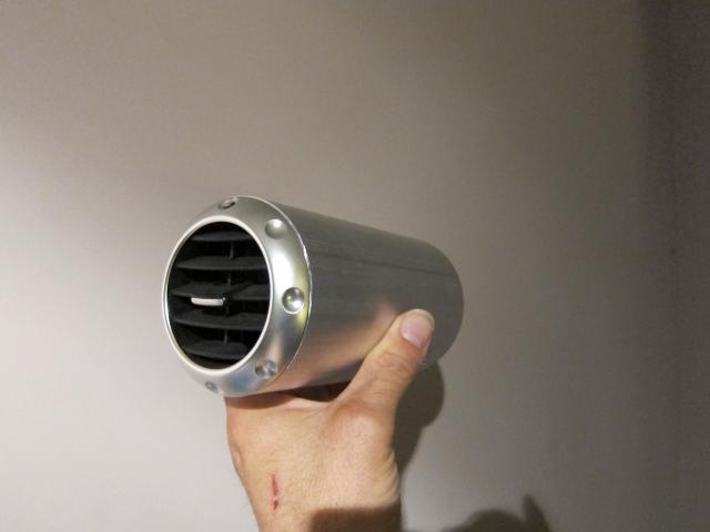

Ken Roberts
It looks like I won't be putting in a stereo after all. I'm just not happy with where to mount the head unit. The amplifier can easily fit directly below the dash but the head unit looks too awkward where ever I try to mount it. I want to keep the area to the right of the dash as simple as possible. The only items going in that location are the a/c vents. Here is a picture of one of the Audi TT vents installed in a tube. They are rather large and I might not be able to make them look good. I'm always up for the challenge though. :thumbsup:
No way! I was waiting to see it all together. Why don't you just kill the head unit? You could use a car PC, mp3, ipod, etc...I'm using a permanently installed iPhone for my radio/nav. JL sells a nice interface/preamp module with volume controls. I'll probably put in a DAC too just to clean up the audio.

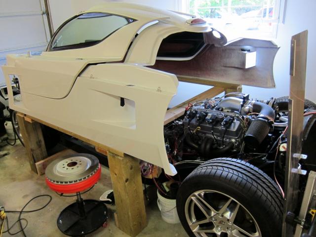

Ken Roberts
I took the body off the chassis hopefully for the last time. I made a stand for it located over top of my Corvette rolling chassis.

Yos are you saying I can simply use a ipod for my music and a interface/preamp module and then to my outboard amp? Can you give me a link to such an interface? :idea:

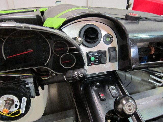

I think you're going to be happy with the RaceLogic TC. Did you also get the digital adjuster.
Sorry I missed this question Mike. I didn't use a digital adjuster. I mounted the control for it in the center console.
