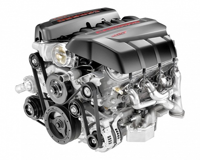

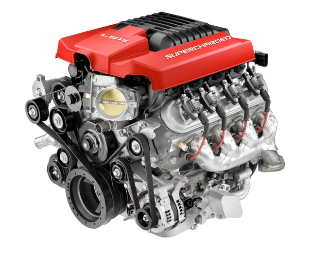

I recently found a alternative/cheap GM made power steering delete bracket and pulley system. This type of bracket/pulley bolts to the front of the drivers side cylinder head. GM used these parts on the 2014 Camaro LSA engine and Camaro Z28 LS7 engine. These cars had electrically assisted power steering (EPS) and didn't come with a traditional engine mounted PS pump. They both have the same belt wrap (distance to block) as the Corvette.
Here are the part numbers:
bracket-#12641124
pulley-12629519
bolts-11518633 (3 required)

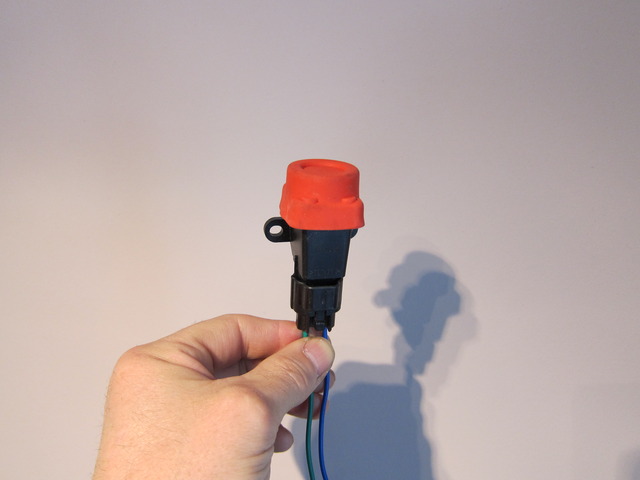

I decided to add a fuel pump inertia switch. This will be installed close to the drivers seat . It gets connected to the ground side of the fuel pump relay. I chose this model due to it being used extensively by OEM manufacturers. They cost around $50 to $75. Here are some part numbers for it:
AC Delco- #D1876D
Standard Motor Products-#FV-7

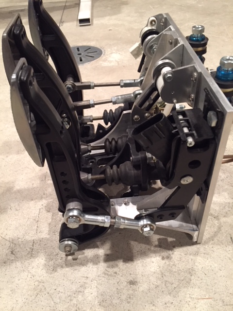

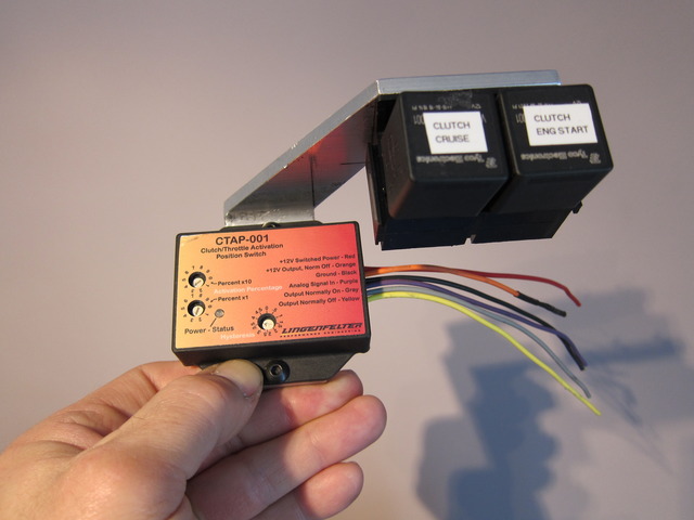

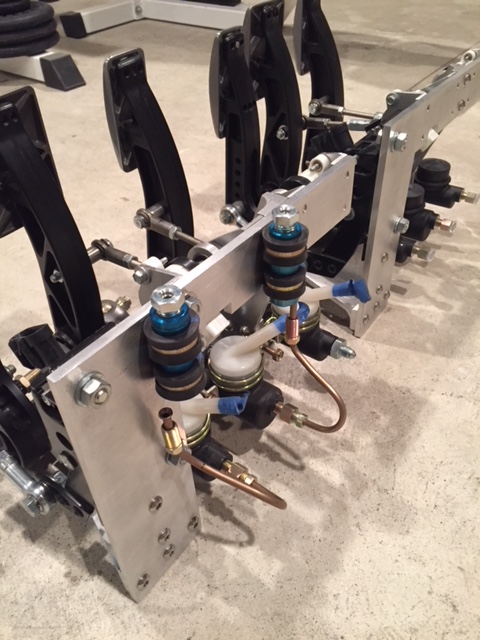

I finished the final version of the pedal assembly. I added a second rheostat. This one is mounted to the clutch pedal. This one will control the clutch switch (engine start) and cruise (disengagement).
The second picture shows the Lingenfelter CTAP-001 box. It learns the voltage swing from the rheostat (0 to 5volt range) when you press the pedal and then allows you to program in where in the arc you want the switches to activate. The engine start switch is "normally open" and the cruise disengagement is "normally closed". Both types of switching are available with this unit. The switching is done with the relays I have mounted next to it.
This box can also be used for the throttle position. It could be used to disengage the A/C under full throttle or to activate/deactivate a nitrous system.

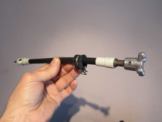

With safety in mind I elected to completely remove both the tilt and telescopic motors from the steering column. The telescopic motor is useless in my opinion anyways. The steering wheel needs to be completely extended in order for the tilt function to work. This is the only position that will allow the wheel to tilt without obstruction (at least in my build).
The picture in this post shows how I can still use the tilt feature manually. The telescopic feature was locked out with the use of a threaded rod. It was carefully designed though so that the column can still collapse as designed in a collision. I modified the cable to include the use of a wheel at the end so I can adjust the position manually. The cable can now be positioned high and away from your feet. I bought a small aluminum wheel from McMaster Carr and tapped/threaded two set screws in the sides of it. Here is the part number for it:
#6047K12 McMaster-Carr

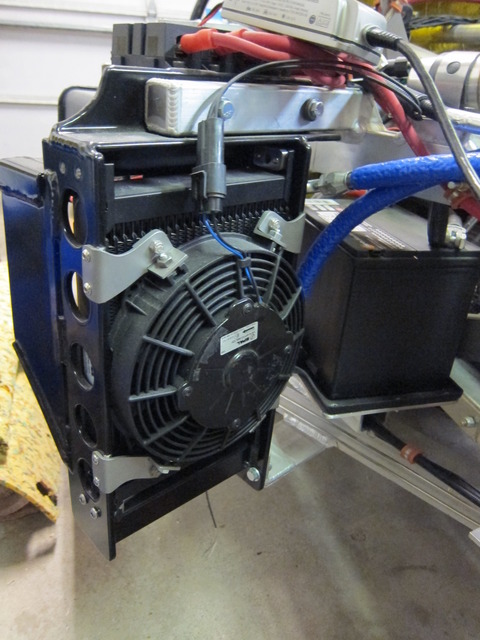

Two additions to the Ricardo transaxle oil cooler install are in final design currently. The first picture shows the Spal fan that will be installed behind the Setrab 625 oil cooler. The second picture shows the Improved Racing model #FSM-165 thermostat that will be installed in the circuit to prevent oil from reaching the cooler until the designed 165 oil temperature is exceeded.

Ken... Everything you do is nothing but first class. Could you post some more pics of your sweet peddle assembly. Maybe form a couple more angles. That is a really nice job and I look forward to the rest of your build. Thanks for all post. Once again nice job Sir....:thumbsup:
Ditto...
Ken- your mods are very well thought out and executed. Thanks for sharing.
Ken Roberts

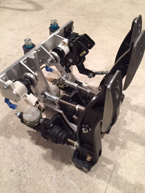

Thanks for the kind words Joe and Ricardo. Here are a few extra shots of the pedal assembly. I kept adding on to it in stages until I was satisfied with it's strength to weight ratio. I want consistent voltage readings. Corvette, CTS V and Camaros use these rheostat type of switches. The clutch rheostat reads the opposite of the brake rheostat. One has a rising voltage signal while the other has a falling voltage signal.
