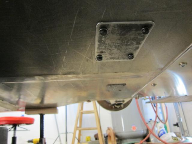

This weekend I made a footrest for the passenger. It bolts to the floor from underneath.

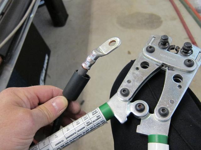

I have been playing around with different crimping and soldering techniques for the main power and ground cable lugs. I just wasn't happy with the soldering methods. I bit the bullet and bought a professional style crimper that swags the lug on. It takes a bit of practise to perfect the technique. I purchased a few extra lugs to practise with.

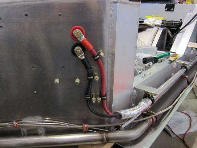

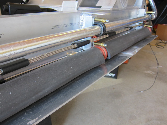

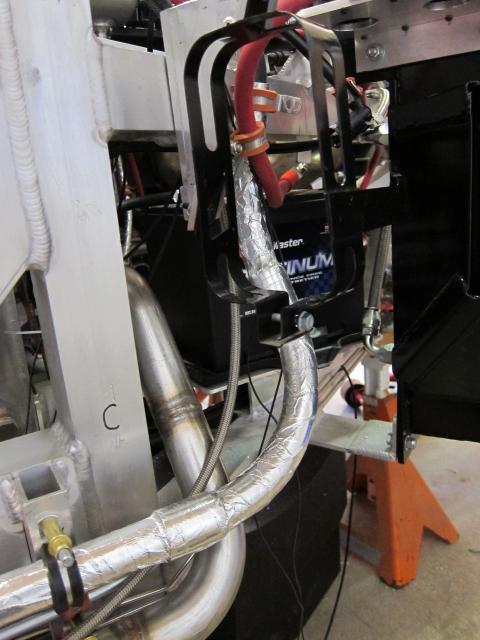

In the third picture of the last post you can see how I ran the power and ground cables to the front. I used a 3/4" plastic electrical conduit with two 45 and one 90 degree elbows. I than covered the conduit in heat tape.

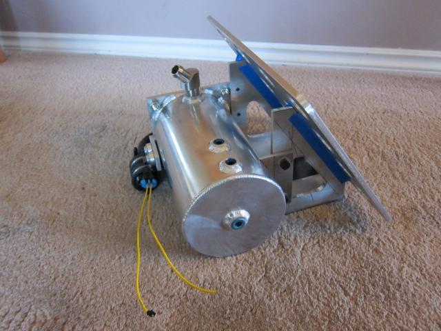

The windshield washer tank mystery was finally solved after mocking up the passenger footrest. I decided to mount the tank/pump to the back of the footrest. The first picture shows me pointing to the fill tank. The second picture shows the hose path into the foot well. The third picture is the main tank bolted to the back of the footrest. In total it should hold at least 4 liters of fluid. Servicing/replacing the pump will be fairly easy. Just unbolt the footrest from underneath the car (fourth picture) and slide the assembly out.

Hey Ken, what is the advantage to running ground cables rather than letting the chassis be common ground? Nice crimper by the way!
Ken Roberts
I didn't want any galvanic corrosion interfering with the connections. It's more expensive. heavier and time consuming though.
I purchased the crimper used from ebay. Still cost almost $200....yikes
