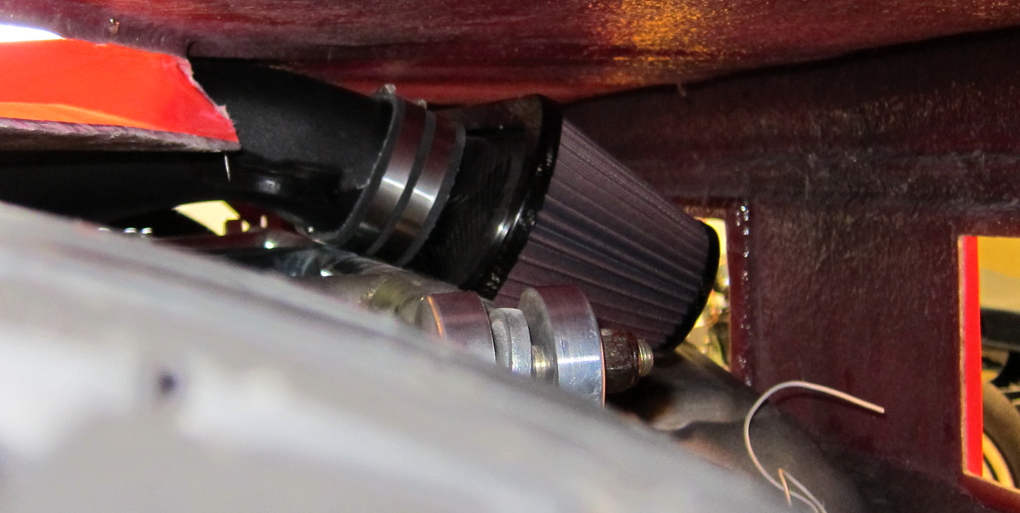

Here is a picture of the modified C6 Corvette K&N filter assembly installed with the hood down. It does fit but just barely.

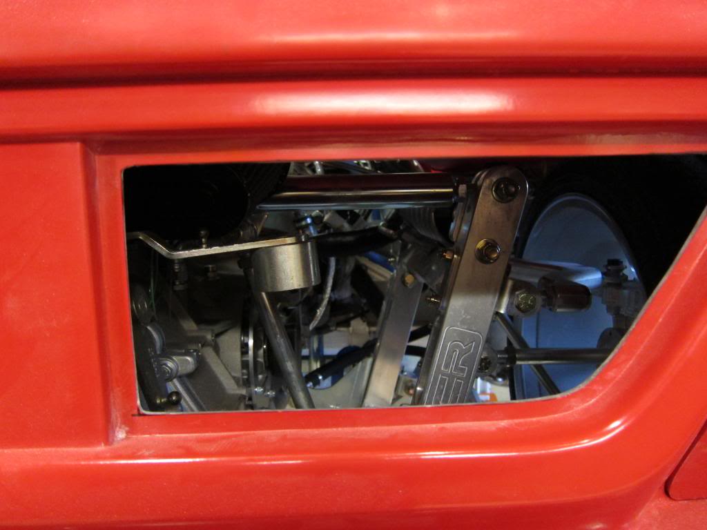

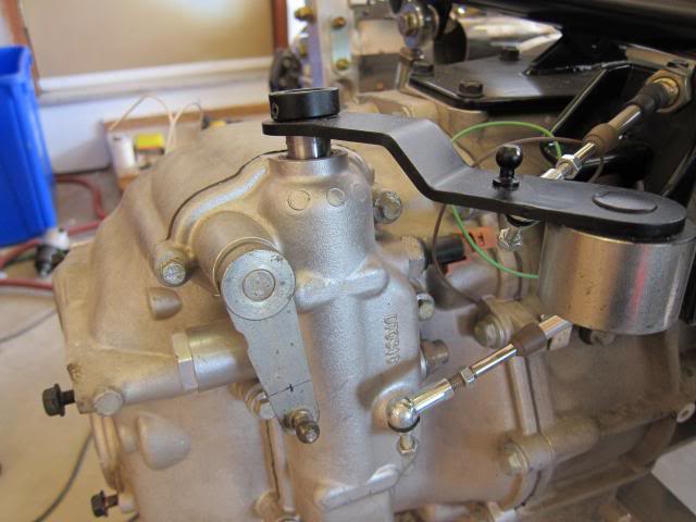

I plan to put the exhaust straight out the back but heres the first problem. Can I cut the weight off the Ricardo horizontal shift arm to gain clearance for the muffler? I assume it's just there to give a more solid/smooth shift feel.
UPDATE- the weight was relocated in board on the shaft to give clearance for the right side muffler.

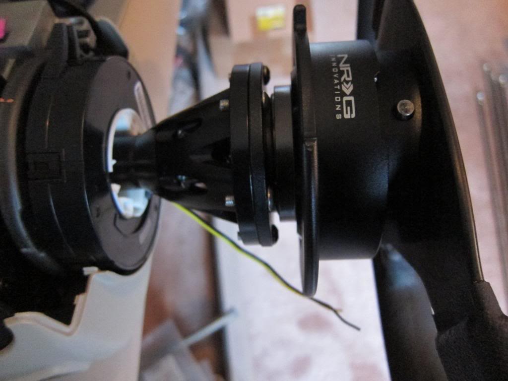

Here is a mock up of the steering wheel, NRG quick connect and Pfadt hub.
The black and yellow wires are for the horn. This style of quick connect (NRG) has two pins that allow the horn button to function in the center of the wheel.
UPDATE-the Paft hubs are no longer available. Mine was removed later on and replaced with the new NRG hub that came out for the C6 Corvette/XLR columns.

Ken,
how much longer, if any is this adapter/release than the stock bolt on wheel or the one that we provide.?
I have a few customers that are looking to use OEM style steering wheels with a horn.
Ken Roberts
The NRG quick release and Pfadt adapter combined is about 5" long (2 1/2" for the NRG and 2 1/2" for the Pfadt adapter). Your quick release is 4 1/8" (assuming you mount it in as far as it can be welded to the stub shaft). My Sparco wheel doesn't have much of a dish. Your Grant GT wheel has more of a dish. In the end they are even in total distance from wheel to steering column.
The NRG quick release is available in a shorter version as well.Thin Version | NRG Innovations
Mine is model 2.5

Nice find, I would think everyone with a street build would want a horn button in the middle of the wheel option. Will it work with the RCR wheel spline or will I need to cut off the original welded on RCR quick release spline to make it work?
Rob
PS Come to think of it I don't have the black housing (shown in your pictures) encasing the white "trip" ring as the outer most assembly on the steering shaft.
Ken Roberts
Mesa the outer most assembly (black plastic thing) on the steering shaft is known as the "clock spring". It is required for any electrical features used on the steering wheel.
The RCR supplied quick release does not have the ability to provide electrical connections. Hopefully if you do cut off the welded on portion of the RCR quick release the factory splines and nut threads are still intact. All the newer cars came without this RCR spline welded on.

Thanks for the explanation Ken. I had always wondered when reading other people reference such things what relayed the electrical to the steering wheel. My car did not come with this black plastic ''clock ring". Had no idea something was missing until your post. Since I am already too far down the road to make this conversion I will have to figure some other way.
Nice bit of info for the rest of us, regardless :)
I'm a little in the dark here so forgive my uneducated question. . .
It most other car use cases, the NRG adapter connects directly to the spline, no? Why is that not the case on the column we get from RCR? Several of the GTM guys have used these adapters and although its probably from a C5, they're using a corvette column. I too would like the horn on the wheel.
If you guys want to use the horn on the wheel why not use the supplied steering wheel? The ones Fran sent me had that.
Comes with the button, yes. But making that work with a QR is the issue, unless you want to disconnect/reconnect a wire every time you disconnect/connect the wheel. The NRG adapter takes care of that for you.
