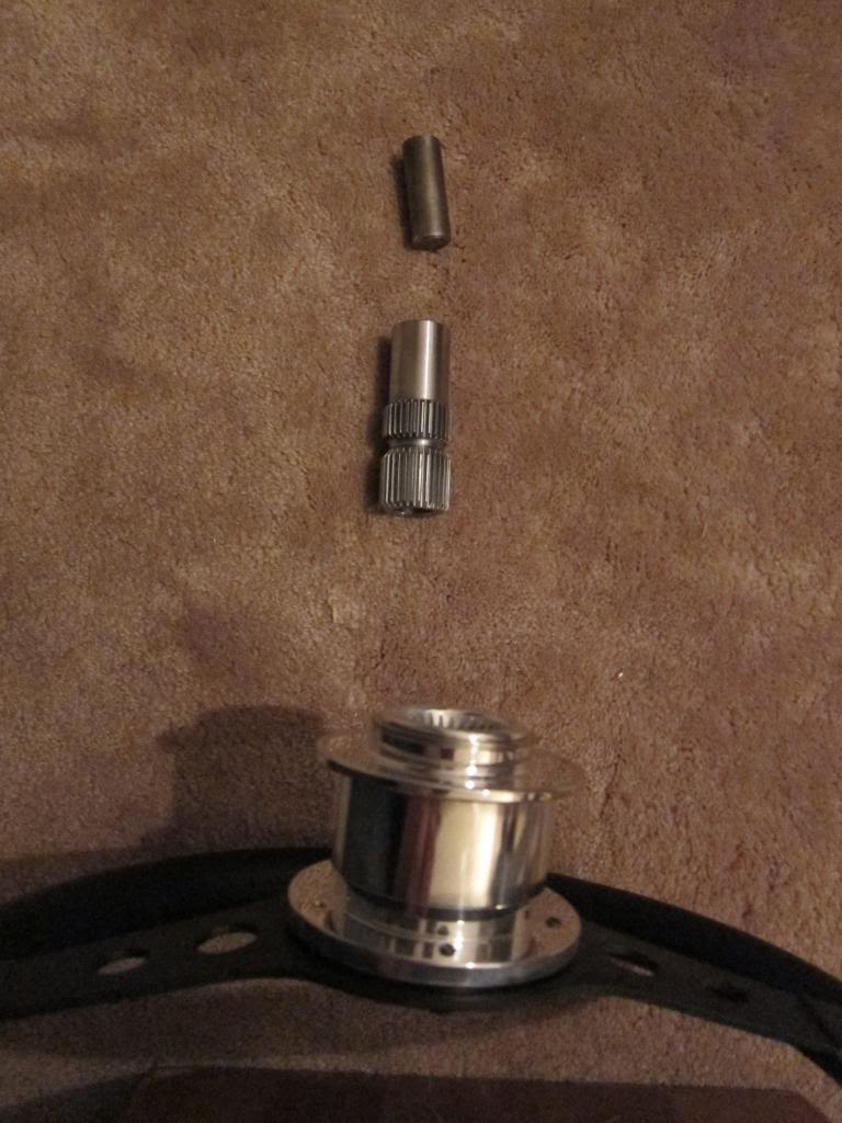

Here is the RCR supplied quick connect.
The cylindrical portion at the top of the picture threads onto the steering column shaft.
The portion in the middle with the male splines slides over the cylindrical portion and then gets welded.
This now combined piece slides into the female splines of the bottom portion attached to the wheel.
You can keep the RCR quick connect and purchase a thin adapter that will bolt to the end of the quick connect which will convert it from a 5 bolt pattern to a 6 bolt pattern if you don't care for the RCR "Grant GT" wheel.
If you want the horn button to function in the center of the wheel then you can't use the supplied RCR quick connect.

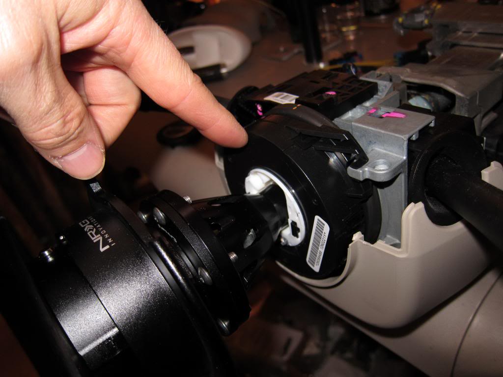

My finger is pointing to the "clock spring". This is needed if you want to use any steering wheel mounted electrical switches/controls including the horn button.
The GM part number for the clock spring is #89060610. You can get it for about $123 if you happen to have a XLR column without it.

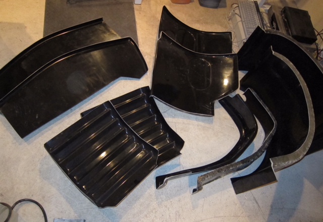

Here is a picture of the wheel tub kit that i received. I don't know if this is complete or not but it gives you a good idea of what is included.
The louvered looking pieces go in front of the rear tires. What do all the other pieces do, and where do they go?

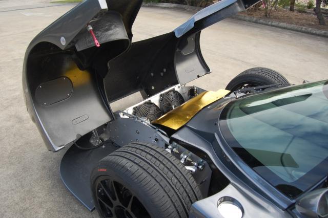

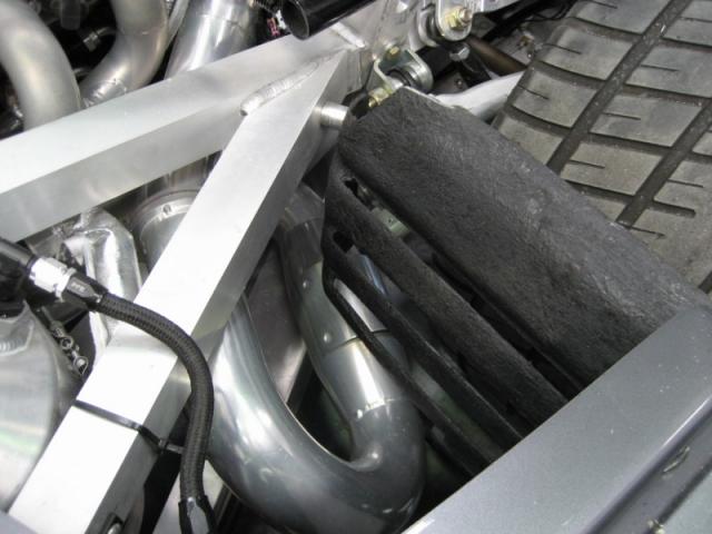

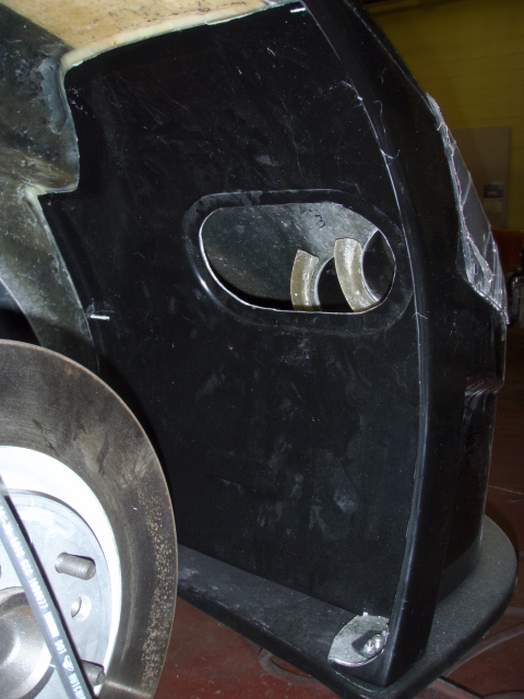

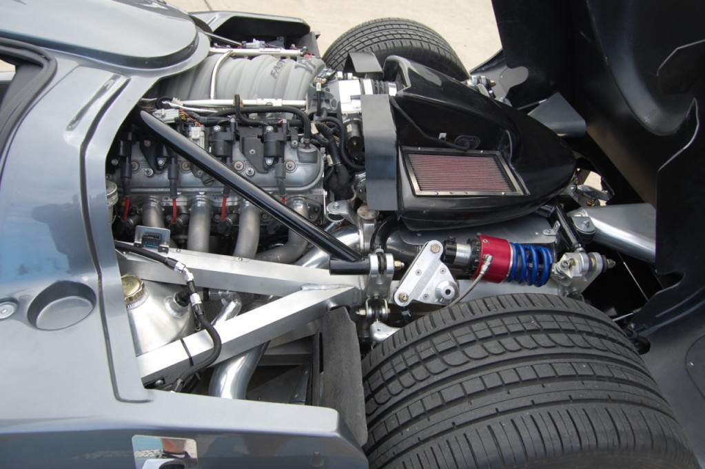

May shed some light on where some of the parts go, however, not too sure if these are the same exact pieces that are still used.

Dave those pic's helped a lot. The arc'd pieces in the front clip, I never thought to turn them sideways Now I see how they work, Thank you.

I want to hinge my fron clip as well. Could you provide details/PICs of your hinge assy.
I'm interested too. Maybe we could get a group buy going for the hinge assembly.
I don't think that is Dave's car though. It's right hand drive. Most likely Australian.
