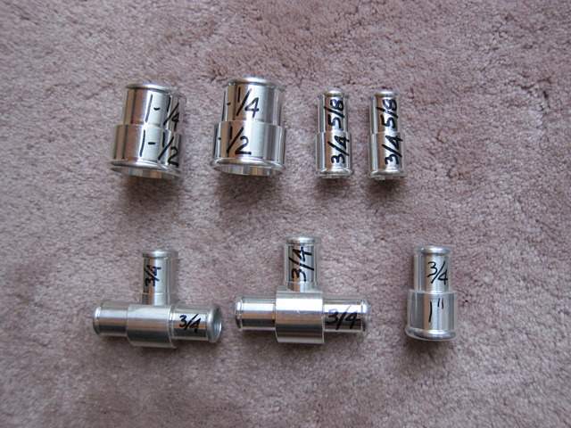

I replaced all my nylon coolant transition and tee fittings with machined aluminum fittings from Jags that Run....also called Stealth Conversions. Here is a picture of the various sizes used on the SLC build. The inside of the transition fittings are smooth without a step for less turbulence. I had enough made for two cars.
The 3/4" to 1" fitting is only needed if you plan to use the plastic Dorman tank supplied in the kit.

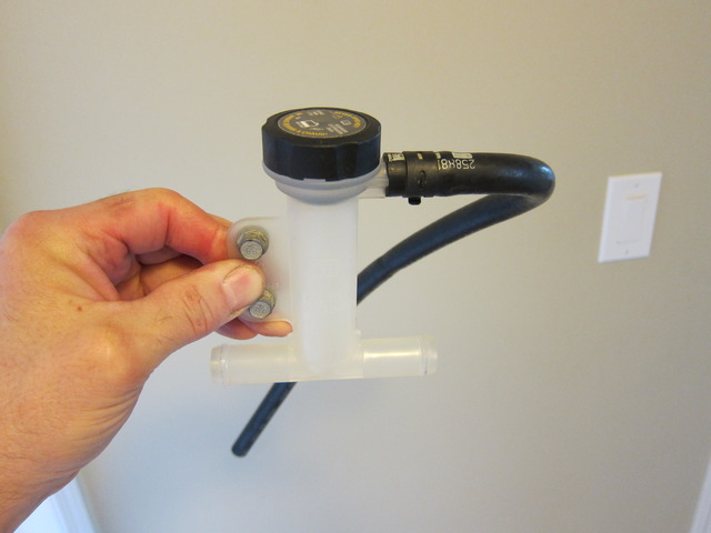

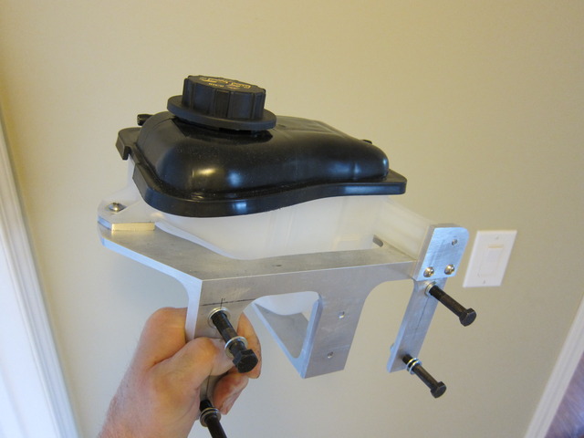

Work continues on gathering parts for the GT-R build. I finally got around to making a light robust mount for the Dorman tank if I choose to use it.
The second picture shows the LS9 supercharger intercooler fill point. These are from the Cadillac CTS-V cars. Part number for the reservoir is #25884797 and the cap is #15076936. Together they were about $37.

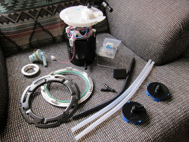

The fuel tank design will include the CTS-V fuel module. A separate electronic control module monitors fuel line pressure and uses a PWM signal to spin the twin pumps in the fuel module faster or slower depending on demand. The benefits are quieter/cooler running and longer service life. A Ford truck vent valve will be used for the evap system and roll over protection.

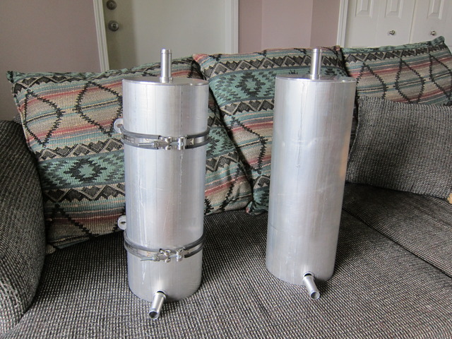

Ideally I'd like to run dual inter-cooler circuits if there is room in the engine compartment. Heat sock can be a problem when you install a smaller pulley to increase boost. Each inter-cooler brick will have it's own pump, tank and heat exchanger. The tanks are being mocked up in this picture before I settle on a final height. They will most likely be made a bit shorter. The volume currently of each 6"x16" tank is 1.9 gallons. If I just go with a single system I'll use one tank and leave the height as is.

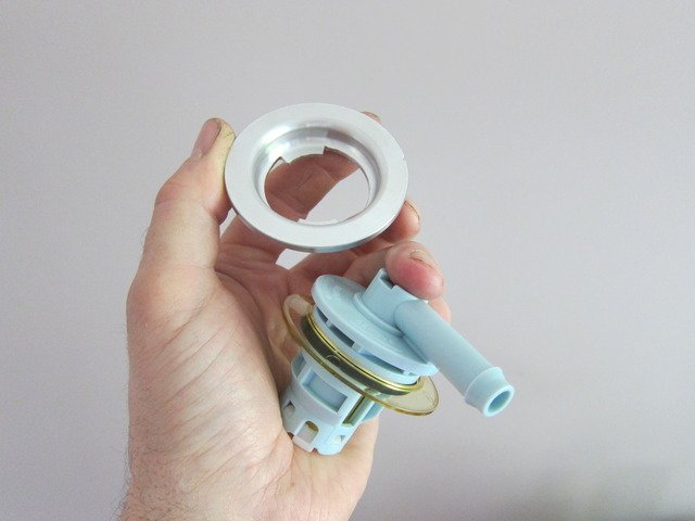

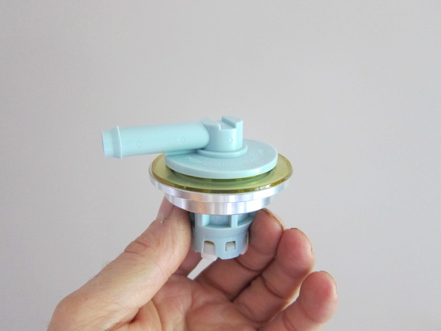

I decided to use the Ford F150 type of fuel tank vent valve for the next build. I like the OEM reliability aspect. The weld in bung can be purchased here: Ford F Series Aluminum Weld-in OEM Vent Bung
A 2" hole saw will cut the correct hole size. The Ford vent was installed in F150 and up trucks from 1997 to 2004. I purchased a Dorman #911-061 fuel vent valve (Ford F65Z9B593DA) Dorman Products - 911-061
The tabs on the weld in bung had to be filed slightly to get the valve to drop in smoothly. Push down and with a quarter turn to the left and it locks in place.

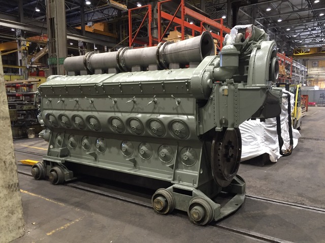

I'll be retiring in a couple of weeks after 36 yrs with the same company so I'll finally be able to devote some time to my build. Here is a picture of one of the last engines I help build. It's worth about $300000.
Congratulations on the impending retirement Ken. It's been a long road - I know. I just retired my 43 year long career last October.
Soon you'll be enjoying weeks that have 6 Saturdays and 1 Sunday! :thumbsup:
Oh yeah - cool engine! More info??
Ken Roberts
Thanks Randy!
That's a GM Locomotive engine (645E3B). We rebuild some of our older Locomotives (CN Rail). That particular one puts out 3000hp. These types of engines are common in ships and as back up power in Industry. My last two engines before retiring will be twin Roots blowers which produce 2000hp.
