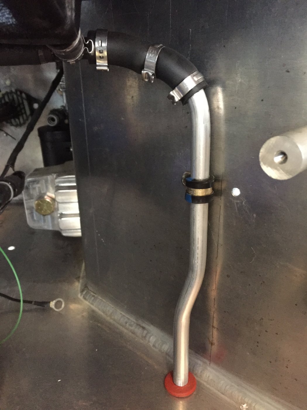

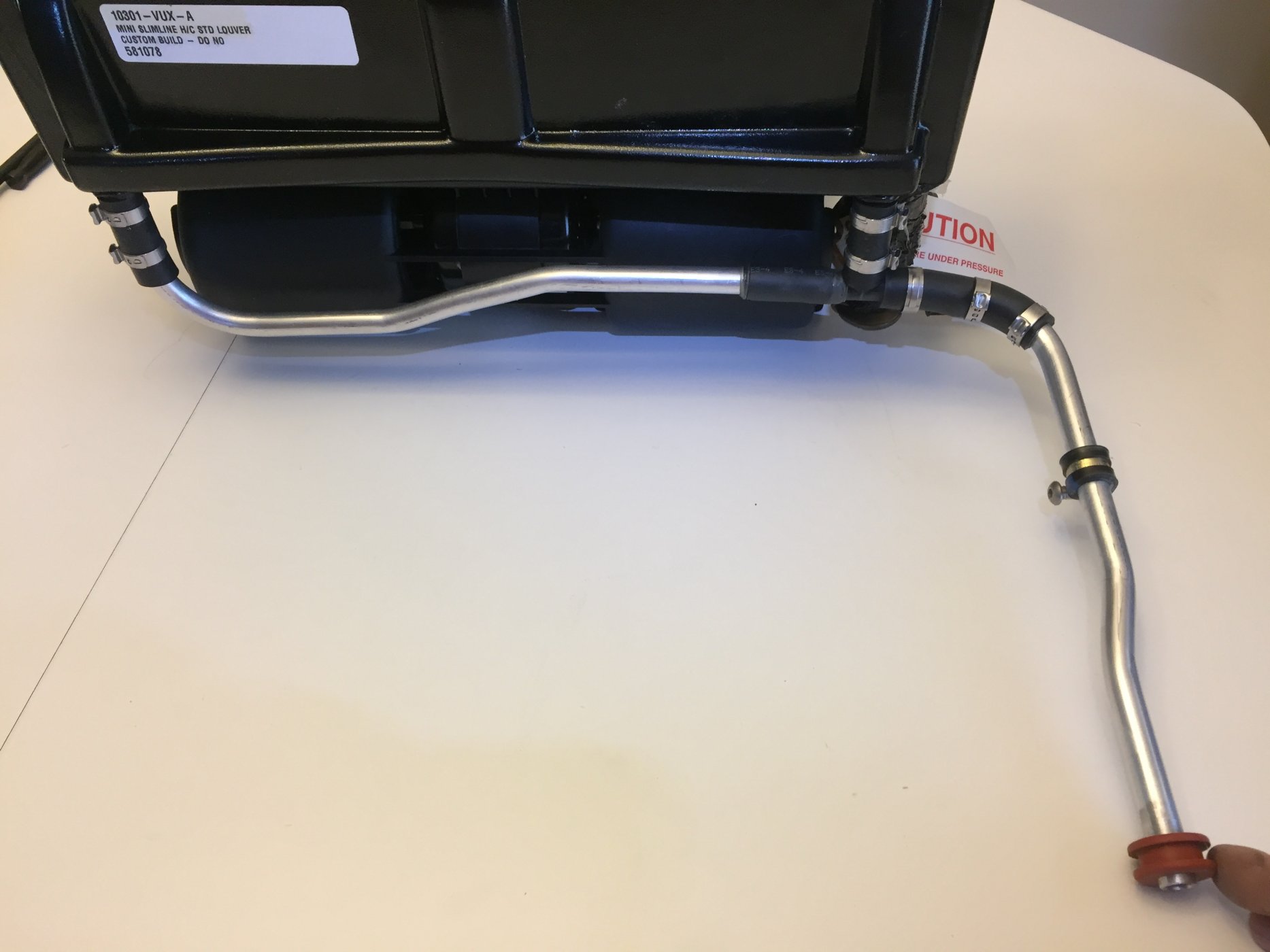

I made a robust drain for both cars a/c systems. The passengers feet are in the same area so I felt the need to keep it tucked up tight. I have a foot rest and washer bottle mounted near by so it was important to mount the drain out of the way. I used some 1/2" aluminum tubing from McMaster Carr, oetiker clamps and epdm rubber hose. The tubing is held in the floor with a silicon grommet.
EPDM hose 9776T18
Aluminum tubing 9929T17
Silicone grommet 1061T39
Oetiker clamps 52545K73

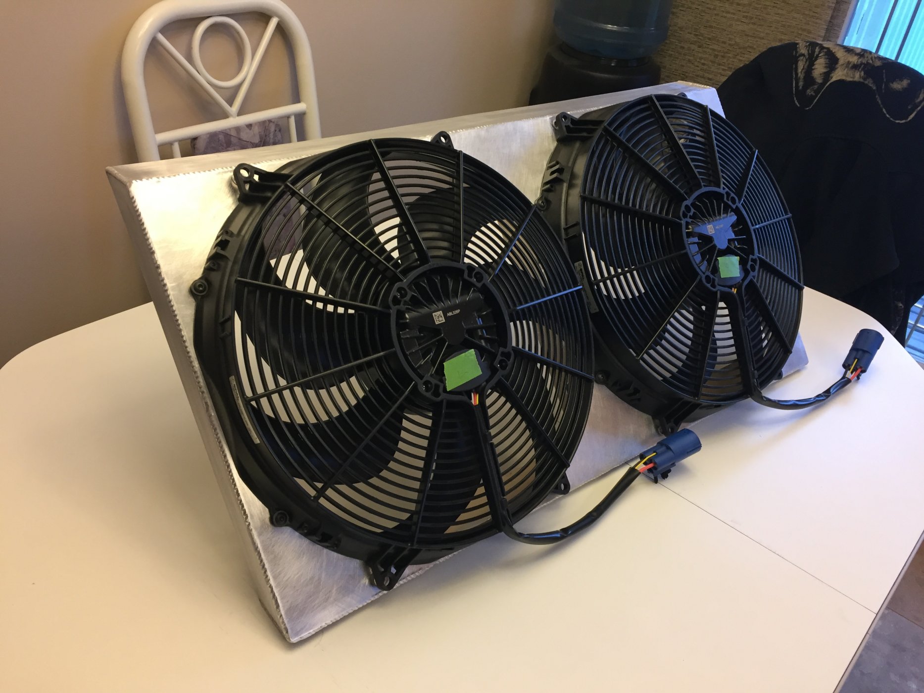

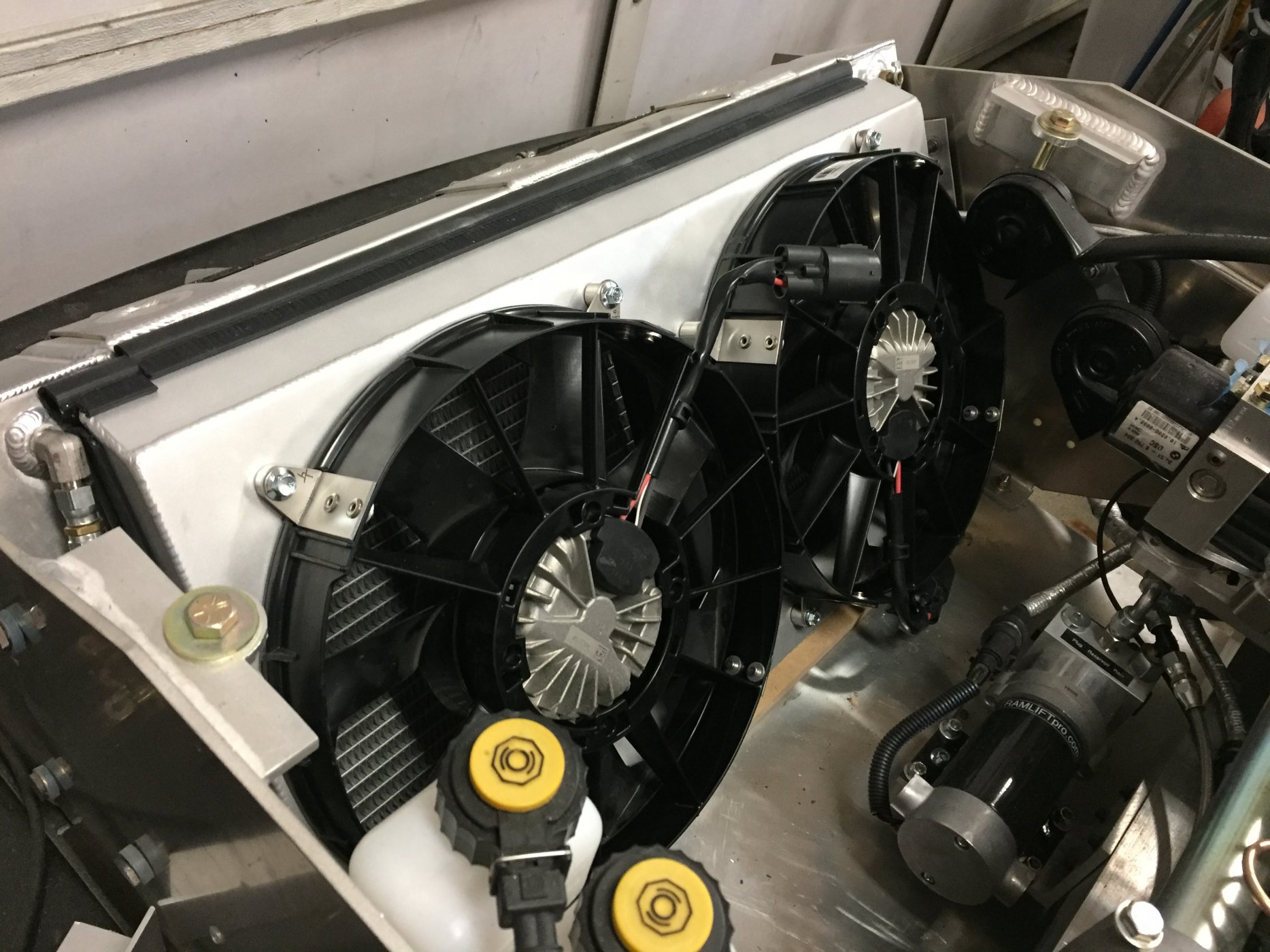

Final process of mounting the big 12" Spal fans. You can see that the fan shroud over laps both tanks in order to use 12" fans. The shroud was angled down so that a bigger shroud box could fit and still provide hood clearance. Next up is to fabricate the air deflector to help direct the air up instead of on the foot box. I'm using a rubber bulb weather stripping seal to keep the shroud away from the radiator and still provide a good seal. The goal is to mount the fan shroud independent of the rad like most OEM installs. The radiator will most definitely have a longer life this way.

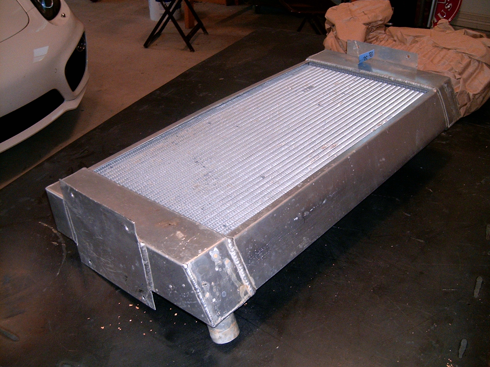

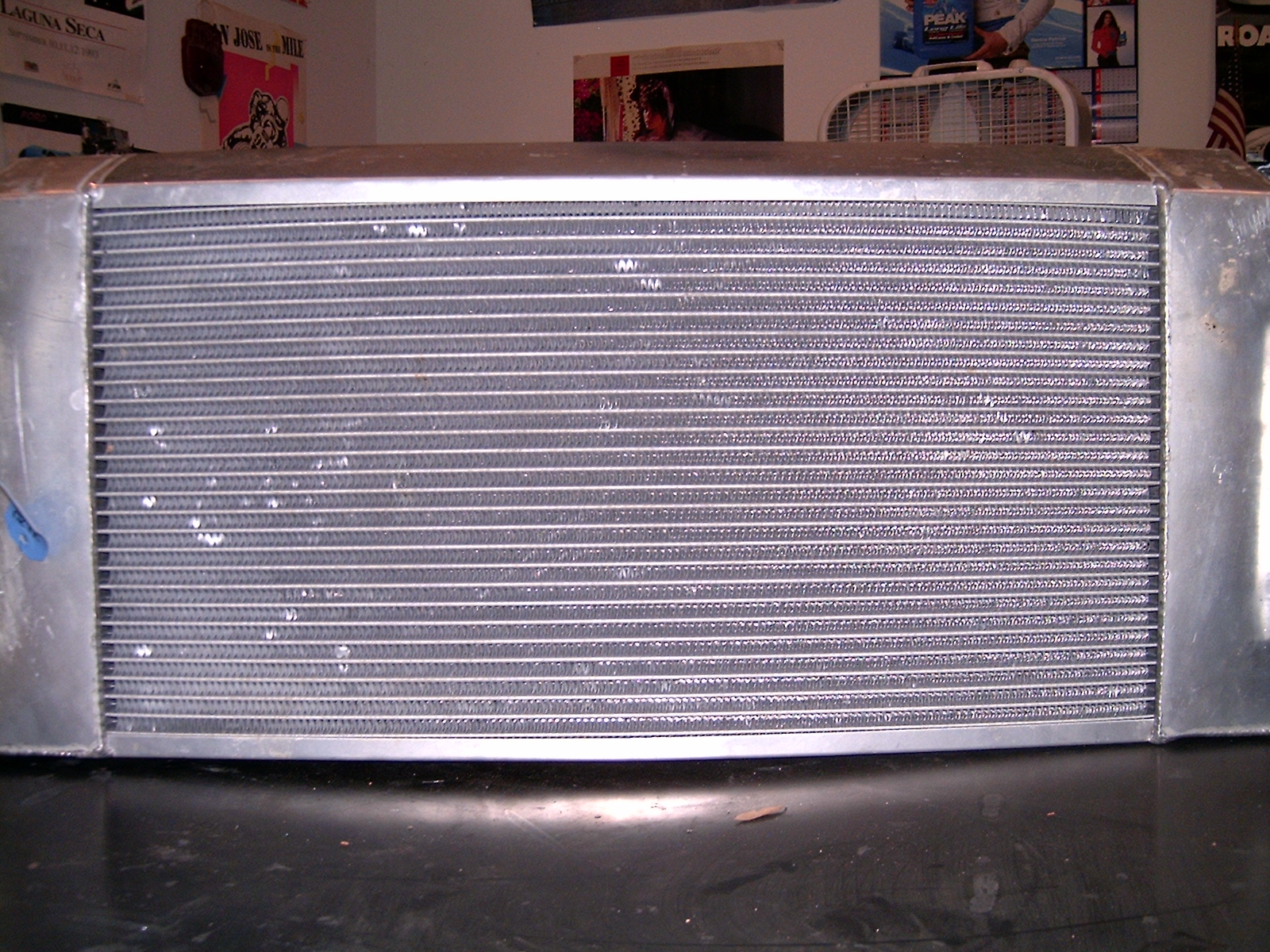

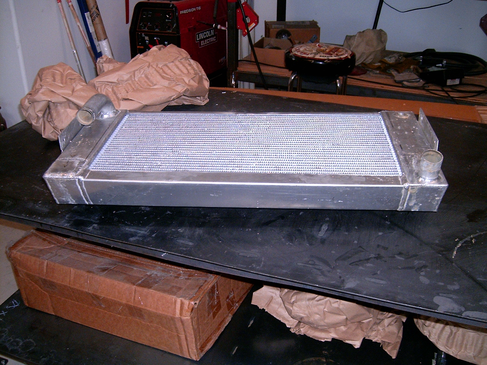

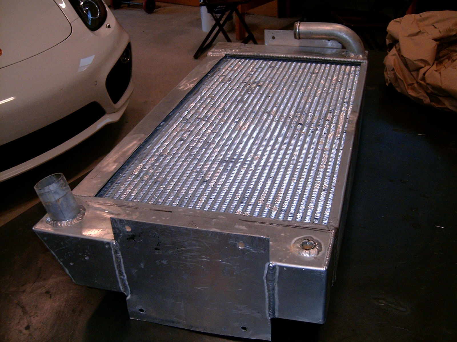

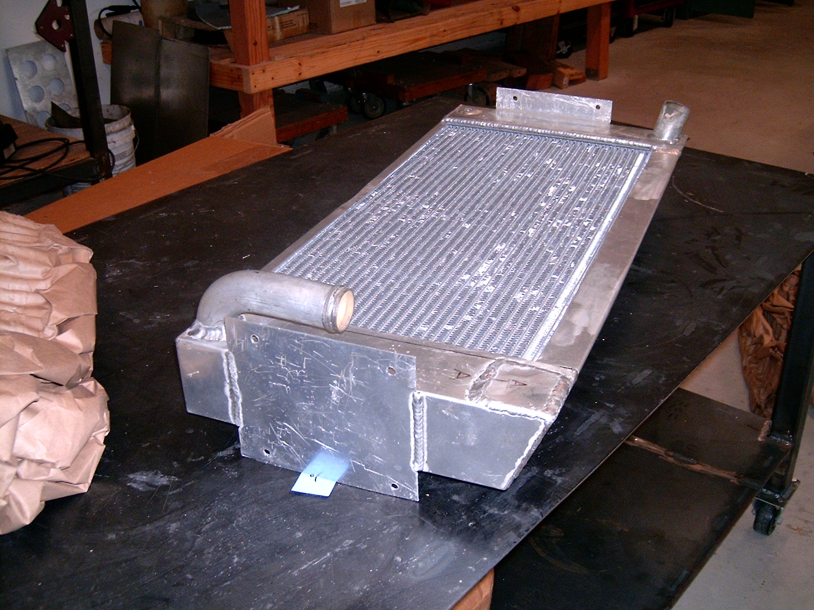

Ken, my standard radiator has less than a 100 hours on it, has no leaks or other damage, and I am willing to sell it as it excess to my needs. I did move the inlet from the bottom to the top of the drivers side in an attempt to improve efficiency (it worked marginally. Aprox 3-5 degrees F reduction). It would be easy to move it back if you wanted to. I'll get out to the garage and take some pictures for you.
As far a price goes, I am thinking about 1/2 of the cost of a new one or there about? Could you find out what a new one costs from RCR if you don't know already. You pay shipping and I will do shipping prep to your address. I will need address so I can get quote from UPS ground.
Howard Jones
here are pics

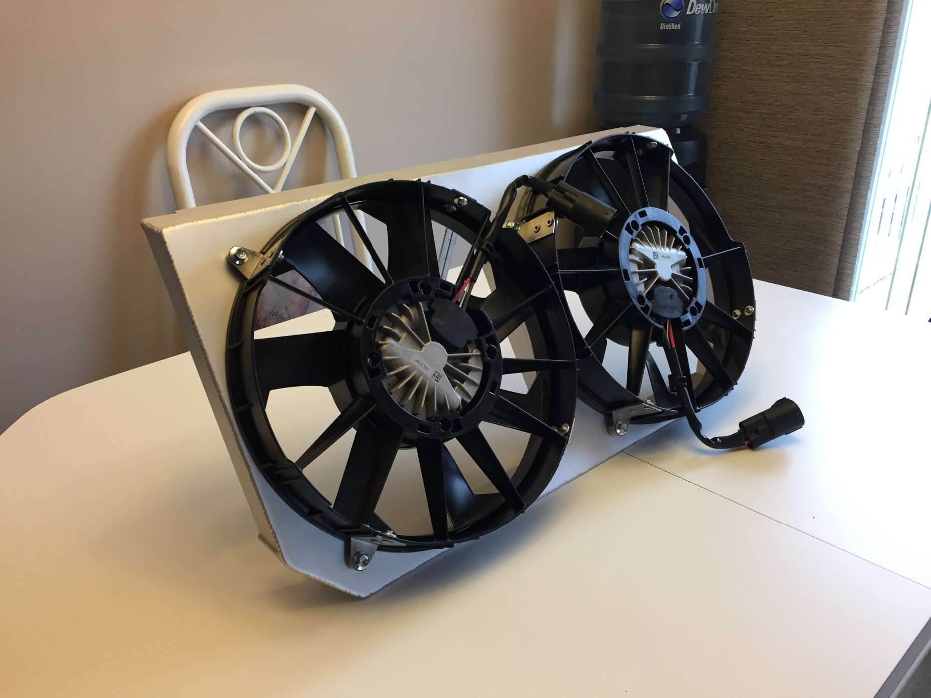

I finished building the fan shroud assembly for the GT-R. It follows the same design goal as the SLC. The 15.2" Spal brushless fans couldn't have been a better fit.
These fans are also available in the same size with a brush motor. The Spal part number is #30102082. A great alternative if you want to maximize your cooling but not want the added complexity of a PWM controller.

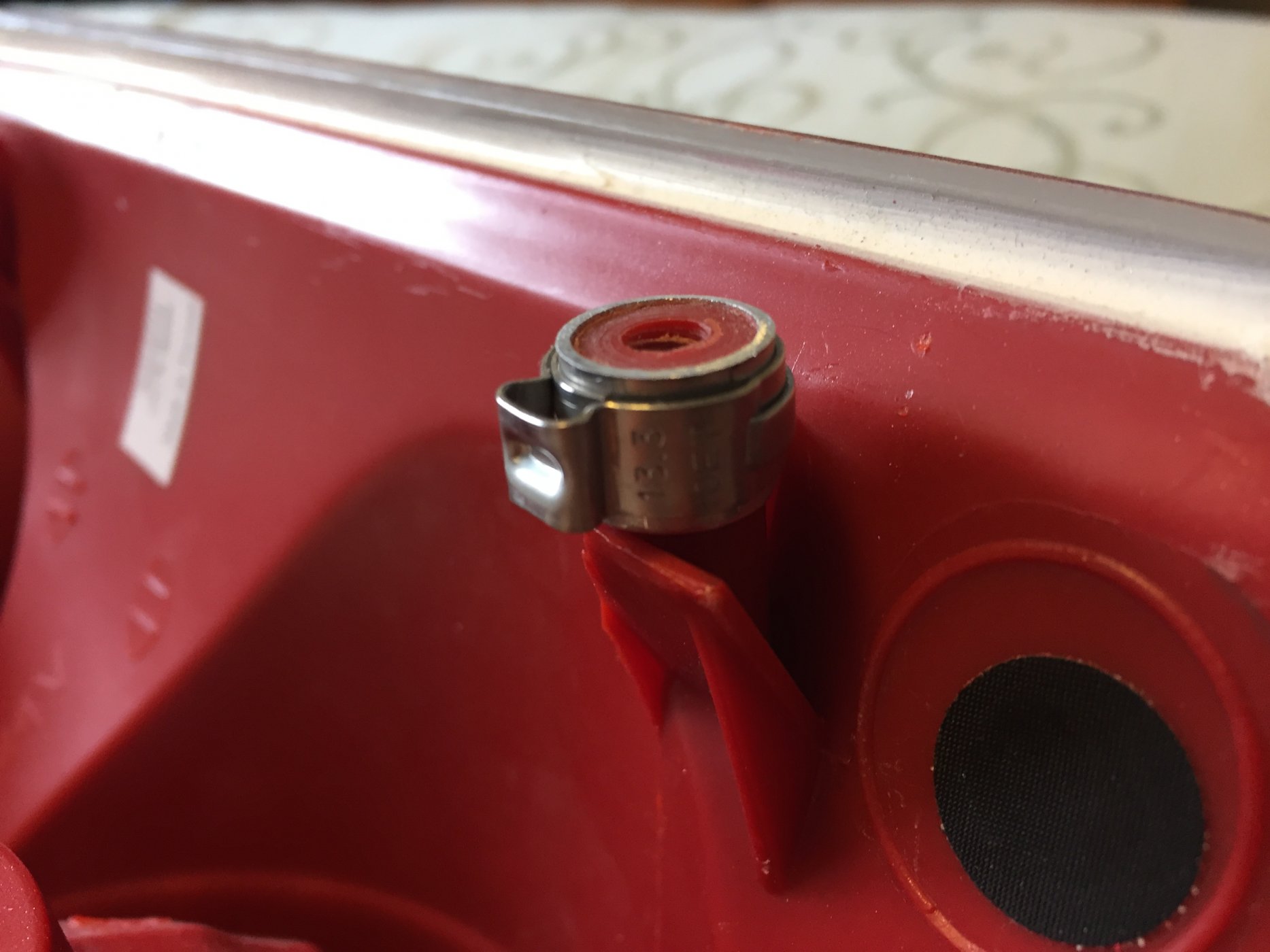

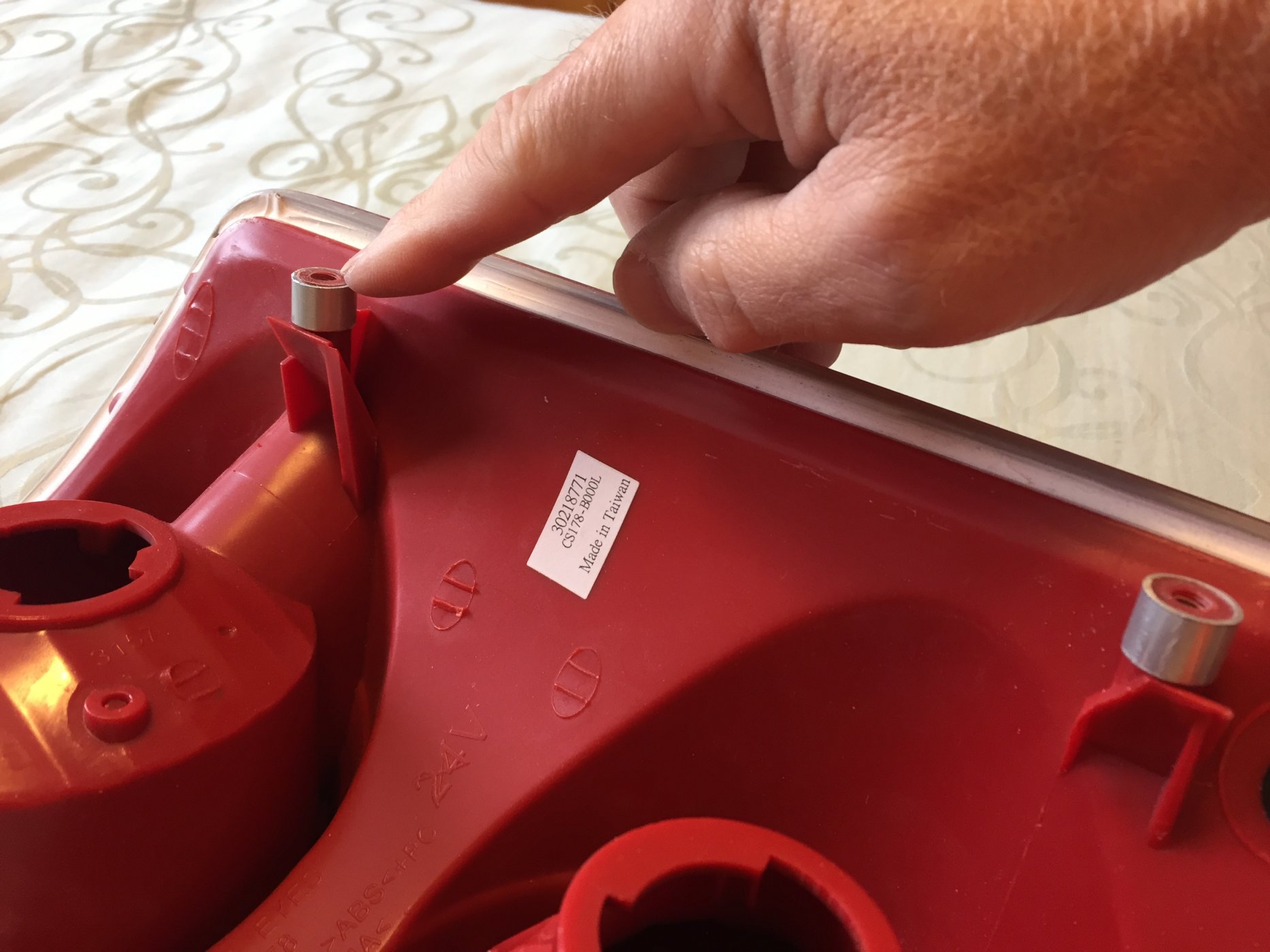

I'm using the stock Dakota tail lights so I thought I'd reinforce the two plastic horizontal mounting points on each light. I found that a .500"(od) by .035" wall aluminum tubing fit snugly over the stand off. I then further reinforced them by installing oetikar clamps. (13.3). Overkill I know but I already had a bunch of these clamps.

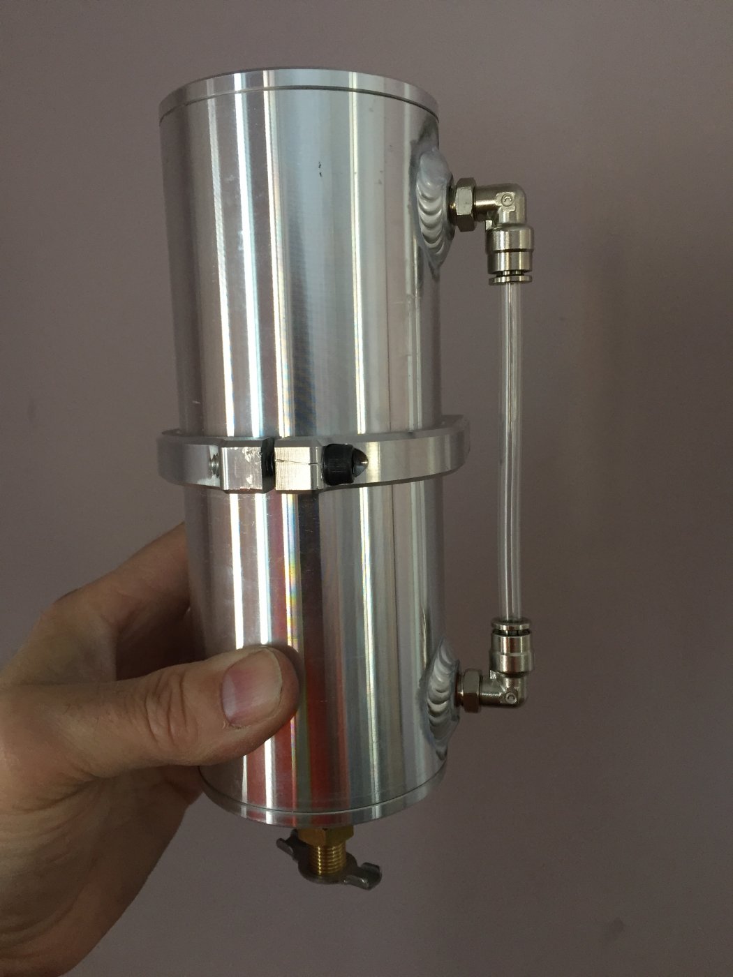

Decided to add a sight glass to my overflow/recovery tank.
The elbows
The tube
The weld bungs
