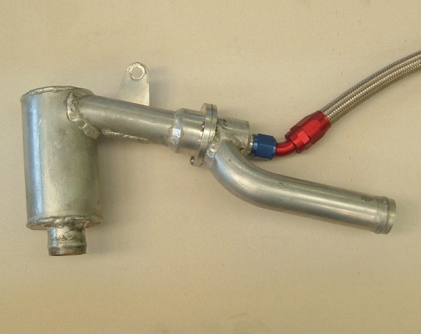

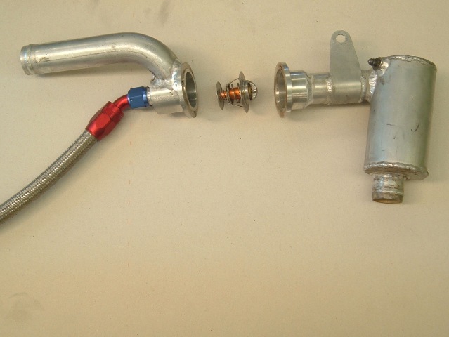

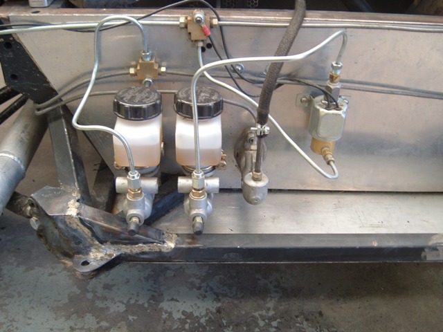

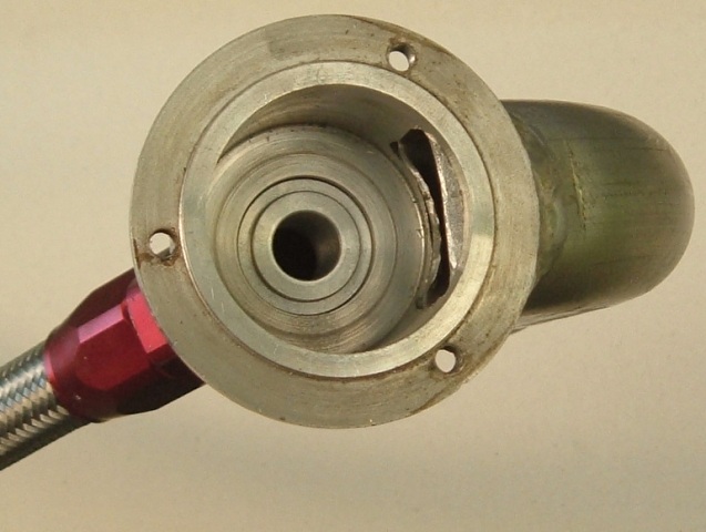

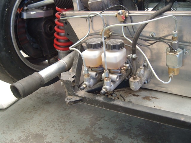

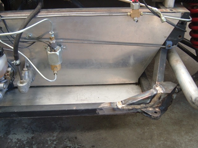

Anyone who has been reading http://www.gt40s.com/forum/race-track/30372-scratchbuilt-kiwi-40-goes-racing.html will know things did not go well at the Levels 14 Nov meeting. I have been somewhat lethargic since and not really up to posting much. However before that meeting I had done a few mods to the car, fitting larger brake master cyls and softer pads. The Girling cyls that I was using I thought were available in most sizes up to 1" but I was misinformed and had to change over to Willwoods to get the size I wanted. This meant chopping out a bracing bar in the front of the chassis to make them fit.
First pics are the offending bar and the chop. Subsequent ones are the new cyls and new bracing gusset.
Also because of the necessity to get my engine temps up for E85 I machined up a thermostat housing to weld into the swirl tank inlet.
Both these mods were successful, the brakes now feeling good and engine temps sitting steady at 200°F.
