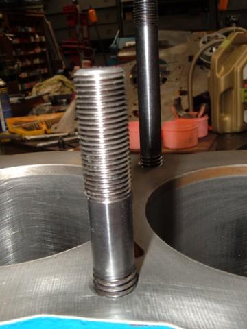

My heads at the outer studs are 38 thick, holes in the block are 39, gasket 1, washer 3, nut 13. Total 94. Stud length of the 154-4203s is 82 so it will have insufficient engagement in the nut by 12mm if the stud is bottomed out. I actually made some 11mm spacers to go down the hole first for the studs to bottom onto.
For the inner studs my heads measure 76, so total 132. The studs are 127 so a 5mm shortfall there
Ross, your heads are 3mm shorter but you are still going to be 9mm short on the outer nut engagement. Maybe a 3/8" ball bearing down the hole? Or use the Dart studs 66130121? Or maybe ARP can supply something in the right length?

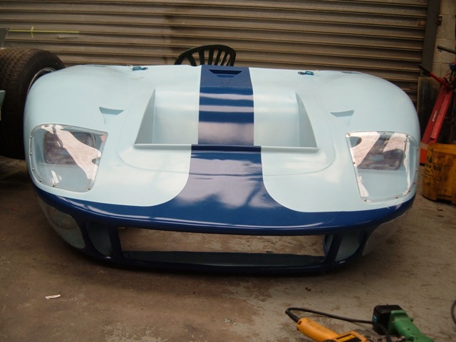

How's this for a teaser? The blue stripe! Wasn't going to do this until the winter rebuild, but since I had to attend to the damaged panelwork front and rear it seemed a good time....

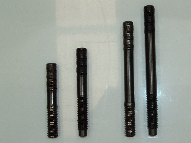

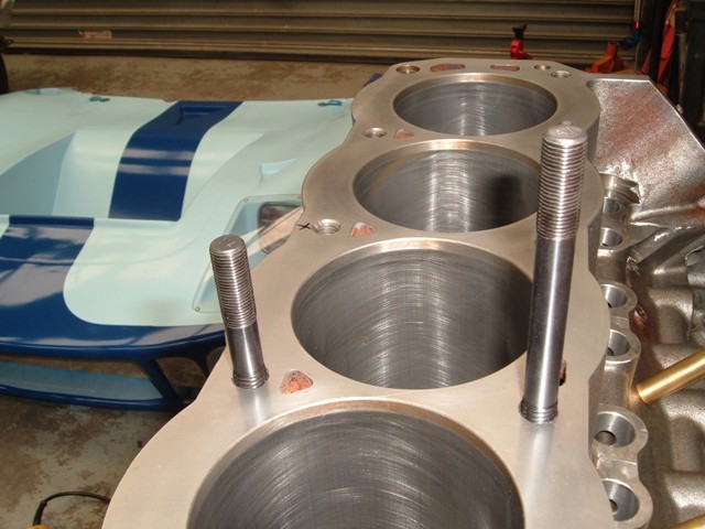

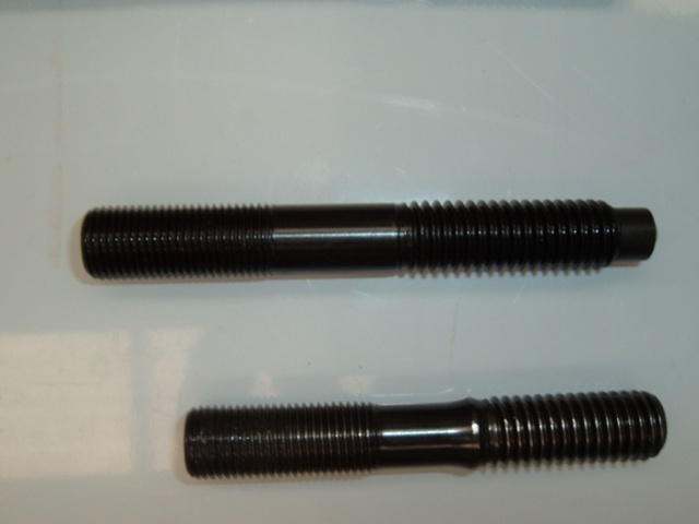

Studs arrived today. All OK. They snug nicely into the bottom of the holes and are slightly longer than they need to be. About 5mm overlength on the shorts and 10mm on the longs. I think these are what you are going to need Ross.
First two pics compare old and new, last two show them installed.
I have been doing a bit of reading about torque values and by all accounts it is hard to get reliable and repeatable clamping forces using a torque wrench due to frictional discrepancies. The preferred method where you can't use a stretch gauge is torque angle, but unless you know the amount of compression you are getting in your gaskets etc you can't do it.
However it is stated that if you torque your nuts up and release them about a dozen times with your preferred lube and take care to retain the same nuts on the same studs they will burnish the threads and provide relatively equal and repeatable clamping forces. Sounds logical to me, I think I'd use the old head gaskets whilst doing that and fit the new ones for final assembly.
