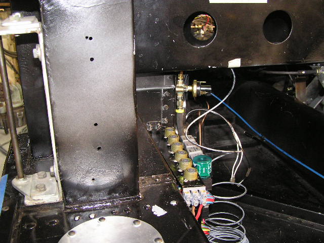

Russ, throw away the electric pressure gauge.
use an old fashioned mechanical gauge and run a 1/4 or 5/16 pressure line in the car reducing down to the normal 1/8 pressure gauge line at the inside kick panel.
you can see in the photo there is also the oil pressure switch for the fuel pumps
The 'T' piece is a brake pipe union typically found on the english cars for the brake light switch. you can also see the rubber hose coming from the engine
