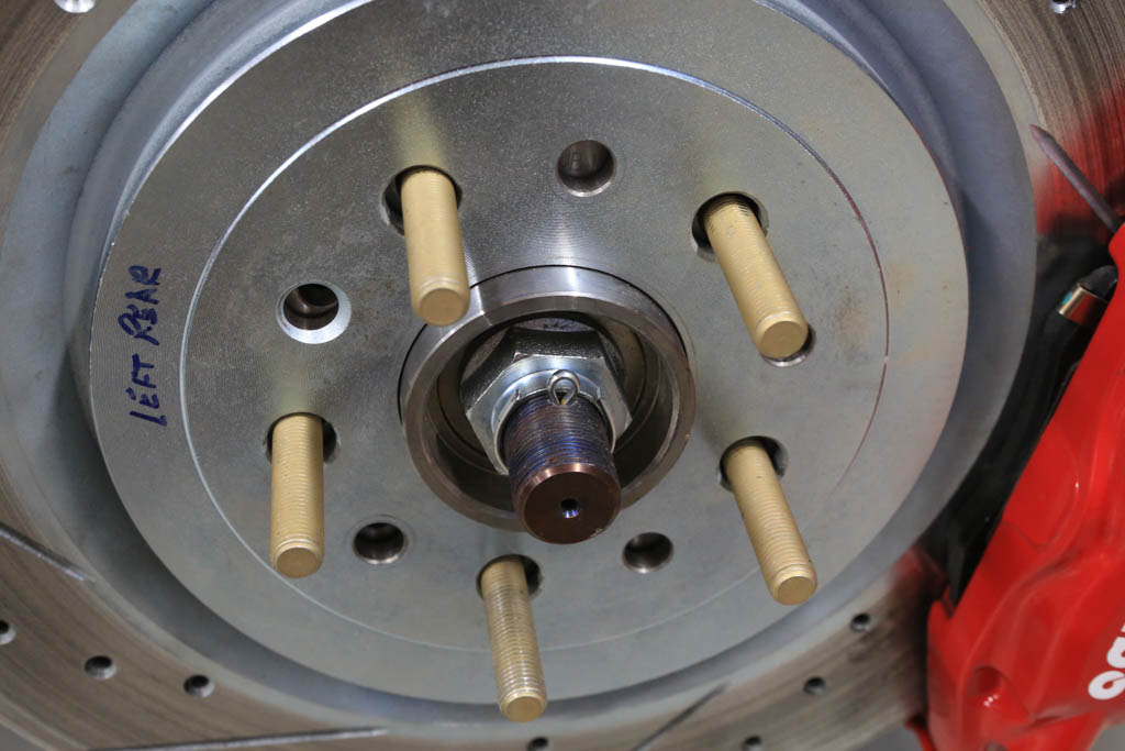

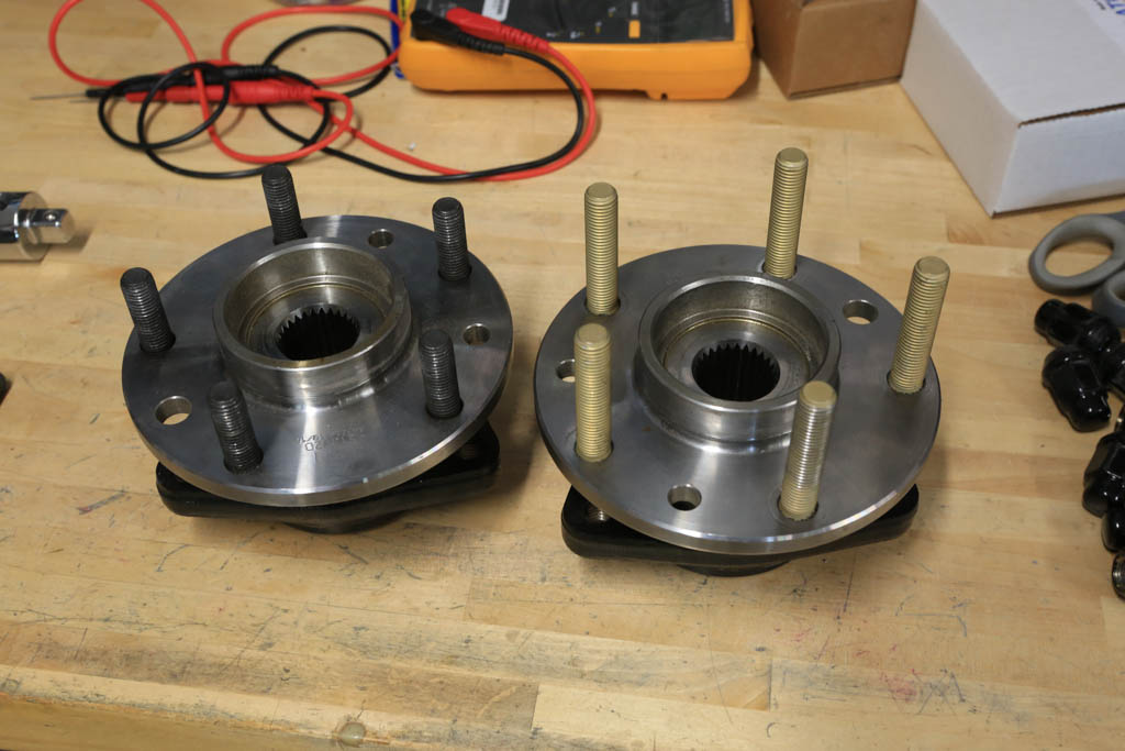

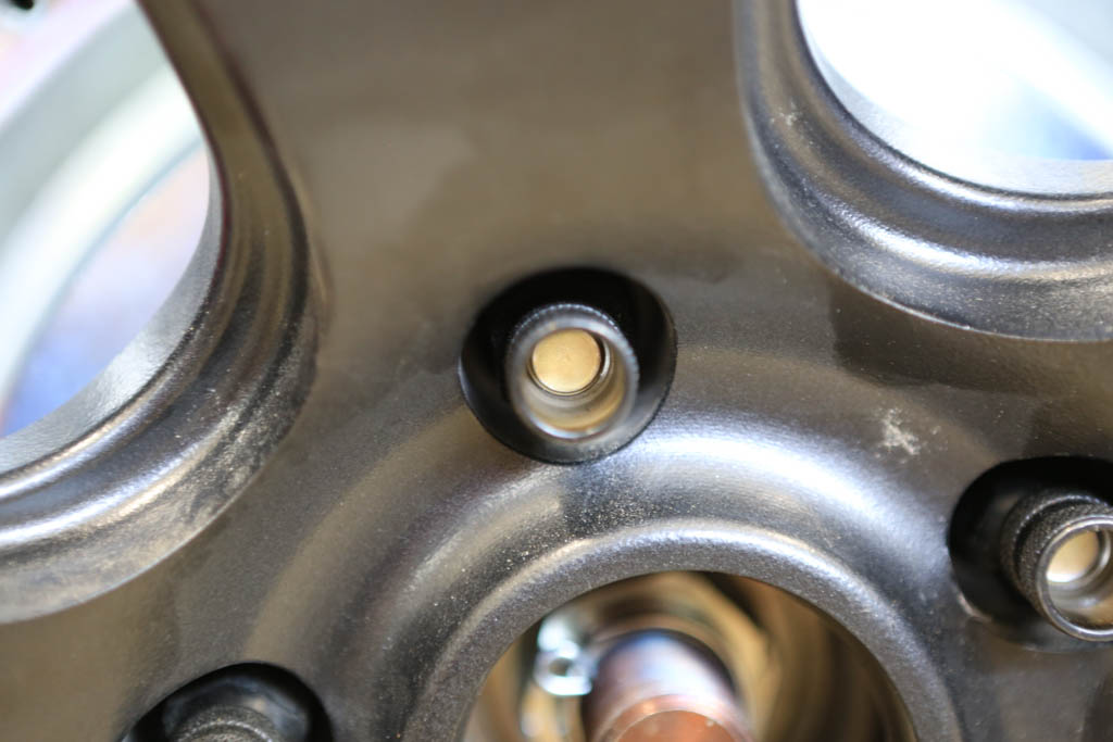

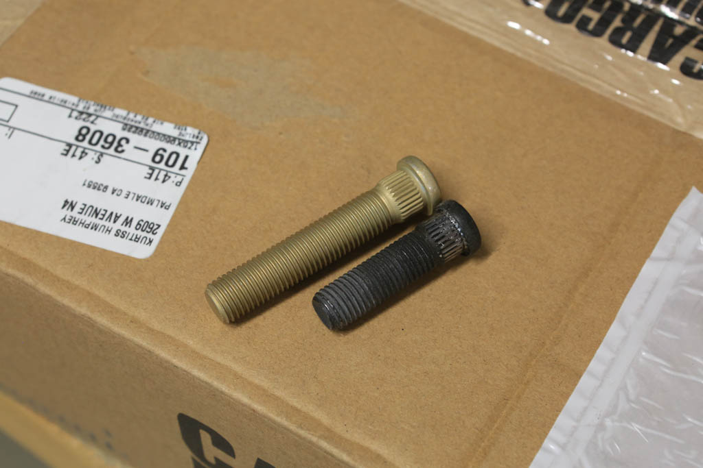

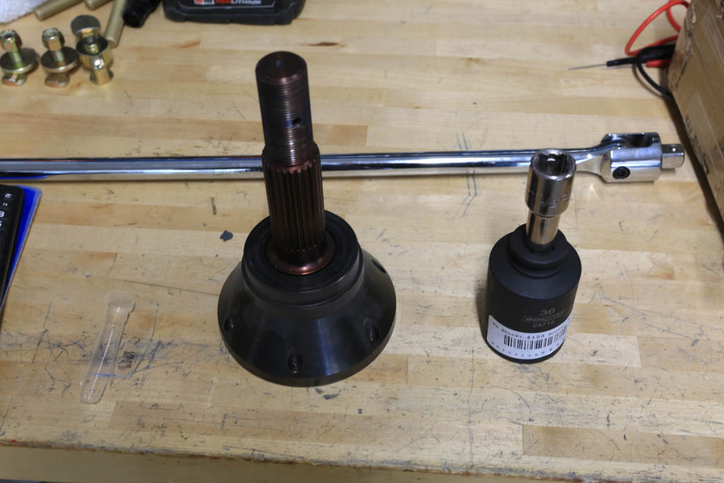

Like others, I changed out the rear wheel studs. Even though I had a little over ½” of thread engagement, and the rule of thumb is to have a thread engagement that is at least as long as the diameter of the stud (12mm), I feel better with the longer studs. I installed ARP studs P/N 100-7708 using a hydraulic press. You’ll need a 36mm socket to remove and tighten the axle nuts to 180 ft.lbs. After installing cotter pins and the wheels, the stud length is perfect. No worries!

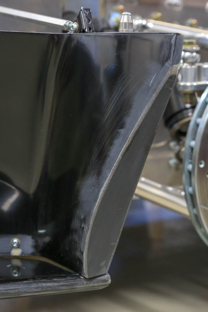

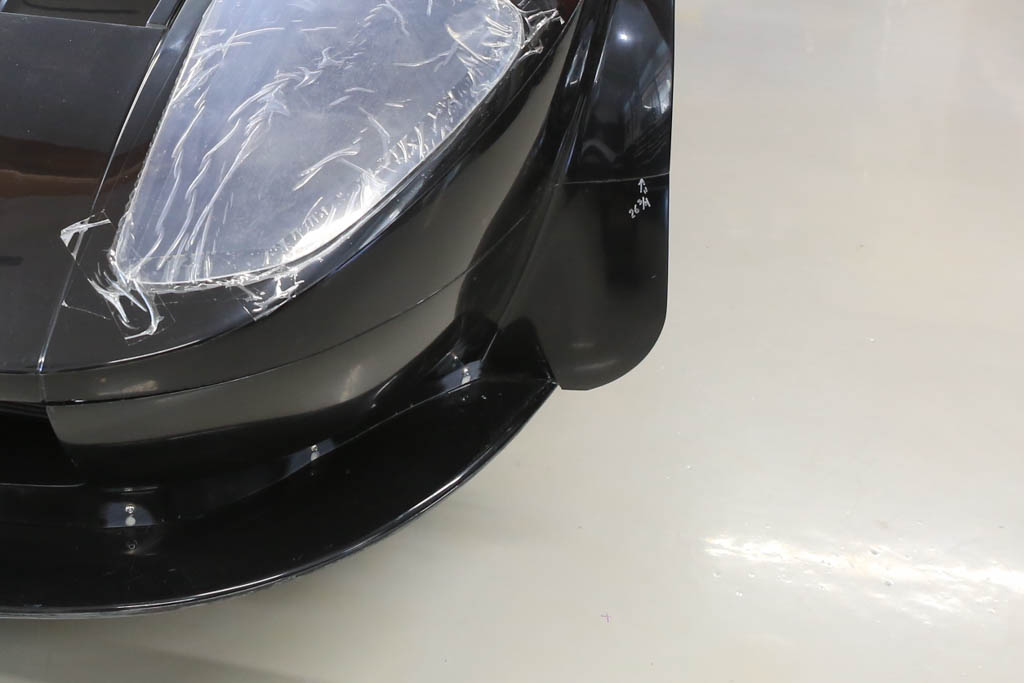

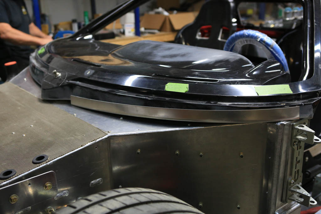

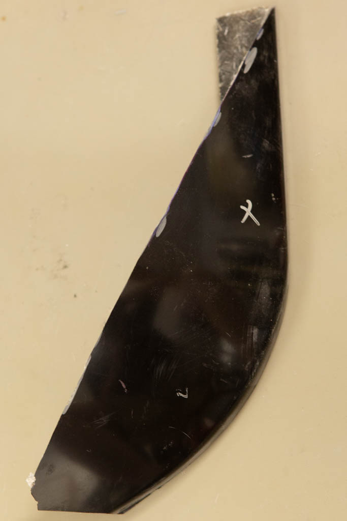

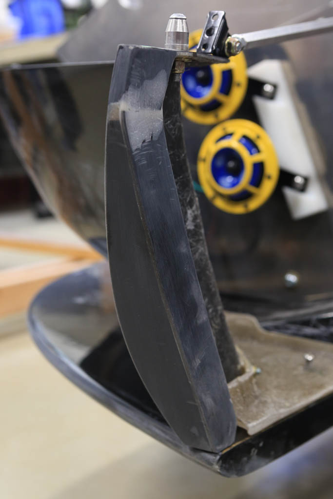

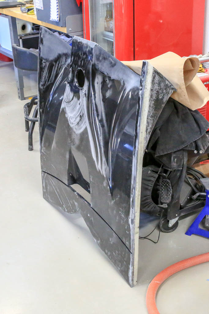

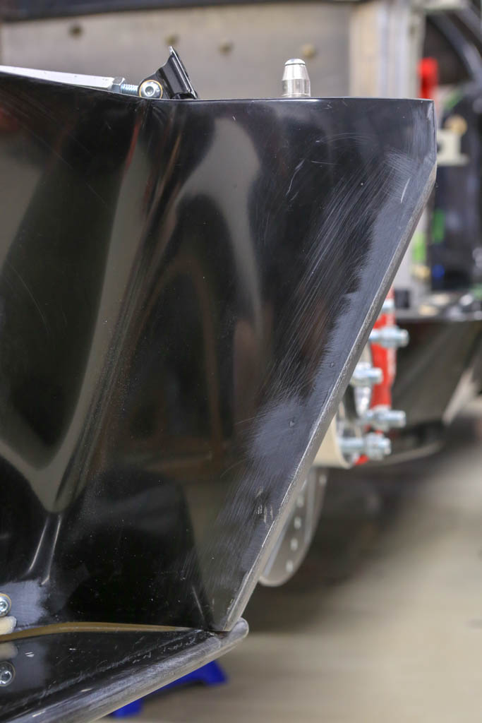

The original front wheel well forward flair sticks out way to far. Like many others, I cut down the flair, bonded a flat piece of fiberglass and added more fiberglass to the inside. Looks so much better!

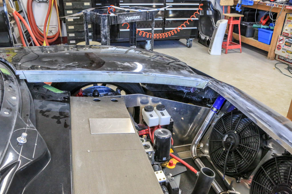

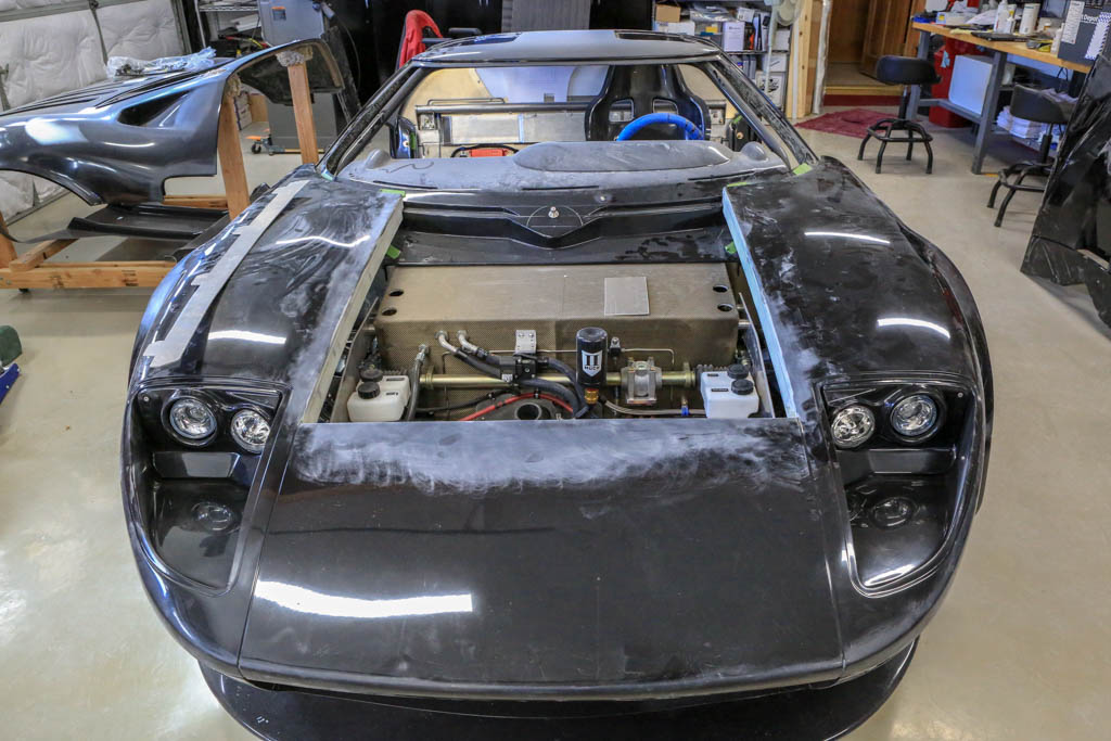

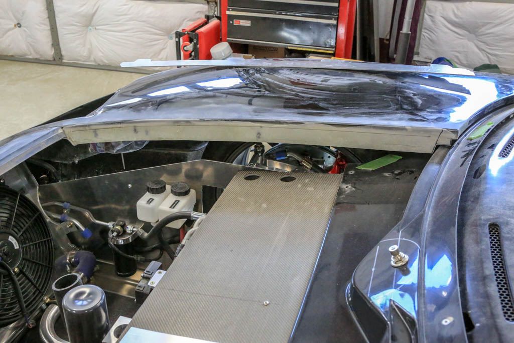

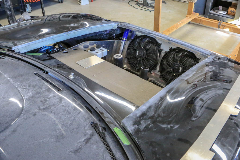

Front Clip Trunk Cutout
I was skeptic at first but after seeing Rufus’s car and the easy access to the front area, it just made sense to liberate the trunk lid from the front clip. Rufus sent me the templates that H had fabricated for his own car and gave me a set of hinges. I followed the photos he posted and was able to separate the lid with no problems. I still have lots of work to do (install hinges and gas struts).

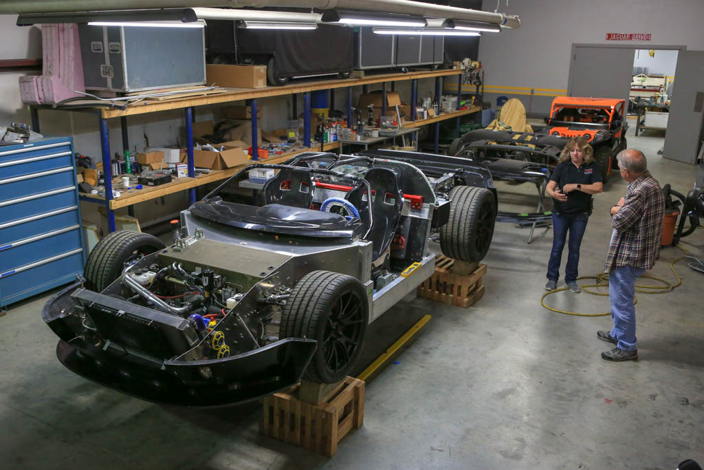

I reached a point where I didn’t know what to do next. None of the body panels had been bolted down because I wasn’t sure where to start. I needed to fit the spider, rockers, doors, rear clamshell, front clip, and rear bobtail.
I mentioned my dilemma to H and my desire to have him get me on the right path. He graciously agreed to help a crazy Californian who was willing to drag his car and wife across the country to Buford, Georgia. He also agreed to let me help (he may regret that).
It took 4 days and 165 gallons of diesel to reach the green and beautiful Peach State. We got here last Wednesday afternoon and dropped off the trailer at H Craft Customs before heading to the hotel. I was thrilled to meet H and see his car, Jarod’s car, the Robertson Racing cars and his shop. After I stopped drooling, my wife and I retreated to the nearby Holiday Inn Express for a good night’s sleep.
Well, H and I have been working on the car for 5 full days. H is an animal, a true workaholic who can visualize and build just about anything. I’ve also had the pleasure to meet his wonderful family and spend time with them at the Exotic Car Show at Chateau Elan Winery and Resort on Sunday.

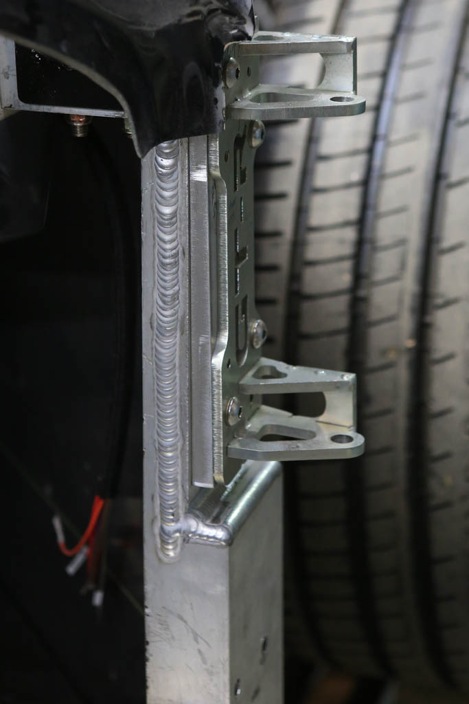

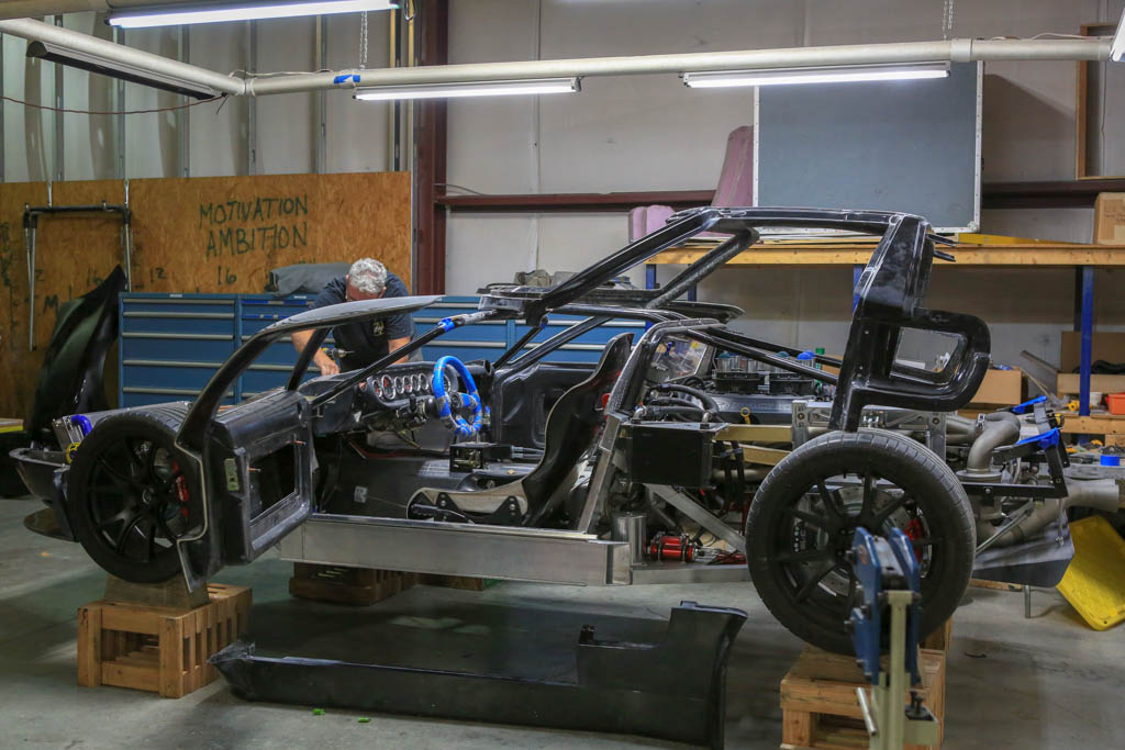

Day 1 at H Craft Customs,
  • Removed all panels/doors and front clip supports

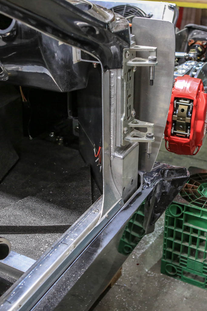

  • Machined door hinge mount plates to make vertical
  • Cut front of spider – removed lip beyond windshield frame
  • Fab’d fitting/bracket for front of spider
  • Test fitted doors
  • Removed material from rockers
  • Cut door latch post from spider

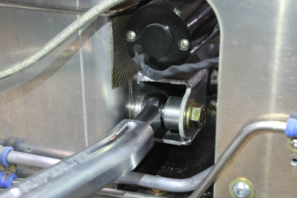

  • Ordered (for front suspension modification to remove wheel spacer):
    • Rod ends, shims, bushings from McMaster Carr
    • Rod ends from Speedway

Day 2 (Friday, Sept 25th) with H
  • Installed bracket at front of spider and caulked in place
  • Test fit all panels except bobtail – placed shims at windshield roll bar and on bobtail support structure in prep for spray foam
  • Trimmed and cut rocker panels to fit lower sil

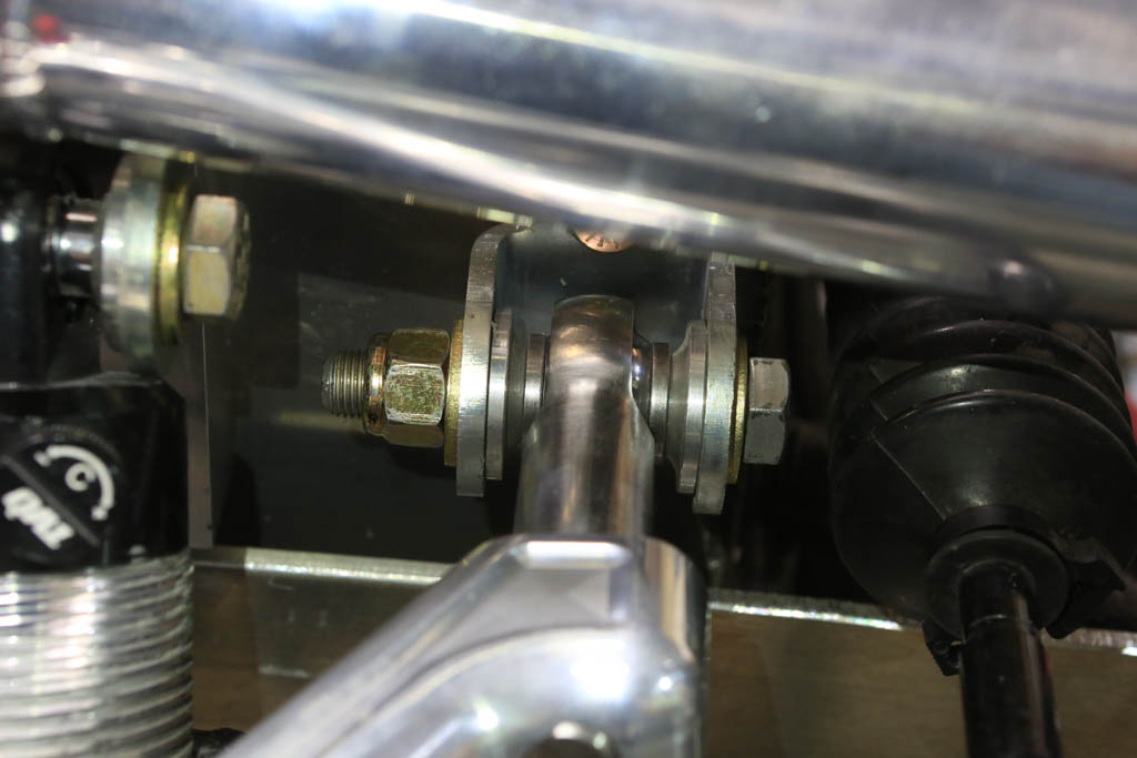

  • Removed front tires
  • Fabrication of door inner trim – lower sil
  • Removed upper A-arms
  • Fab’d and installed 1” thick front shock upper mount stand-off

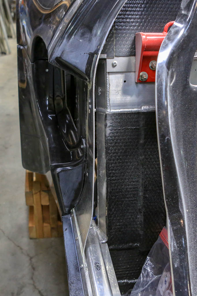

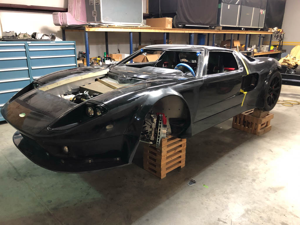

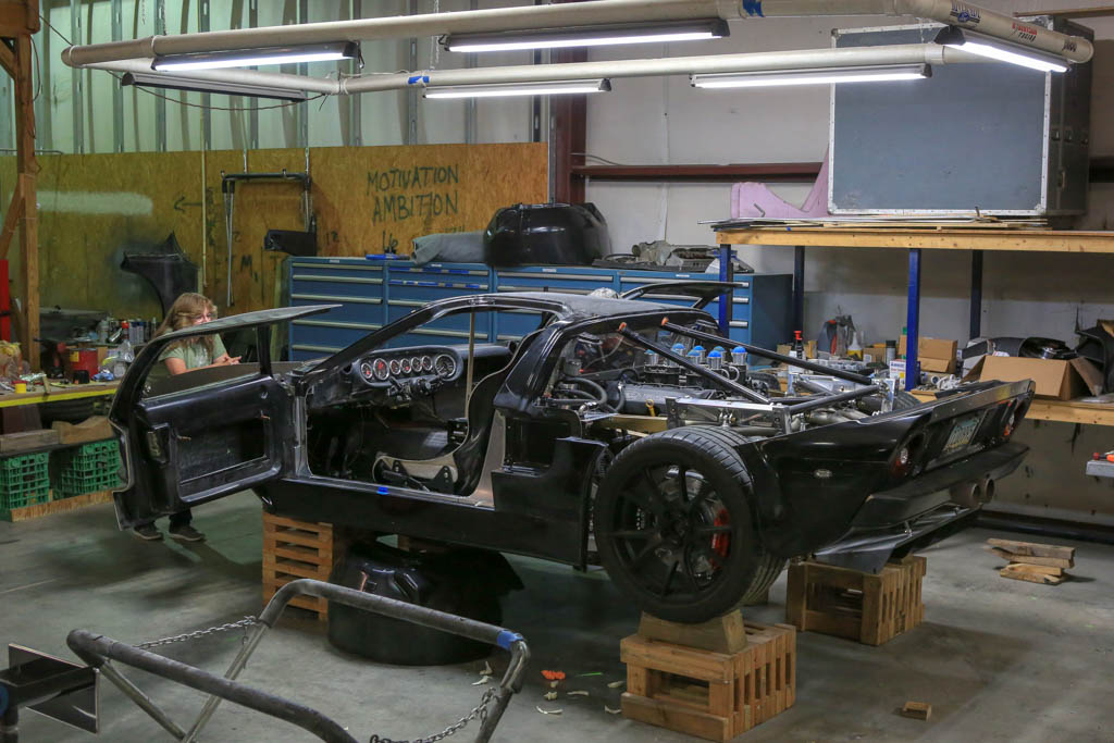

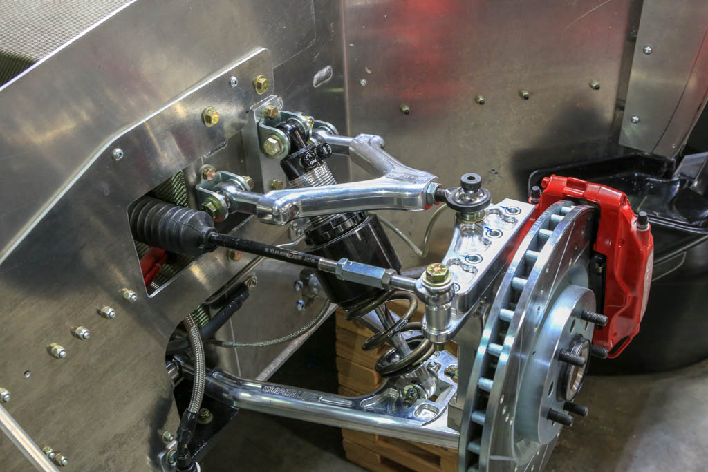

Day 3 (Saturday, Sept 26th) with H
  • Fab’d and installed front and aft door entry trim. Weather strip lip around door is complete.

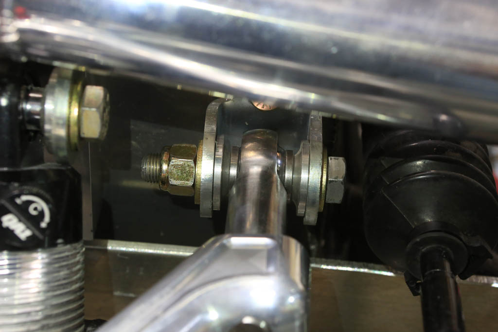

  • Installed new rod ends on lower A-arms
  • Installed new rod ends on upper A-arms
  • Removed wheel spacers from front spindles

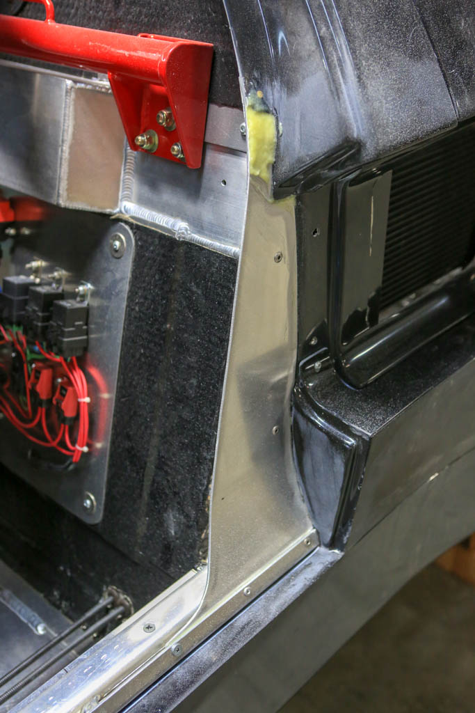

  • Trimmed and installed front clip supports

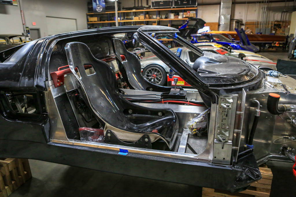

  • Installed doors, front and rear clam shells – excellent fit so far

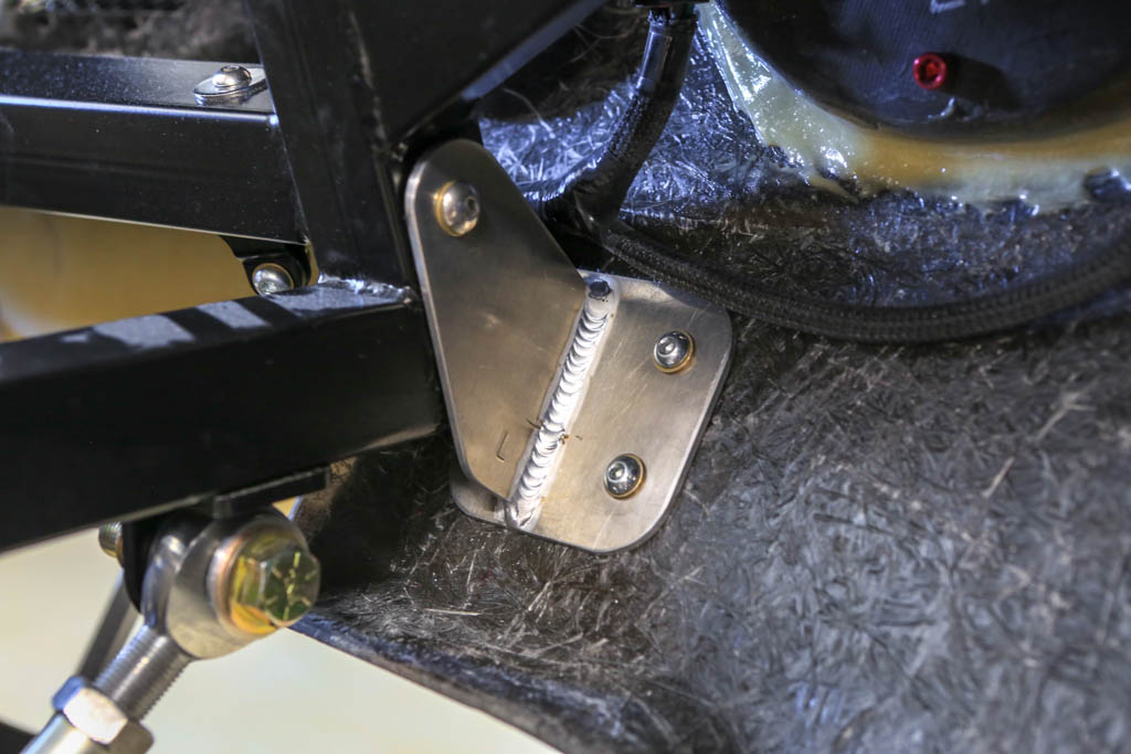

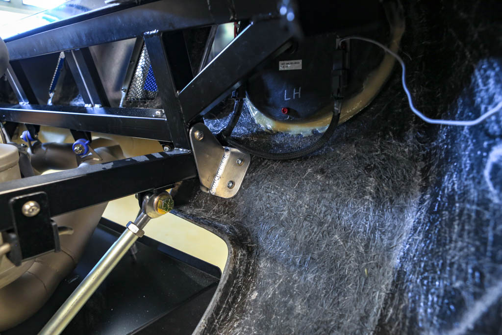

  • Fab’s and bonded front clip fender supports to inner fenders
  • Installed front clip support wings
  • A03B7996.jpgA03B7998.jpgA03B8004.jpgA03B8011.jpgA03B8247.jpgA03B8243.jpgA03B8245.jpgIMG_2990.jpg

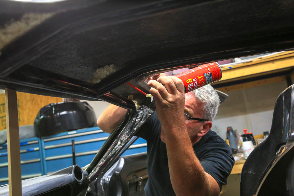

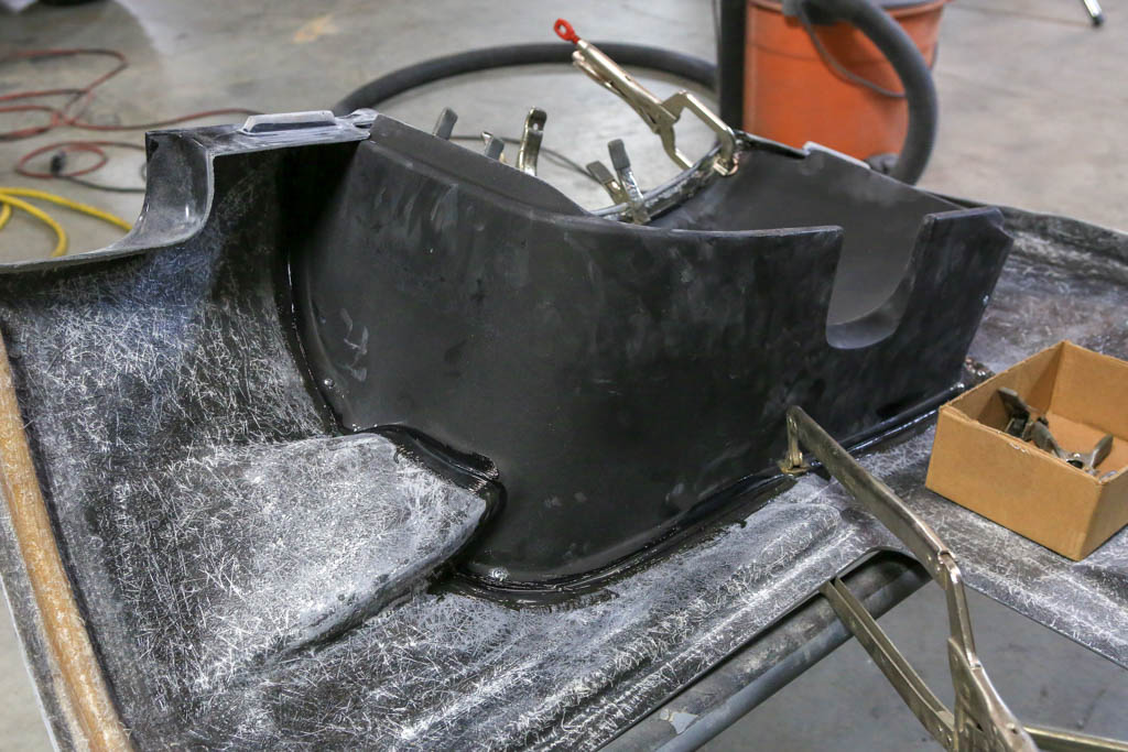

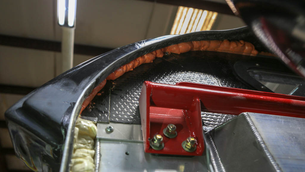

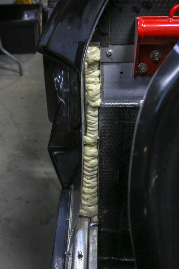

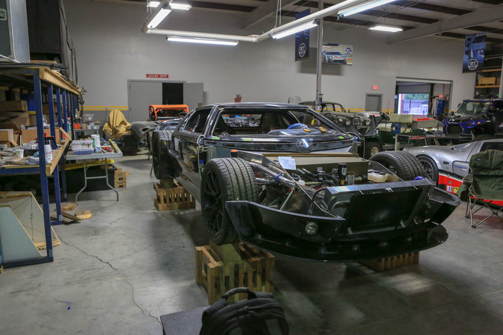

Day 4 (Monday, Sept 28th) with H

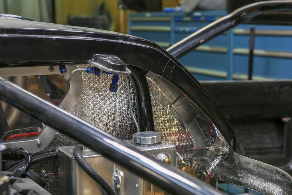

  • Applied Great Stuff Fire Block spray foam to upper firewall/spider interface and spray foam to side spider/rocker interface.
  • Applied Great Stuff spray foam to spider above roll bar on A piller and upper roll bar/ windshield frame.

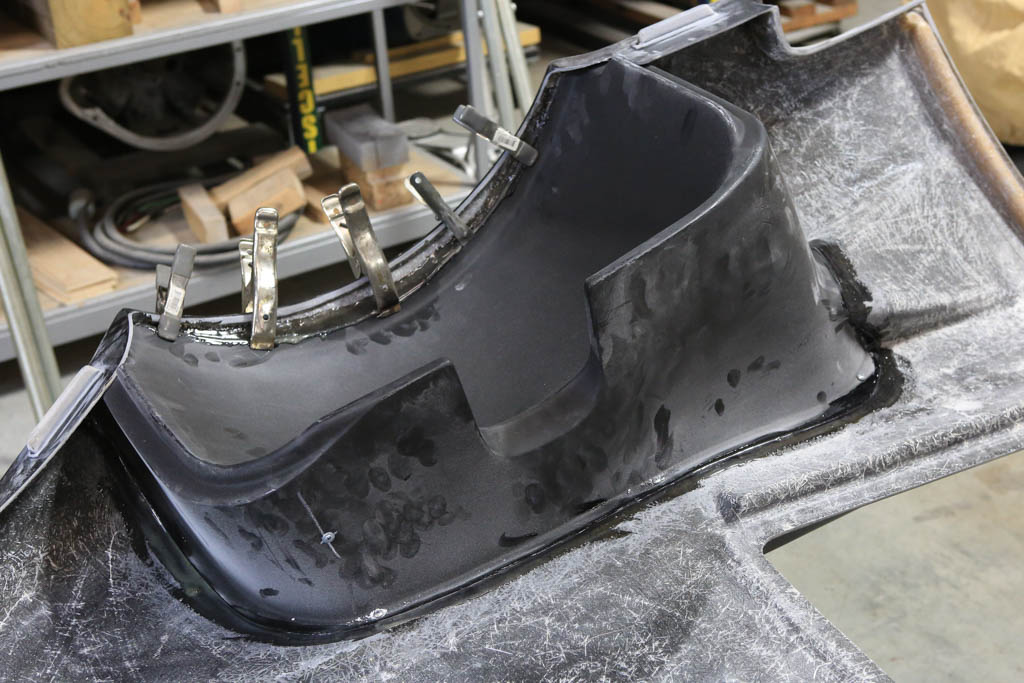

  • Trimmed wheel well lip on rear clamshell.

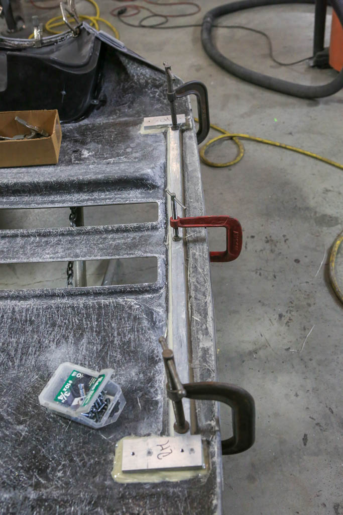

  • Set and bonded in strengthening rod between hinge mount plates on rear clamshell
  • Bonded upper wheel wells to rear clamshell.
  • Installed bushing into upper A-arm rod ends and finished install of upper A-arm.
  • Trimmed bobtail to match support structure.
  • A03B8250.jpgA03B8266.jpgA03B8252.jpgA03B8255.jpgA03B8257.jpgA03B8261.jpgA03B8262.jpgA03B8264.jpgA03B8268.jpg

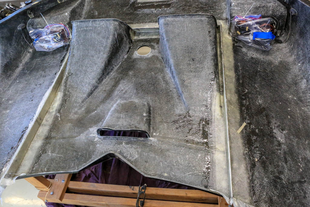

Member

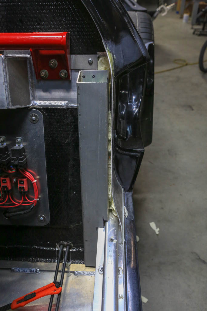

Day 5 (Tuesday, Sept 29th) with "Super H"

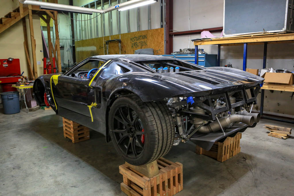

  • Installed hinges on bobtail support structure.
  • Trimmed and fit checked hinged rear clamshell – excellent fit.
  • Located door strikers – will fabricate striker support structure.

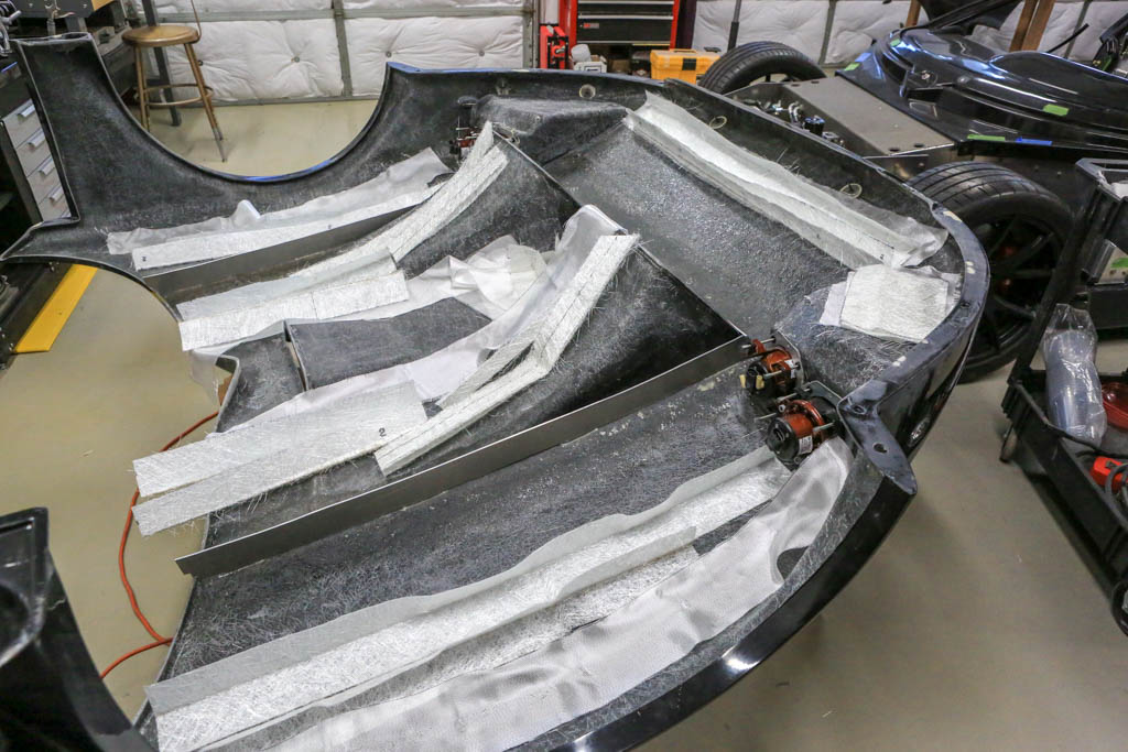

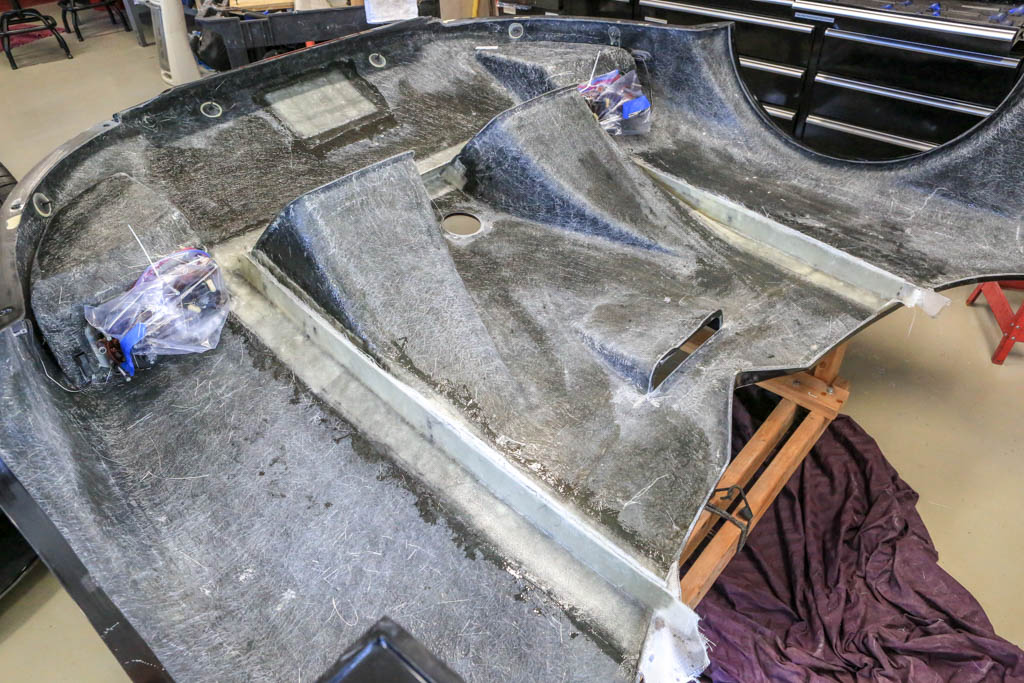

  • Applied fiberglass to rear clamshell support rod between hinge mounts, fiber glassed around rear wheel well.
  • Applied fiberglass to front clip inner fender supports.
  • Mounted/bolted the front clip to the rocker panel.
  • Trimmed lower front clip and install rivnuts in prep for bolting to upper clip.
