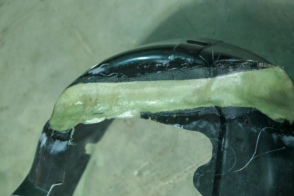

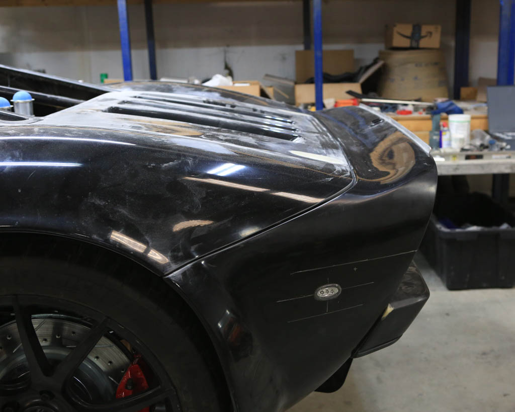

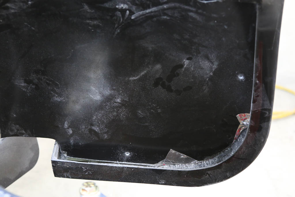

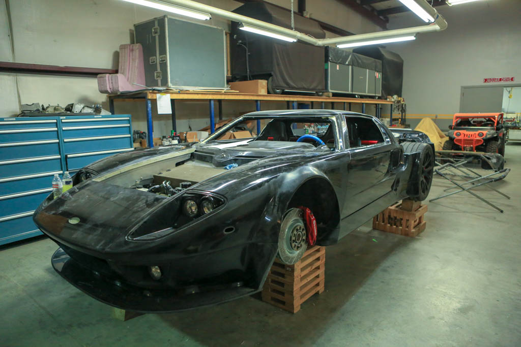

Day 6 (Wednesday, Sept 30th) with "Super H"

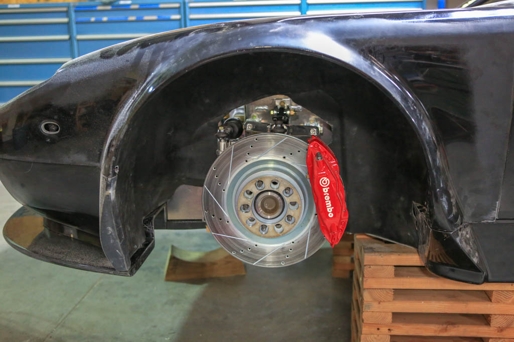

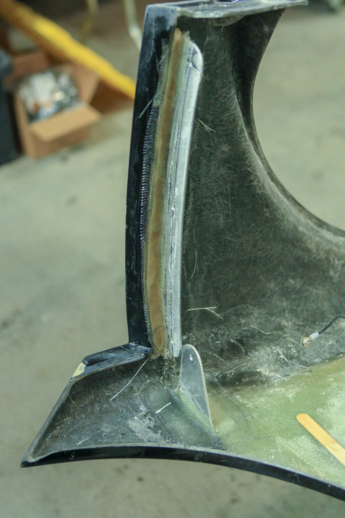

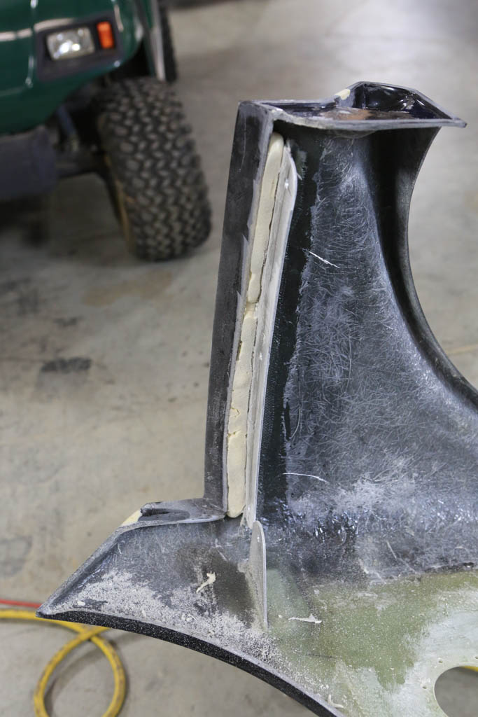

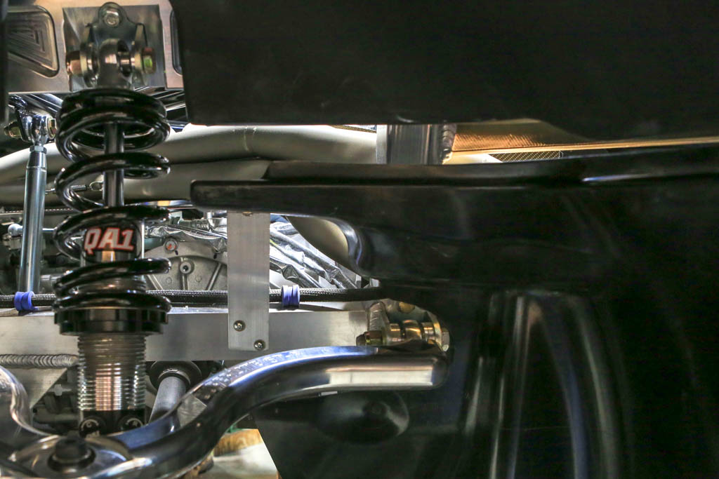

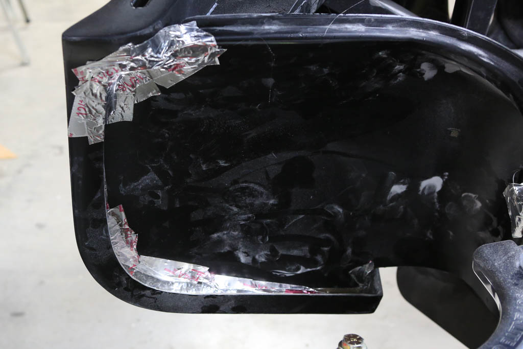

  • Added foam to front clip mounts. Will add fiberglass to blend to wheel well.
  • Completed door striker fab and install – doors close very well.

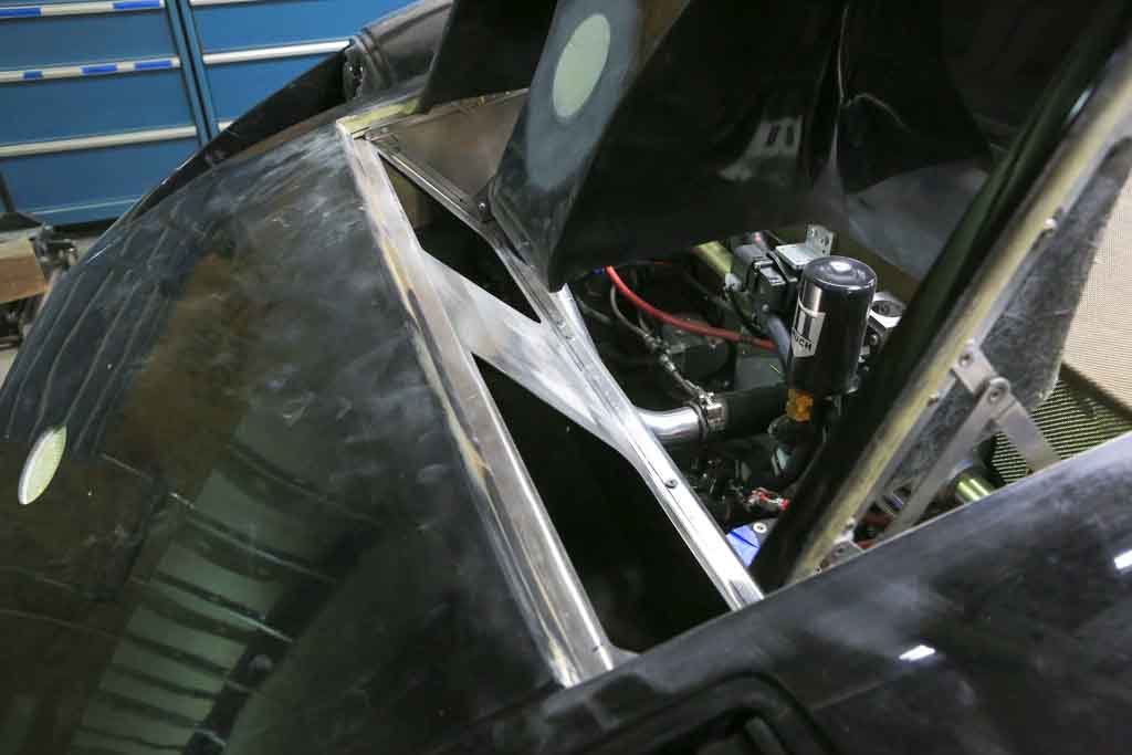

  • Bolted the front upper and lower clip together.

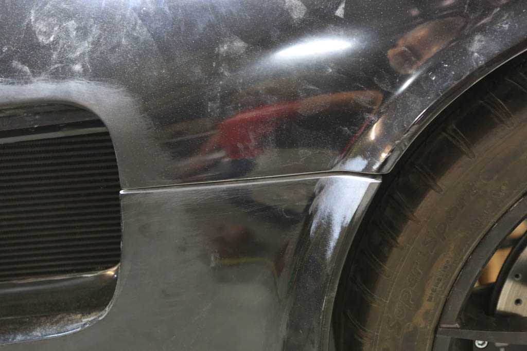

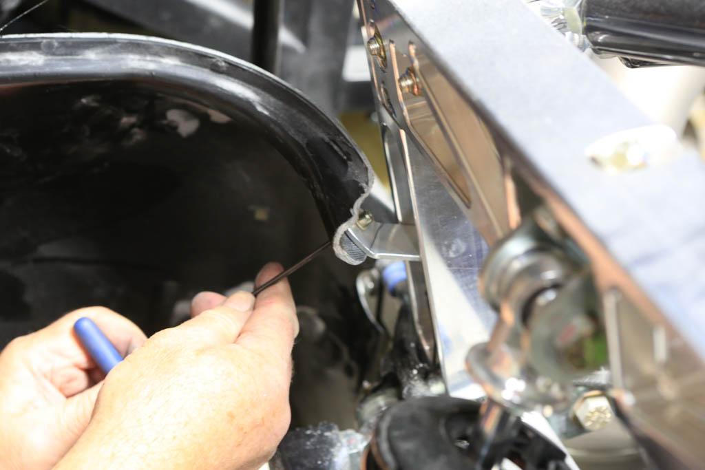

  • Trimmed the front wheel well lip

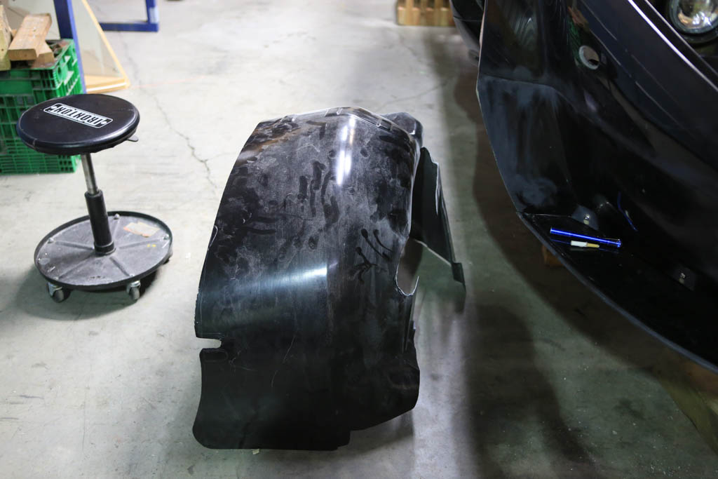

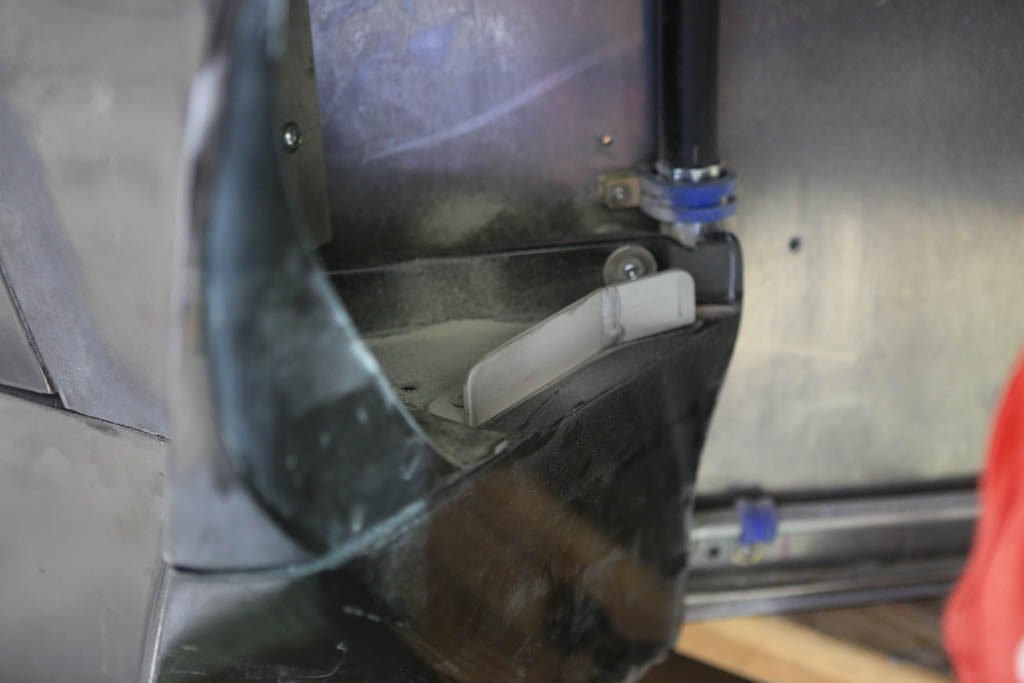

  • Installed the left front wheel well
  • Working on installation of right front wheel well.

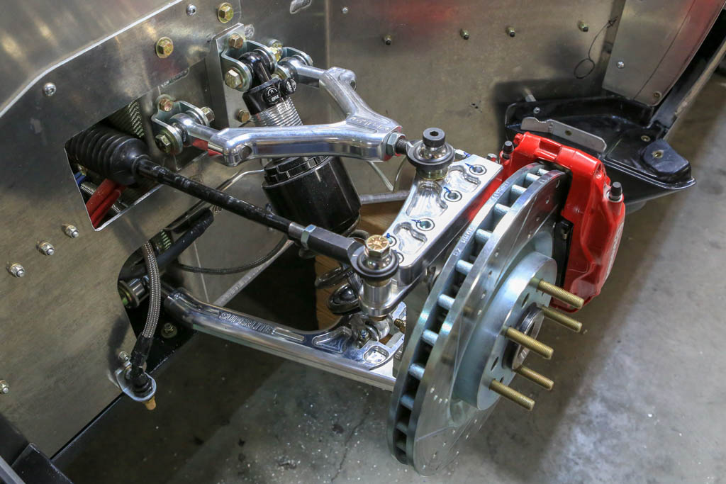

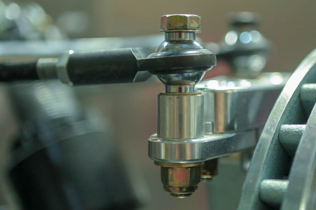

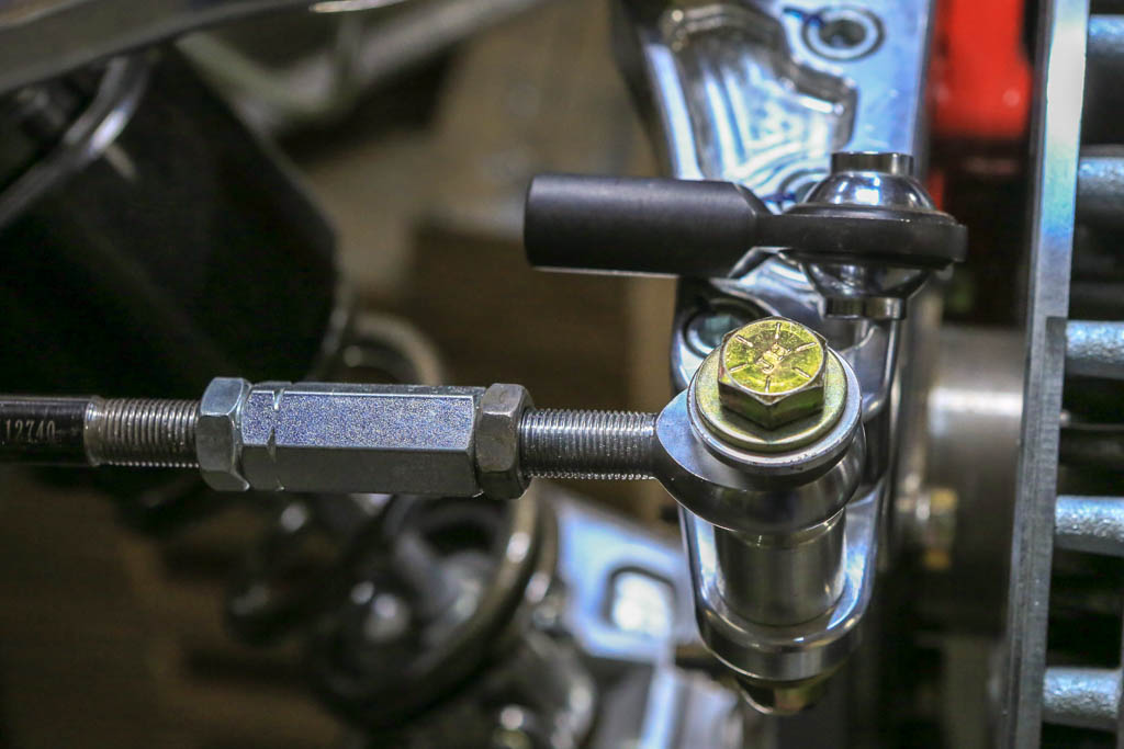

  • Modified left front steering tie rod end (will provide detailed info on modification soon).

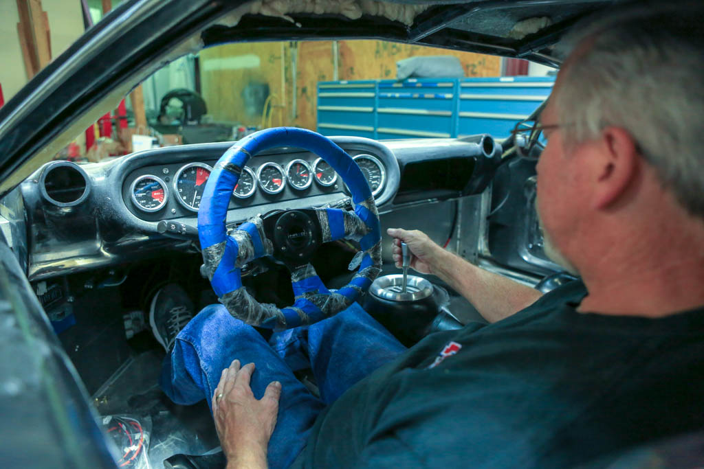

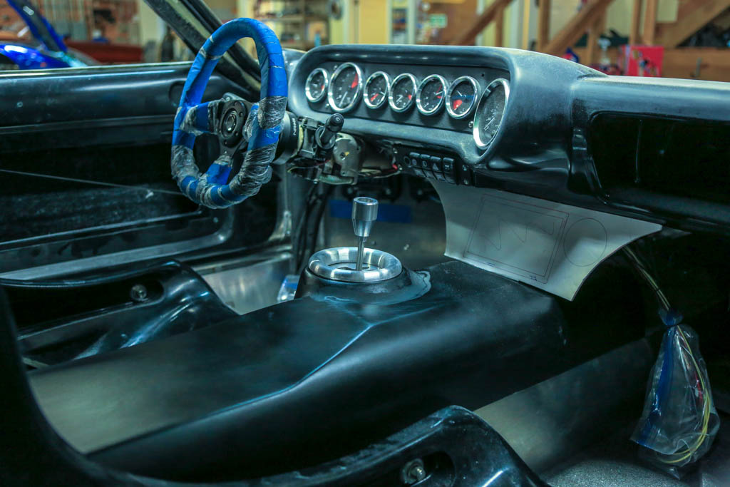

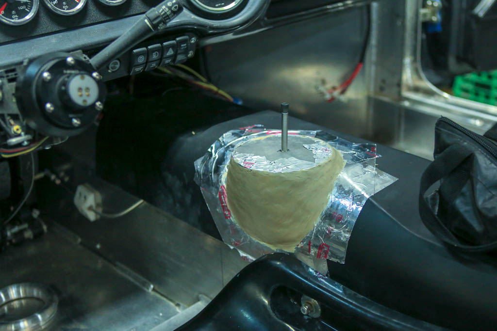

  • Began working on center console install.

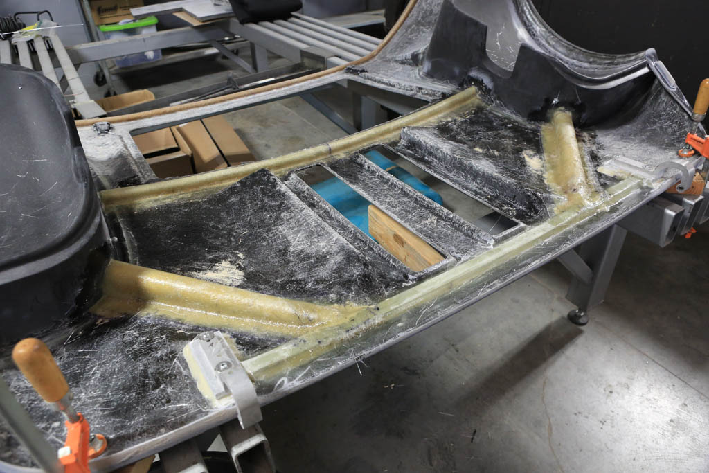

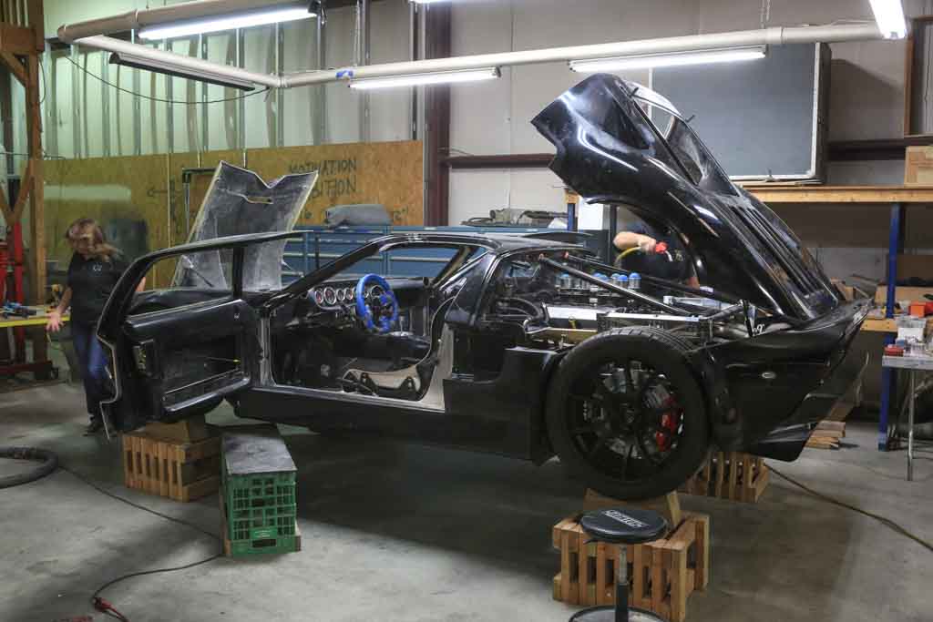

Day 7 (Thursday, Oct 1st) with "Super H"

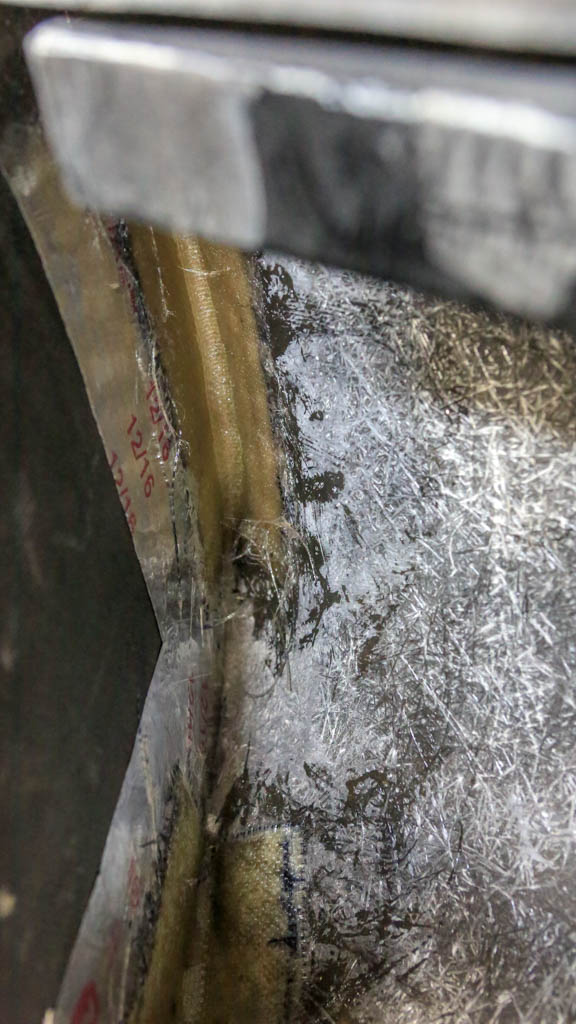

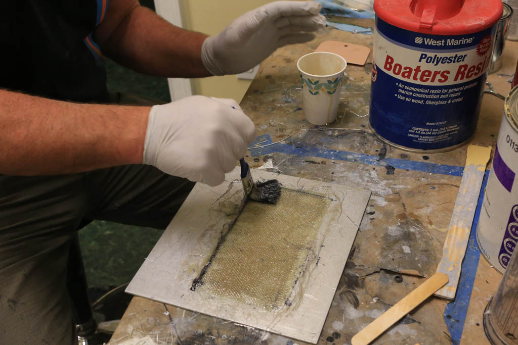

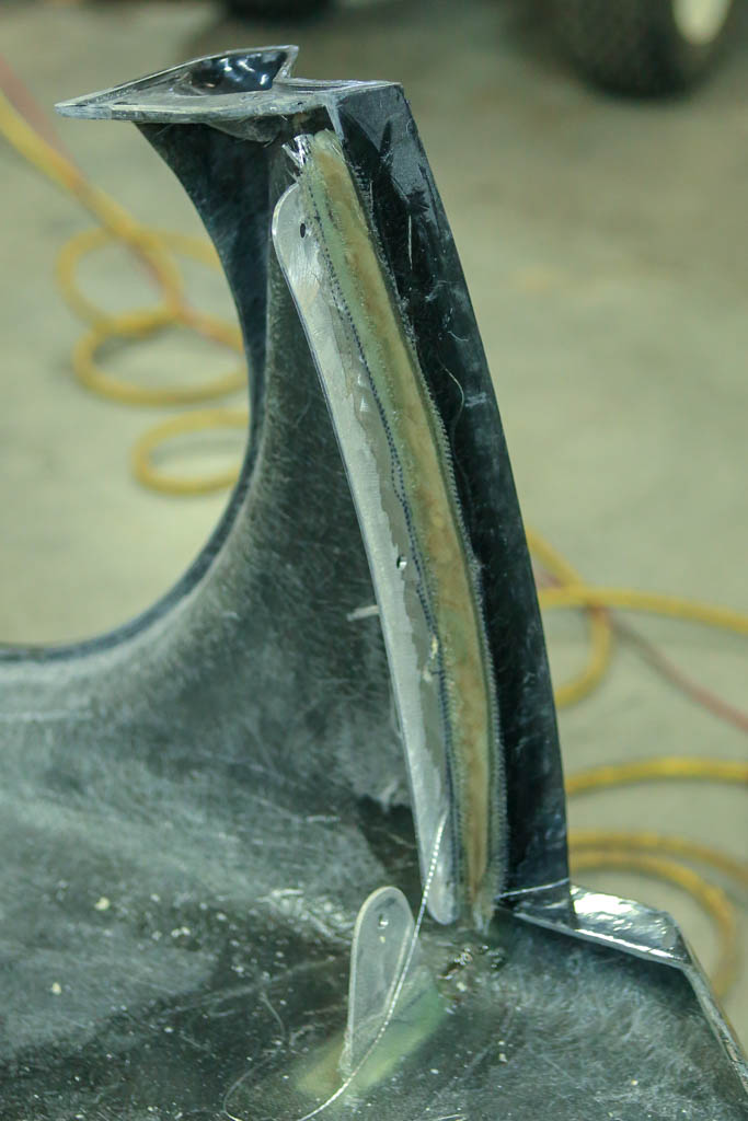

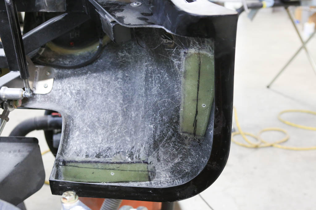

  • Installed front right wheel well liner and fiber glassed around fuel filler tube.
  • Completed right front steering tie rod end.
  • Fiber glassed front clip mount.

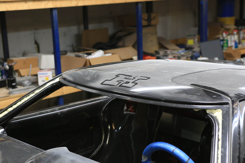

  • Fit checked rear clamshell. Trimmed hinges for better fit of bobtail. Still need to make adjustments to bobtail and support structure for better fit.

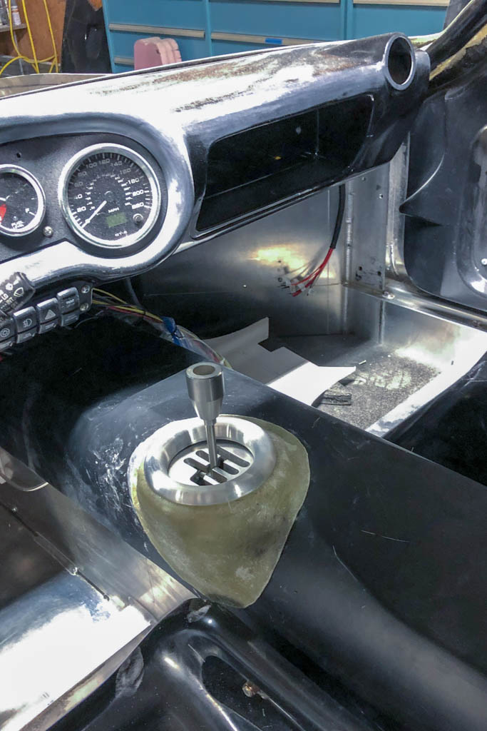

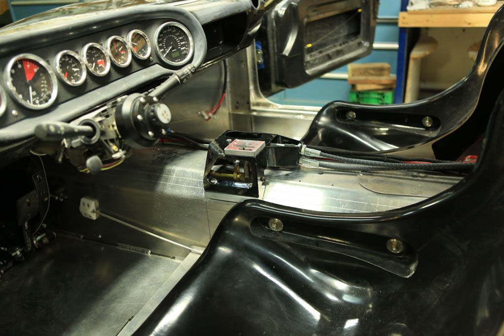

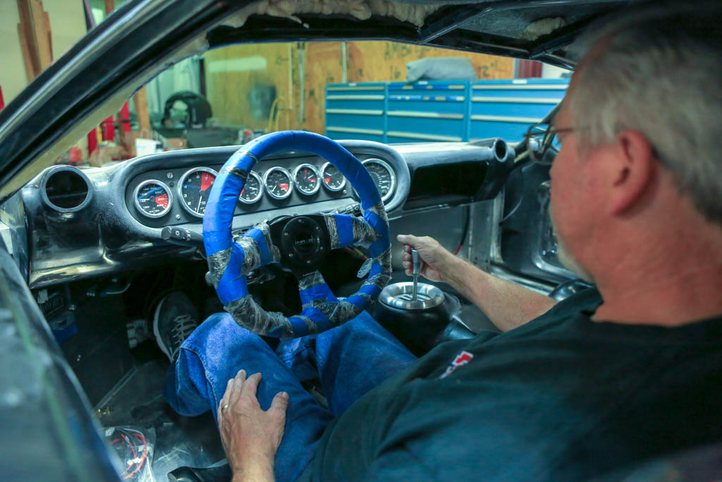

  • For center console:
    • Received center console yesterday.

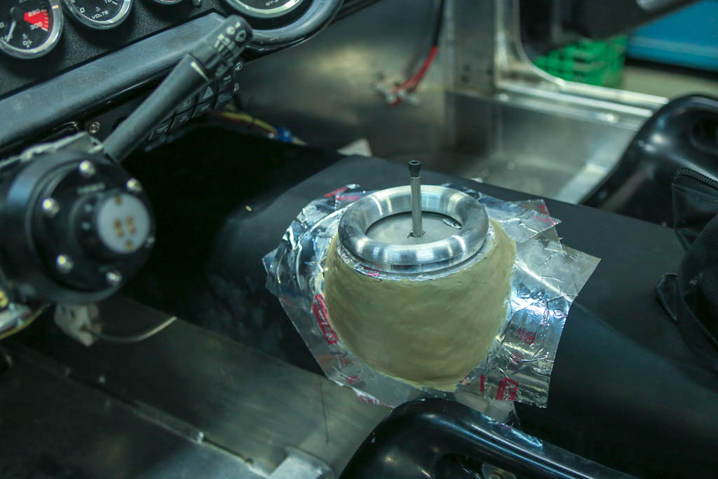

    • Modified shifter for smaller footprint.
    • Cut hole in console to fit over shifter.

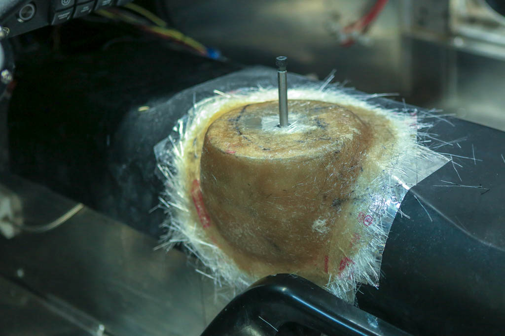

    • Welded/machined circular plate around existing shift gate.
    • Machined trim ring for shift gate.
    • Fab’d console modification to shift gate.

  • Did some finishing touches (Bondo, sanding and primer) on the center console. I highly recommend H’s console – it fits and is easy to modify for your needs.

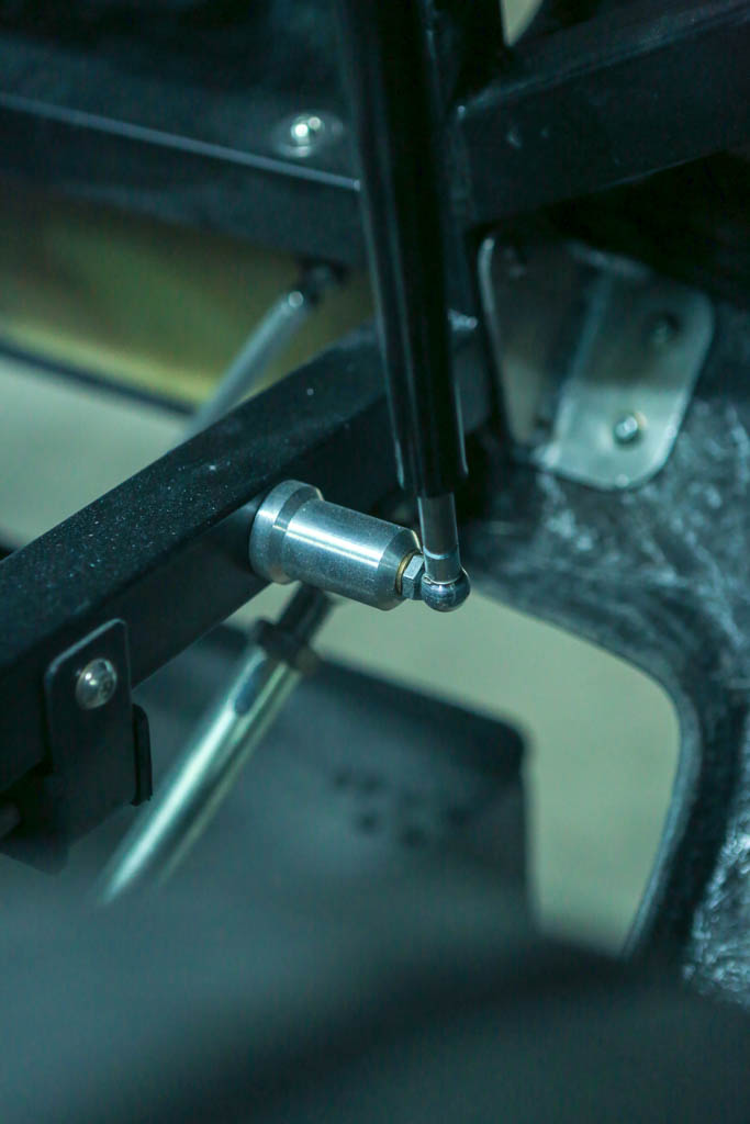

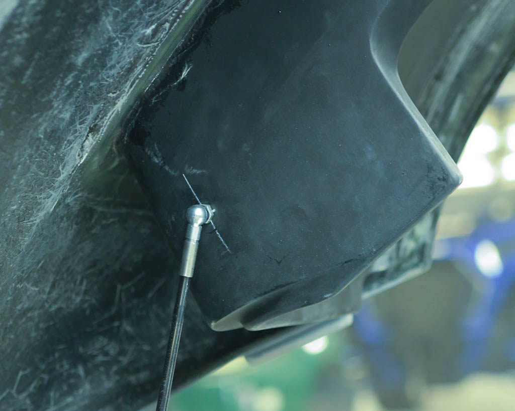

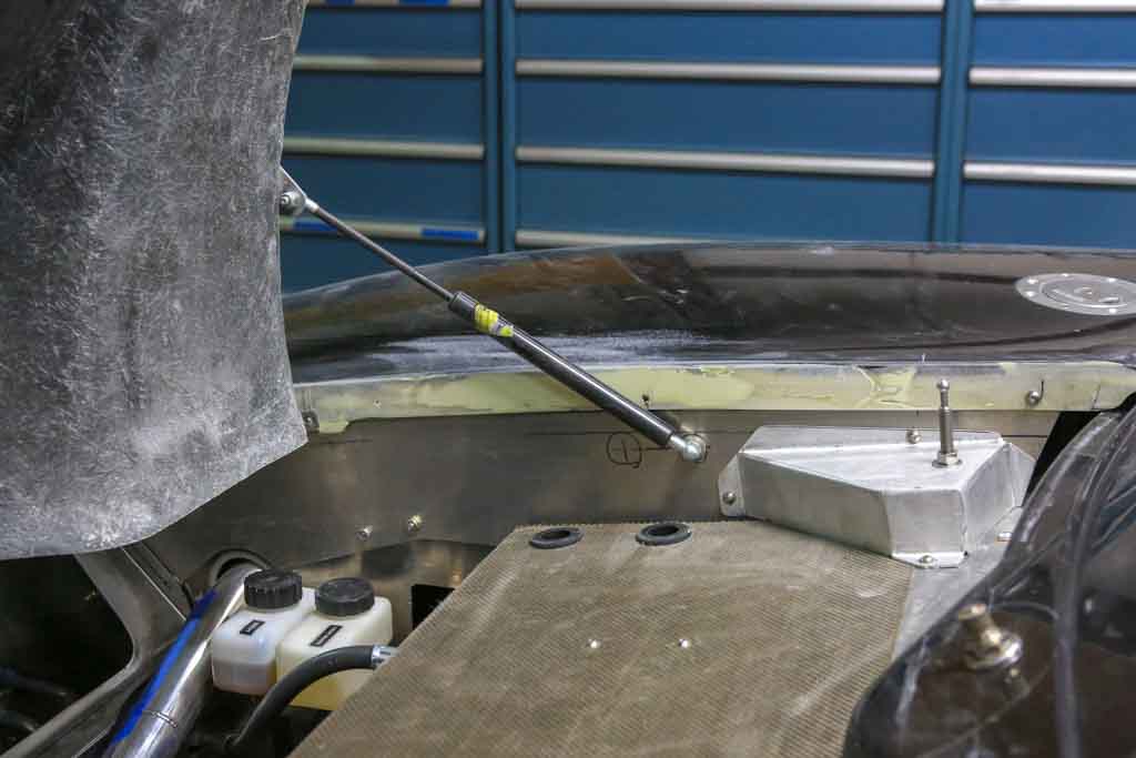

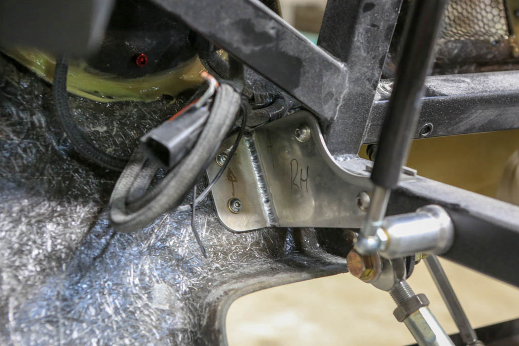

  • Added gas struts to rear clamshell.
    • Added 1” extensions to each end of the gas struts.
    • Machined strut stand-offs that bolt to bobtail structure.
    • Drilled/tapped reinforcement plate that was bonded to inside of upper wheel well.
    • Installed struts and closed the clamshell.

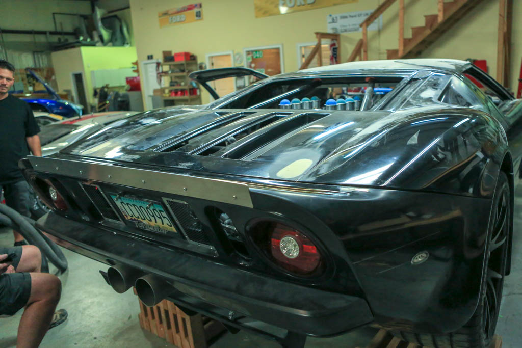

  • Installed rear clamshell and adjusted bobtail. Will leave clamshell installed over weekend and attempt to adjust body fit of clamshell and bobtail on Monday.

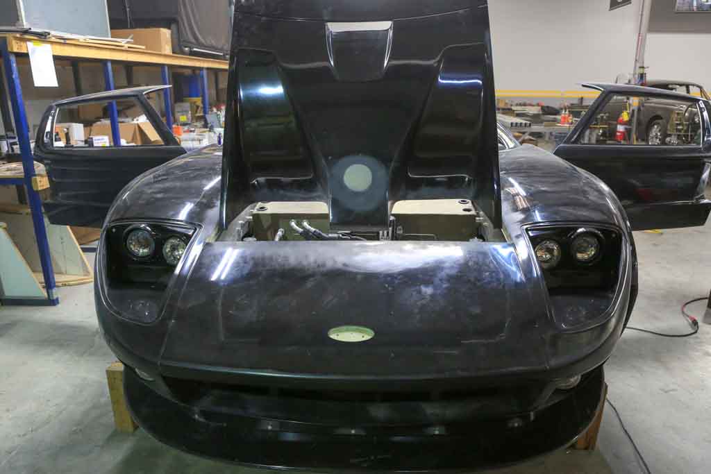

  • Began fitting center hood section to front clip.

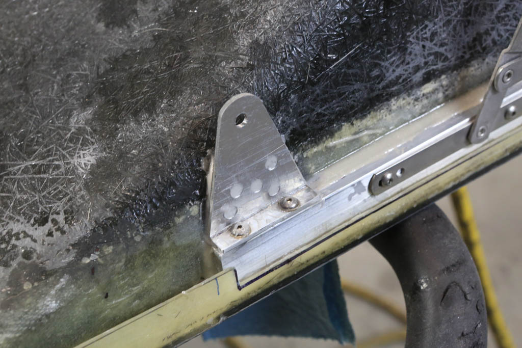

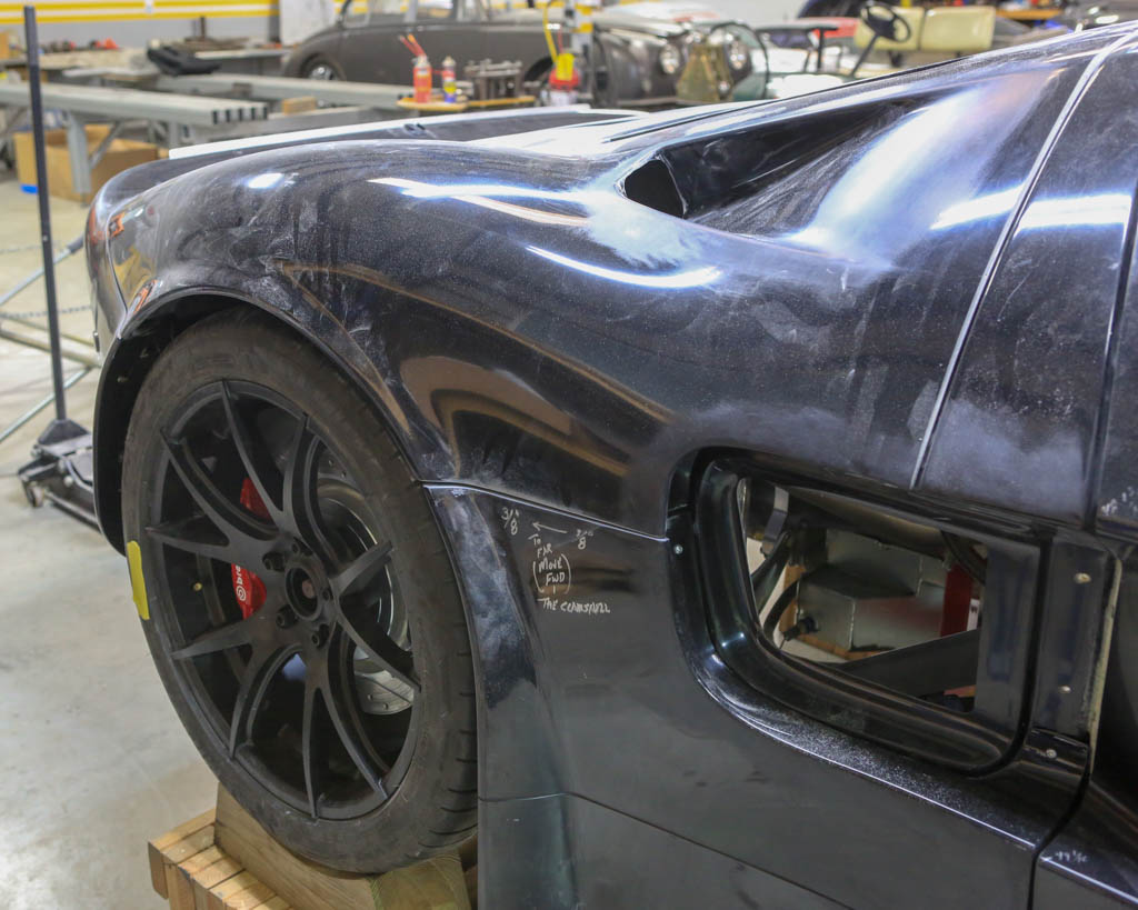

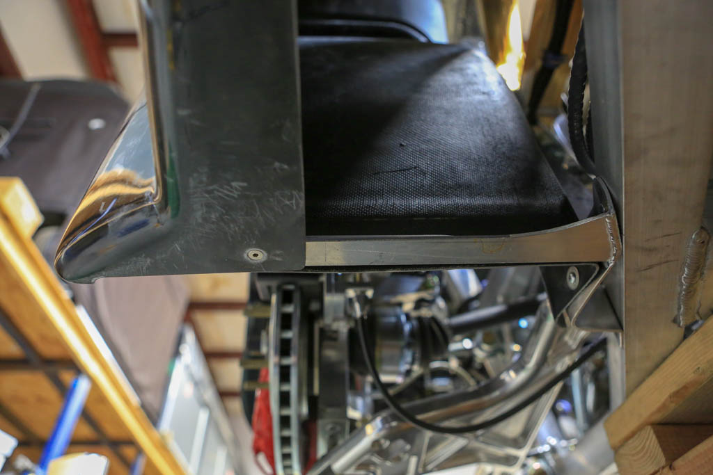

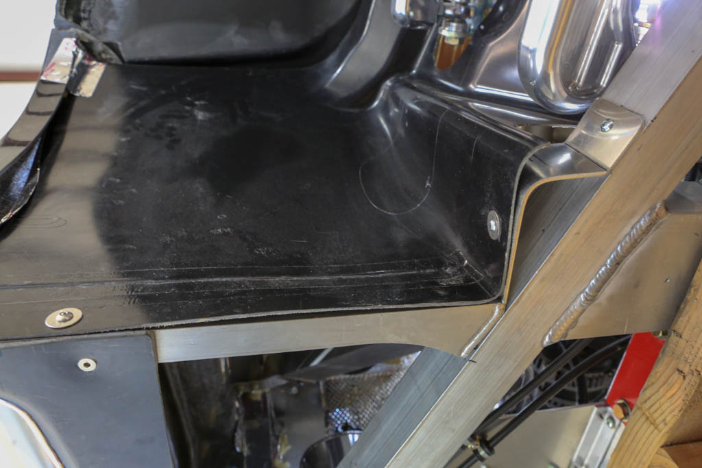

  • Fab’d lower and upper brackets and installed forward section of rear wheel wells
  • Drilled and attached front hood to radiator support stringers.

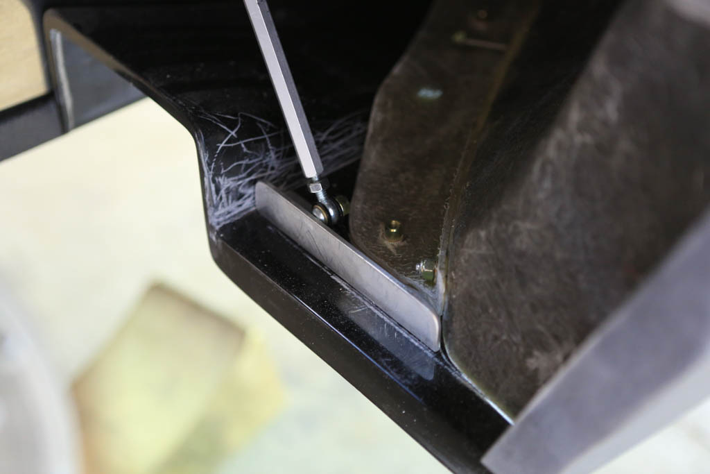

  • Fab’d and bonded brackets for front hood gas strut mounts.

  • Installed new longer wheel studs at left front hub.

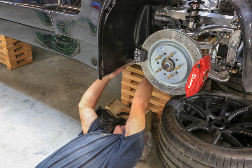

Day 10 (Tuesday, Oct 6th) with H

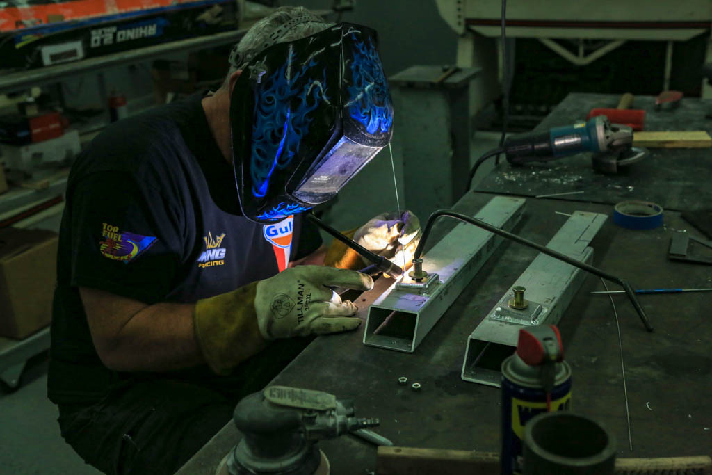

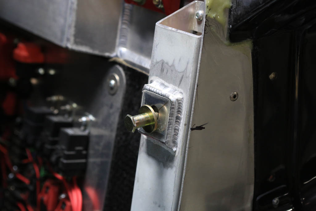

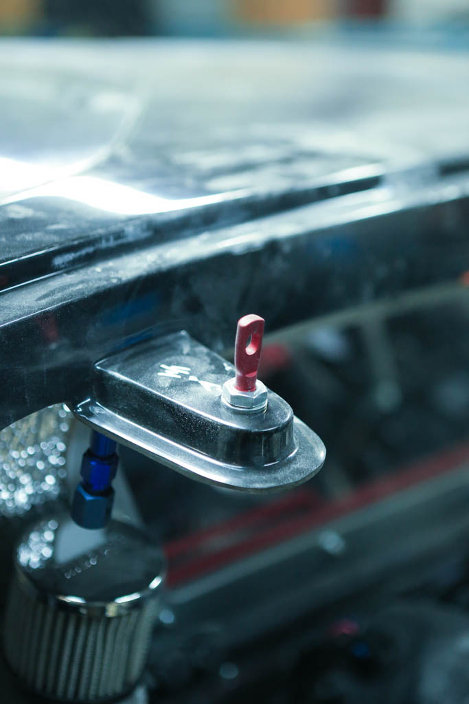

  • Fab’d brackets for front hood to mount Quick-Latch QL-38 series hood pin kit.
  • Installed rear wheel well, rear section
    • Fab’d bracket for upper attachment

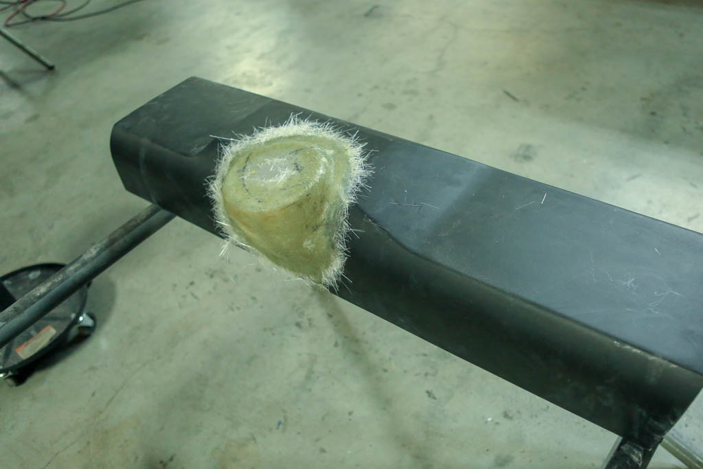

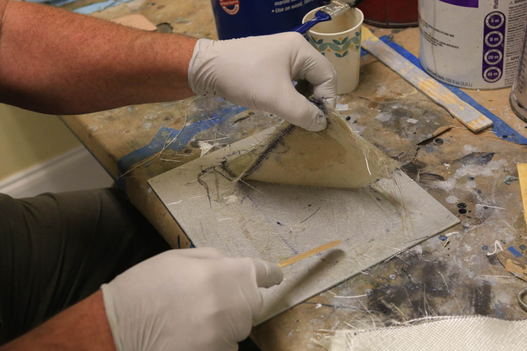

    • Used wet fiberglass layup to fab/shape lower attachments on both front and rear sections.
    • After cure, drilled attachment holes then removed wheelwells
    • Trimmed fiberglass attachments and installed rivnuts
  • Completed rear bobtail brackets to strengthen bobtail/bumper mounts.
  • Adjusting/fitting rear clamshell.

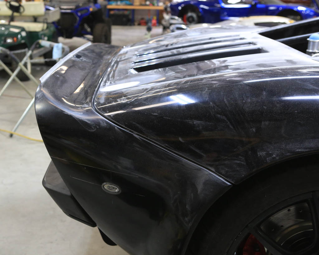

    • Trimmed rear section of clamshell
    • Trimmed alignment fingers (“chocolate fingers” per H)
    • Adjusted bobtail height
    • Had difficulty with clamshell/bobtail fit due to clamshell flex with gas struts installed. Decided to add structural stiffening to clamshell – curing overnight
Kurtiss H.
Member
Day 11 (Wednesday, Oct 7th) with H at H Craft Customs

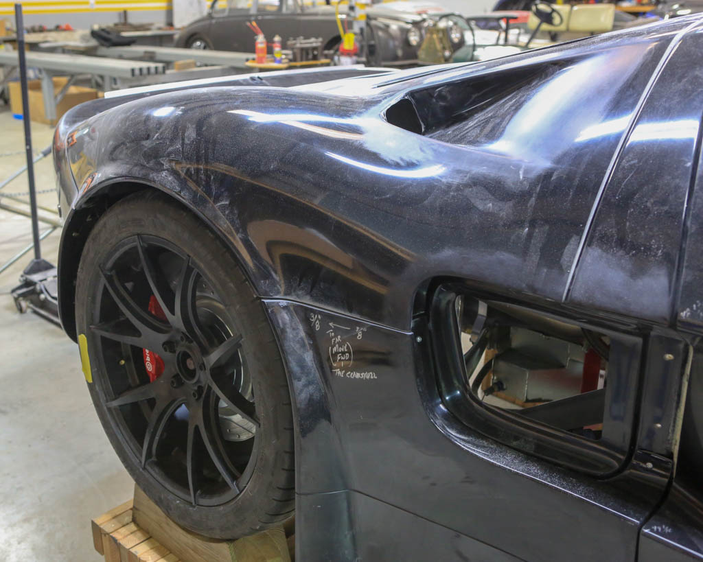

  • Rear clamshell cured overnight. Cleaned up the fiberglass, applied a light coat of black paint and installed. Mounted the gas struts and closed the clamshell - It fits so much better!
  • Reinstalled front and rear sections of the rear wheel wells and installed tires - back end is complete.
  • Installed front clip, wheelwells and tires for last time. Adjusted shock spring height for that great H look.

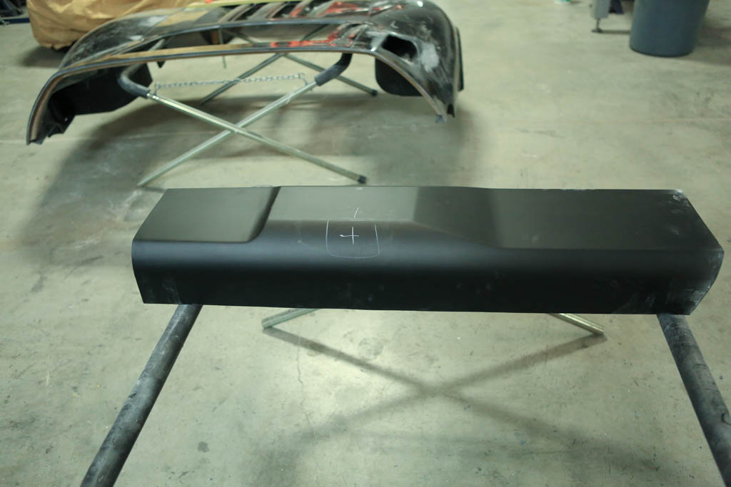

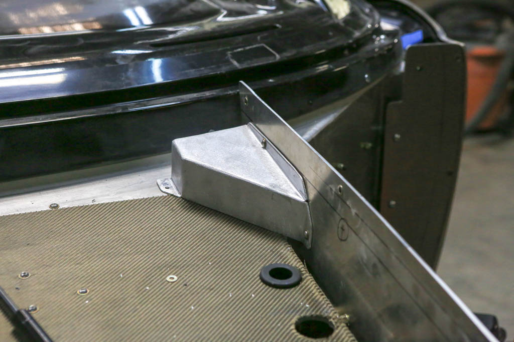

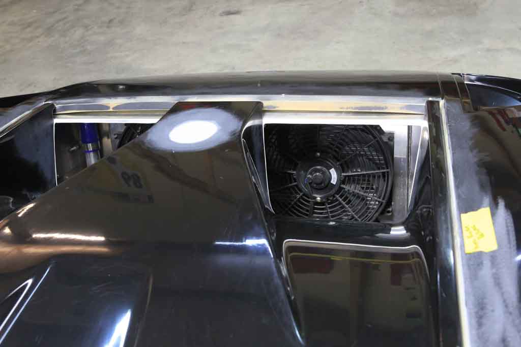

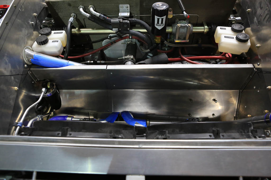

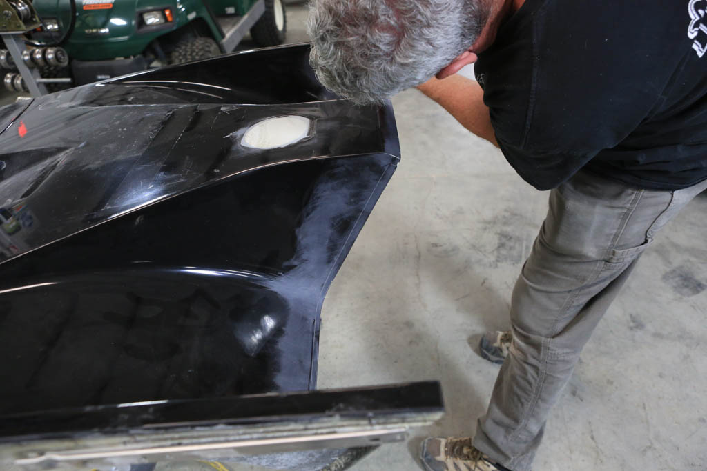

  • Began working on radiator ducting. Like all body panels, the sheetmetal was bent, trimmed, fit checked, removed, trimmed, installed, marked, removed, trimmed, installed...
  • Began working on front hood. Trimmed hood to match sheetmetal duct. Will install gas struts and Quick-Latch’s tomorrow (the last day).

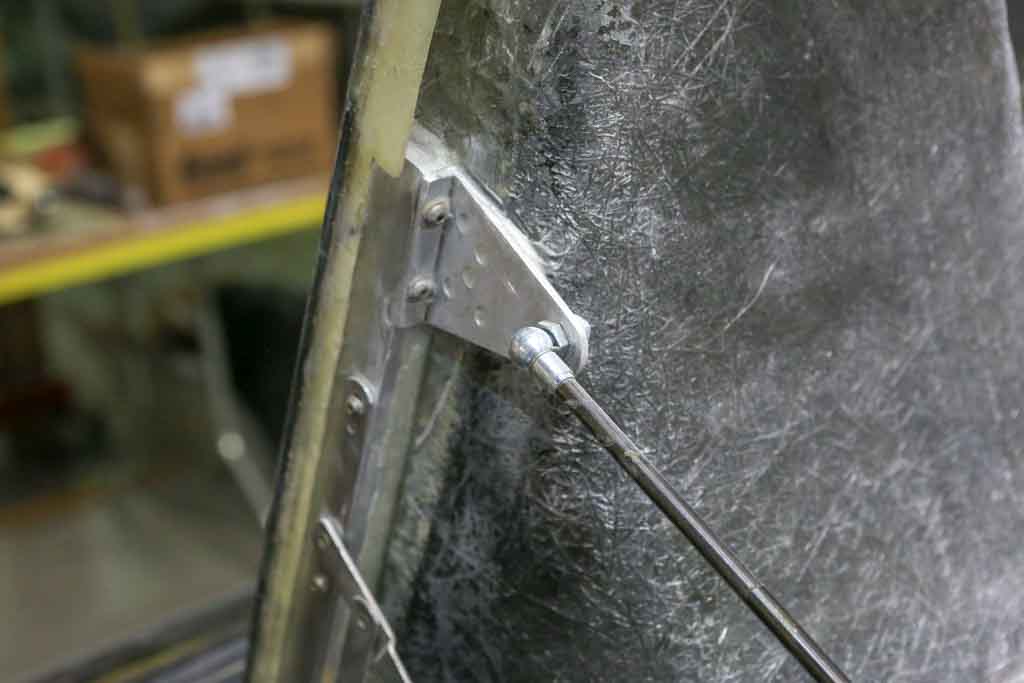

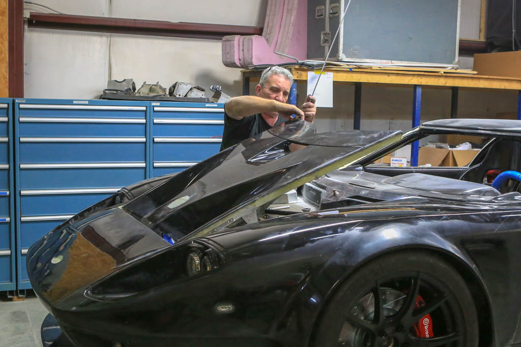

Day 12 (Thursday, Oct 8th) last day with H at H Craft Customs

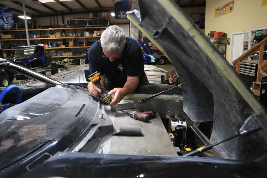

  • Worked on front hood and did a little more trimming on hood to match sheetmetal duct.
  • Installed gas struts on hood.
  • Installed Quick-Latches and pins. Will do final alignment when I get back home.

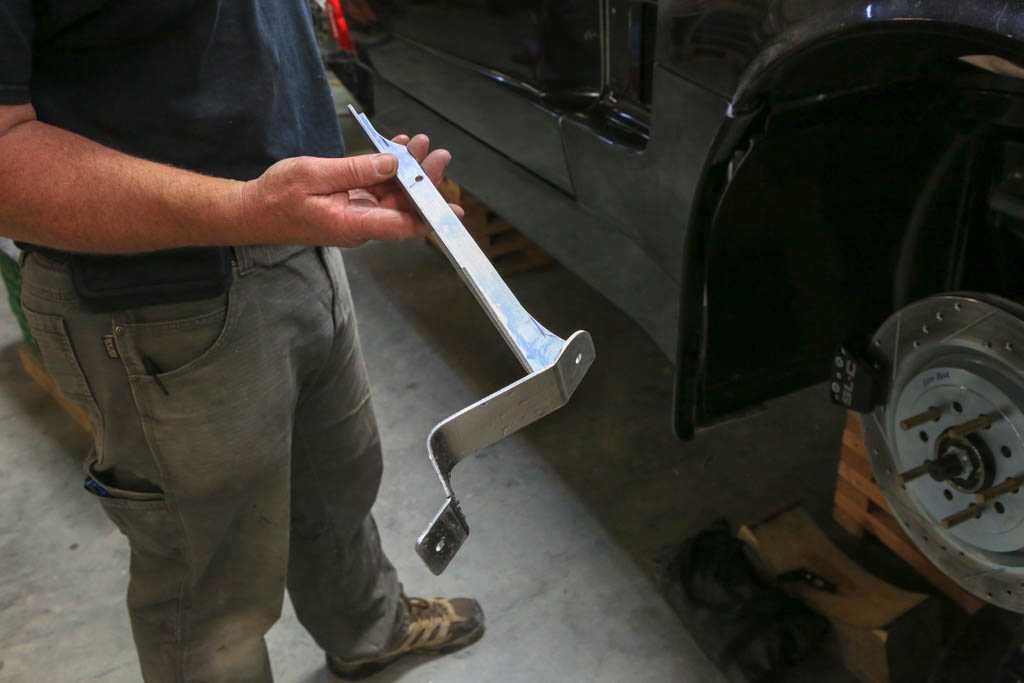

Kurtiss I made a pdf template of the front shock mount spacer if anyone is interested (set printer to 100%). Thanks for doing the write up on the process.
  • GT-R shock spacer.pdf
