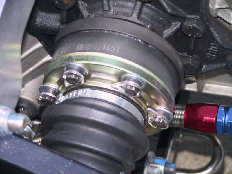

Thought I might take a minute and update everyone on the availability of good quality locking fasteners for CV joints. For those who have been worrying about this here you go. They are made by stage 8 fasteners. The are essentially a 12.9 grade 12 point head bolt with a grove cut in to permit the use of an indexable tab and e-clip.

Gary:
What potential problem with 500 to 600 HP motors are being addressed with these bolts/fastners.
Regards, Buzz
There is basically no great method of locking the fastners. You can use locktite (grease all over the place makes it difficult to implement), or use safety wire (must drill all of the bolt heads). This is the easy and effective way to lock the bolts. I am a big fan of being able to lock all fastners when possible. This is common race car and aircraft practice.

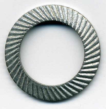

Hi Gary, A while back I asked the same question because I wanted a second opinion about the lock washers that the local Porsche racing team use on the GT3 cars. They gave me a set of 12 to put on my CAV. I will post the picture again. they have the same grooves on both sides of the washers. They torque them to 60lbs. on the race cars ond 50 lbs. on regular street cars. Does anyone know how many lbs. of torque on the 016 Getrag? Joe /ubbthreads/images/graemlins/confused.gif

I forgot to mention that can be gotten at any Porsche dealers parts dept. /ubbthreads/images/graemlins/smile.gif

I have drilled heads many times before, and this is an option. The only problem I have with that is it is not a lot of fun. If I only drill a single pass through the head the holes frequently end up in poor safety wire orientation after torque. Predrilled aircraft style bolts usually have 3 passages so you have a hole 60 degrees. I see no real problem with this Stage 8 setup as the bolts are top notch and the locking system seems very adequate. I had no problems with e-clips and everything went on rather quickly and easily. With the slight assymetry of the lock tab grooves (thus can be flipped) and the fact it is 12 point fasteners the tabs can be oriented to have little to no play. I found it easier then drilling a bunch of bolt heads /ubbthreads/images/graemlins/smile.gif
These anti-vibration washers are known as Schnorr washers and are available in imperial and metric sizes and should be available from most good engineering or workshop suppliers and not just Porsche retailers.
Graham @ GTA Racing.
Graham, Thanks for the info. How good are they? Have you had good luck with them? Have you ever had them come loose? Joe

I love this system, but unfortunately for CV joints you are stuck with metric. The ZF uses 10 mm bolts. I had a concern about the e-clips flying off, but after talking to the Stage 8 tech rep and doing a little math I think things will be just fine. For example, at 200 MPH the clips will only be subjected to 9.5 g's. When installing and removing the eclips the force appears to be a couple hundred times their weight (next to nothing). Thus it would take a couple hundred g's to throw them off. Something like 1000 MPH. I did not measure the release force, but it seems much much more then ten times their weight. I plan on keeping an eye on them after I run on the track. If I throw a clip I will be forced to drill heads and safety wire. As an added benefit the tabs will tend to tighten the bolt with centrifugal force albeit a very small force /ubbthreads/images/graemlins/smile.gif
