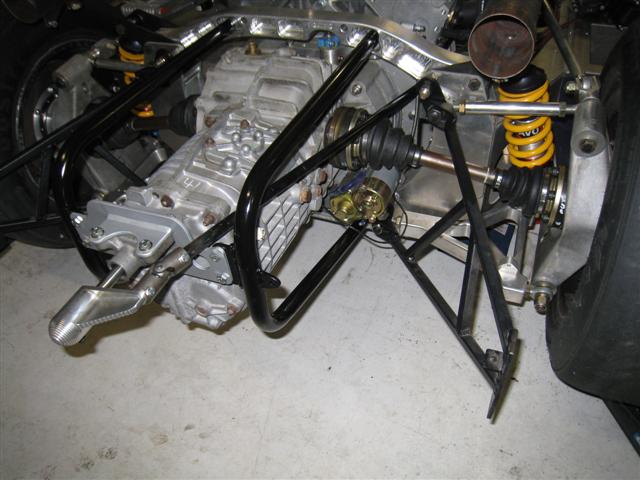

Have to agree with Dave Deerson on this one --we've been running like this for years , the important issue is grease boot quality selection
flatchat(Chris)
Tx. err, thats the heavy duty prototype :shy: --It does work really well tho

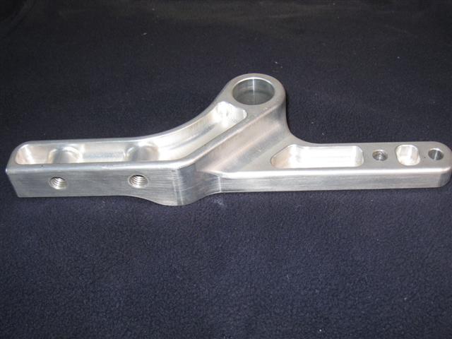

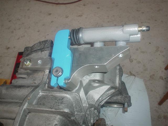

Chris, made mine from a hunk of billet too, not quite as elegant as yours but still
"pretty" and functional. I'm using the Brantwood cable system to shift.

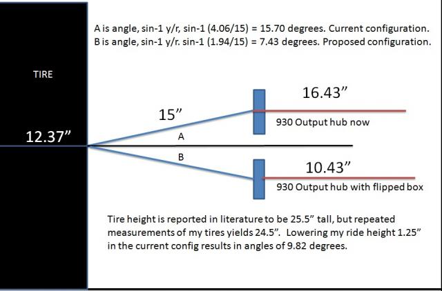

Ron, check out these driveline angles !!
If they're not worried about them.............
http://photos.gpupdate.net/large/168978.jpg
Those aren't quite as high as mine......15.7 degrees.
But I see your point.
