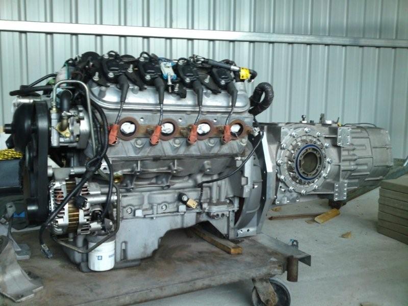

Is there a particular (wet sump) oil pan that will work best (in terms of fitment and ground clearance)? Batwing, standard ls3 crate engine, f-body, gto, corvette, etc... etc...?
Getting closer to the engine being completed - got the final componentry coming in shortly - Mozez heads .... mmmm, almost 500cfm flow :D

However my builder wants to know what type of pan he should use on it and gave me all those choices......I don't want to guess it will fit, and then have to start changing it out down the road.

Interesting - this is the first I've heard about pans not working - I thought others (e.g., Cam) just used whatever came on their crate engines? (edit: or maybe not since I just looked up ls376 crate and it says delivered w/o an oil pan)
Hmmmm. Is the pan you got Kevco to make wet sump and compatible w/ all LS's? Any special baffling features in it? Maybe I should just contact them and ask them to make me the same one you got? (Alexisisisisis at work borrowing other people's design ideas here, hah!)
edit: My motor mounts are offset backwards from the horizontal beam they're welded onto, which was probably an addition made to later chassis to allow for a stock pan to clear? Rob, where your motor mounts are welded to the chassis, are they welded to the centre of the beam, or offset backwards?

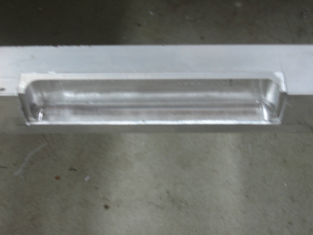

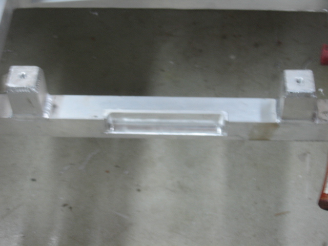

Alex, I believe the LS7 set up has the engine mounts centered on the cross member. I know Cam has the rear offset for his LS3, probably like yours. My engine mounts are also centered, but I had to notched the cross member to accommodate my oil pan. It's a different ball game with your big block, measure twice cut once. As it turns out, I will cut out my cross member and move it forward 1/2" so that the new rear tail will fit over my ricardo. I already had to cut a hole in the tail just to get it on so I could route the exhaust. Plus I plan on poly mounting the entire drive train.

My engine mounts are pushed backwards
So it looks like that was done for oil pan clearance (i guess a standard ls3 corvette oil pan will fit now)
Btw, I don't have a big block - the RHS is dimensionally the same as any LS motor, except it's 1/2'' taller at the V, can take a huge crank and a bunch of other stuff. but other than that it's the same.

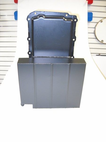

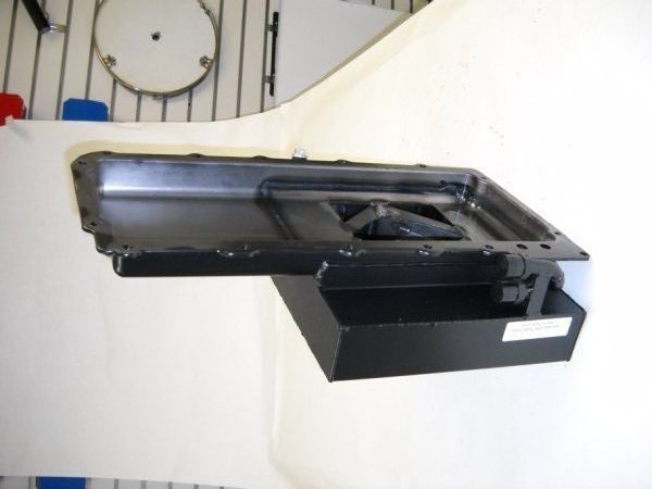

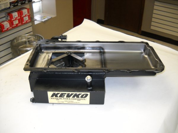

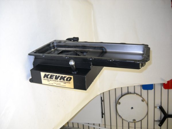

This is a pic the pan design, although mine is cad plated and slightly narrower....and come to think of it - has that notch for the drain plug too (maybe that is a standard need on some other car???) I don't recall the price exactly ..... but 325 rings a bell.
