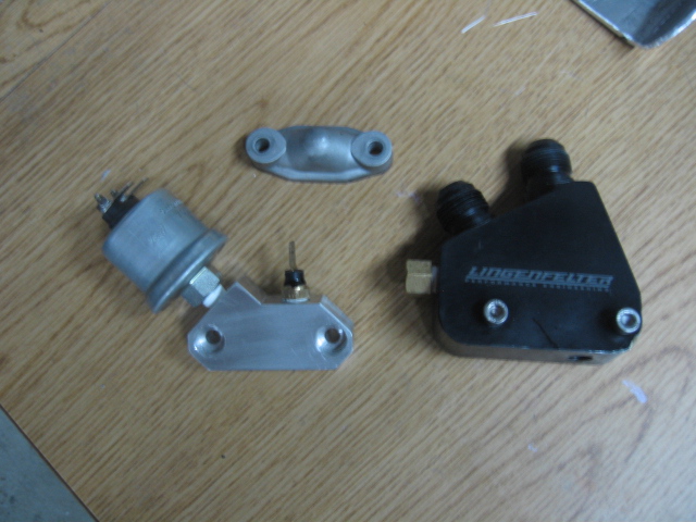

Alex, regarding the oil pressure and temp sensors. There is a block off plate right behind the oil filter. If you are using just one sensor you can drill and tap that plate. If your running an engine oil cooler Lingenfelter makes a nice piece that has ports for both sensors. I didn't like running oil lines so close to the exhaust and didn't plan on running an engine cooler, so the Lingenfelter adapter is on the shelf. I made my own adapter. All three are in the pic. The small one is the stock block off plate and mine is the one with the sensors in. Whatever method you use make sure it's designed to circulate oil (loop).
