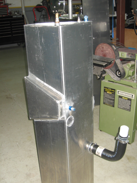

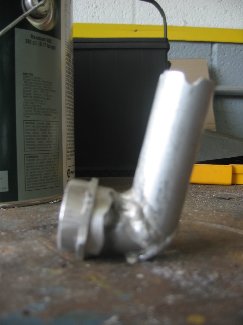

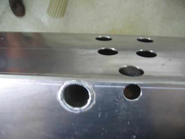

check out posts 305 -311 on Cam MacIssac's build log. I did a quick sketch of what we have been doing. I chose to put my swirl pot on a shelf for a while and chose to try a sump first. It holds 6/10 of a gallon with baffles,compared to the swirl pot holding 1.25gals. I think it will give me a good supply of fuel until I get real low. What do you guys think?
I think your idea of a sump is a terrific idea :D
Sumps unite :D
That swirl pot works like a champ. I've not hit a corner or hard brake starved for fuel. I think the bosch44 is a better fit for LS 3/7 engines than the aeromotive A1000. Unless you're planning on 1000hp, your recirculating/heating fuel for no reason.
