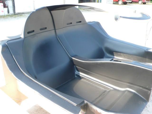

Interior tub ... Fran has them in standard fiberglass and carbon fiber.
Fran,
How is this mounted to the chassis? Is it bonded or bolted to the Chassis. i assume that the upper section is bonded to the roof. But I'm just curious about the tub. It really looks like a great piece for the SLC.
I know it looked awesome in the LeMans version that you had in Charlotte.
fernando

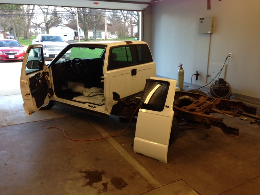

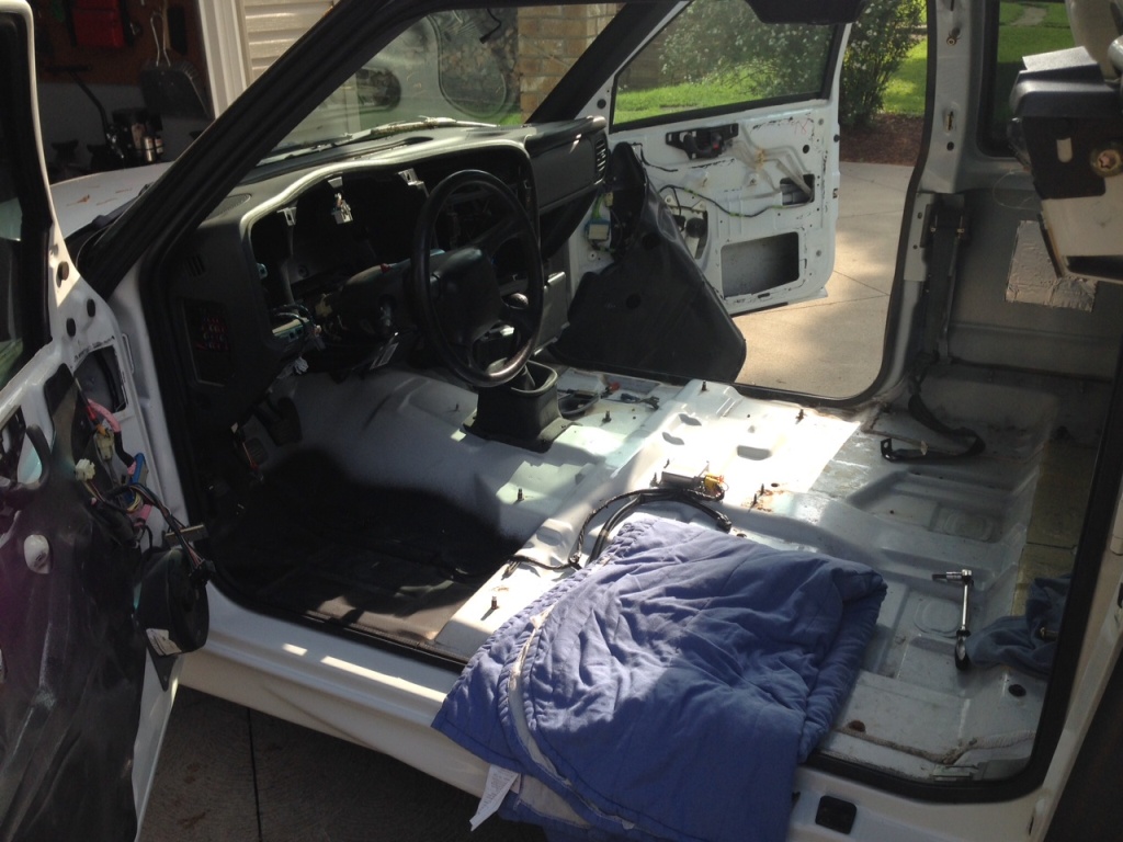

So my nephew turned 16 years old ... So Uncle Bob (me) is gonna fix up something for his first car ... One thing leads to another as you all know.
What started off as just some small issues with a nice used truck, turned in to a partial respray, LOTS of small things, and an interior cleaning that ended up gutting the cab.
So a few weeks later and it's back together and out of the shop! NOW can I get back to my SLC ? LOL
(Just didn't want anybody to think I was slacking off)

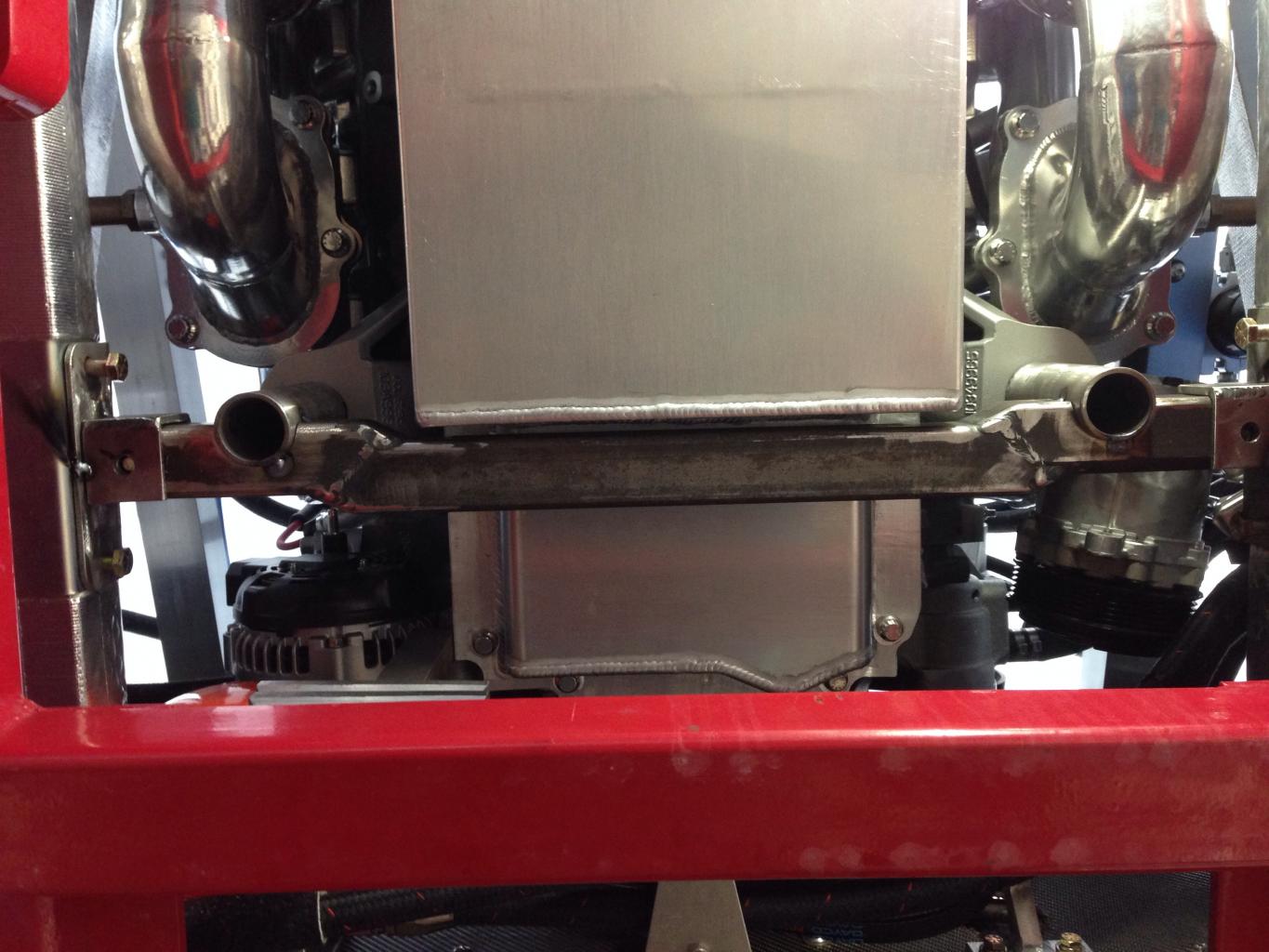

I highly doubt it Bob.
Maybe you could remove the stock GM motor mounts from the engine whilst supporting the drivetrain and slide the engine mount crossmember for or aft and get enough clearance to remove the oil pan?
Warning to all. It is near impossible
to remove an oil pan from an LS.
Or at least it was for me with my
combination.
End result was to cut out the cross
member, remove it in three sections,
and fab a new one that will come out
If needed.
Parts are at powder coater, I'll post pix
once it's all back in.
The GM mounts that Fran supplied. With the windage and pickup tube on this LSA .... The pan had to come STRAIGHT down. I felt I was too far along to considder removing the engine, just to get the pan off. The way that the cross member is now held in the "pockets" on the ends, I think it should be as strong as the original design, but will allow removal. Hope Fran approves ? LOL
