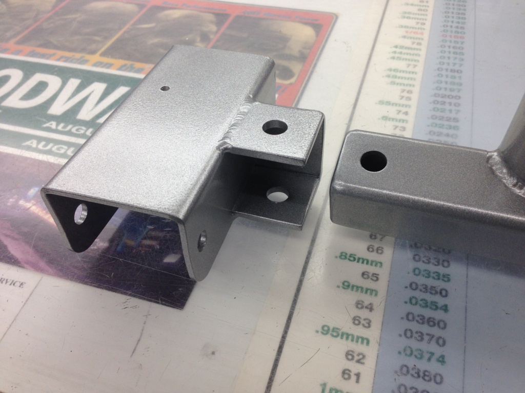

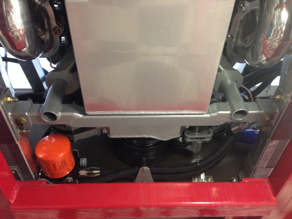

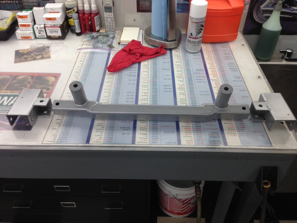

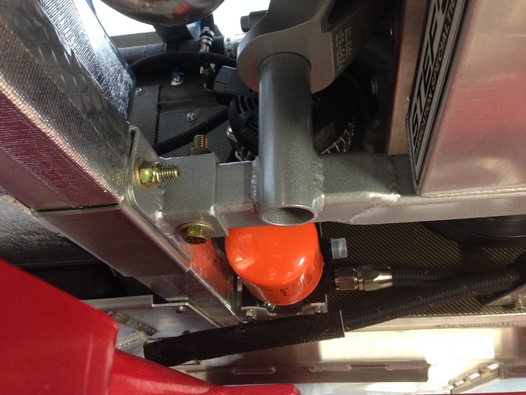

Cross member coated and installed. Bolted right in so if at any time in the future (hope not) the pan can drop out with no issues.
*Proper length bolts to follow*:thumbsup:

Bob,
I know that you probably know this, but with the engine crossmember bolts mounted the way they are, if the nut comes off the bolt will fall out. If there is room to reverse the bolts, I would do so.
My 2 cents.
Great job!

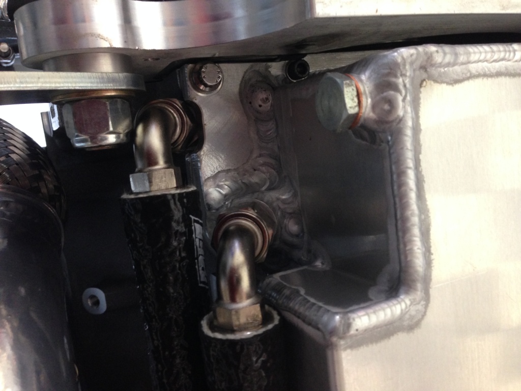

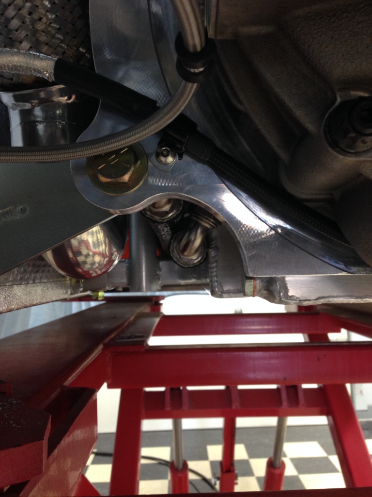

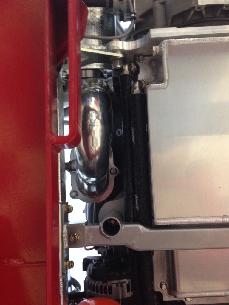

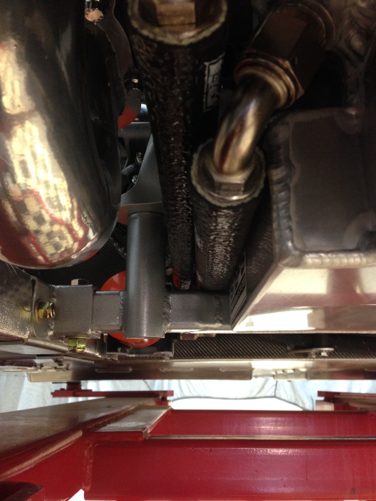

So the main reason I had to remove the oil pan was the oil lines that come from the side of the pan. Using a fabricated oil pan, you have to run lines to the filter and oil cooler. I SHOULD have noticed this on the engine stand, not months later in the car .... that's on me .. but there was no way to get the lines away from the exhaust without using multiple fittings, and I still had 1/16 of space. The solution was removing the pan. TIG welding the hole shut for the return side. Machined the pan rail flat, and returning the filtered/cooled oil to the service port on the side of the block. As you can see, much cleaner look and plenty of air space between the manifold and the cooler hoses.

Yes. That is the highest temp Fire Sleeve I could get at Summit Racing.
I am also using the Nomex type cloth hose for all my lines. It also has a high temp rating. I am still considering a secondary heat shield between the lines and the bend in the exhaust tube. I may forward a couple pix to Fran for his opinion.
Not sure if I will just cut a small slot for clearance, or have a plastic shop heat it and make a bubble shape to clear the back corners. I have a while to figure it out. LoL

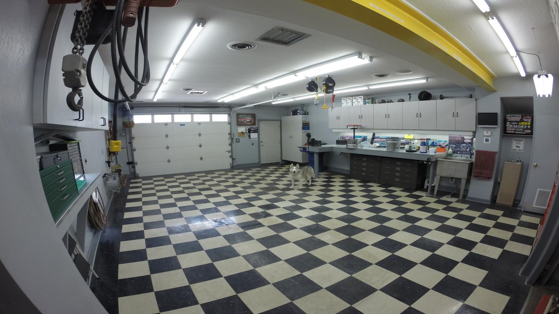

Hello every one ! After getting a little burned out working on the car, and seeing my car fund go dry, it was time to take a break. The plan was to just take a month or two off to re-group. Well ....... That was nearly 9 months ago. But now the shop is clean again and the SL-C will be back home from storage soon. Stay tuned for the next season of "Crazy days at Bob's Garage" LOL !

Well Hello Bob ... Glad to see you back in business again. Your shop looks like it's ready for some action, nice shop! Good deal keep us all posted.
Enjoy have fun !!!
Fantastic shop Bob! I agree, its definitely ready for action. I can only hope I can have mine looking a tenth that good by summer time. :thumbsup:
