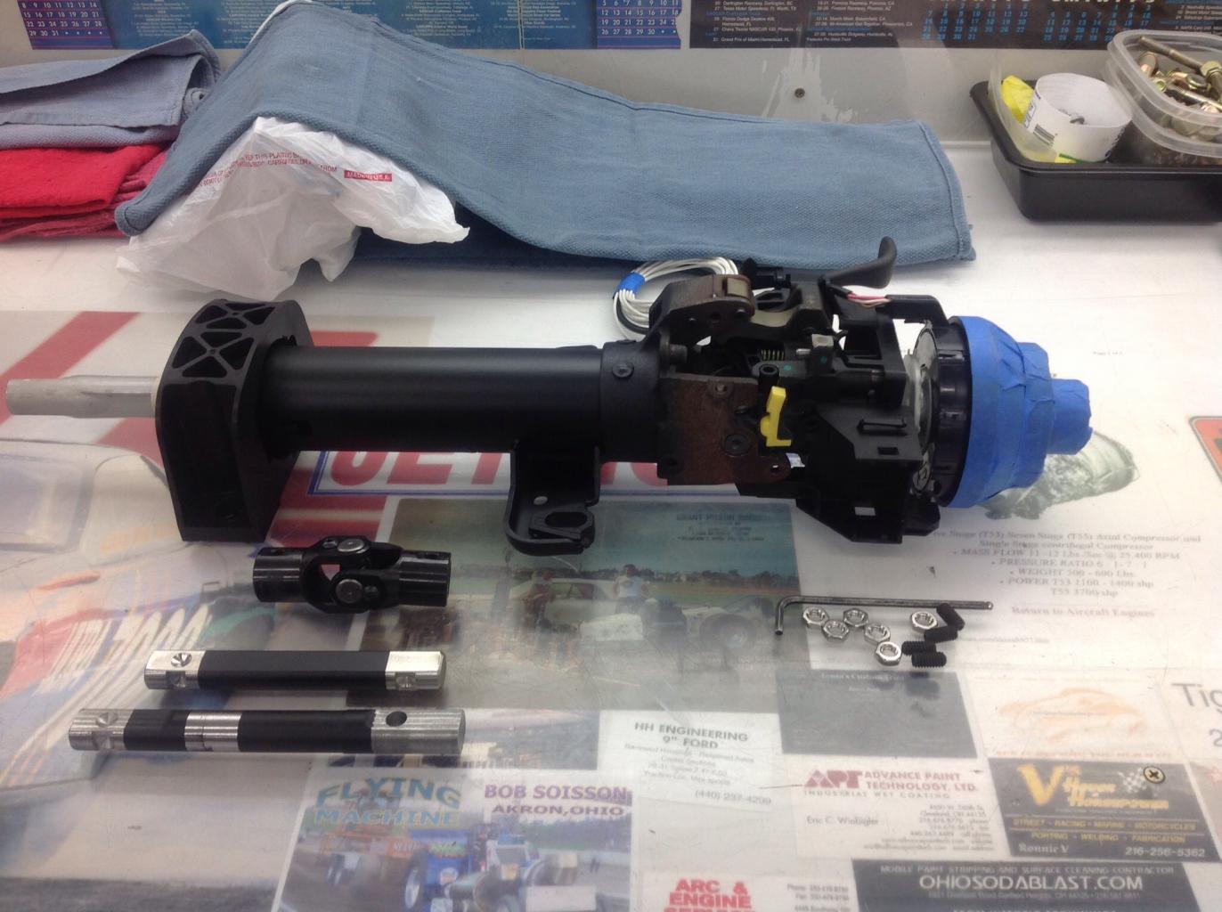

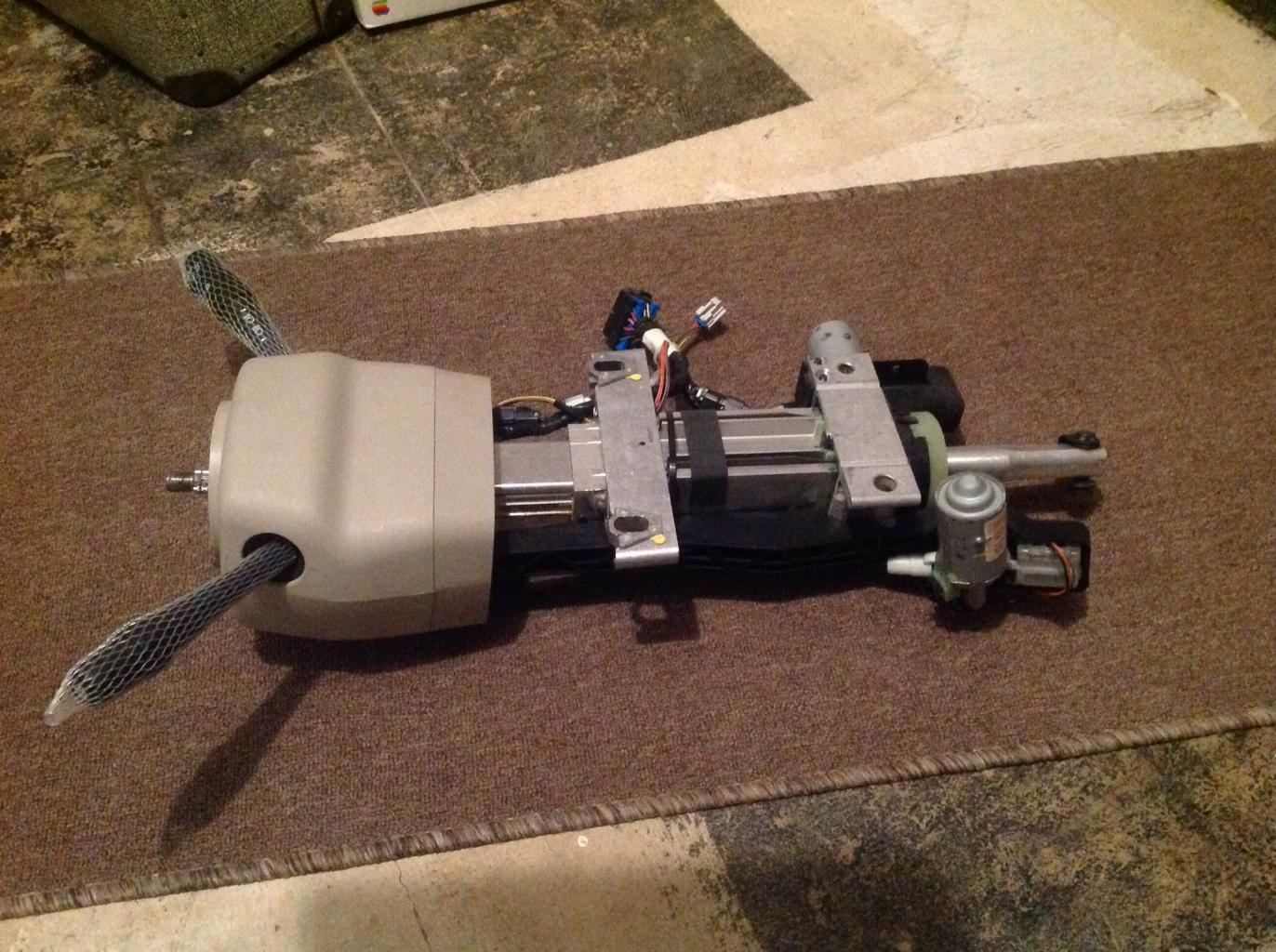

So I have decided to not use the power column that came with my car. Big feet. That about sums it up. This is a corvette non power unit from EBay. Pics to follow on the fit!

Also if any one needs a power unit this ones up for grabs. I did have to remove the clock spring for the steering controls. Make me an offer. I'll be fair.

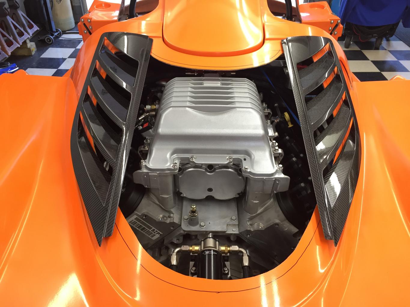

One step forward two steps back. Still a few steps away from the supercharger clearance issue.
Well after a few weeks (ok months) of trying to confirm that the heat exchangers I have will pull the heat out of my LSA's super charger ... (no luck on a real answer to that) ...
I have made up brackets on CAD soon to be made from hunks of aluminum to mount them in the car.
At the point of begining ready to wire the car, I decided to temporarily connect the engine harness and fire up the motor for the first time. It was ..... Well .....
"un-eventful" LOL .... no issues or stress .... It just started right up ! (some how I felt disapointed ?):drunk:
The idle is some what tame due to the lower compression (add supercharger)

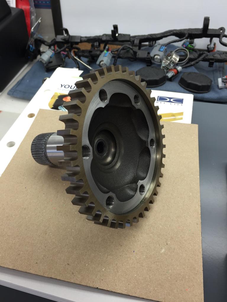

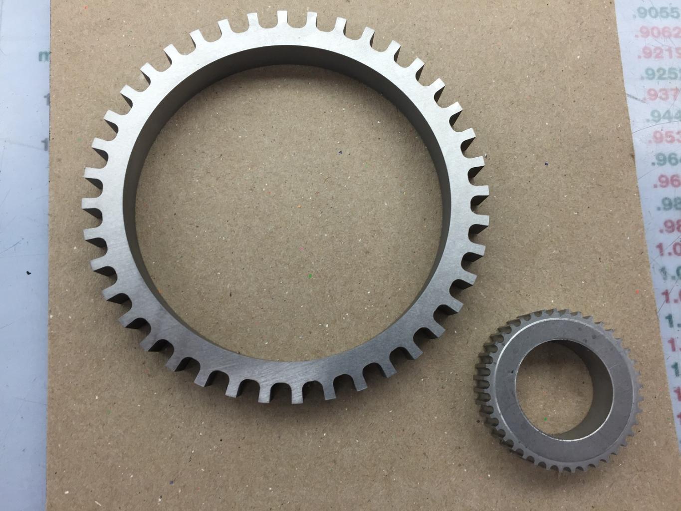

Small tone ring is from GM 4L60E trans. This 40 tooth ring is what the GM ECU is looking for on the VSS input. The large tone ring is one I made to fit the Porsche hub. Press fit and ready to go back in the car. The Drive Shaft Shop does have similar rings, but at 46 and 48 teeth. Not sure if that would have made a difference.

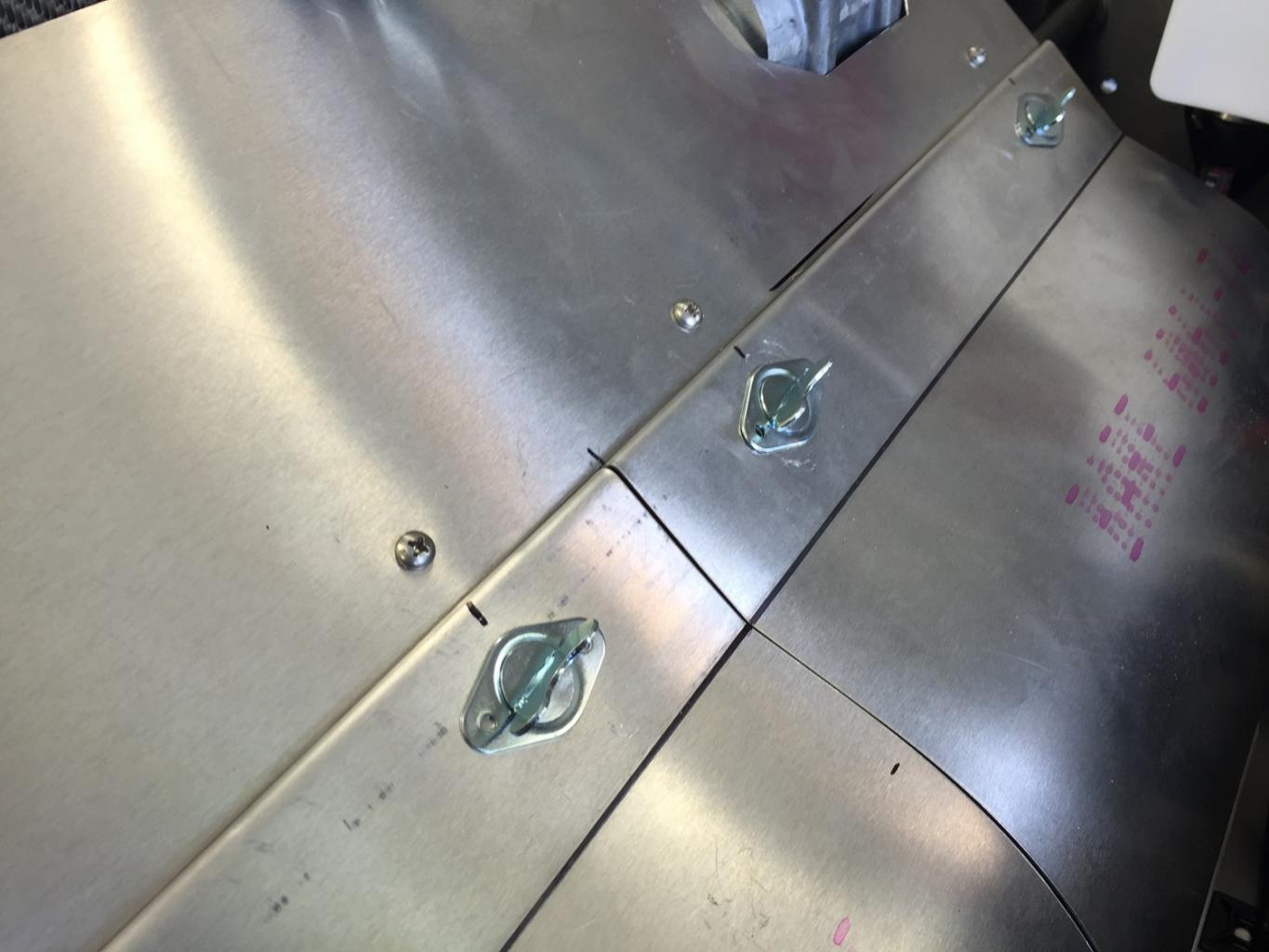

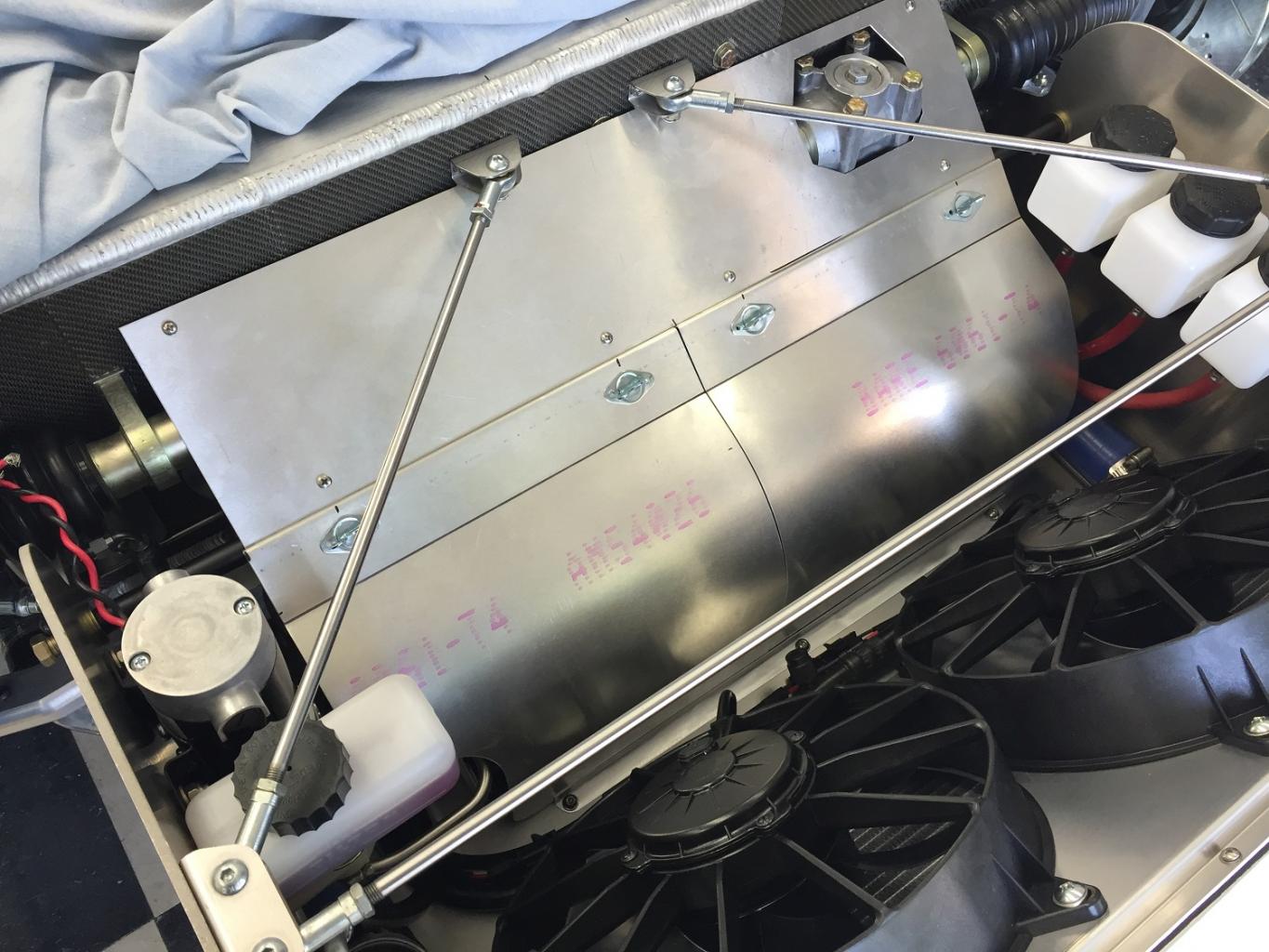

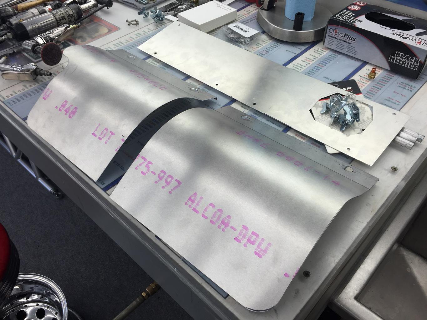

Trying to keep some of the heat off the foot box, made up an air deflector. Split in the center so removal is easy. Will cover in heat refective stuff next !
Also see the upgraded fans. If the engine stalls these will just pull me down the road ! LOL
