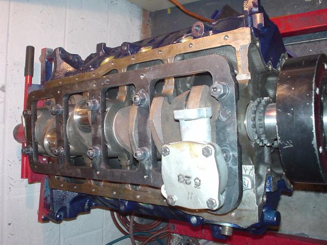

Has anyone used a mains girdle, and if so did you have any clearance issues with your oil pump?
I am putting in a Canton girdle with ARP mains studs, but I have a clearance issue. Appreciate any advice. Thanks

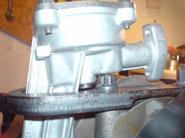

Yup. I have one on a Windsor and had to clearance the girdle and pump webbing slightly. The pump isn't installed in the pic below but the upper right was dimpled. I found it easier to install the pump and then the girdle.
I obviously was a bit tired and emotional last night... and not thinking straight LOL
Straight back in from work tonight and saw it straight away. I hadn't used the shorter bolts with the 1/2" multi-point head in the right position.... All fixed now.
