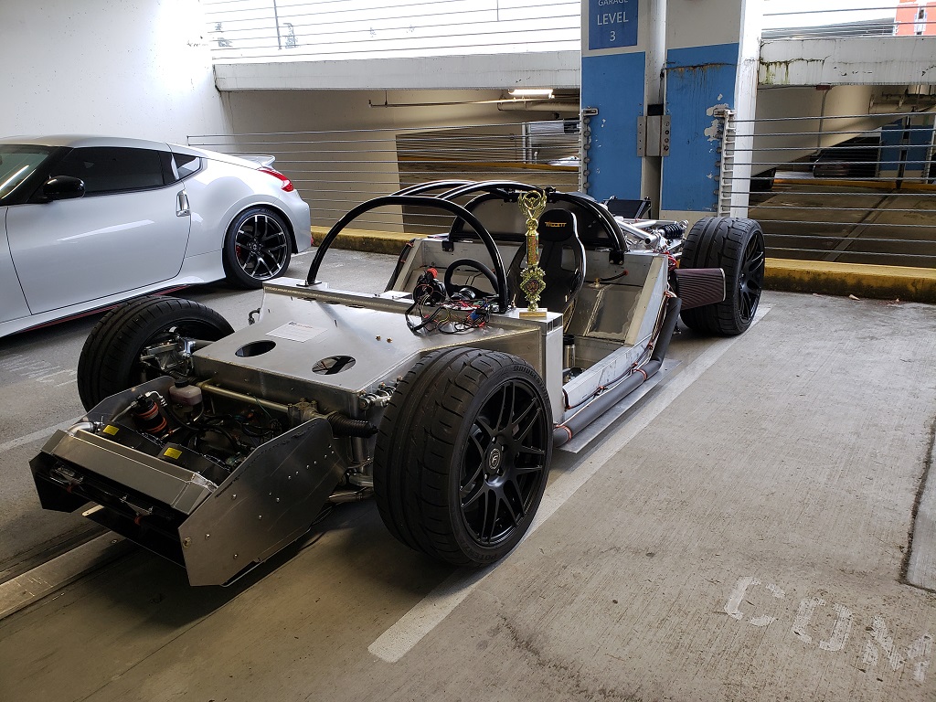

So every year Microsoft does a small car show to benefit United Way. I bought my 'naked' SLC and won best custom car, which was pretty cool. Definitely drew a lot of attention and questions :)
