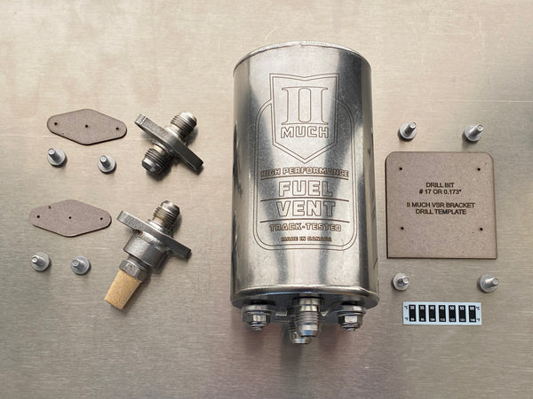

I got one of these Mark -
Coupled with a roll-over valve. This system allows the tank to vent to atmosphere and doesn't require a vacuum source. I haven't hooked it up yet to see how effective it is at catching fumes but it seemed to be the go-to thing before they had their recall.

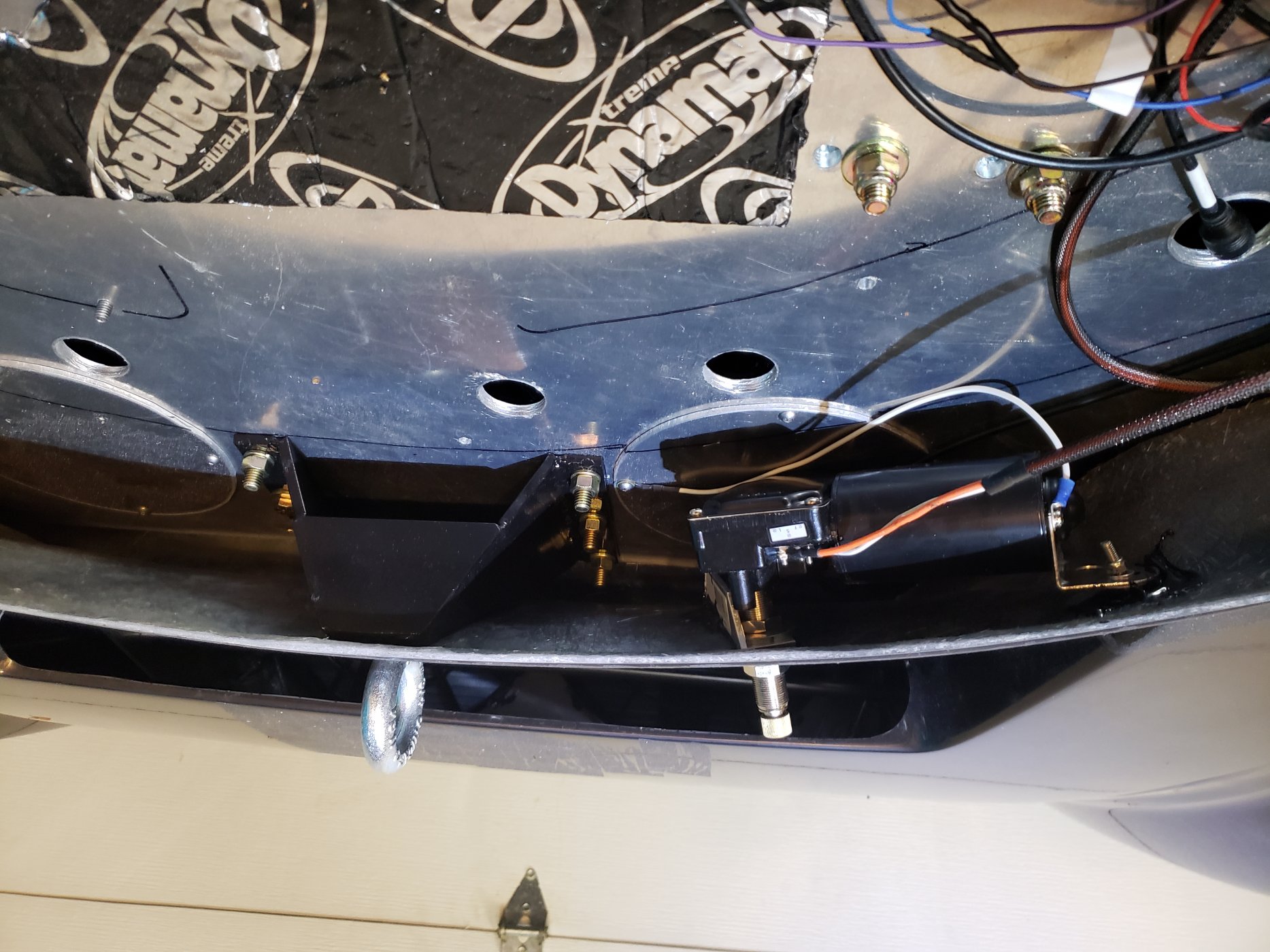

Mark, I'm using the same fuel pump inertia switch as you and I'm pretty sure it must be mounted facing up. You have it facing back (towards the driver). In that position it won't react to an impact from the front (the force of the impact will keep the ball in the cup instead of dislodging it and breaking the circuit).
Install instructions paragraph #1. (vertical mounting)

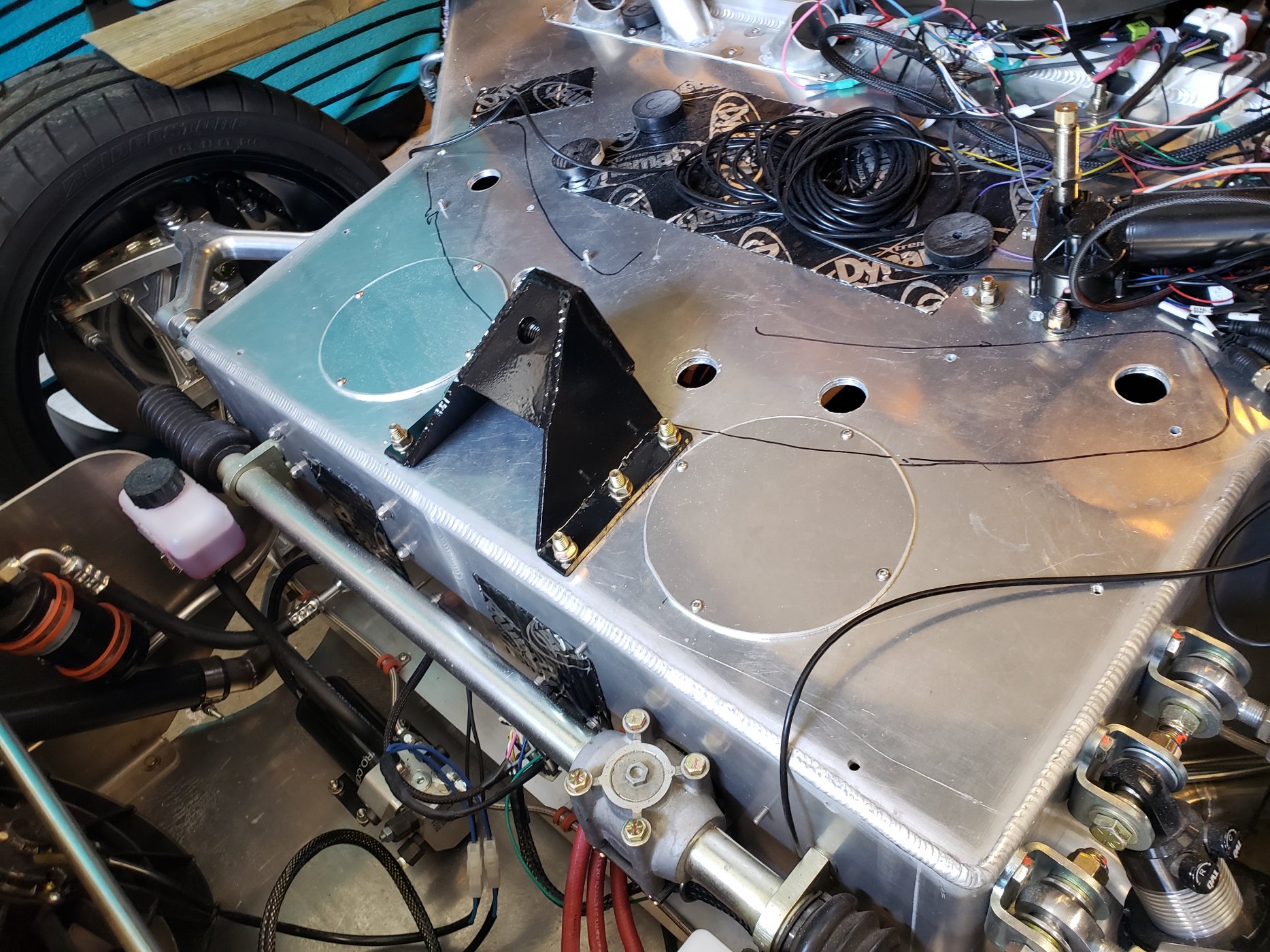

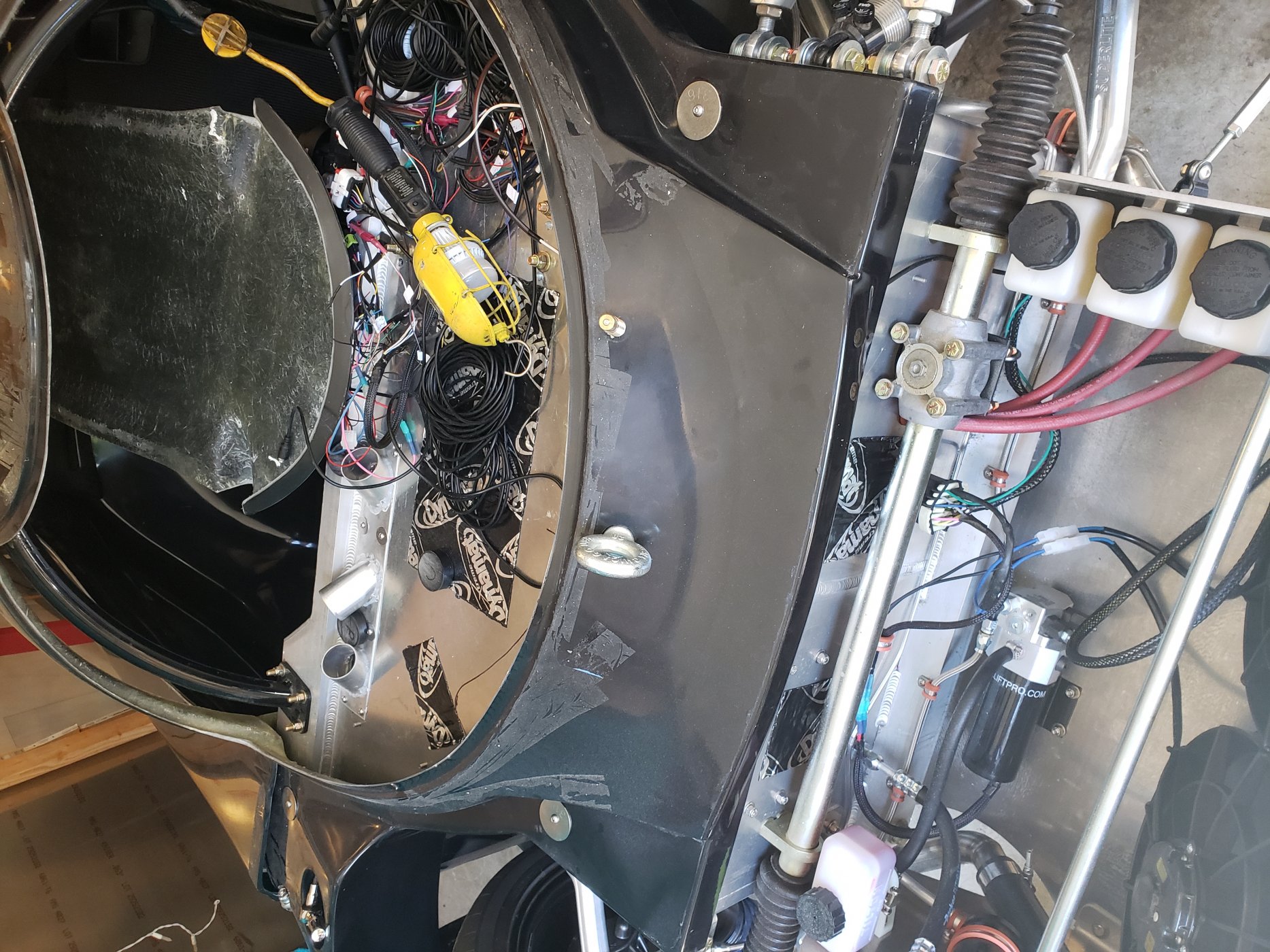

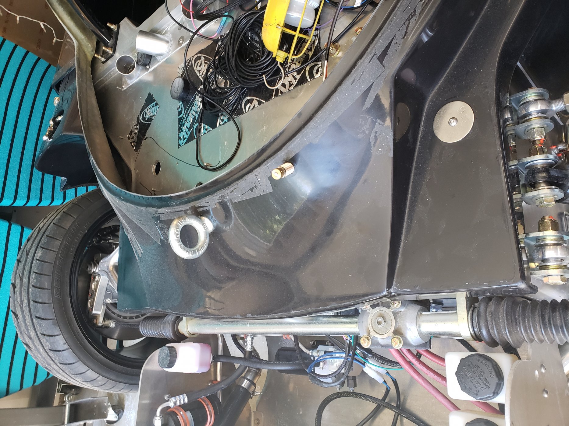

I Installed a front tow hook and got the wiper motor installed. For the tow hook, I made a bracket out of 1/4" steel that bolts to the monocoque with 6 3/8 bolts and backing plates. It has a 3/4" nut welded to it so a 3/4' x 1.5" ID eye screws in to it. When not in use, I'll either cap it with a blank cover or thread a painted allen bolt in to cover the hole.
I also decided to add some leg vents by drilling a few 1.5" holes under the front part of the "anchor." You can see the anchor mount traced in to the chassis in black marker in the pics below.
