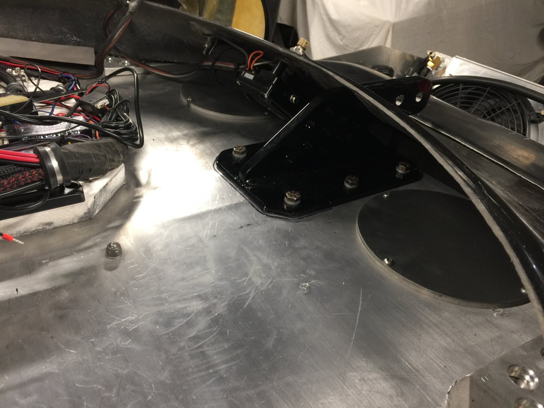

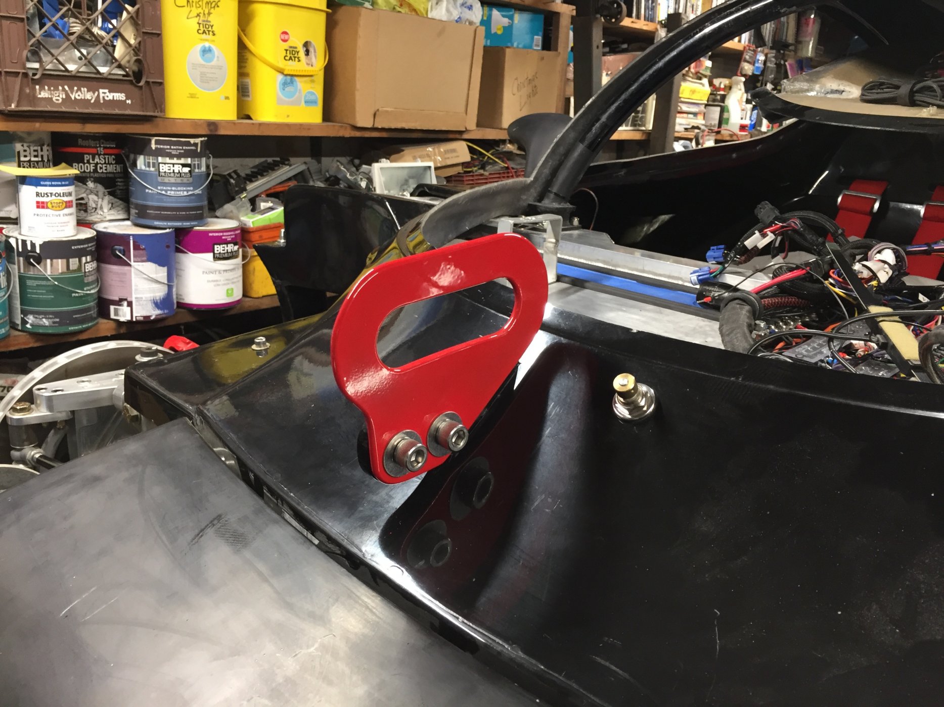

Hey Mark,
Howard's tow hook is being torqued so hard by track tow vehicles that it is bending the top of the footbox! His is located in a similar spot to yours, although yours spreads the load more. Judging from what happened to his, you might want to put some load spreading reinforcements under the upper footbox top.
Mark B.
Hey Mark,
Thanks Mesa, I have backing plates spreading the load a bit, but may be worth making them a bit larger...

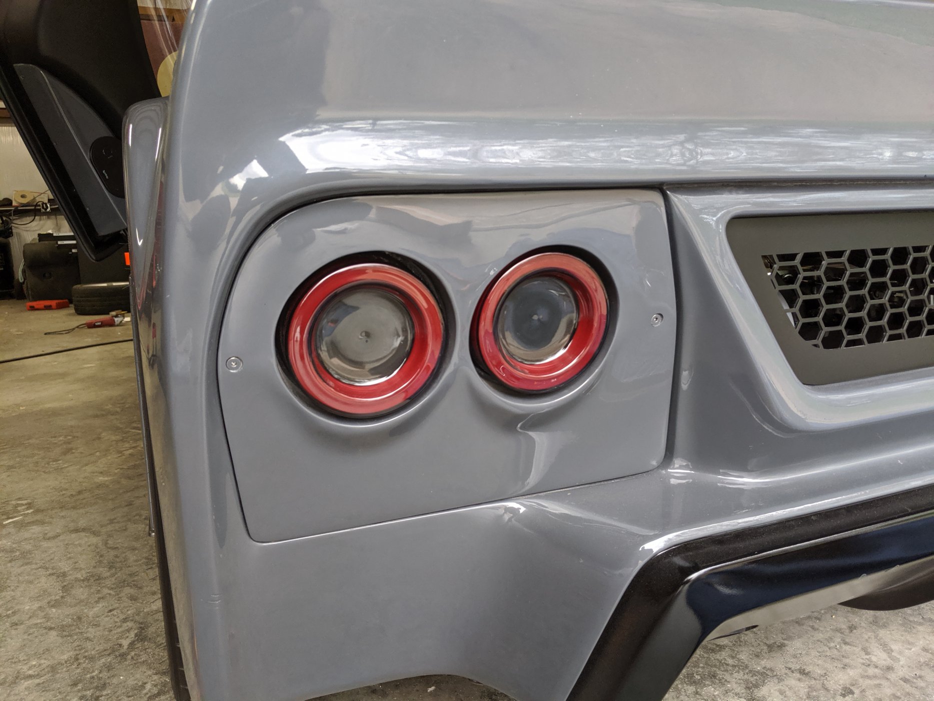

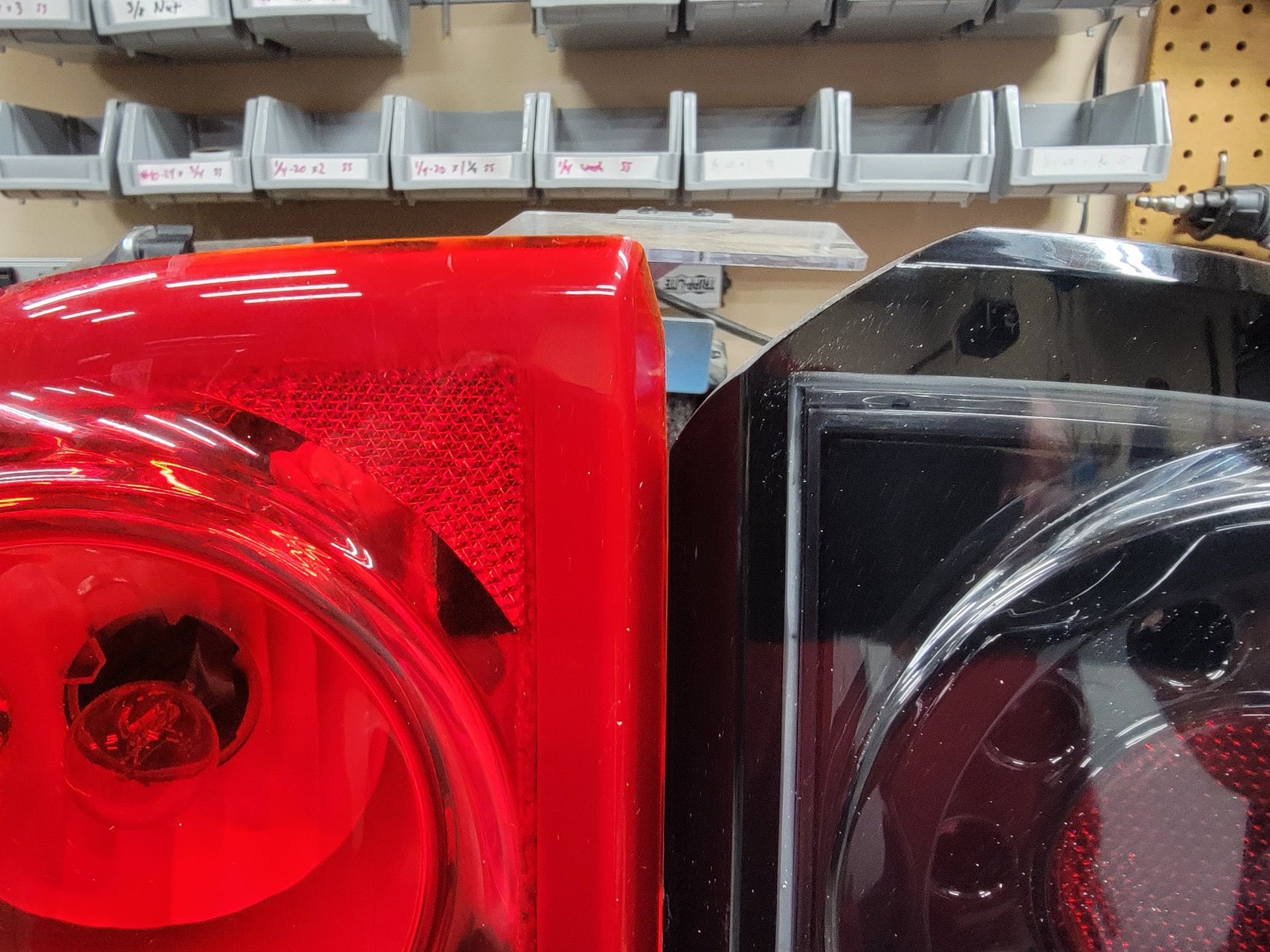

So when I have a list of priority things to do on your car, I do the logical thing and do something that's not on that list.

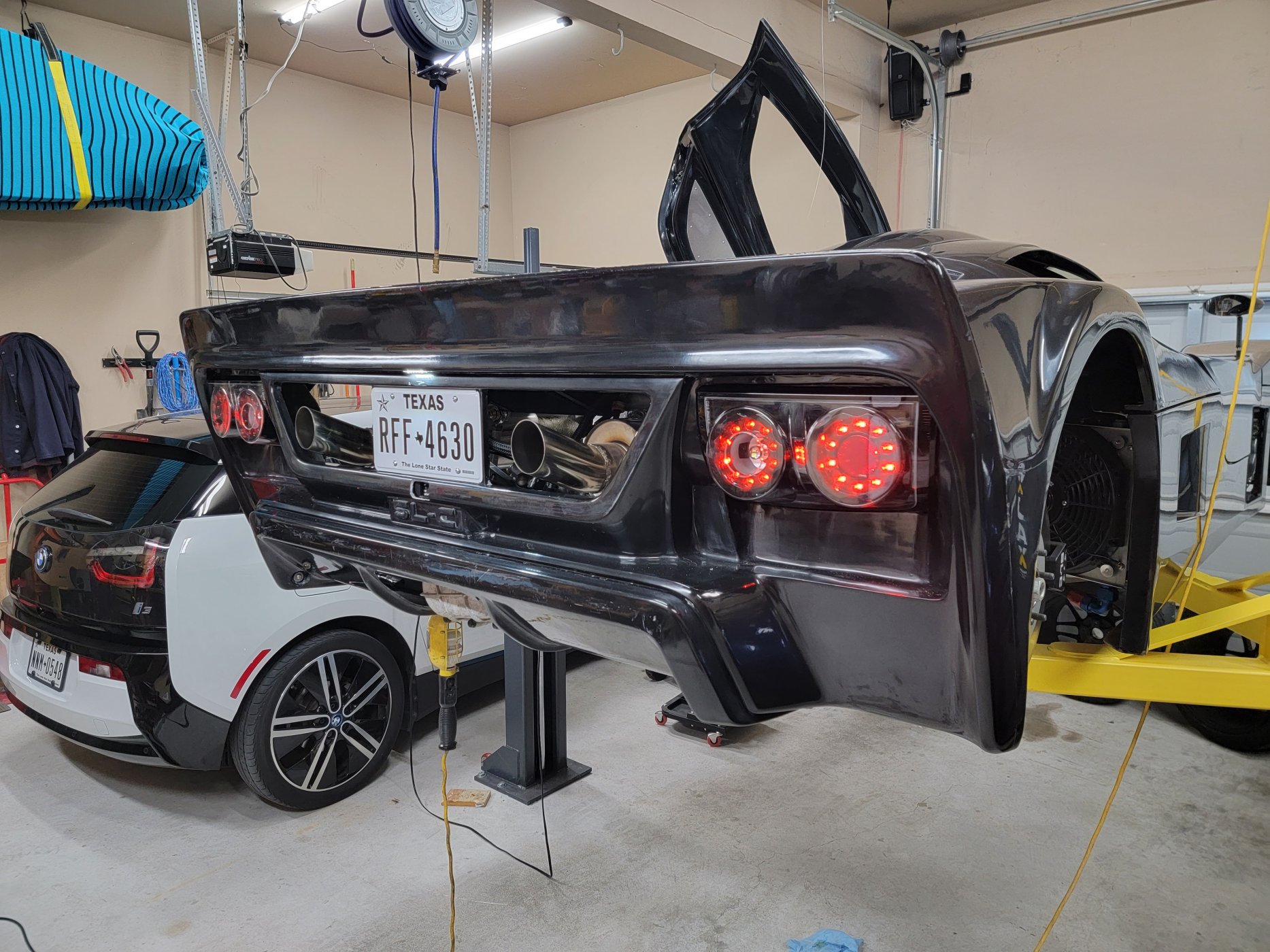

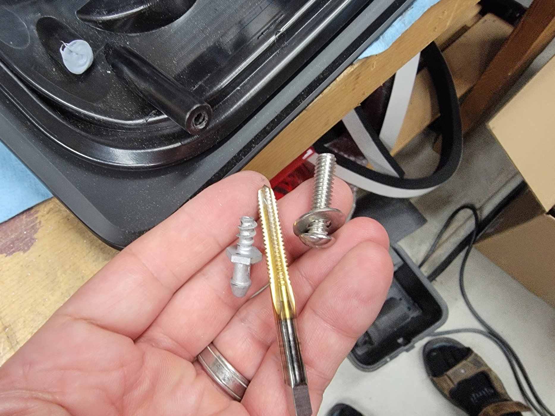

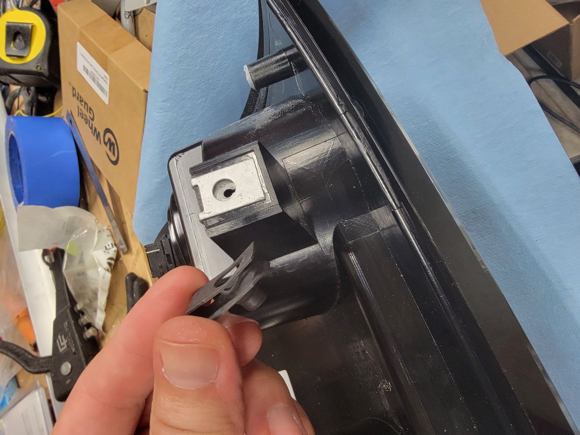

Thanks to Kyle, I have a set of LED taillights that I've been wanting to install, so I knocked that out last night.
I swapped out the u-nuts for 1/4-20 u-nuts
Removed the stock mounting pins, the drilled and tapped the holes for 1/4-20 screws
I decided for now I want to run them without the trim panels since the car is black and so are the light bodys. I trimmed just enough off the corners so they blend well with the body
I'm thinking I'll leave them like this for a bit -- I may actually cut a vent out just underneith and see how that looks/works. If I don't like it, I can always mount the trim panels.
I'm partial, but Lotus Elise taillights (or GRPv3 aftermarket Elise tails) are best looking round taillights for the SLC with the street tail.

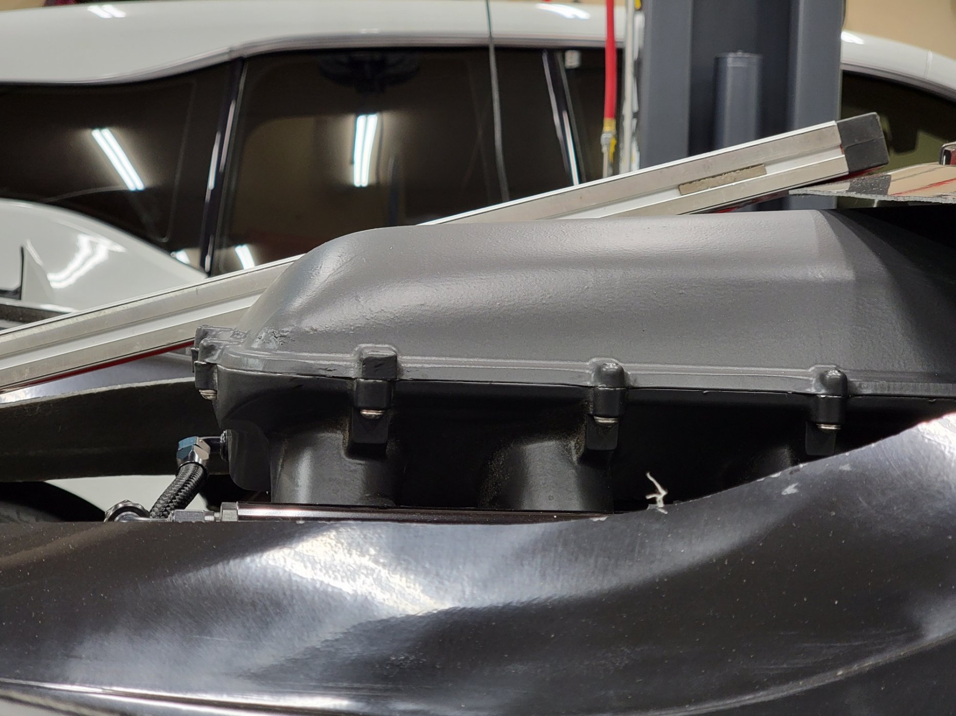

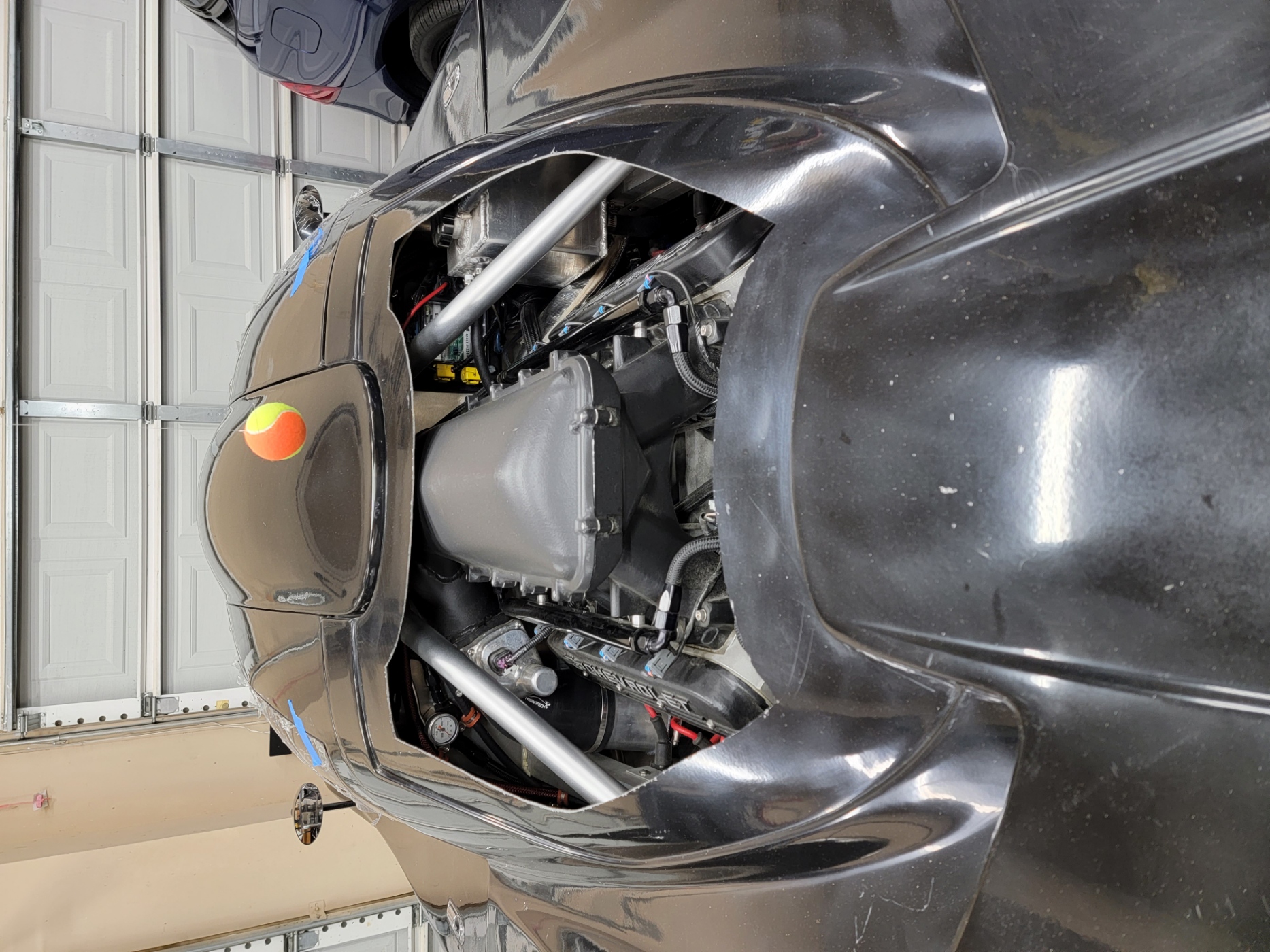

OK everyone I need opinions for how I'm going to do my rear lexan. If you've seen my build you know that I have a Holley High-Ram that sticks out of the rear opening about1.5" at the highest point. I knew that was the case when I decided to use it, but now it's time to decide what to do about it :). At some point down the road I want to add carbon fiber hatch vents, but for now it's going to be just lexan as I'm way over budget.
Option 1: Cut a hole in the lexan around the portion of the intake that protrudes.
Option 2: Try my luck with heating the lexan and creating a dome shape over the intake.
I'm leaning towards option 1. The chance of error is significantly lower (I've never worked with forming lexan). Also having a little extra venting in the glass will be good, and I think it will look fine since it's not a huge piece sticking out, it and it's already powdercoated black. But I'd love to hear all of your thoughts on what you think will look better and if forming lexan isn't too bad.
The first pic shows a level laid on top of the rear clip showing where the lexan would lay. The pic makes it look huge, but the intake will protrude just under 1.5"
Disregard the tennis ball for parking my wife's car ;)
Your not looking out of the glass as it is so wrap up the lexan and use it as a form to make a fiberglass negative mold . You can then modify the mold to accept the intake and give it some useful vents. If you protect the lexan properly it will still be able to be used in the future. I've seen a gray SLC with a full cover over the engine and it looks slick.
Joel K
Mark,
I agree with Rich, make a cover for the time being. That rear Lexan window is about $500 to replace so maybe You set it aside. You may want to put a lower profile intake at some point,

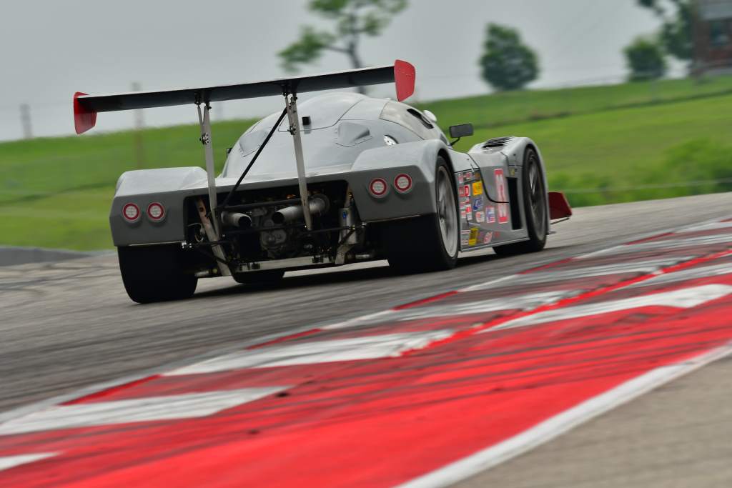

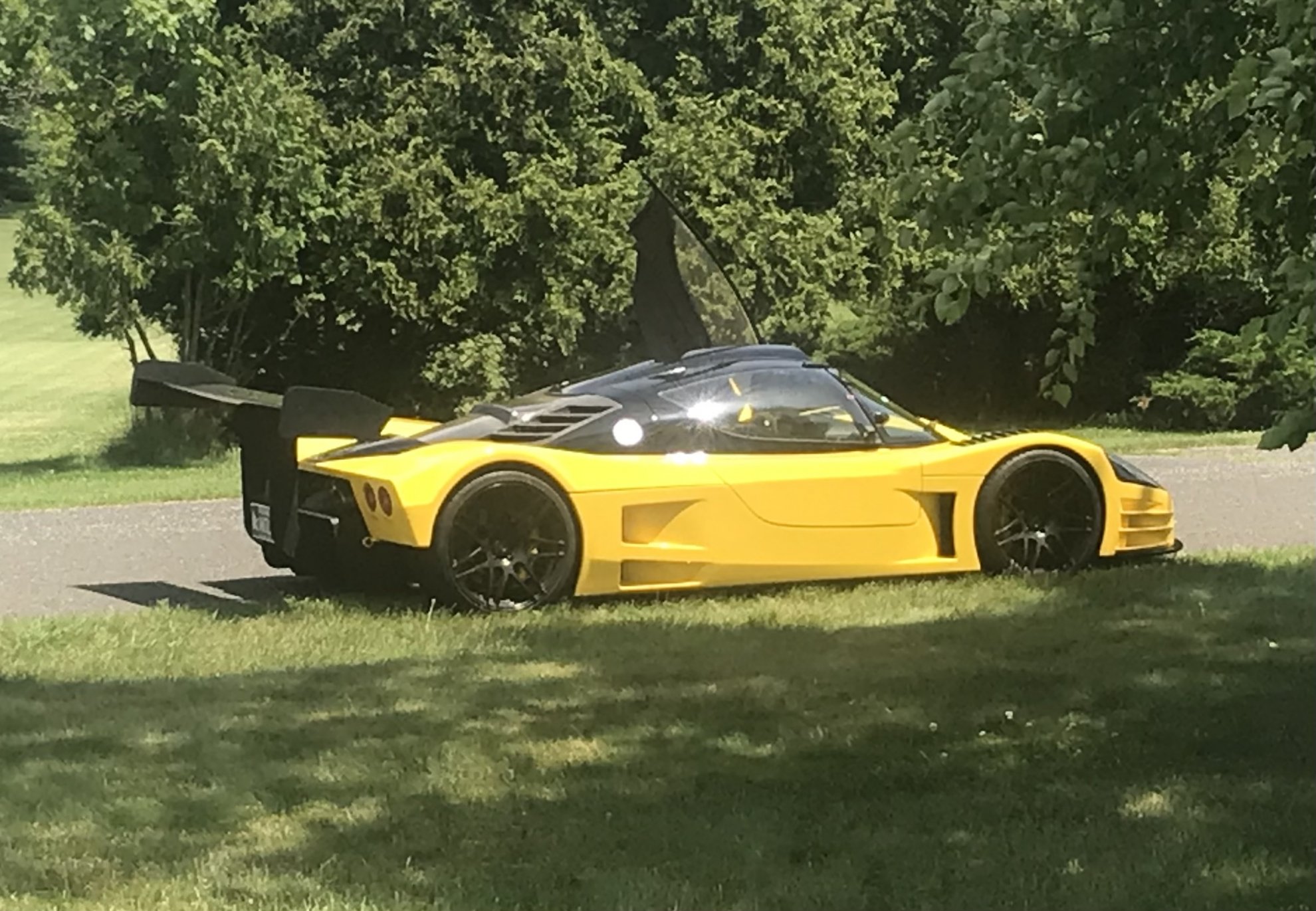

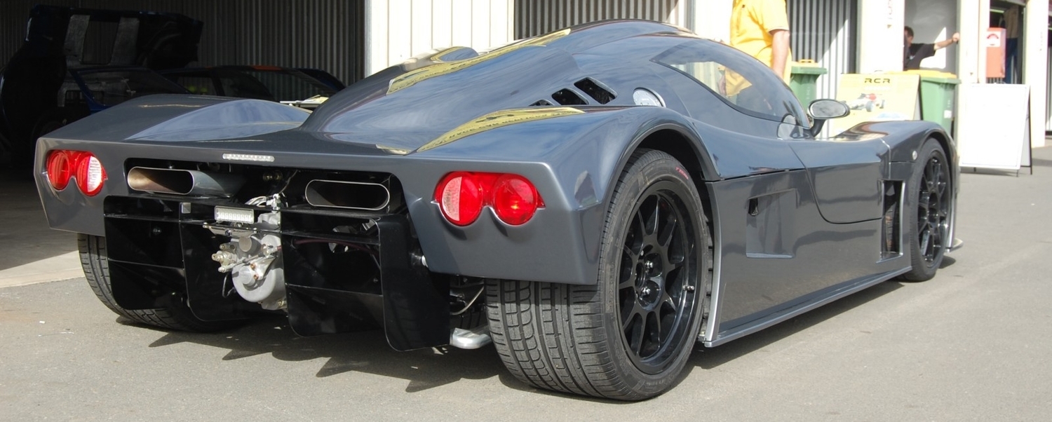

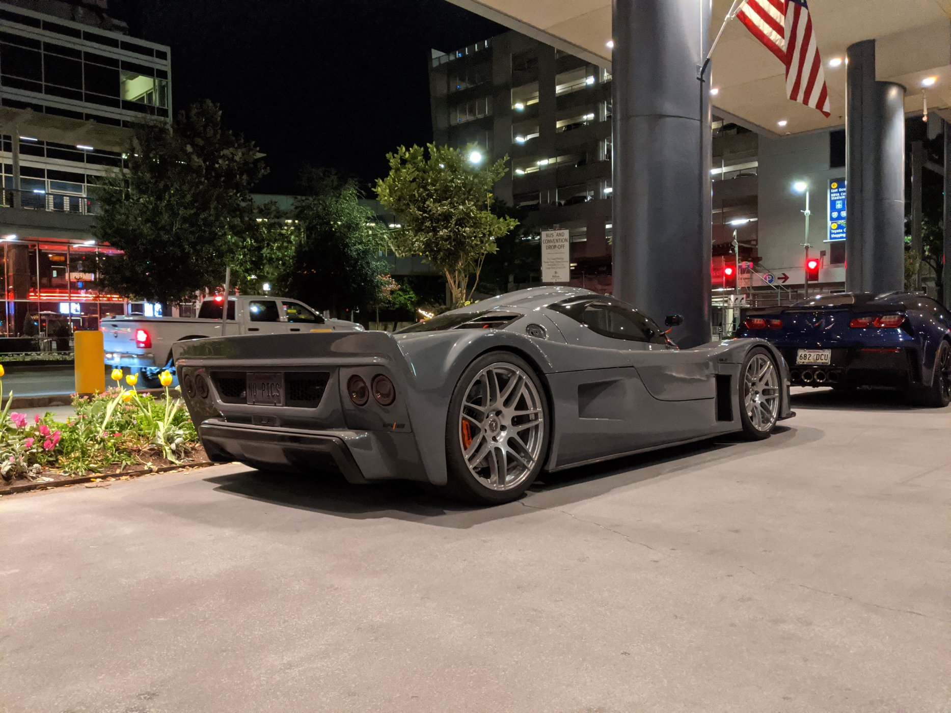

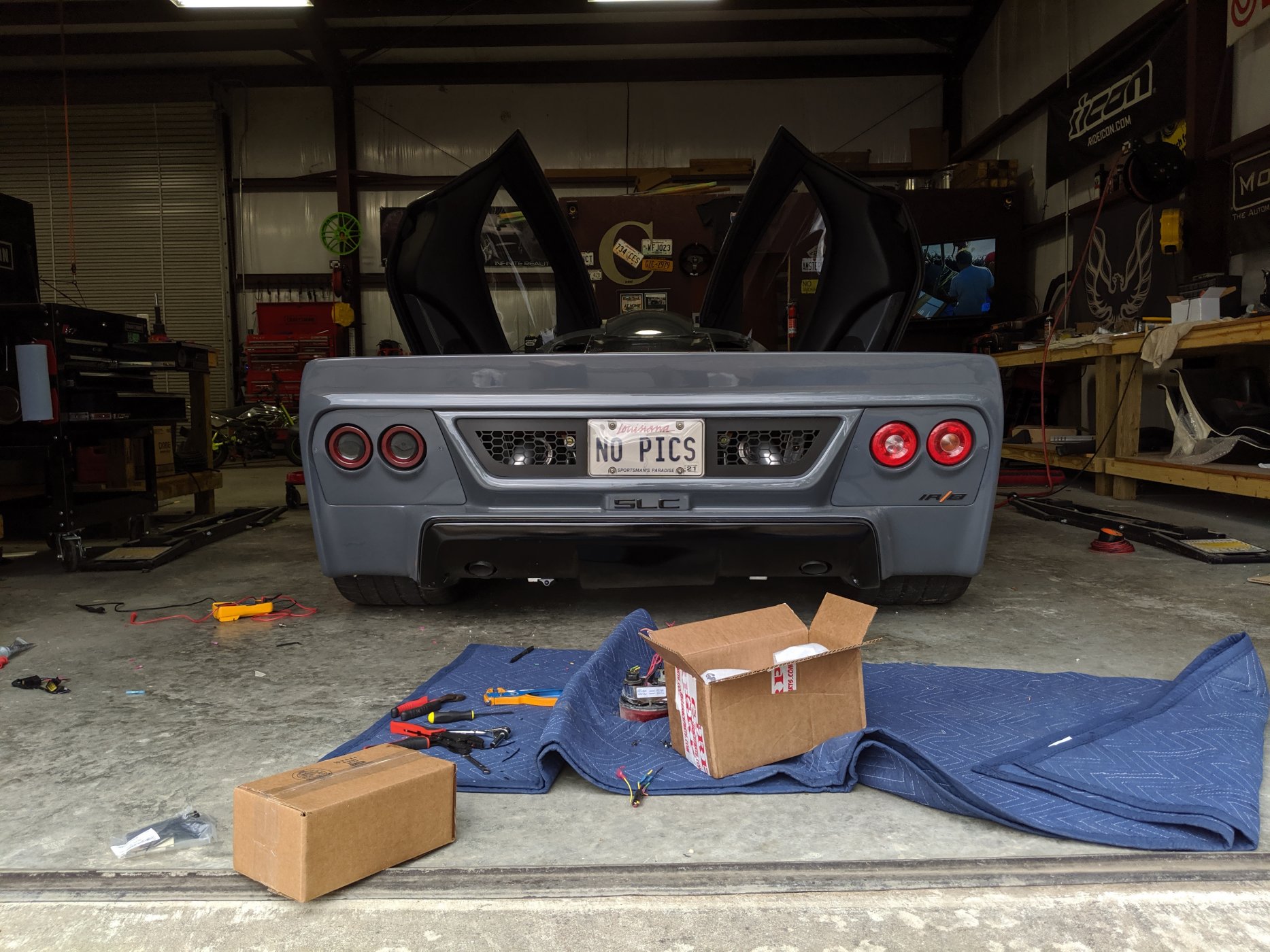

At the very least I’d make a cover or maybe frame up the area with a fiberglass panel to finish It up a bit. Here are a few pics of finished SLCs and a bonus pic of my favorite GTP car, love the back of the Chevy Intrepid from the 90s…
Bob’s LT5…
Howard’s
I think is is an Australian build…
Kyle
GT40s Sponsor
Check out the ruffian40 GT build. He did something similar. Also check local suppliers of polycarbonate. I can get a sheet for $75 around here that I’m going to cut into the shape for the rear window.
