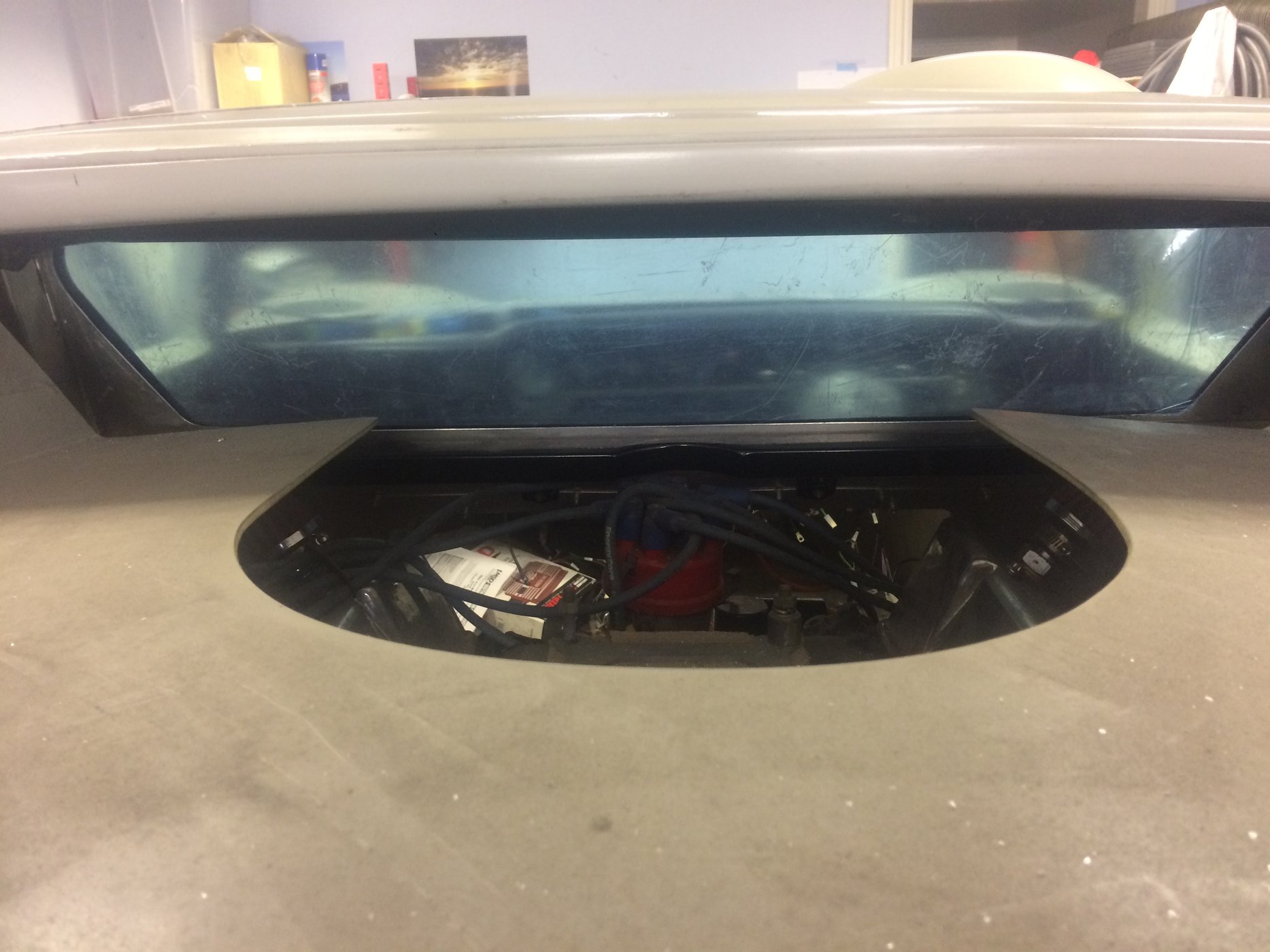

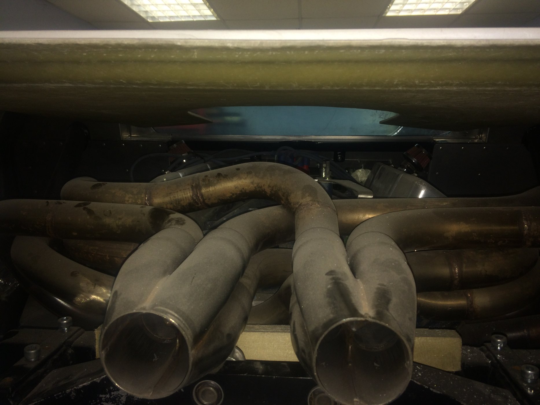

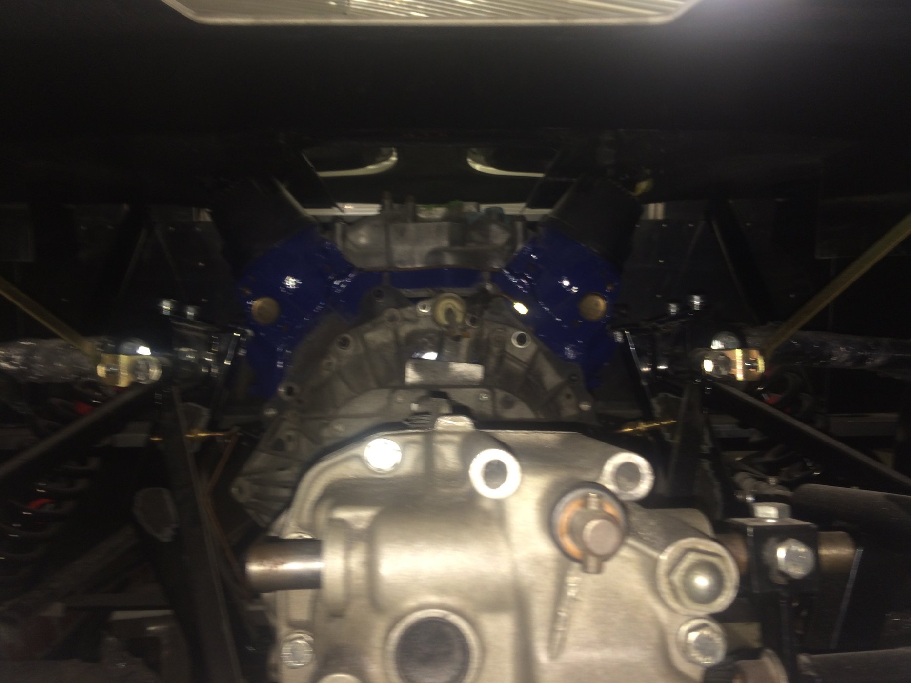

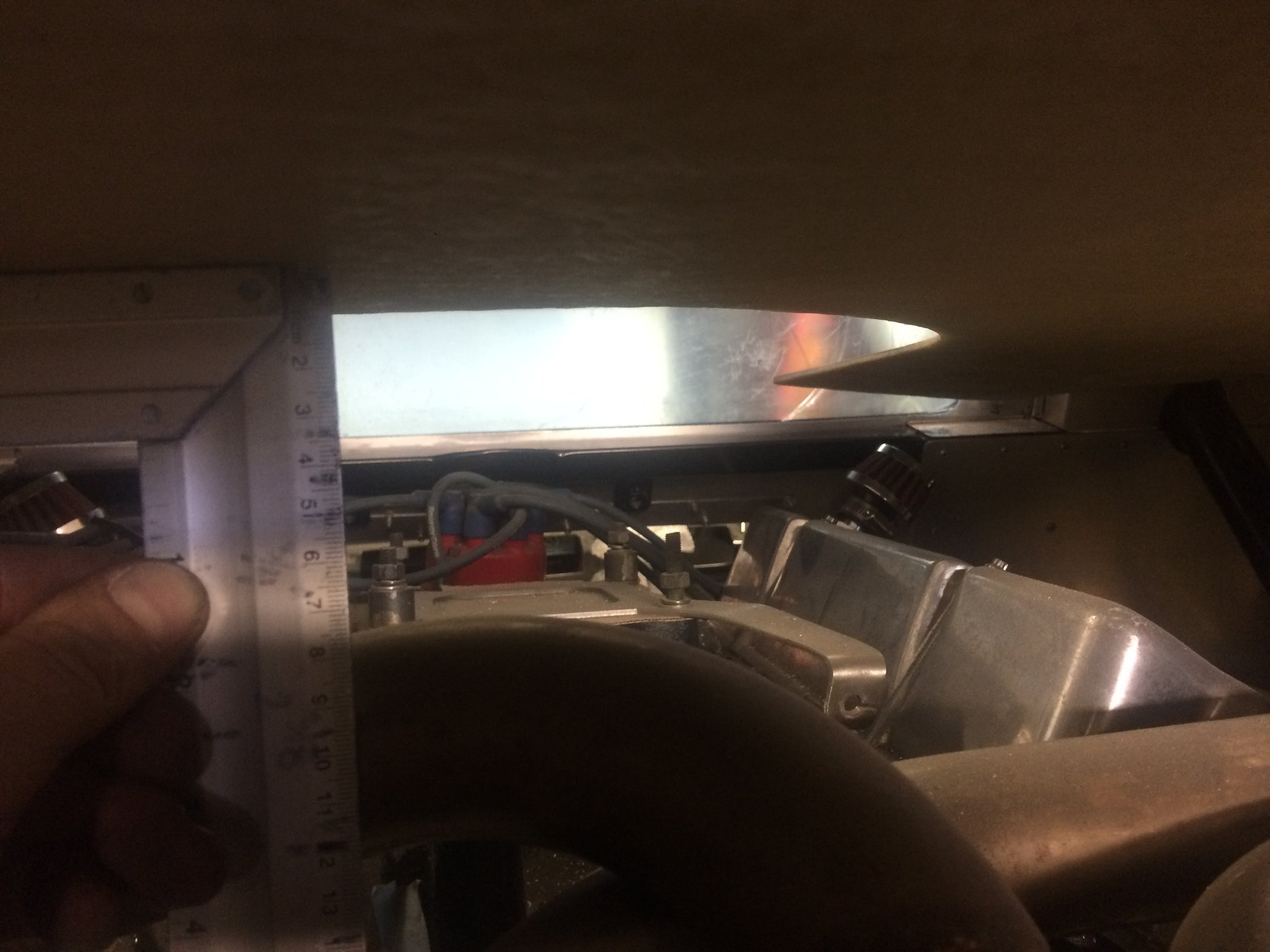

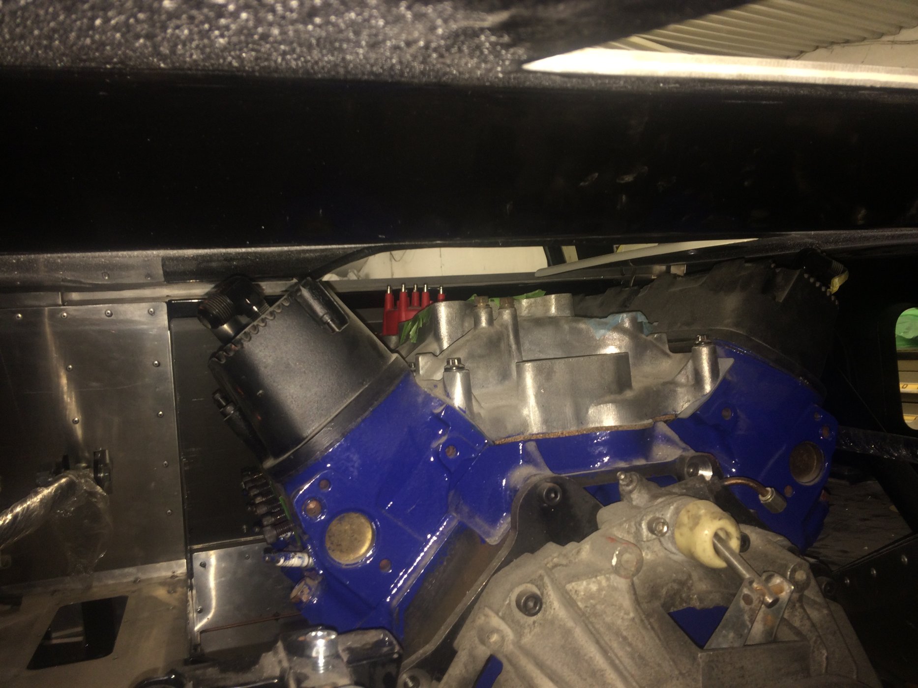

Mortified GT Asylum
Mk1 pics 351W to UN1-13
Mk2 pics 351C to RBT ZF
So you can calculate alittle then:)
351W is very tall and tight under Mk1 rear clam. Look at bulkhead window to estimate your RCR.
Best of luck mate:)
Morten
Mortified GT Asylum
Yes, will almost fry the fiberglass. It will drop 1.5 in once the ZF is dropped in, now its mated to the UN1-13.
