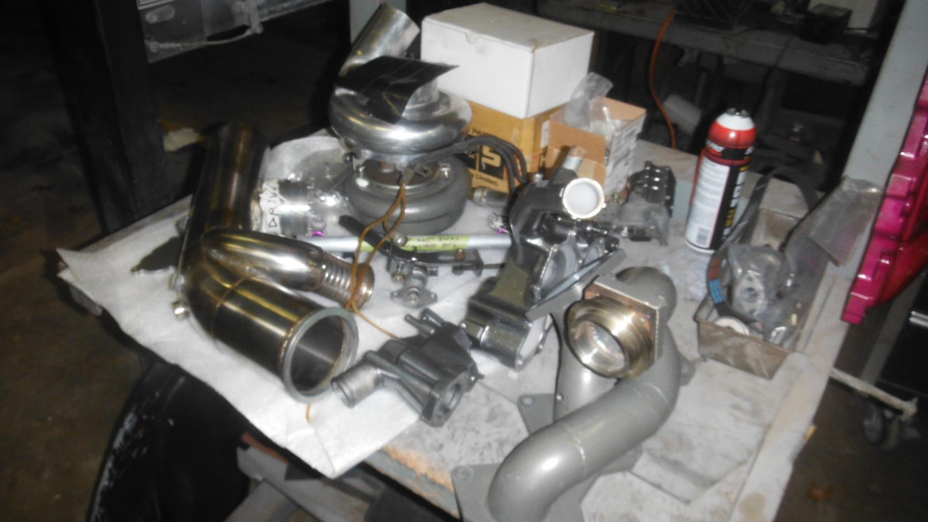

Here are some pictures of the unload and sorting out for the start. I am on a Mac, and not sure how to downsize them and send them. Some picts are of my shop and my twin blower set up on my 38 packard.

Was curious about the turbo exhaust manifold. Did you make it knowing the dimensions of the car or is it a used setup you will adapt to make fit? Looks new to me.
What are the specs on the turbo you have. I know you said it is a GReddy unit, but that covers a pretty wide range of sizes.

I didn't have the car assembled, its all on me but Fran is very helpful with pieces parts.
The turbo is T88 H Custom 20B FD turbo kit w 60mm WG and 4 inch DP.
I have to cut and weld the rest of it, but I will try to make it go out the center above the tranny even if I have to go smaller.
3 X 2200 cc/min Secondary fuel injectors
3 X 725 cc/min Primary fuel injectors
X-treme Rotaries fuel rails (Pri and Sec)
Michrotech LT16 with X6 box and dongle / unterminated harness
With GM 3 Bar MAP sensor and LSI coils
FD Water pump housing
3 pc billet pulley kit FD w S6 Alt and belt
20B engine assy Silver vein finish street ported and polished, dowel pinned, clearanced and balanced rotating assy, oil mods, full rebuild, REC race 2mm apex seals.
Complete with front cover , pulley drive hub, CAS, rear counterweight, upper and lower intake manifolds, engine mounting brackets, oil pedestal, 20B water pump assy
Kennedy 9" double disk
Mendeola S 5 sequential gear box, 4:88 ring an pinion 5 gear is .8 first is 3.25 something like that. geared around 160 at 8000.
