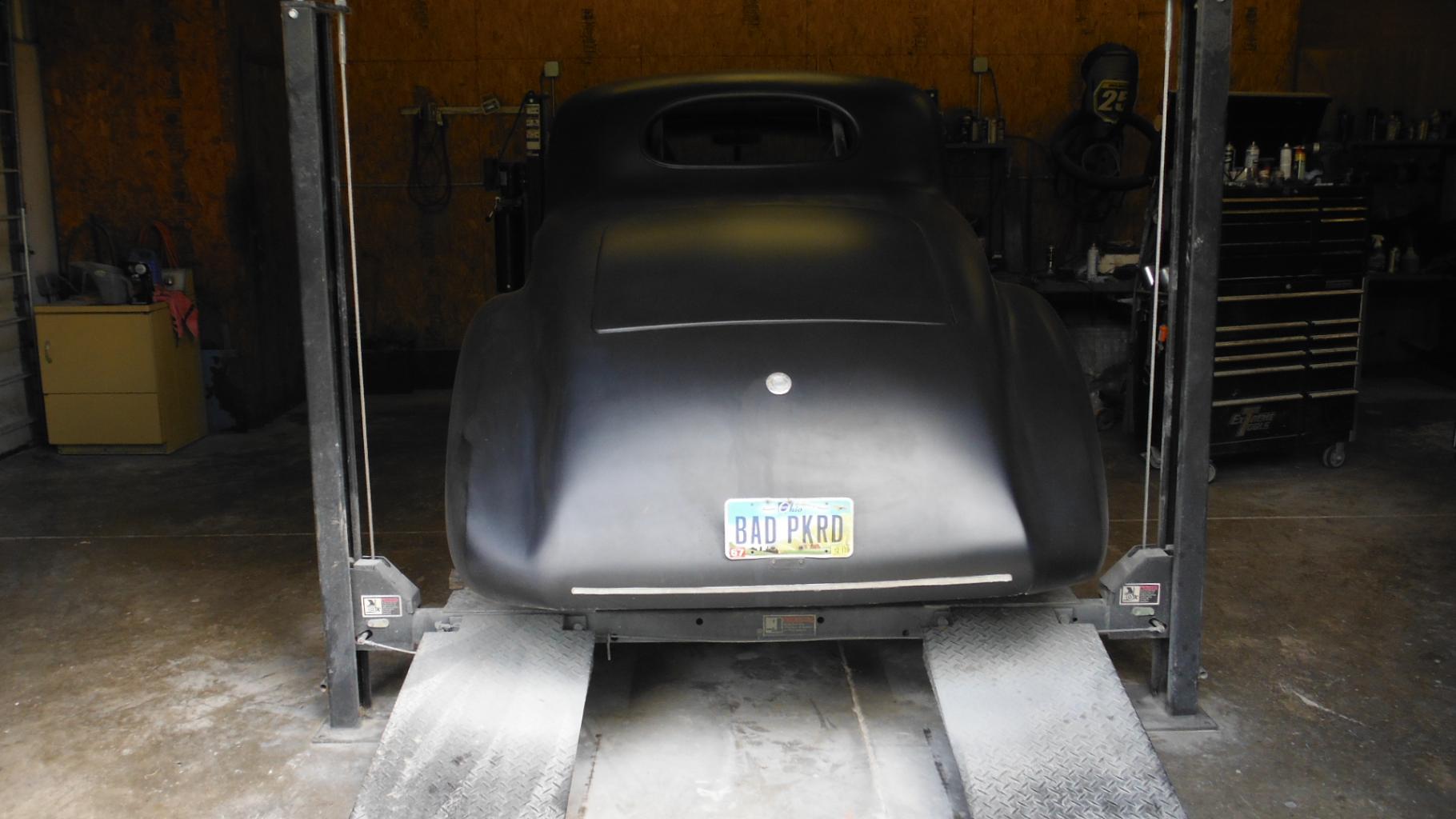

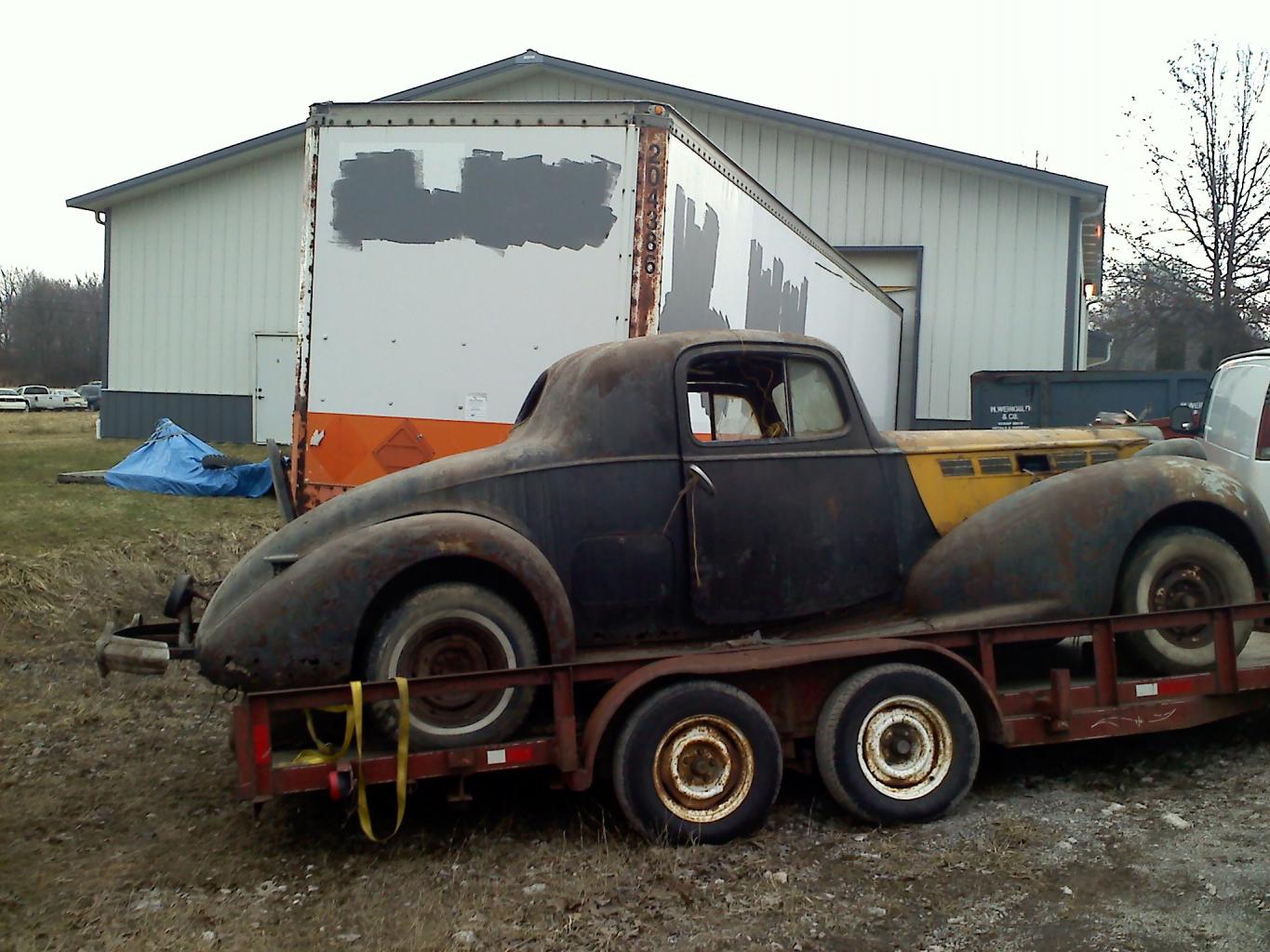

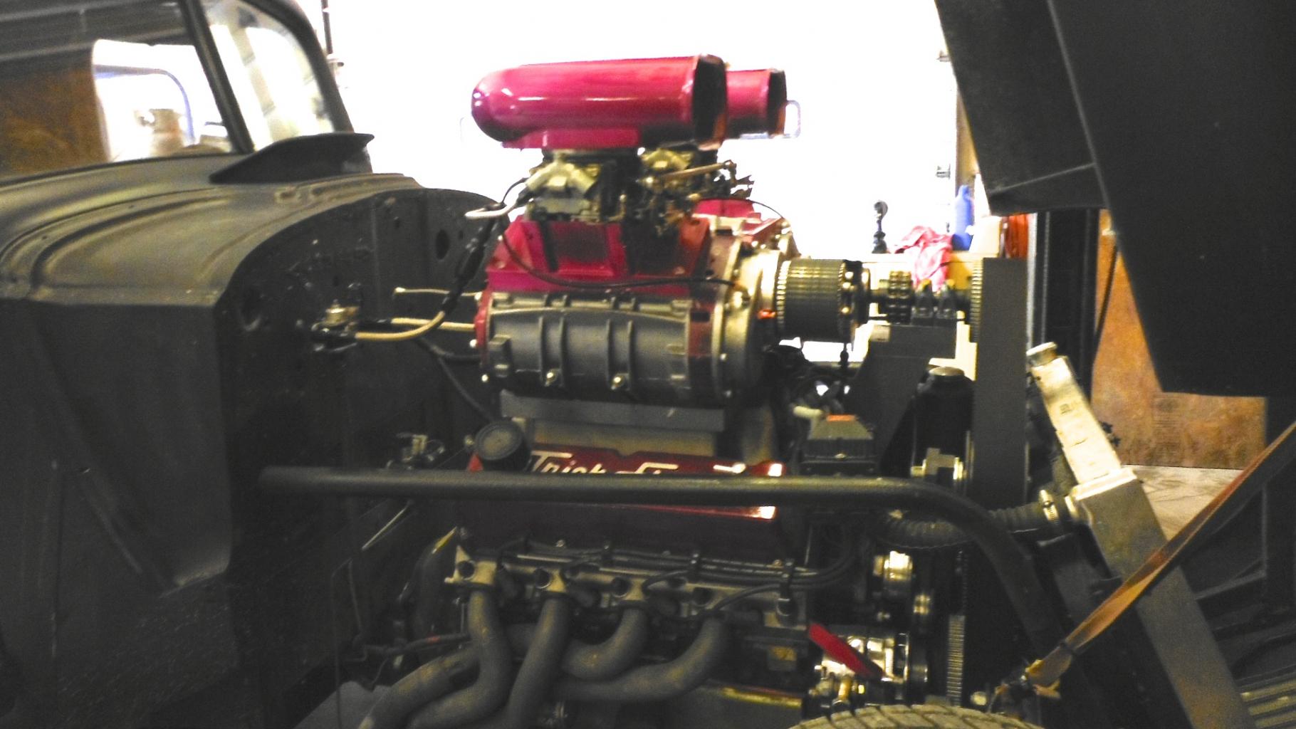

Here is a picture of my pro street 38 Packard 2 dr coupe, twin blowers, 521 Ford, 1500 hp on pump gas, tubed, caged, fat tire car, and what it looked like when I found it in barn after 40 years, it was all wood on the inside, the doors still has original wood in them. Just tired of working with RUST, and Ohio old cars.

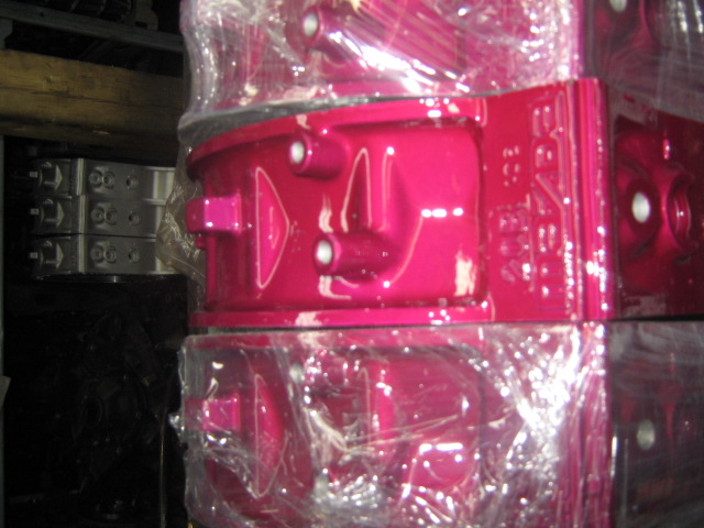

Ill see how this 3 rotor runs, supposed to be 650 rwhp, and with boost and fuel, methanol injestion up to 900, but I just want a reliable motor, take to the track once in a while etc. Should be shipping soon, had to wait a while for the housings to get powder coated to match everything else.

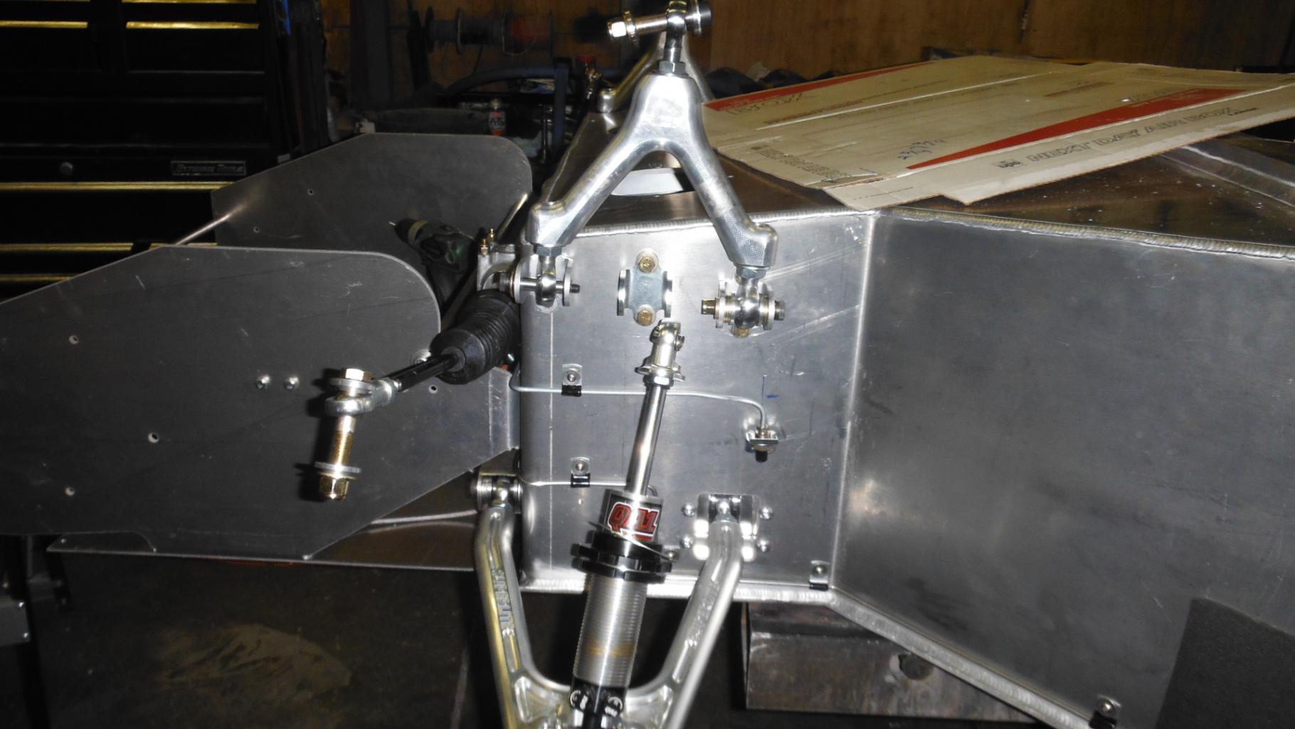

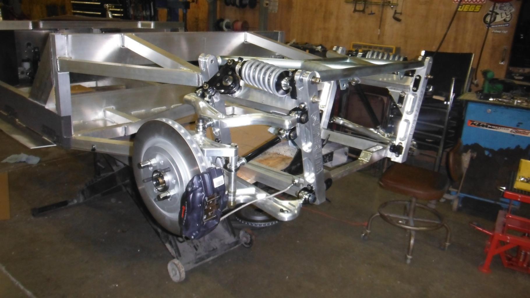

I think I'm gaining, the motor is back from powder coaters, so its ready for assembly.

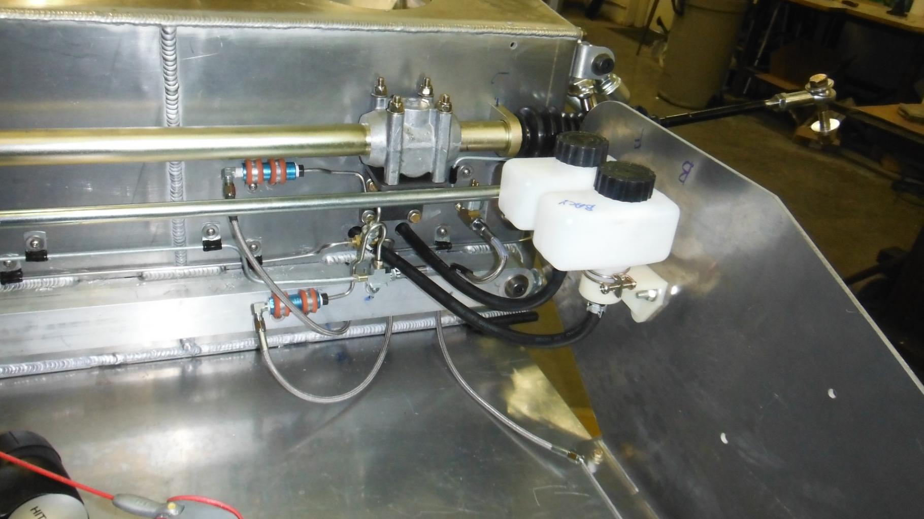

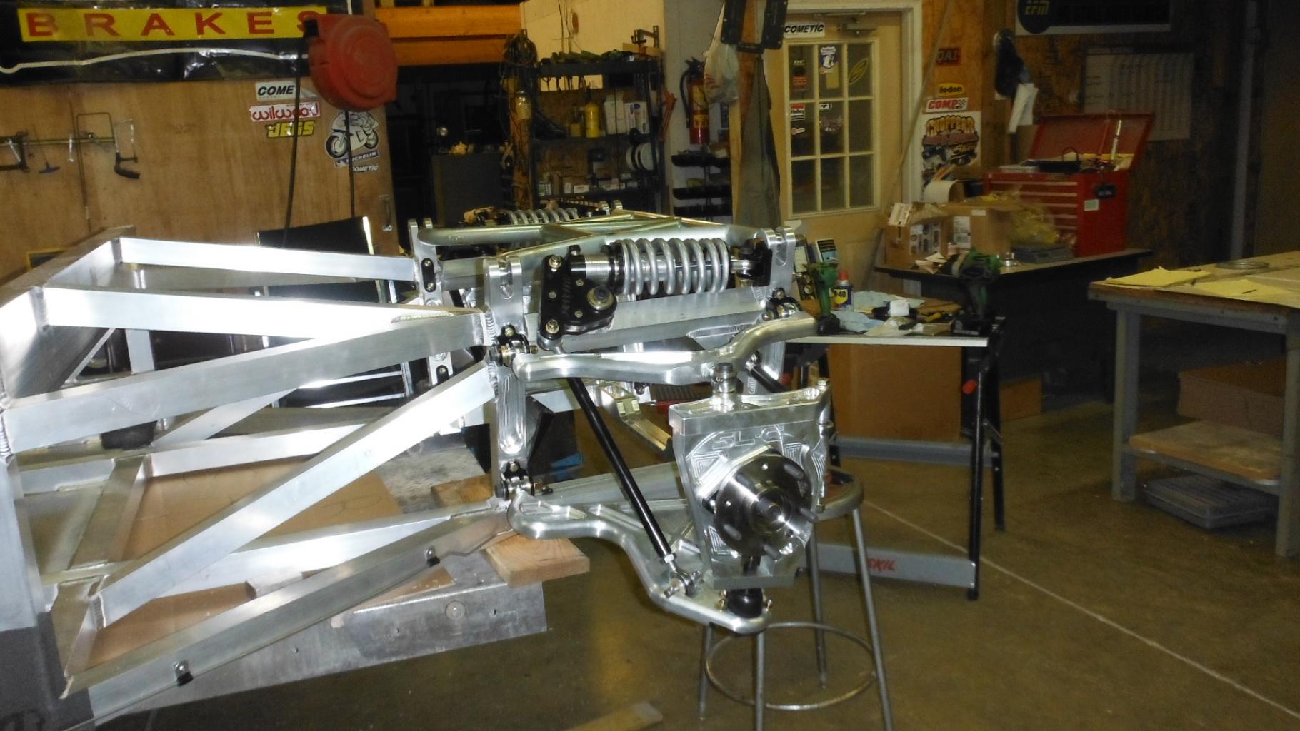

Finished the brake lines today, after a few trips to Summit Racing, I ran them in the front since my body wont fit to put the lines on the inside.
Back end is as finished as I can do till I get the motor and tranny. Ill finish the front end tomorrow, received parts today.
Here are some pics.

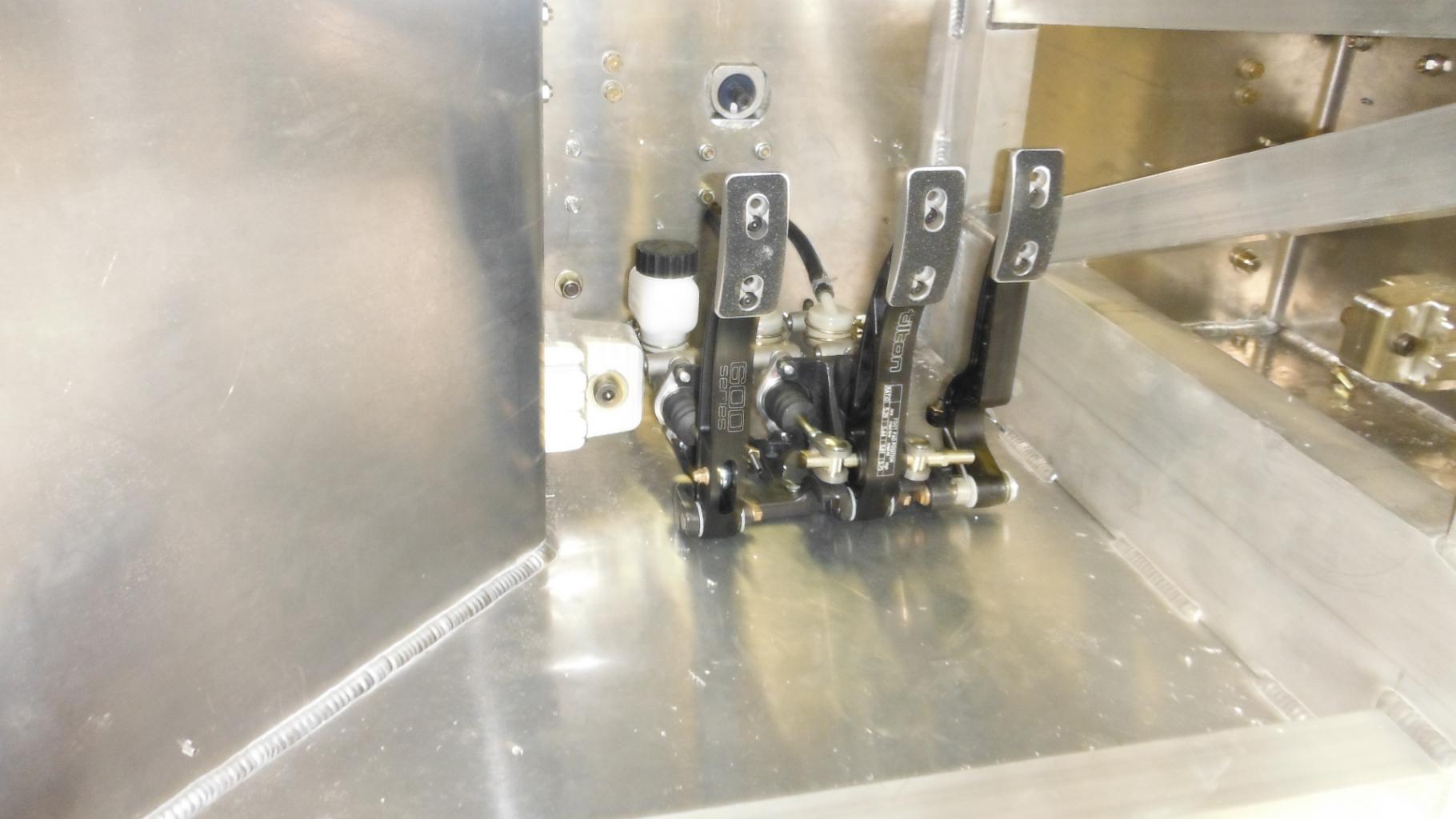

Howard Jones
Gary, get the steering wheel and seat in the car before you mount peddles. Getting these driver controls absolutely perfect is really, REALLY important. Go for dead and I mean DEAD on for your comfort. Line everything up with your nose as centerline. Do whatever you need to do to achieve perfection. You will thank me and yourself later.
Shifter goes last, with brake balance control and other controls such as main power switch, start button etc. If you are going to track the car these things need to be in reach with belts tight.
I put a seat in, going to mount the steering column today. This is just a street car, want to put miles on it not like my other hot rods, 4 mpg, kinda hard to go far with it, but I did pay Gore carbon credits so my foot print isnt as big with it, ya rite.
