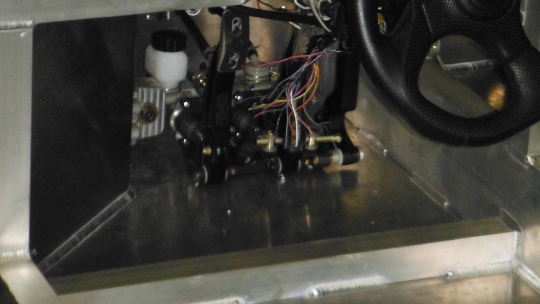

Also, when installing the steering column, you may have to relocate the tilt and telescopic motors. I and others have discovered that our feet hit the motors when transitioning your foot from petal to petal. This is one reason it is so important to position the seat at this time.
In post #46 of my build log, I addressed how I resolved this problem.

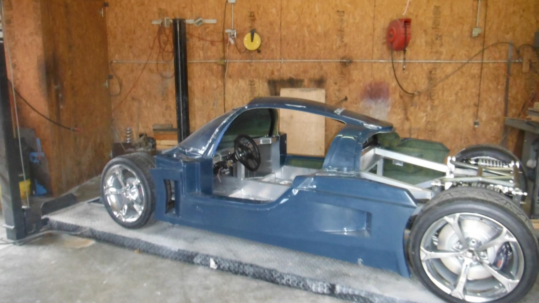

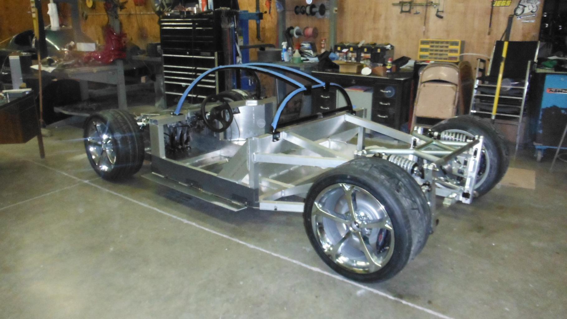

Well its standing on it own feet. Grommets are in, have brakes, kinda tuff for me to get in and out of it, guess ill have to loose a little more.
Will fit the center section on next I guess unless I should so something else first.
Tranny is shipping Tuesday, be a week before it gets here, same with the motor hopefully that ships next week.
Here are some pics.

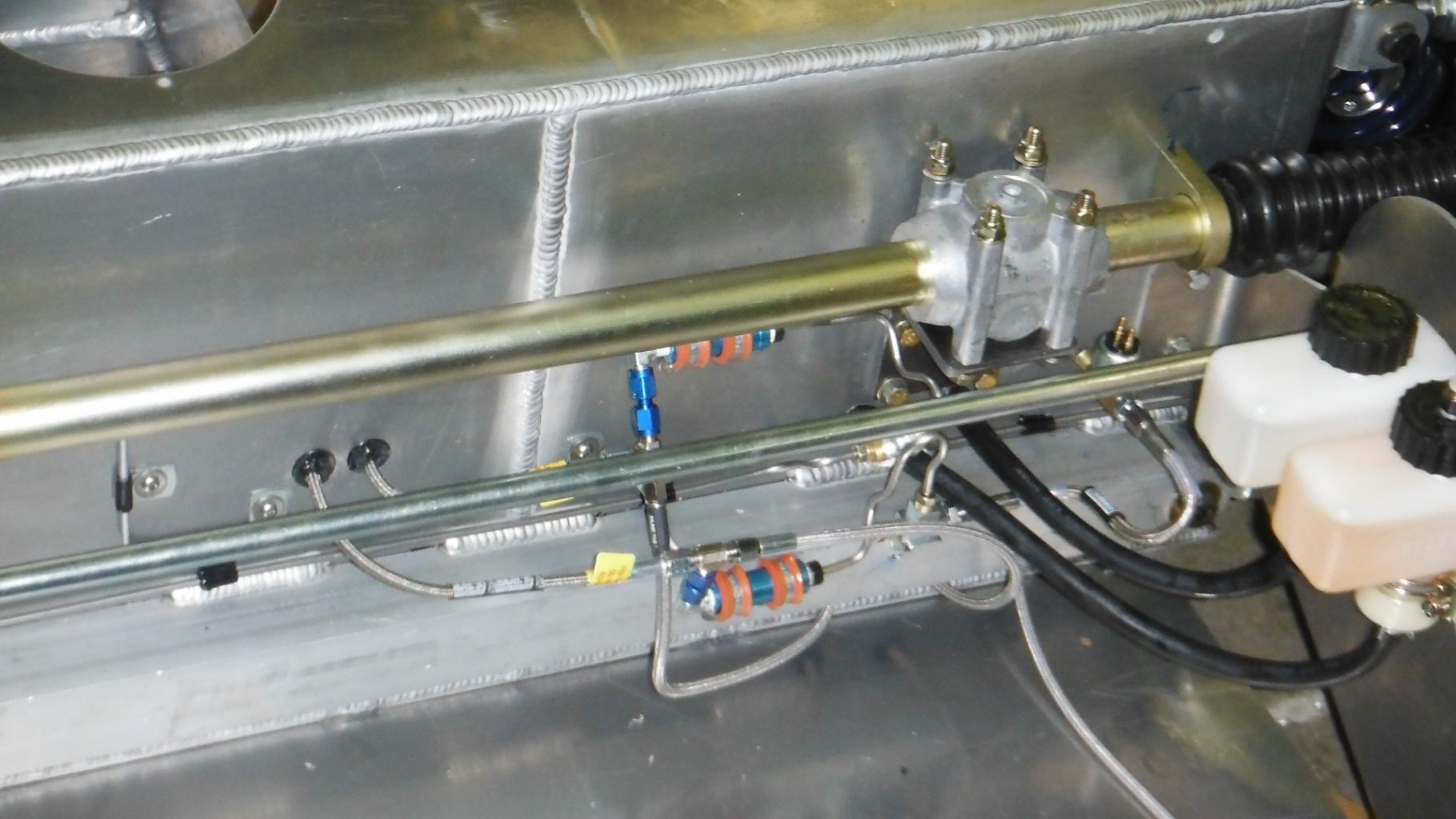

Well its standing on it own feet. Grommets are in, have brakes, kinda tuff for me to get in and out of it, guess ill have to loose a little more. Here are some pics.

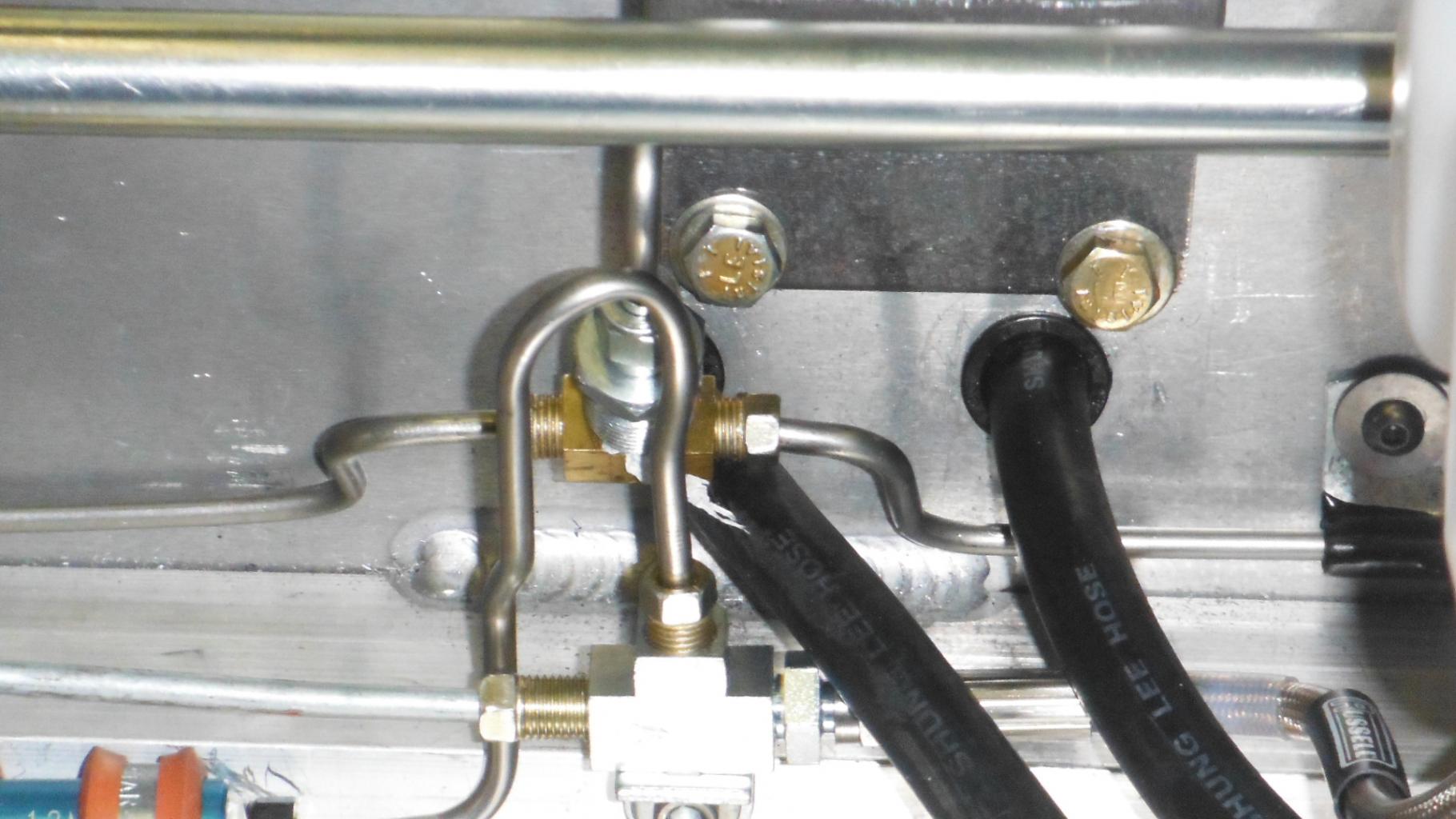

I noted your brake fluid lines but can't tell what they are. Mine sweated and dripped fluid. I switched them out for brake fluid capable hoses and now no issues. Just a heads up use EPDM or SBR hose if you haven't already.
I used what came with the master cylinders that all. The biggest mess was when I pressurized the cap for bleeding and had to much air pressure, 8 lbs, and it blew off one of the reservoir, brake fluid everywhere, it does clean the concrete floor good tho.

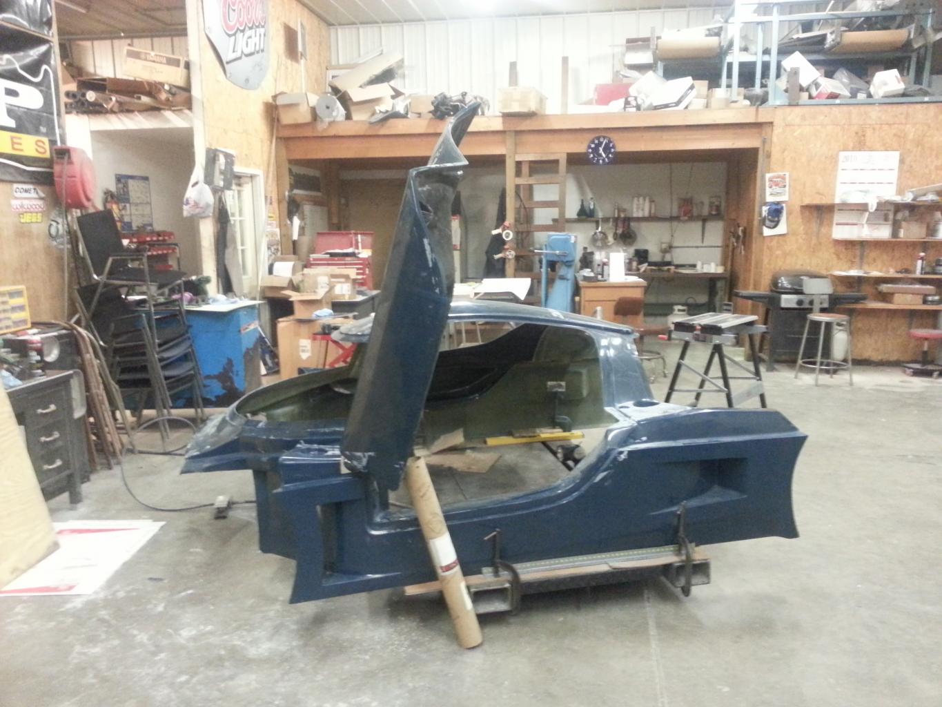

Here my progress. Motor is shipping tomorrow from Calgary, Tranny shipped today from Mendenola, putting the doors on, wheels, etc. Center part of the body is mounted. I know the doors wont open that much, but I will look at it to see if I can make them open that far, longer shock, different mount, something like that.

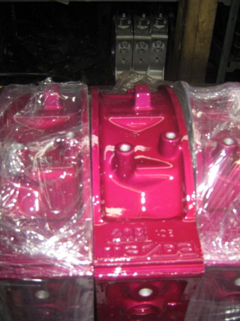

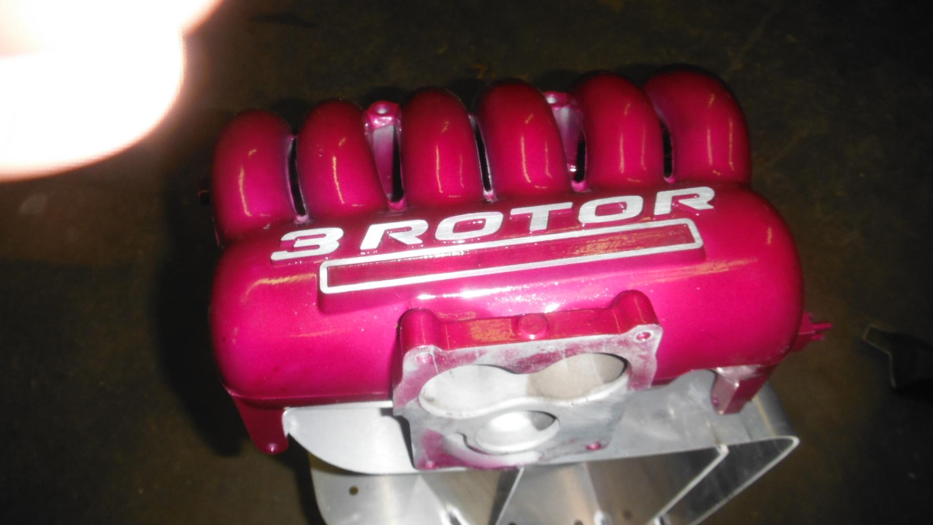

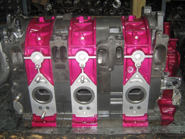

Here is the color of the rotor housings, and manifold. Might of posted these before, not sure.

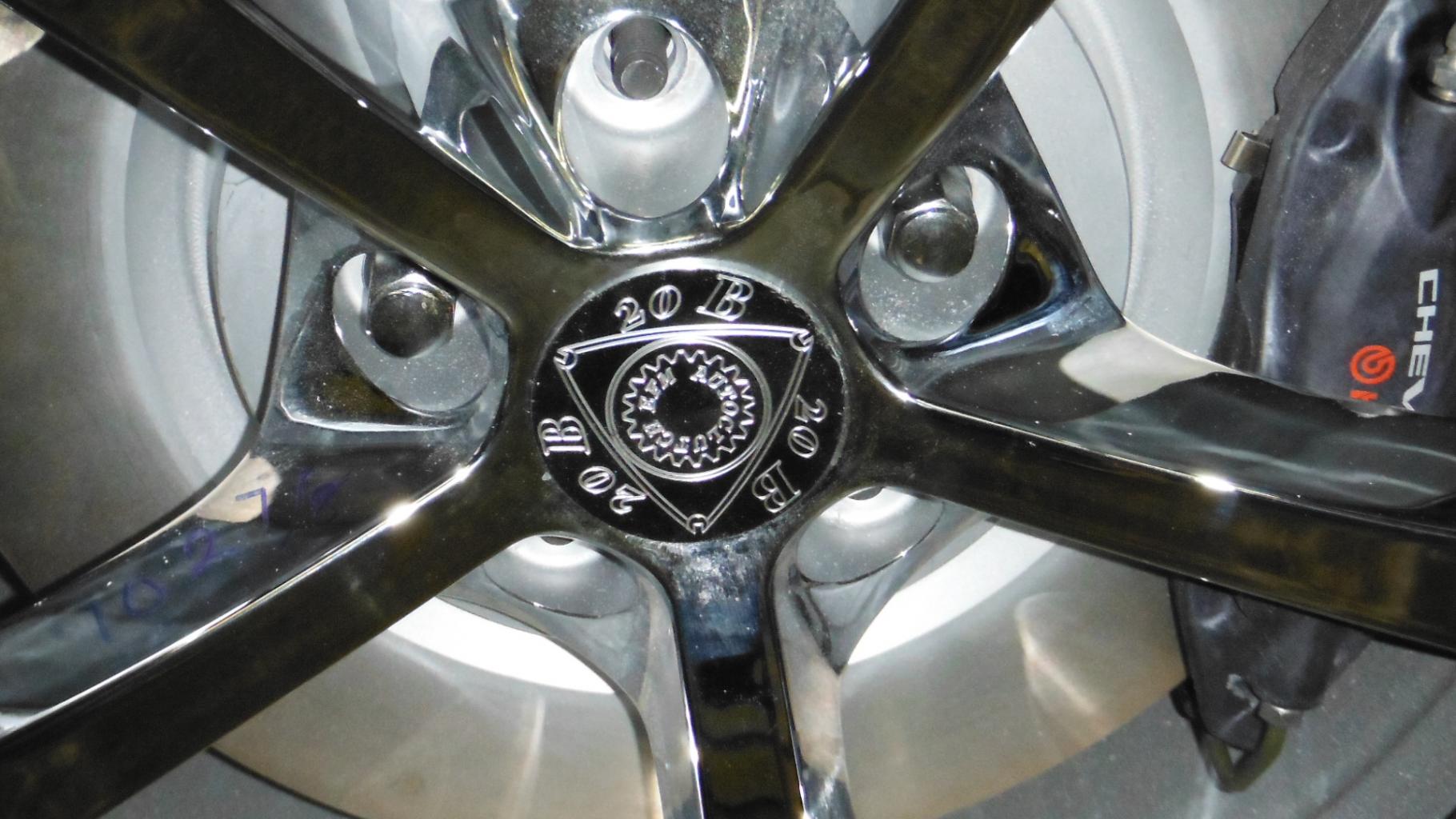

Got board waiting for my tranny, so I made these wheel centers up for my corvette wheels, instead of the 2 flags I made this up.
