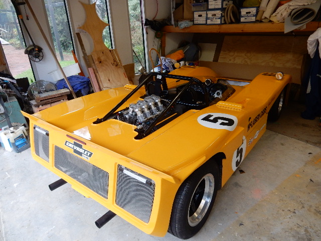

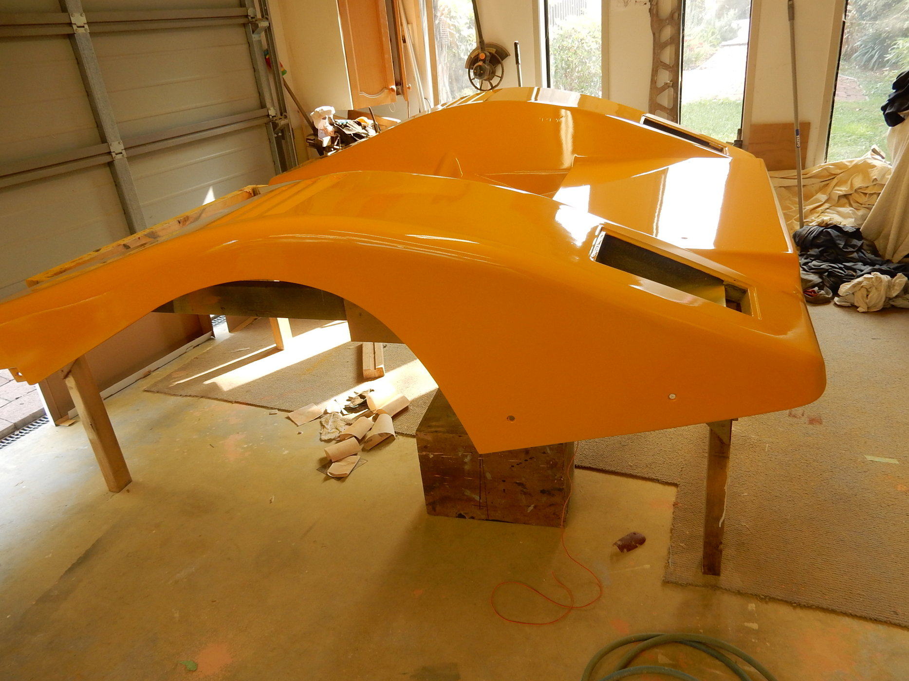

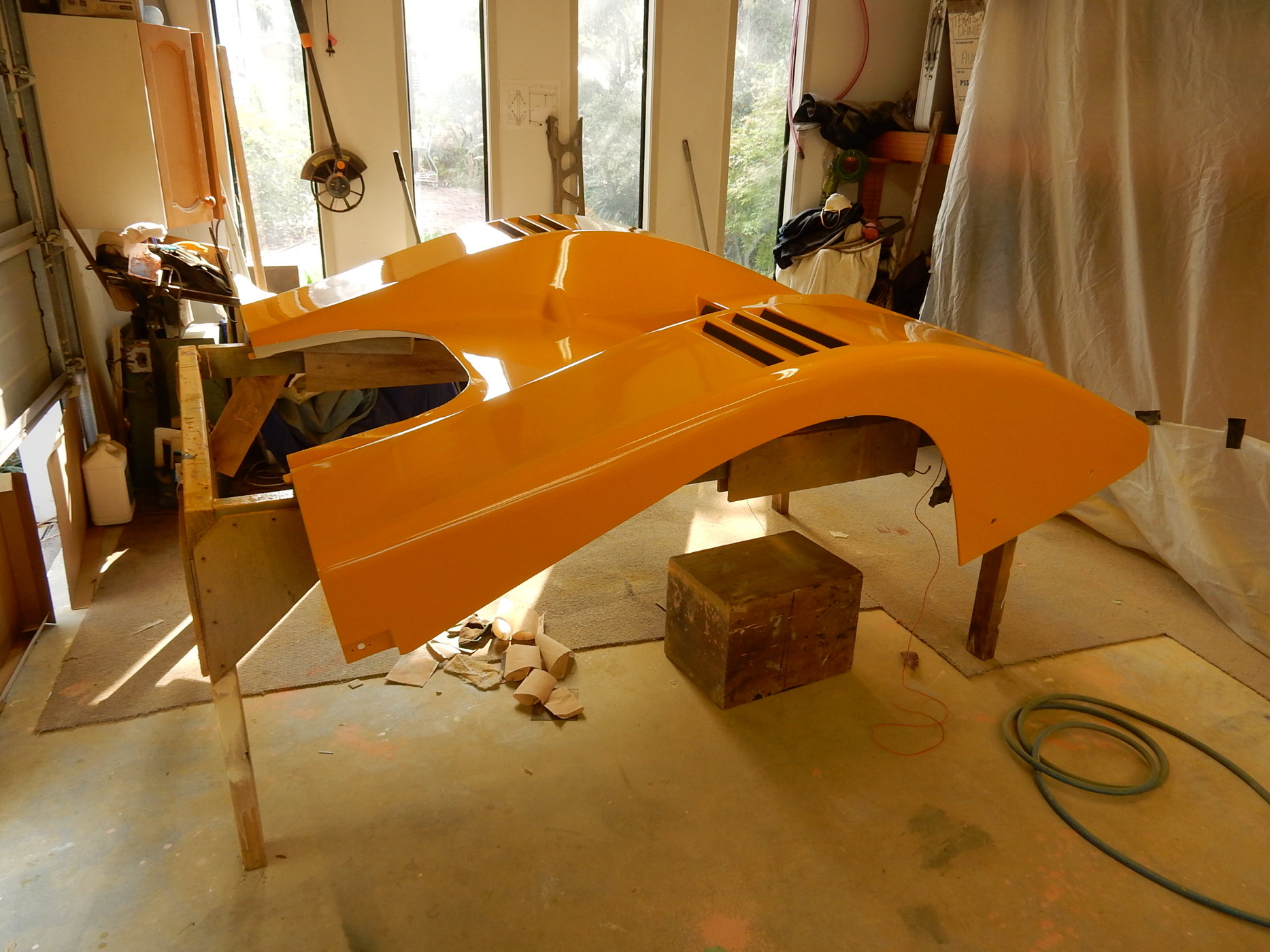

Well that`s the final panel / clip done now, only one run that should sand / polish out and if not then still got plenty of paint to blow a fourth coat over, better depth of colour anyway. Got good gloss and finish so all the effort is worth it, now for those decals...and then we had better start putting it on the road.

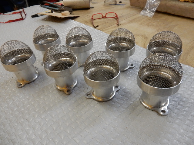

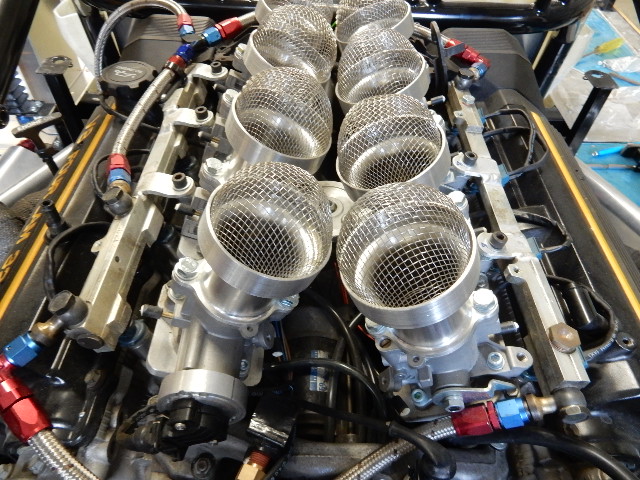

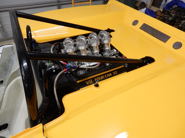

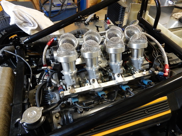

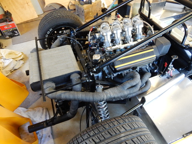

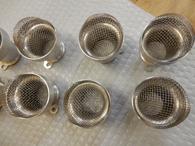

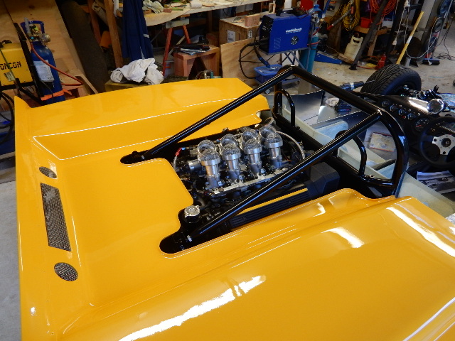

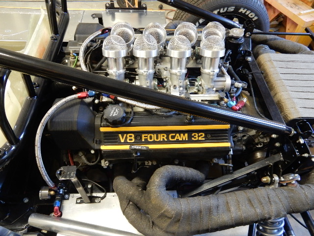

Just fitting in small jobs as time permits, been trying to come up with a solution to keep `stones` out of the TB`s and came up with this idea. Got some aly tube the dia of the TB trumpet flares and cut / turned ring up to accept the wire mesh. Turned a little seat in those rings so the the trumpet seated square and then proceeded to push pre cut squares of mesh into a piece of that pipe with a tennis ball. I then ran around the edge with a 1 mm cut off blade which gave me perfect mesh domes which will then be glued into the ring, onto the trumpet. Should look the part as there is not much room between them as they lay across the manifold at an angle.
Paint is all finished now and just waiting for my decals......then!
Terry, good old Araldite. The rings are almost a press fit and could have survived being pressed on, the glue will also hold the mesh in place.
Terry Oxandale
Skinny Man
They look the part, no doubt! Wondering though, if I need to buy another couple of pairs of glasses if I were to try this. ;)
Well they actually fit! The trumpets still have the original shape / flare and the idea was to have as large a surface area as practical given the space restrictions. Fitted the LED lights to the rear clip and sat it back on the car. Starting to look finished now as I am moping up all the little small jobs that get left till last.

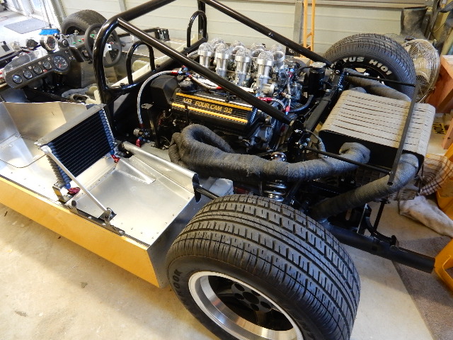

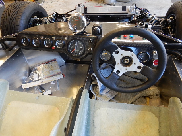

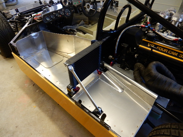

Spent the day doing all the little things that get left till last, installed and wired all the lights in the rear clip...and they worked! Tomorrows job is fit out the front clip with the head and park / side lights. Basically once I get my seat belts fitted, I can drive the thing. Weight looks like being sub 900kg just. As this is a road going venture, I have not worried about weight at all so am happy with that. I will give it a few laps of our block before I take it and get it wheel aligned then off to the final inspection and `rubber stamp`. I need to save some pennies to get the upholstery done....hope the tester has got a soft bottom!

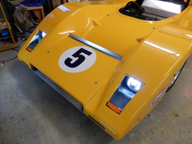

Grand opening...lights are on....somebody must be home.
Finally got the wiring sorted out, nothing works when there is no connection DOH.

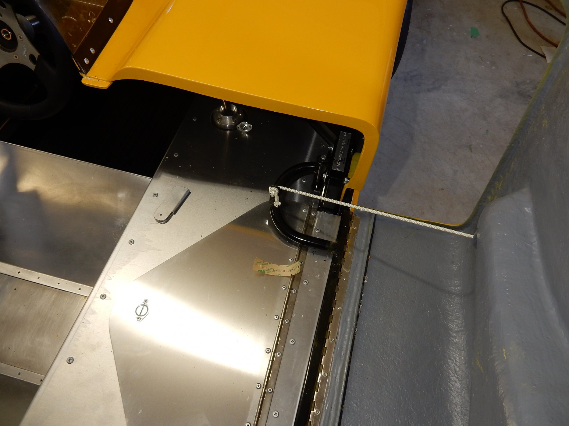

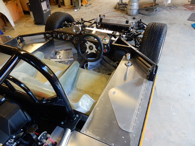

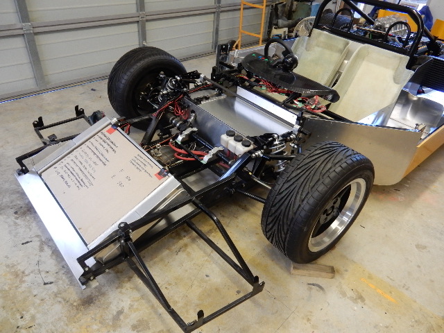

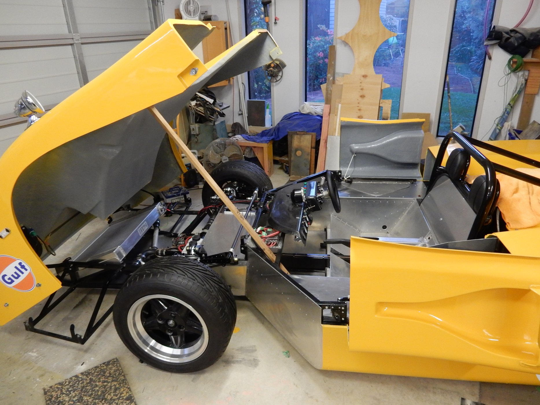

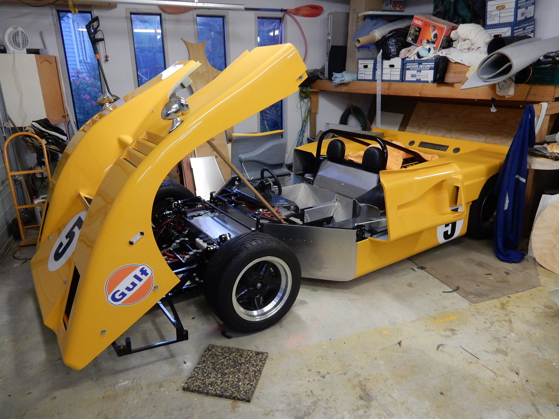

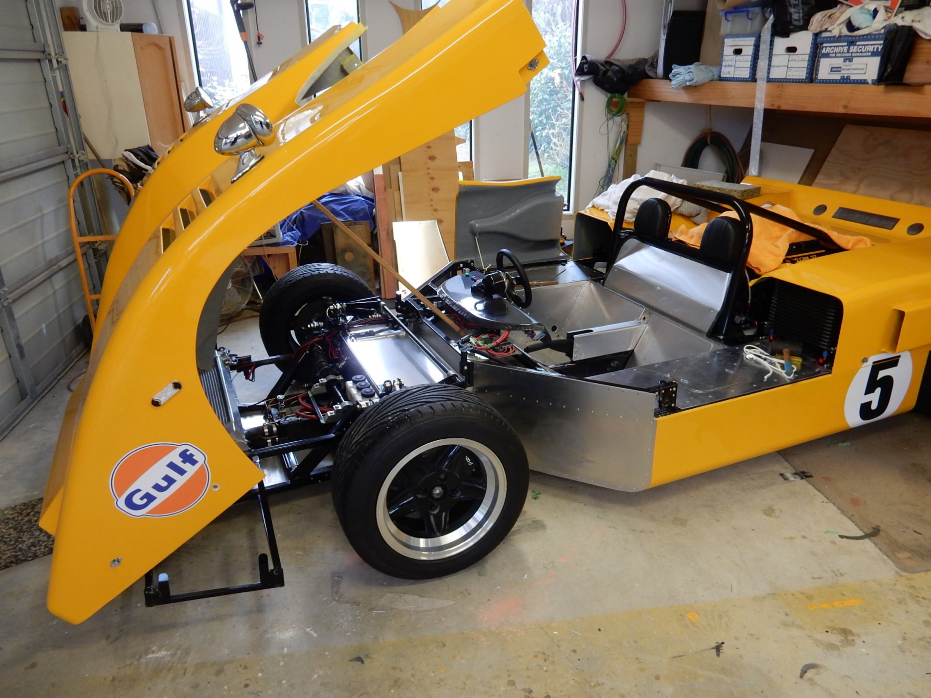

Going to fit some gas struts as it`s a breeze working under the raised front clip.

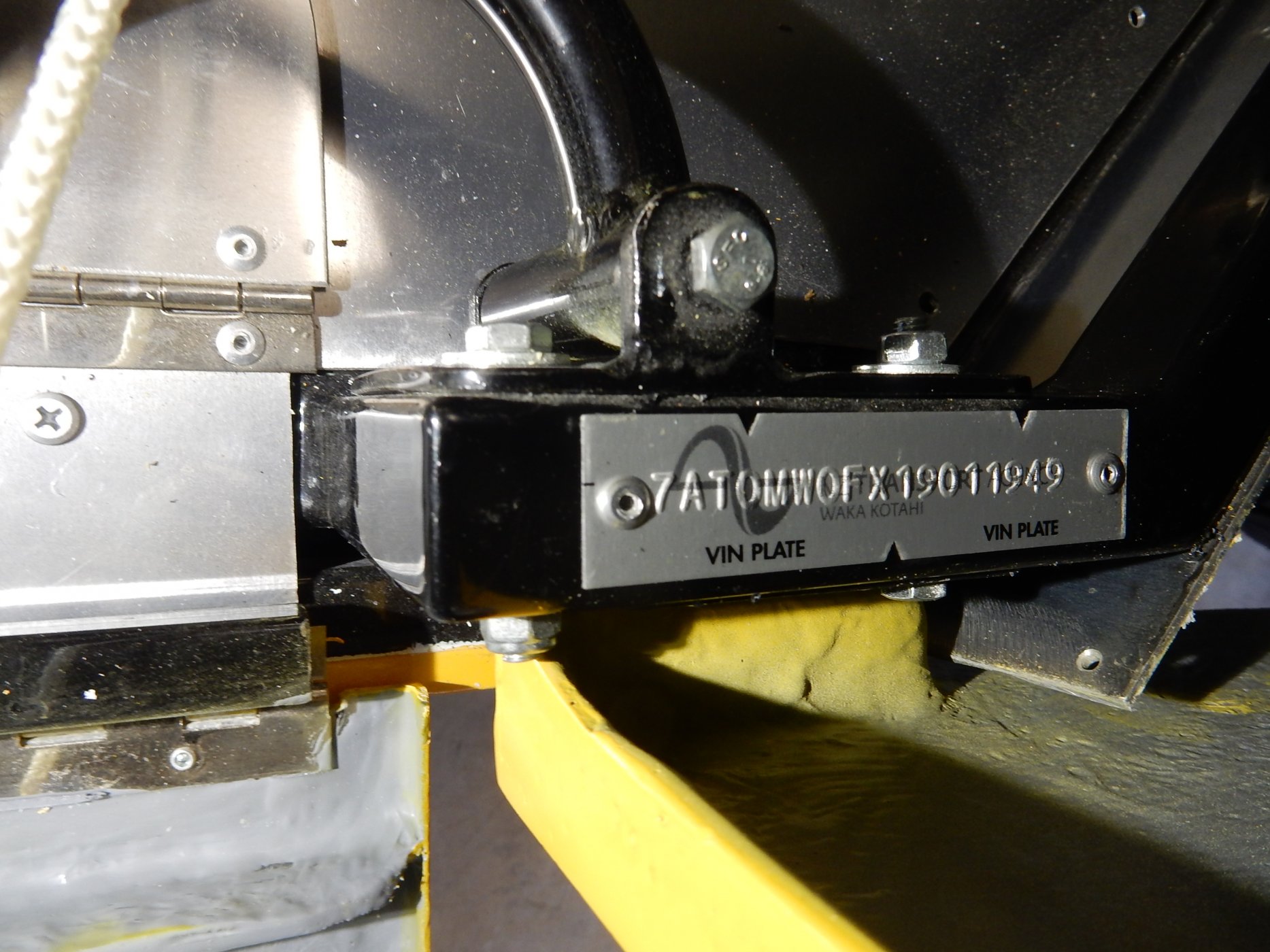

Bit of a milestone....had the VIN number supplied and fitted so its in the LVVTA system now, all I have to do is make it work....first drive once my seat belts arrive in a couple of weeks and then its the final check. WOF and rego all going well.

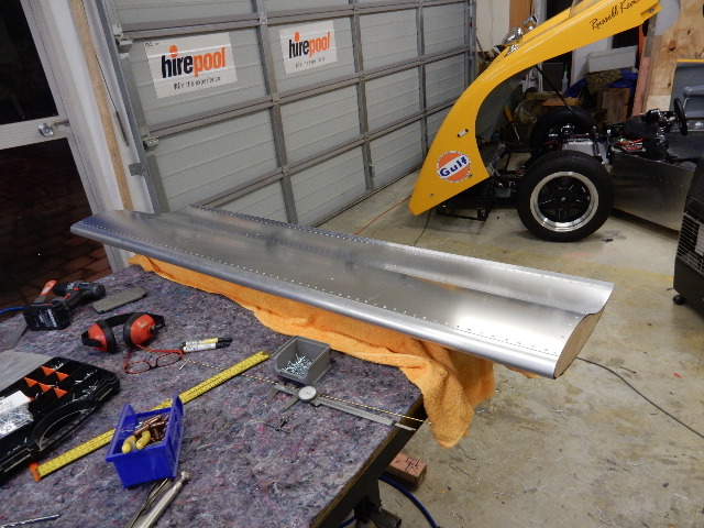

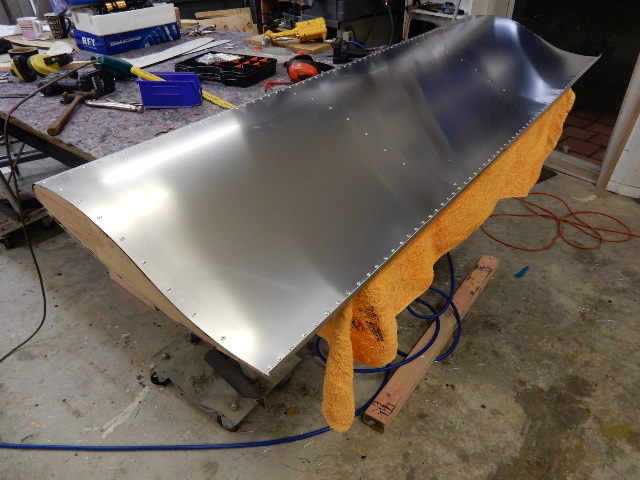

The wing is all built and ready to mount on once we are road registered, not going to push my luck with the inspection.
Neil

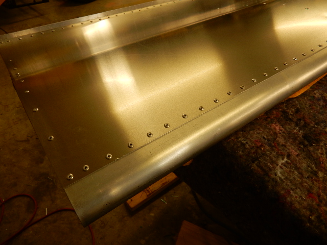

Russell, if you replace those dome head blind rivets near the leading edge of your wing with countersunk rivets there will be less disruption of the airflow over the wing. Less drag, more down force.
