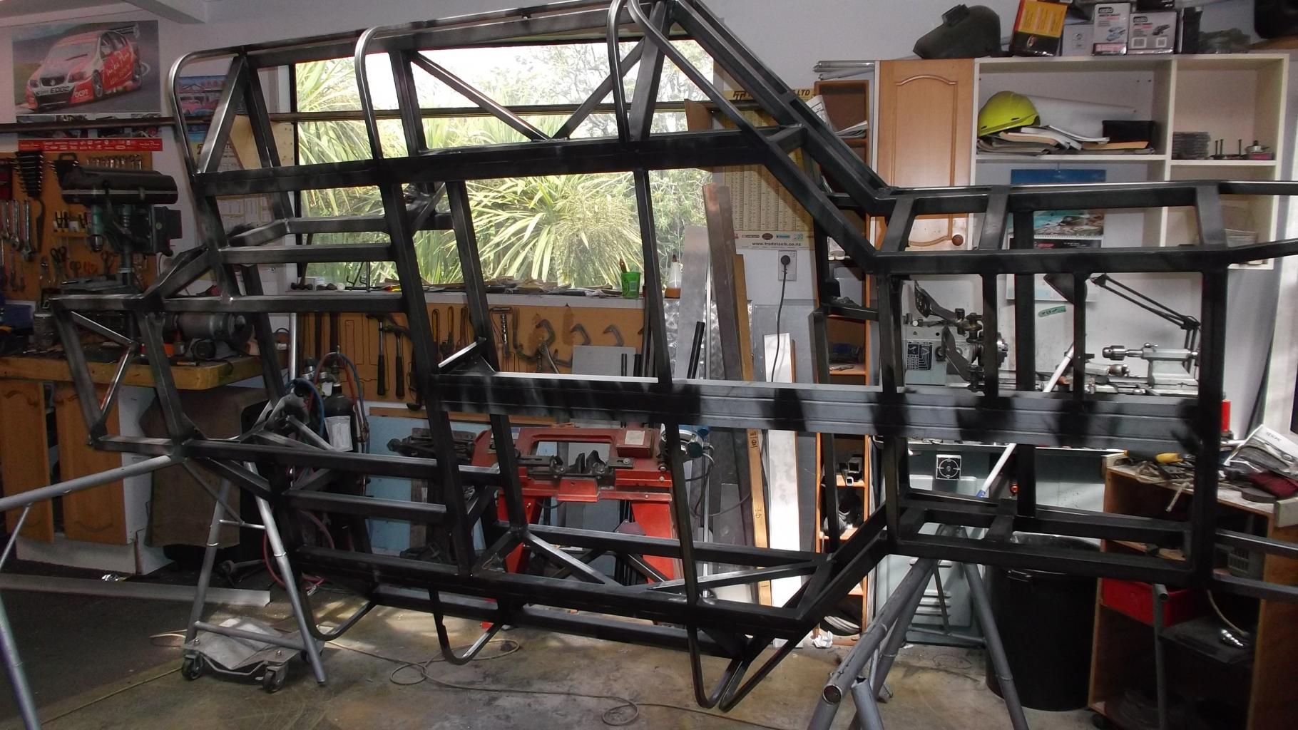

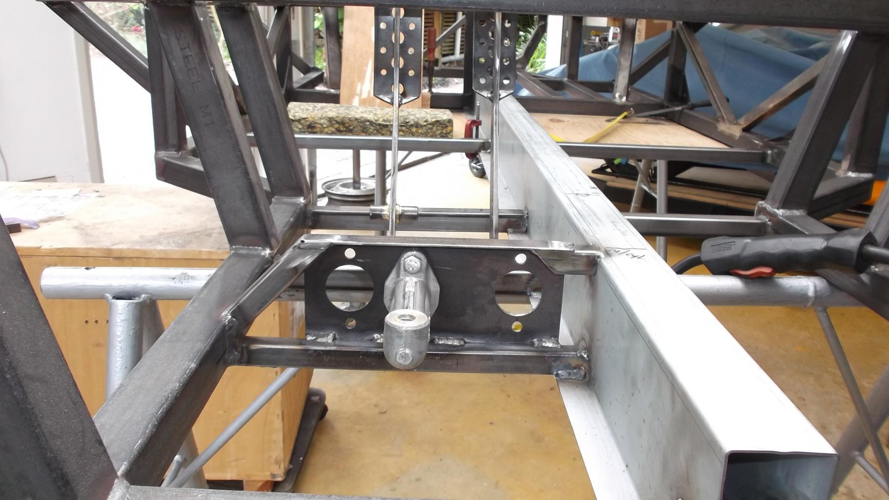

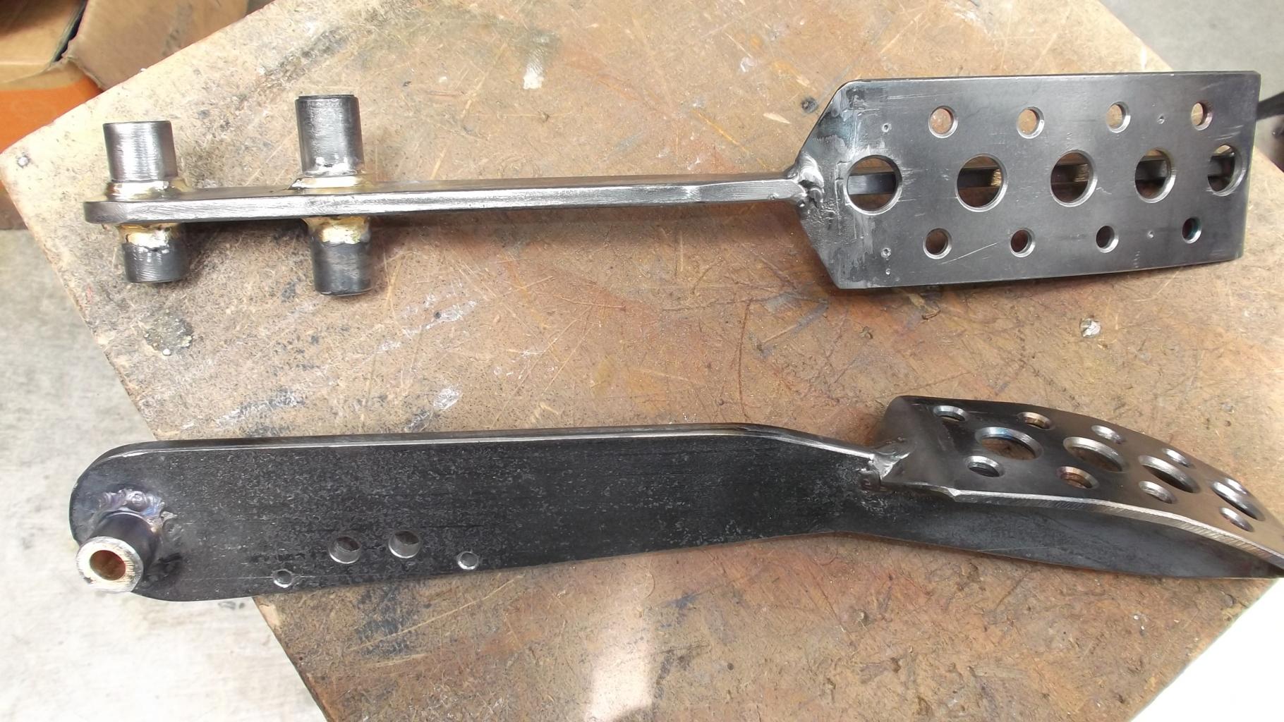

Pretty well got most of the chassis completed now and are just waiting for some major bits to arrive from the States. Summit has been busy delivering all manner of small bits and bobs so its almost like Christmas again.

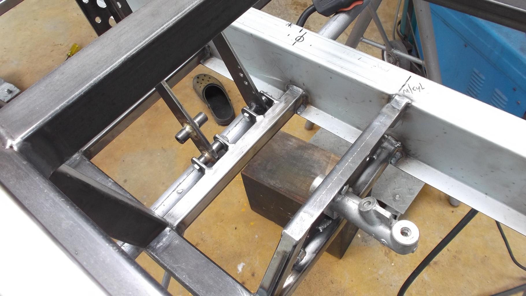

Have started to fit brake and clutch pedals, was going to use Willwood but made my own instead, a bit heavier but $250.00 cheaper. I am also running a fixed balance bar and will fit a adjustable balance valve for the rear. Next for construction is my fuel tank, am only going to run 1 tank of around 50 liters on the passenger side as the battery and me will be on the drivers side. It will be by necessity a long skinny tank around 250 sq in section and around 800mm so will need to be baffled and have a small drop sump for the fuel take off point, I have a Summit tank cap and will also fit a gauge this time. My tame sheet metal guy has had the cheek to go on holiday till the 13th so I will just have to wait.

All over bar a few brackets to hold some bits and pieces, Now its time to work out some suspension dimensions /wish bone lengths and all that sort of stuff.
Certainly weighs more than my tube frame so must put on the scales.

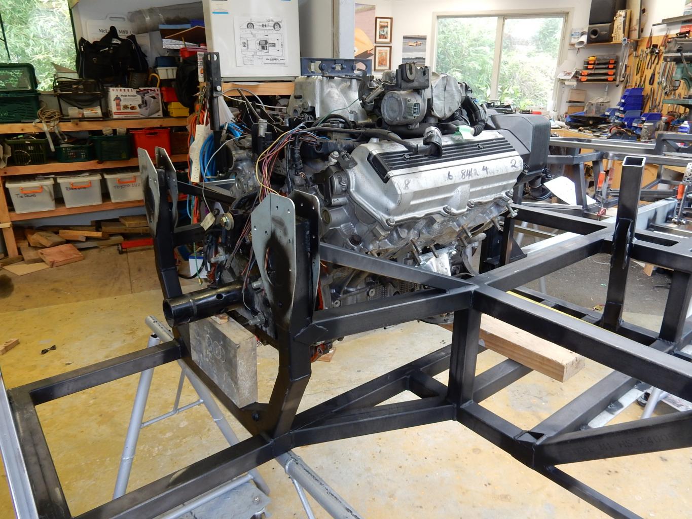

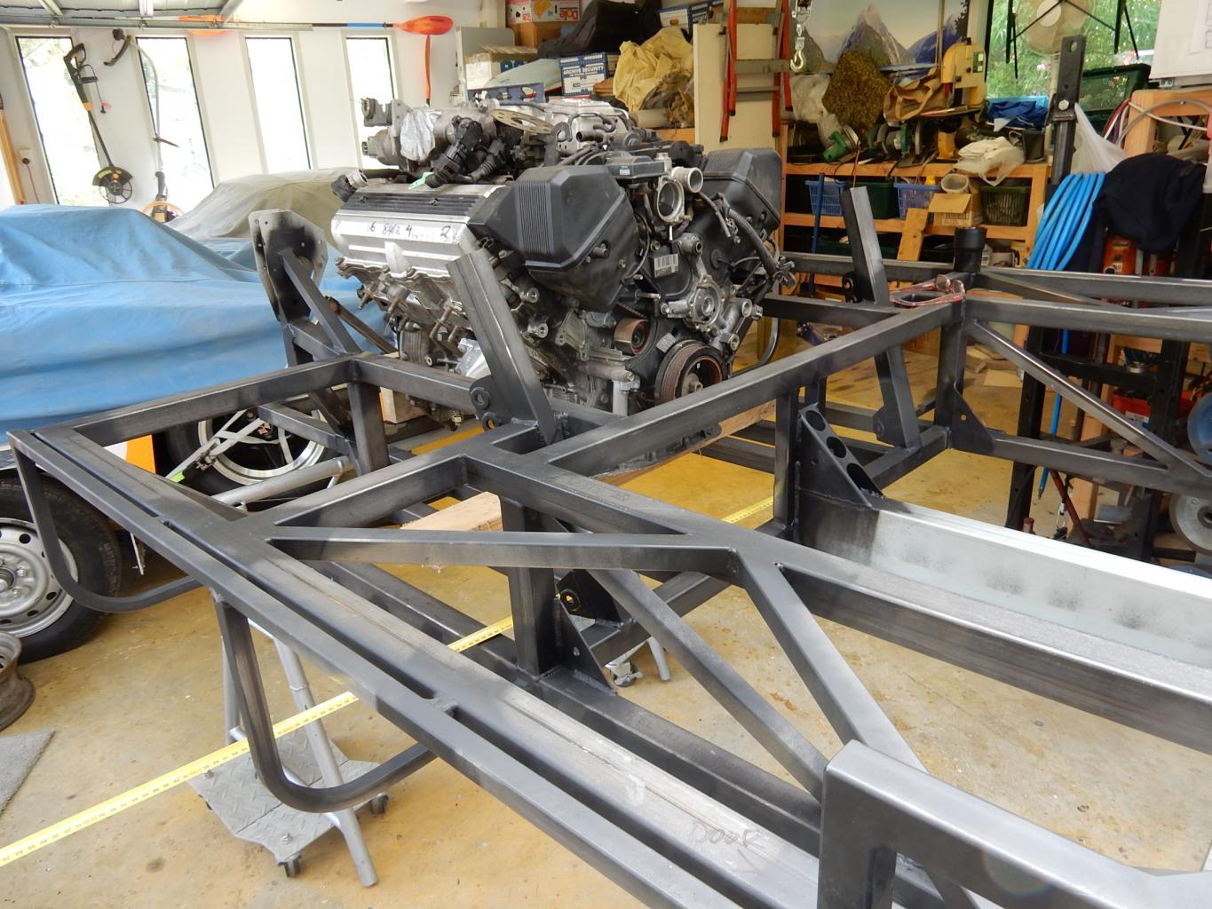

Finally stuck the Toyota V8 in its resting place, still nothing to stick behind it yet, still on the boat somewhere in the Pacific.
I added 40mm to the back section which has ensured that there is plenty of room in front of the motor.
I will be fitting a remote oil filter and was thinking about fitting an oil accumulator as the previous owner had started converting this motor to dry sump and had modified the sump to reduce its capacity.
I was thinking that the accumulator and remote oil filter would compensate for the reduced sump capacity. I would think that the sump capacity had been reduced by around 500ml at the most.

Hi Russell, Good to see more progress, is the engine sitting quite high or is it just the way the photo makes it look. What is the crank centre line to floor distance.

Bit of an optical illusion as the chassis is only 300mm high, the crank centre line is 210mm from the underside of the chassis which puts the sump 10mm up for clearance. The trans axel would like it a little higher to reduce axel inclination.
